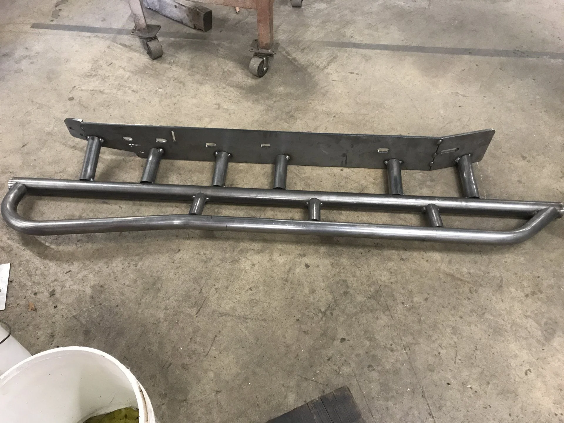

As far as mounting design. Basically, there will be a full length plate on the back side (or inside of the frame rail) then for all the more square holes along the frame, 1/2" bolts sandwich the slider to the back plate. That is also in conjunction with using the existing threaded nuts. That design still has a lot of more too it, if someone tried to copy this, there is still another aspect to it that ensure alignment of the slider is maintained (and not just the normal existing threaded nuts that are already used).
I don't come up with this stuff, Bud is a mechanical engineer with a specialty in material analysis and failure analysis. As well as 30+ years in the industrial manufacturing and processing world. So, he's got a little different way of understanding how things really work, than someone like me who just gets some .120 DOM and starts welding metal together to make a slider.

I'm just pushing this 200 into tight areas, so Bud's design puts 6 different angles legs to the outer tube, with about 5 inches from the last leg to the ends, plus his run the entire rocker length.

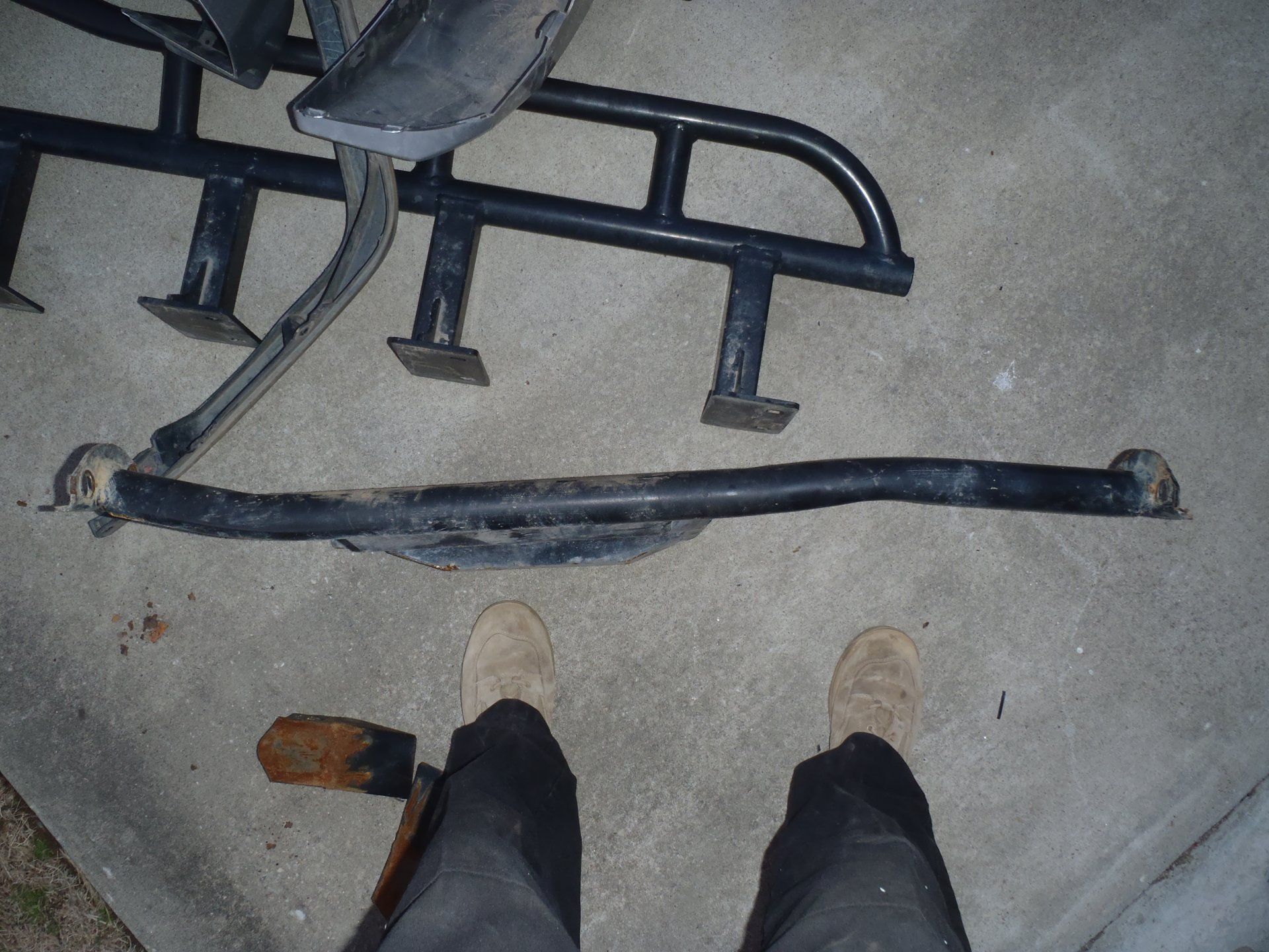

As far as the frame moving and not the slider. I hung plumb bobs down the body where the stock step were to the slider, and I'm sorry, but it was the Slee slider that was bending, not the frame.
Was the deflection in the direction of the slider, or from the fame outwards? I looked at your picture of the Budbuilt slider and yes, it might have more legs, but from the basic design you would not be able to get a hi-lift anywhere close to the tips of the slider. So I would venture to say it is much of a muchnes.
I guess we can agree to disagree then on this :)
ah is see where we are seeing different things, the BudBuild sliders is the picture is the first prototype, I had it in the comments but, yea, that is not what they are looking like now. I was just trying to provide something for the group.
But for the deflection piece, I could get the Slee slider to press into my rocker by lifting from right behind the front leg. I don't know how much closer to a support I could get. I wasn't talking about putting the hi-lift at the far lead edge. Which brings me to the variances in the frame a using an L shaped design.

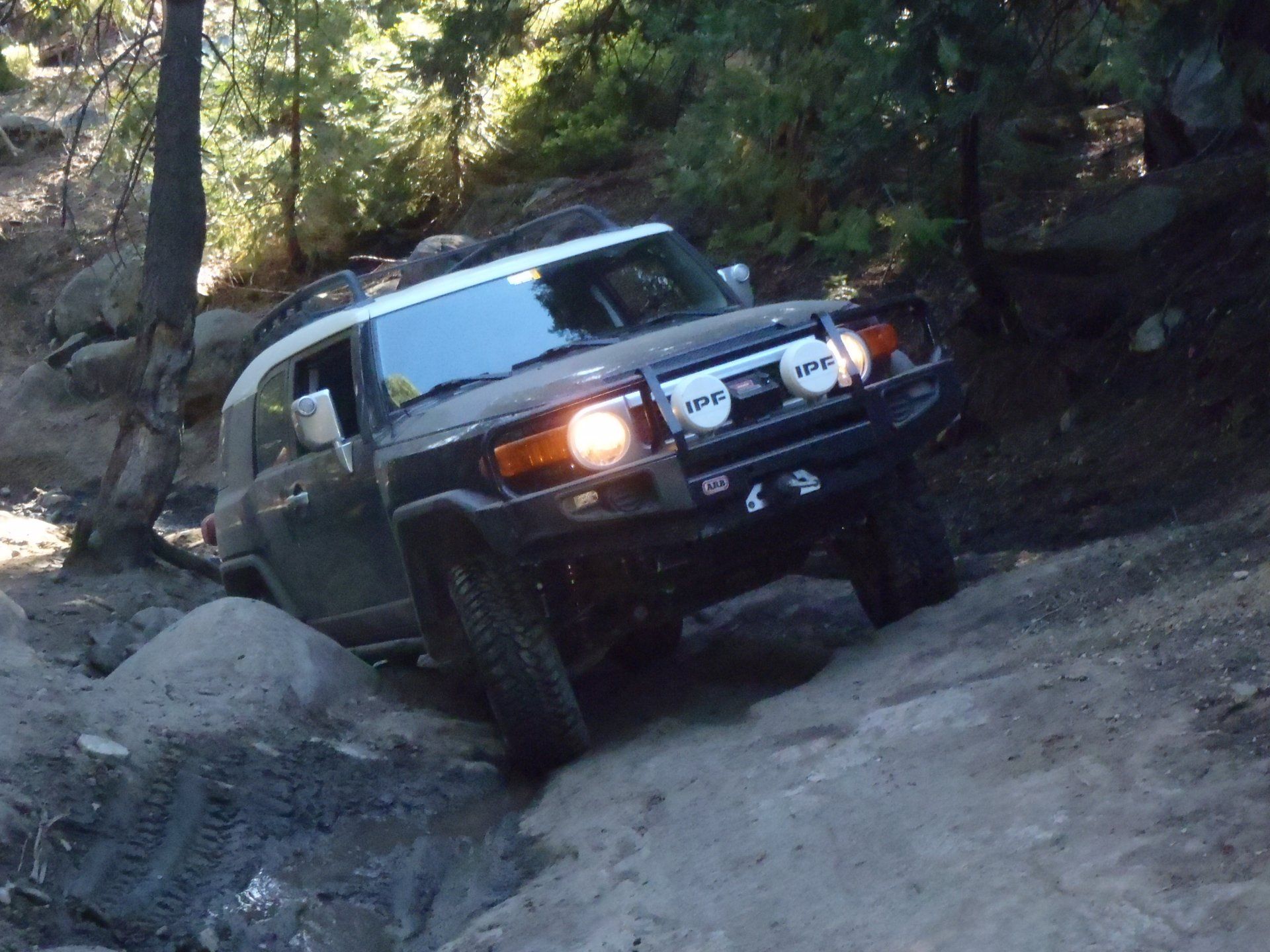

Here I am on Cadillac Hill on the Rubicon Trail. Notice that I have to do an immediate 90 degree turn to the left, while still in-between the two 4' boulders that are about a foot narrower than the width from kicker to kicker. Once past those two rocks, you see where I had to turn, if I did not have a kicker, then I would say good bye to my wheel and the quarter panel behind it. If I would have driven far enough out from the two boulders, to not need the kicker, I would of fallen off that cliff on the left side of the screen. I can't back up, because of the two boulders.
THAT is why I like kickers. This isn't an isolated occurrence, this happens... a lot, and this is just mild rock crawling, not the tough stuff. I hope that better illustrates why I like kickers.
So in this case, the kicker helped turn your rig sharply left upon exiting both boulders--which you needed, because boulders on your right rear and inner left would have prevented you from backing up as part of a 3 point turn to go tighter to the inside (your left)..
Do I have that right?
Yep with giving me a few more inches clearance from that final rock, also that I couldn't pull far enough forward, to do a 3 point turn, because there is a 80 drop to the front of the truck, and couldn't go further right, because there is a 30 foot drop to the right. That is because on the other side of that tree you see to my right, you are down there right before making your way to where I was.
