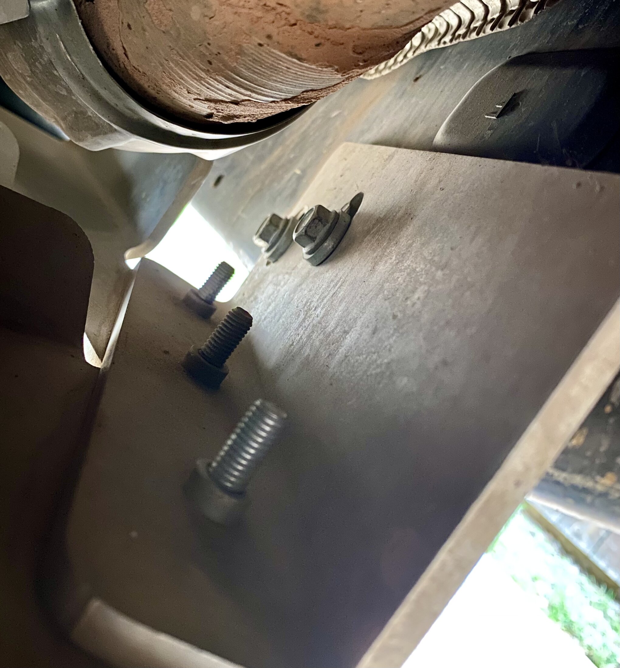

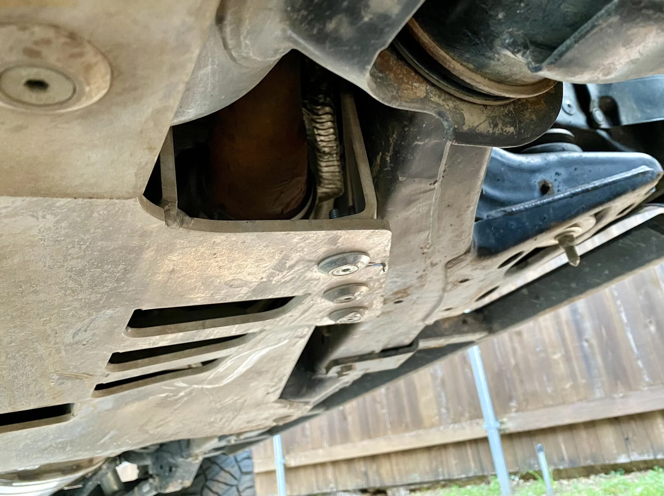

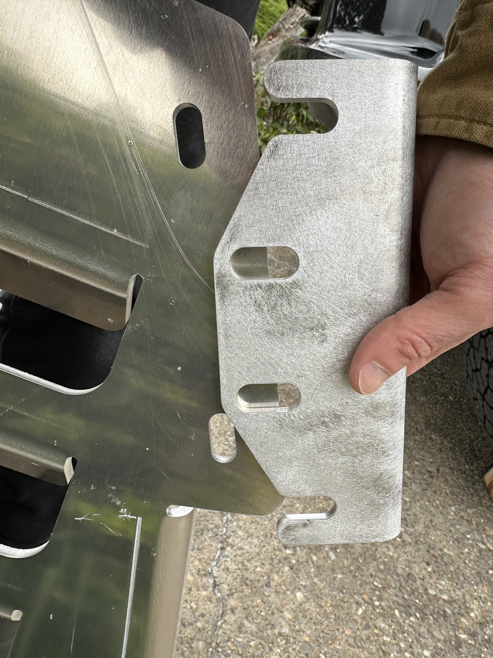

For those who are familiar with Dissent skids installed on an LX570 - I'm having trouble figuring out the stiffener plate part of the installation.
The bolt holes don't align with the holes in the frame. And if they did, the bolts are smaller than the holes, and the frame appears to be solid metal behind the holes. The stiffener holes also don't seem to align with the skid holes even if I were able to bolt the stiffeners to the frame. I reached out to them, but It's a Saturday so I don't anticipate a response from them.
Anyone have any thoughts this?

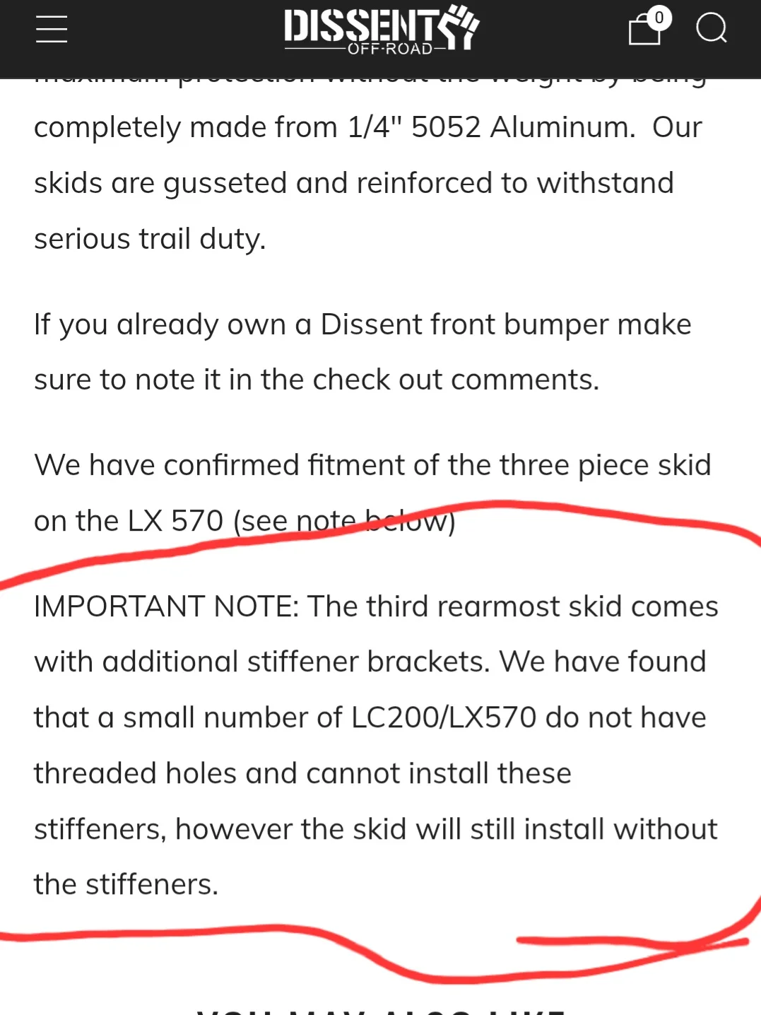

I think this note on their site refers to that bracket.
I've wheeled extensively with and without those brackets. I think you'll be fine either way, but I would install them if you can.
