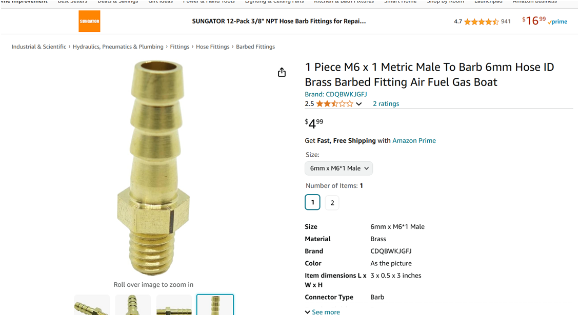

From a previous search on this some of the parts to make that setup work. Need to go through this idea one more time though and see what is available today vs this search in Sept 2024
With the last two barbs to fit in the air filter and the frist bard above to screw into the neoprene expansion nuts
