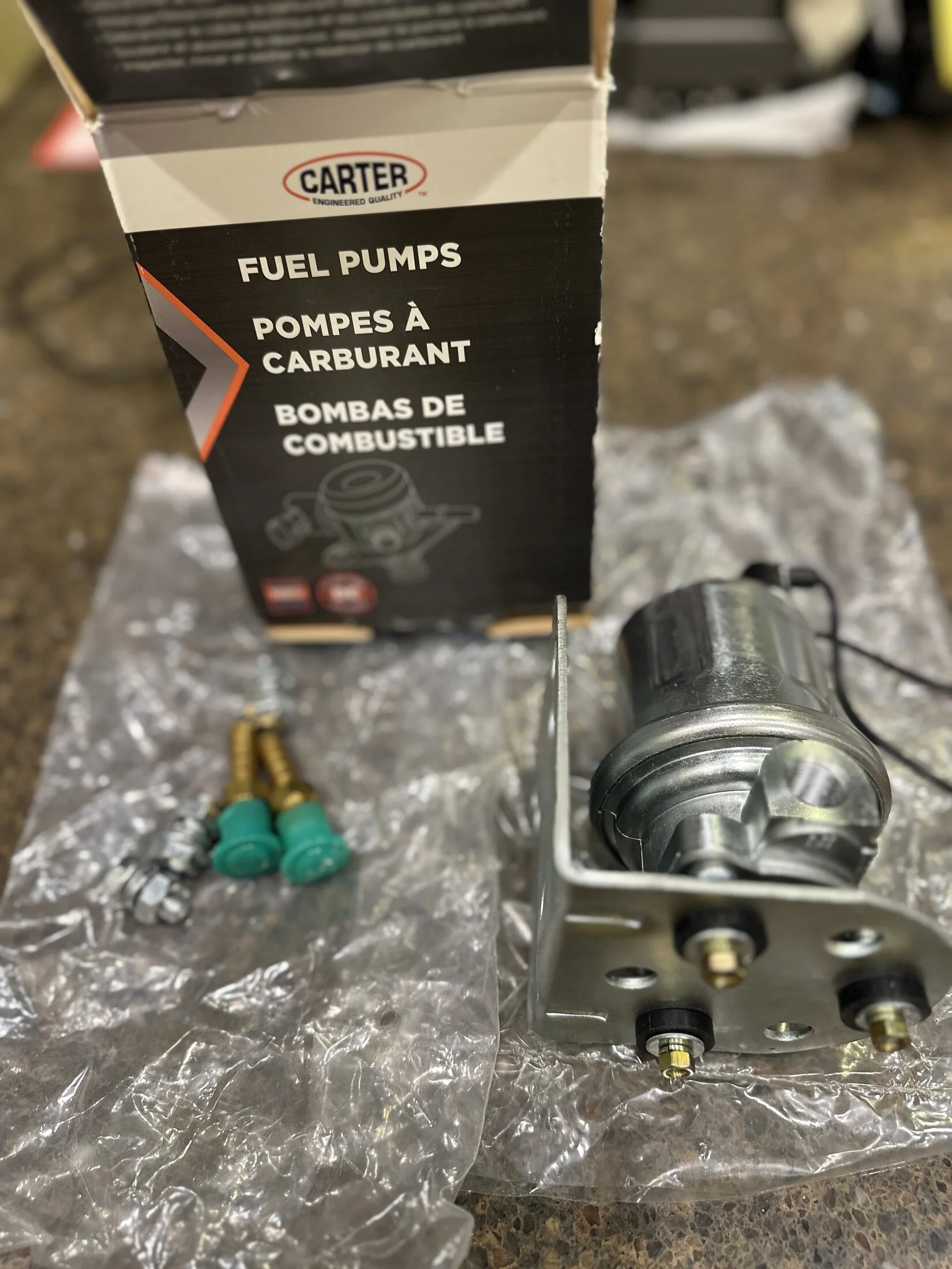

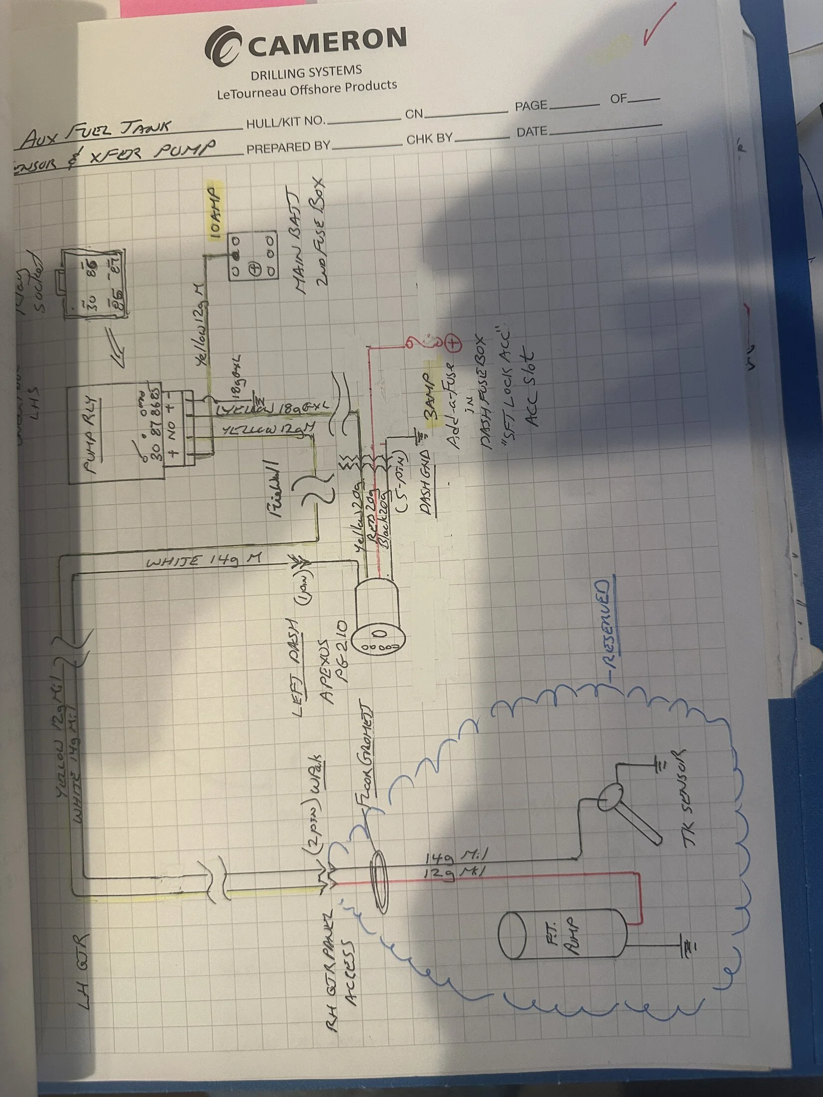

I can sell you a new in box fuel pump that I ended up not needing. I have the 12.5 gal tank and found the provided pump was fine with the following mods. The LRA wiring diagram does not use a relay for the pump their is far to much voltage drop between the small wires and internal circuits in the switch. My wiring set up almost doubled the pumping rate. The other mod was to mount the pump on rubber vibration isolators, I purchased for the Carter, but need up using on the smaller facet .. sound level is below ambient road noise except when caveating at empty tank. I powered pump with 12 AWG wire , the Apexus switch is using 20 AWG wire and the wire supplied by LRA is in between even though it's claimed as 3 mm2 or (12 gauge). Place a rubber sheet between tank and body I used 1/8" x 4" x 10 ft 60A hardness sheet from Rubber Sheet Warehouse.com. x001x8NCS1. I also added heat shield material between tank and exhaust.
