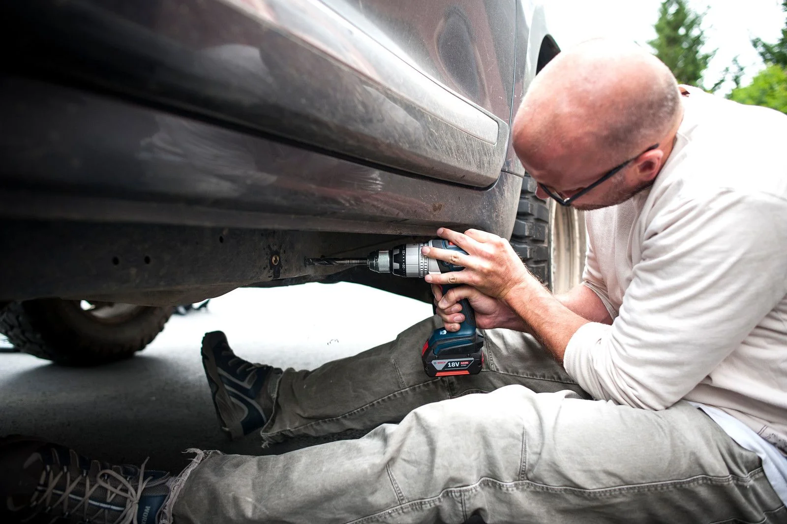

I installed the Metaltech sliders, only need a drill and some wrenches, pretty easy install...

The Metaltech's def take some drilling, I was shocked at how easy the holes were to drill...
This drilling picture is with the 3" lift correct? Probably not quite as easy with standard height. But does look fairly straight forward. I think I am going to wait until budbuilts are available. then compare them all again and go from there. Good options all around. Just want to get rid of the running boards but the wife wants a step.
yep, about a 3 inch lift, does give ya more space to work on stuff forsure...
