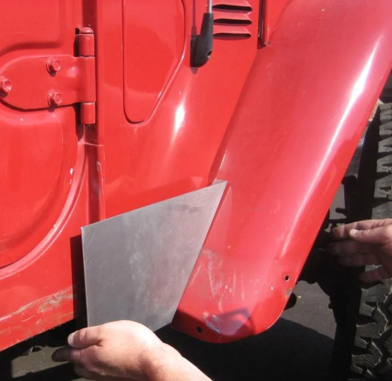

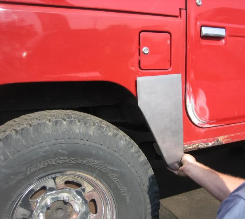

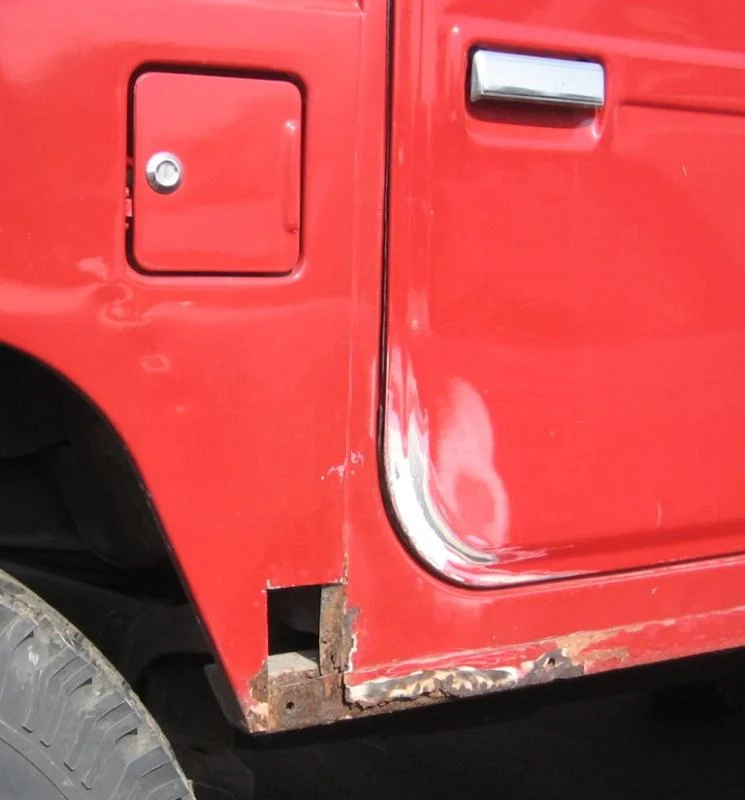

Well, to my amazement, FedEx overnighted the box with my patch panels, the one they lost last week. It arrived this morning. I guess that's some progress, but we still lost over a week of work time. In addition to the rust issue seen in the first photo, the PO cut 3" off the bottom of the side panel, outer rocker, and apron in order to install sliders. We're restoring the truck to stock configuration, using all new 16 gauge metal panels from Real Steel. Here's a couple of not very interesting pics. Sorry, it's all I've got. :frown:

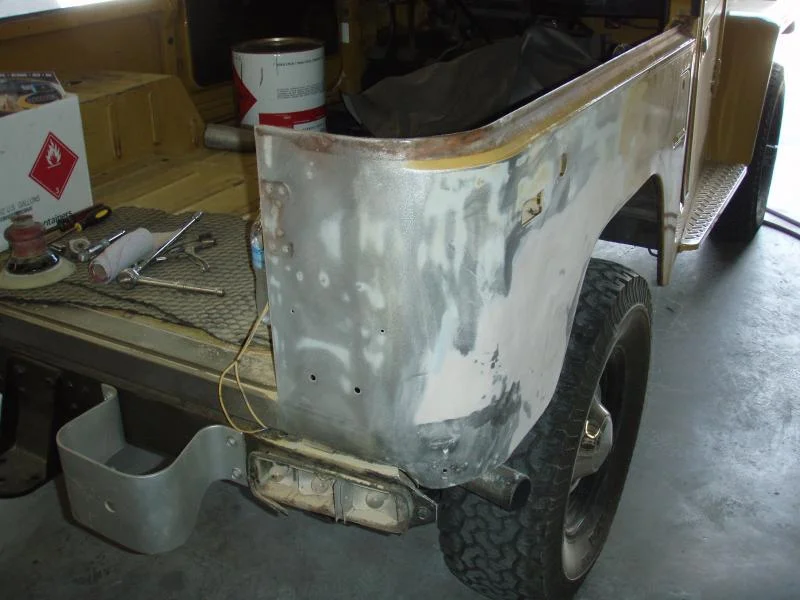

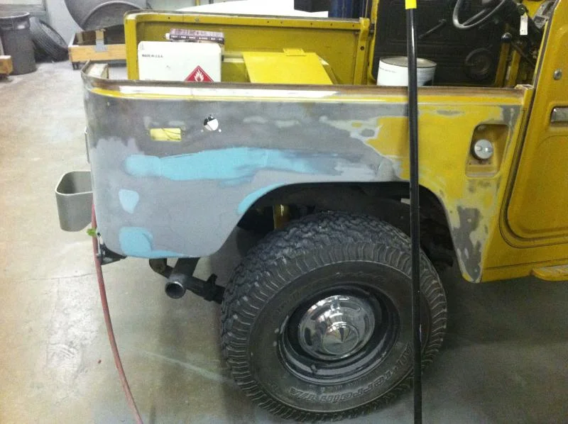

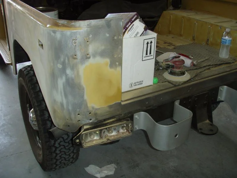

Progress

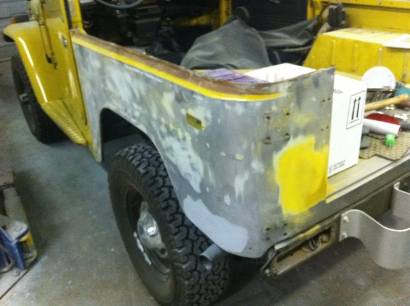

OK Gents we are moving. These pics were from mid-afternoon and I was told she would be in primer by this evening. ETA is now mid-week. I'm going to push her around the corner and put her back together myself. Hope to be rolling by next weekend.:D

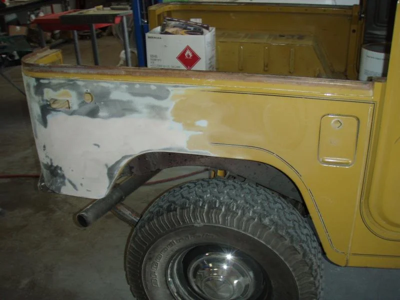

Still a little hammer and dolly to go under this old damaged quarter panel. Mike was cutting this back to metal when I interrupted and was getting ready to bang it a few more times before the All Metal filler. Had to assist in demo of kitchen countertops this evening or I would have been rubbing it myself.

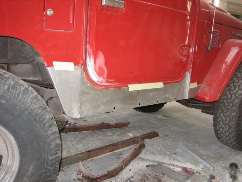

Another setback today. We cut out the rusted outer rocker panels, thinking we'd weld in the replacement panels this afternoon. Behind the rockers is another piece of sheet metal with a lip, which appears to be part of the tub or at least attached to the tub. Hard to describe. The rocker butts up against it. and is partially stabilized by the lip. On the rustbucket, these pieces are completely rotted out. We'll have to order custom fabbed replacement pieces from Real Steel. No more work until we get those in hand. Dammit! :censor::mad:
Pics of what we thought would be welded up and primed today.:frown:
I know behind the rocker are three little pieces that are tack welded to the rocker panel and the bottom of the floor, one on each end and one in the middle. They are tack welded to the floor pan also.These can be little bas*&#d's to get out of the way before the panel can come off.....
Yep, that's exactly what I'm talking about. On my '82, it's one long piece rather than 3 little pieces. It looks like Toyota designed that piece specifically to capture mud and water. On the PS, it's about 50% rotted away. On the DS, it's almost completely gone.

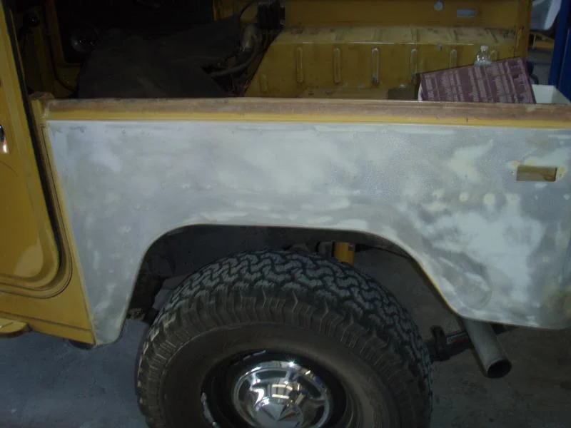

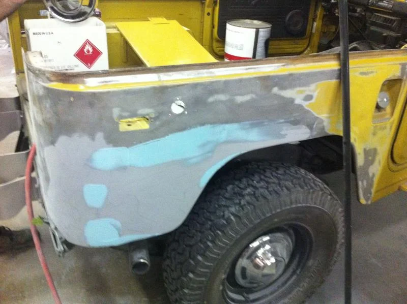

He's in his final rub, says he wants to make sure that the rivet lines show through so he is applying a light colored layer of filler so he can see the rub out. Was hoping to find it in primer today but maybe tomorrow. I'm no longer holding my breath.
