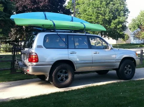

I was going to attach a picture with the mall in the background but I liked this one better
