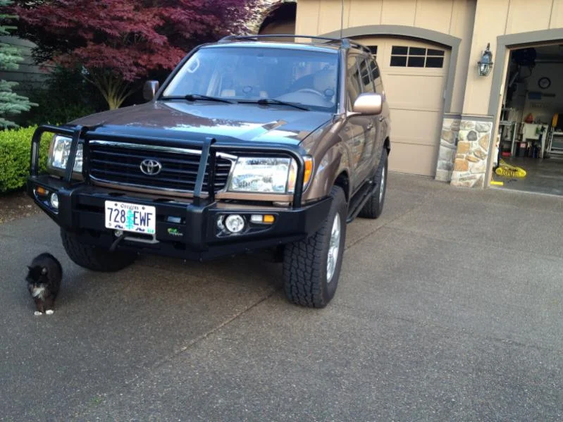

Susp lift, body lift, TC UCAs, wheel spacers, cut pinch weld, and probs some others that I'm forgetting.
He hasn't done all of those yet, but most of them. Doing all of those (plus whatever I forgot) minimizes rubbing
Looks awesome. Which mods did you need to do to squeeze those bad boys in there?
Thanks brother! Well to answer your question, I've got a Slee heavy setup all the way around with remote resivoirs, Metal Tech lower and upper links, Total Choas UCA's....in the garage I've got Nitro 4.88 gears, ARB front and rear lockers, Marlin Crawler gears for the transfer case and Fishie is right; I need to get some 1" spacers and cut the pinch weld. Also, I need sway bar link extensions from Man-a-Fre or somewhere and upgrade my brakes.

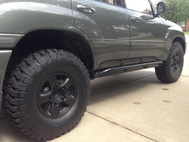

Here ya go....

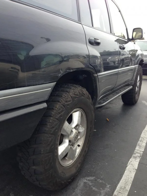

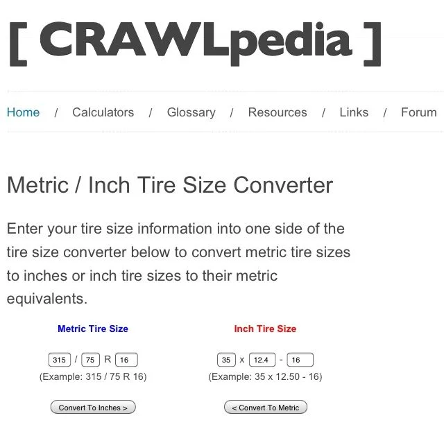

Tall and skinny-ish 35. Blackbird. LX570.
I looked into the Nittos but they would've taken too long to get here. Great looking rig!
