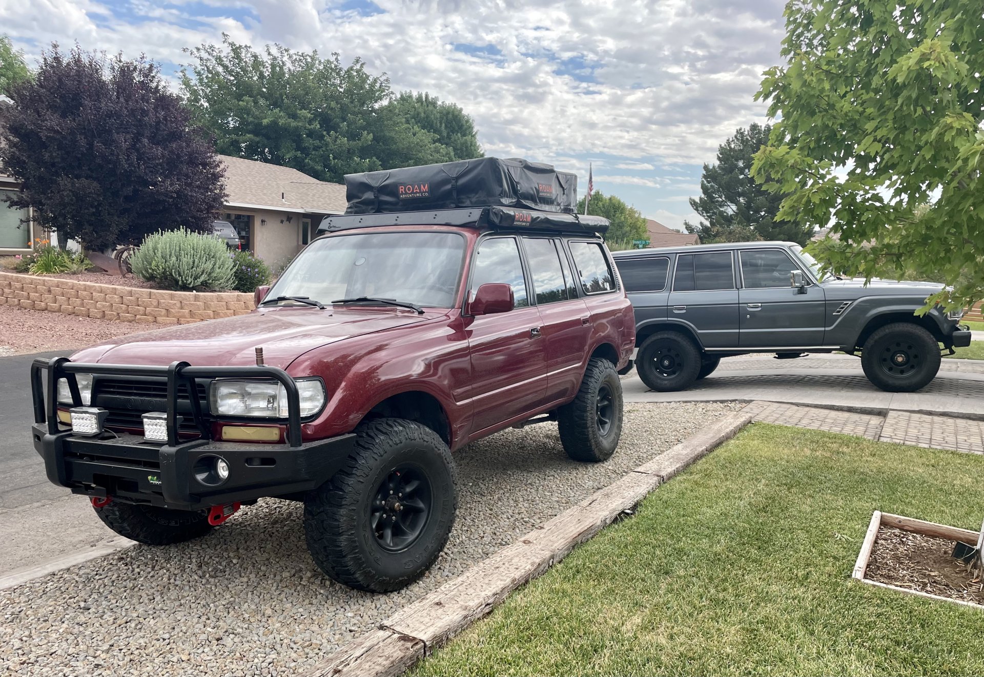

P.S. I am pretty sure I saw that sexy 60 series monday on Brigham road. Good looking rig!!!!

I wish that 60 was mine! It's my buddies DD. He gets alot of looks for sure. Are you in Saint George?
