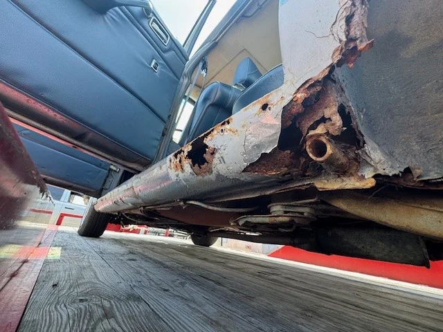

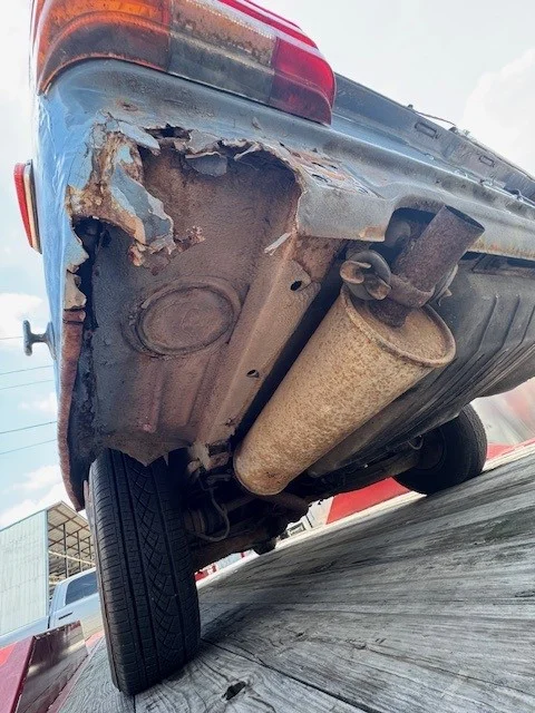

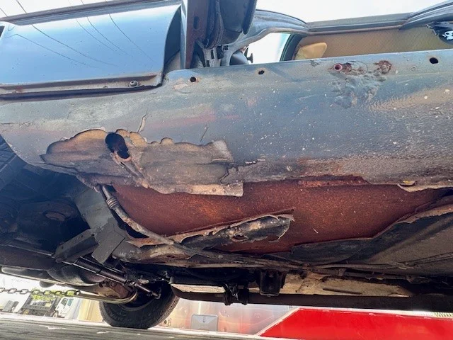

Unfortunately, mine runs great. My issue is mother nature.
DOOOOOD 😲
