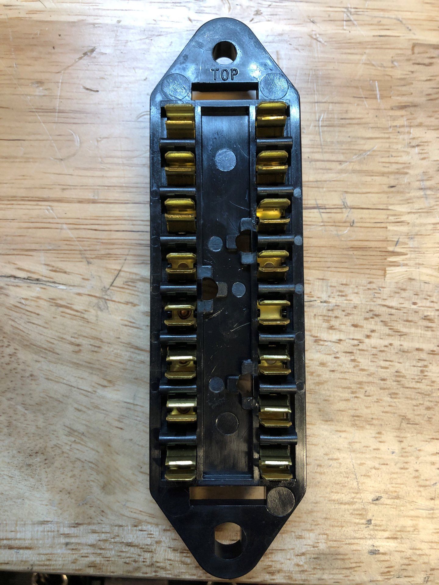

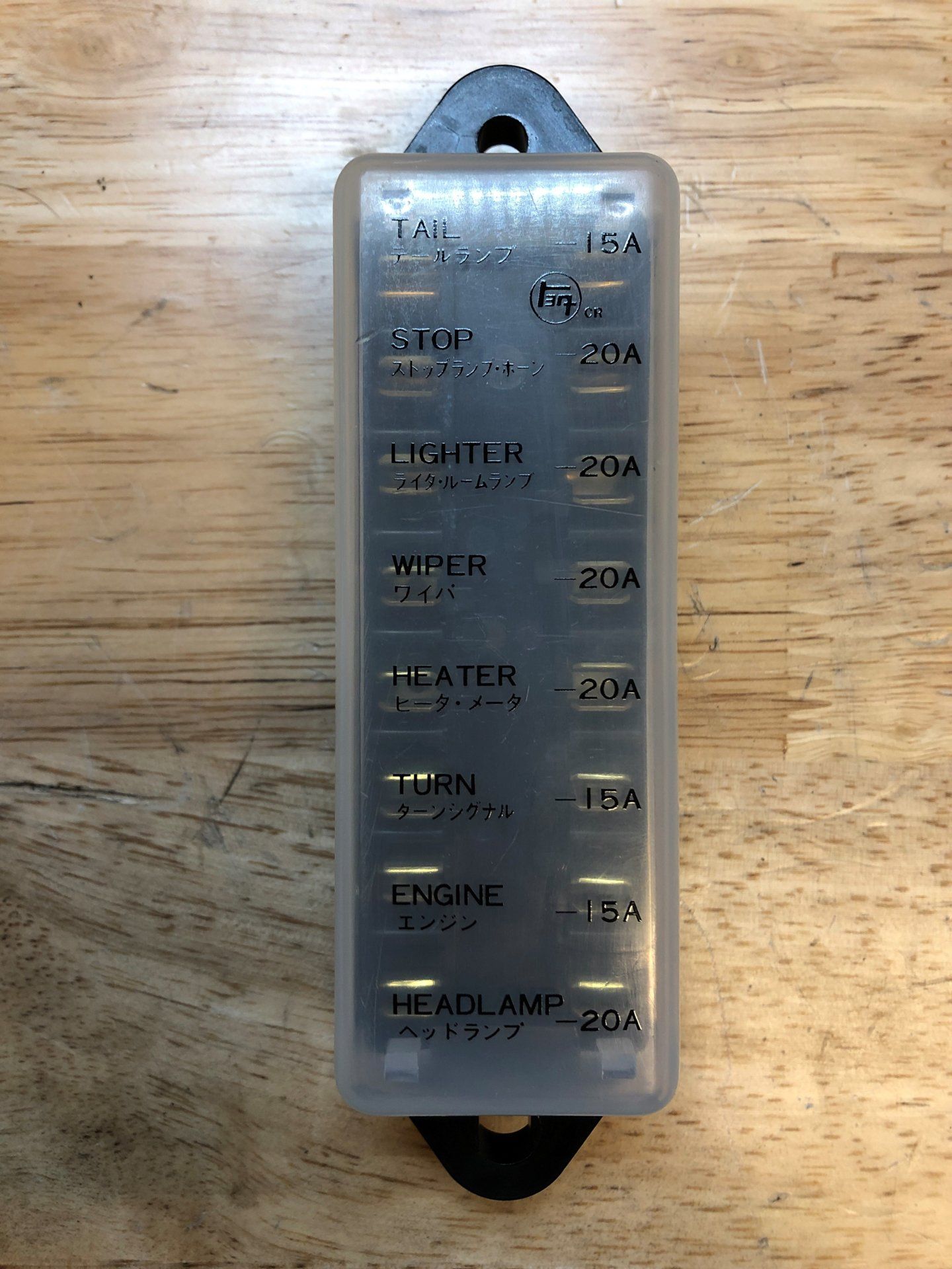

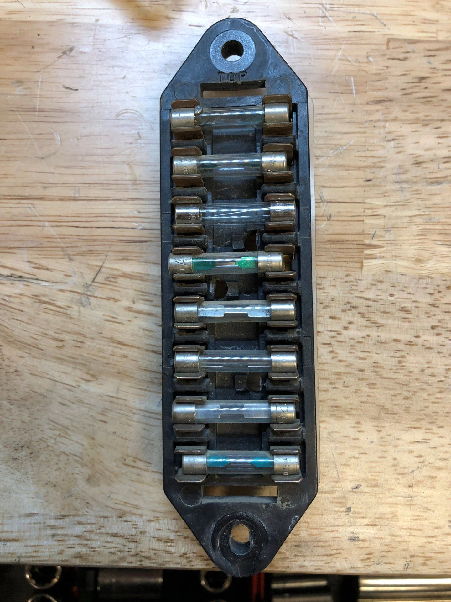

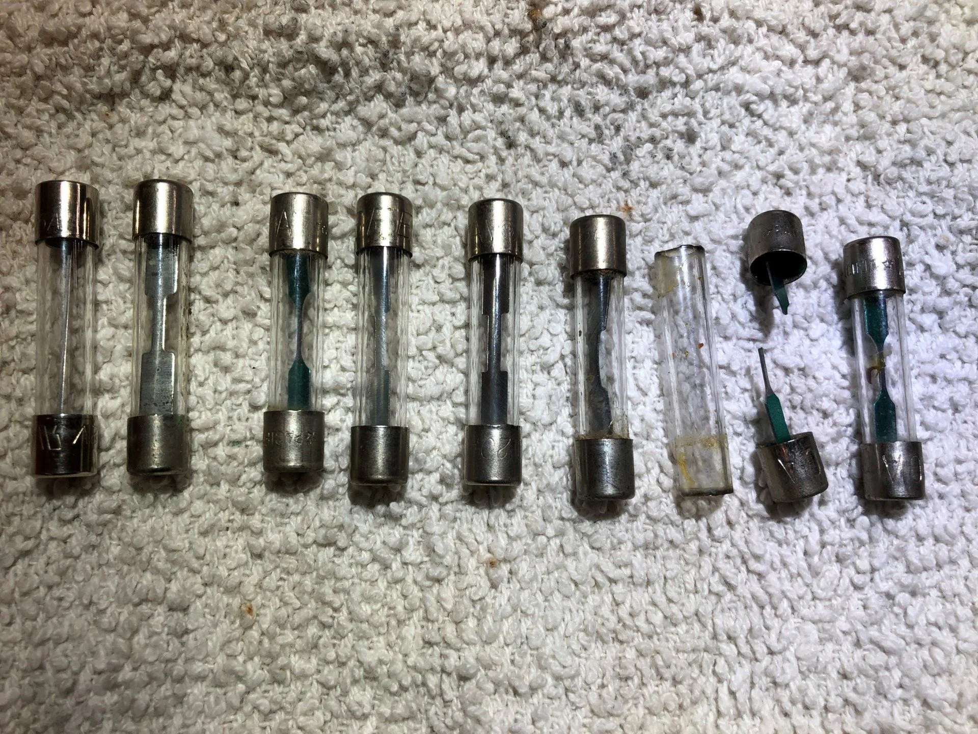

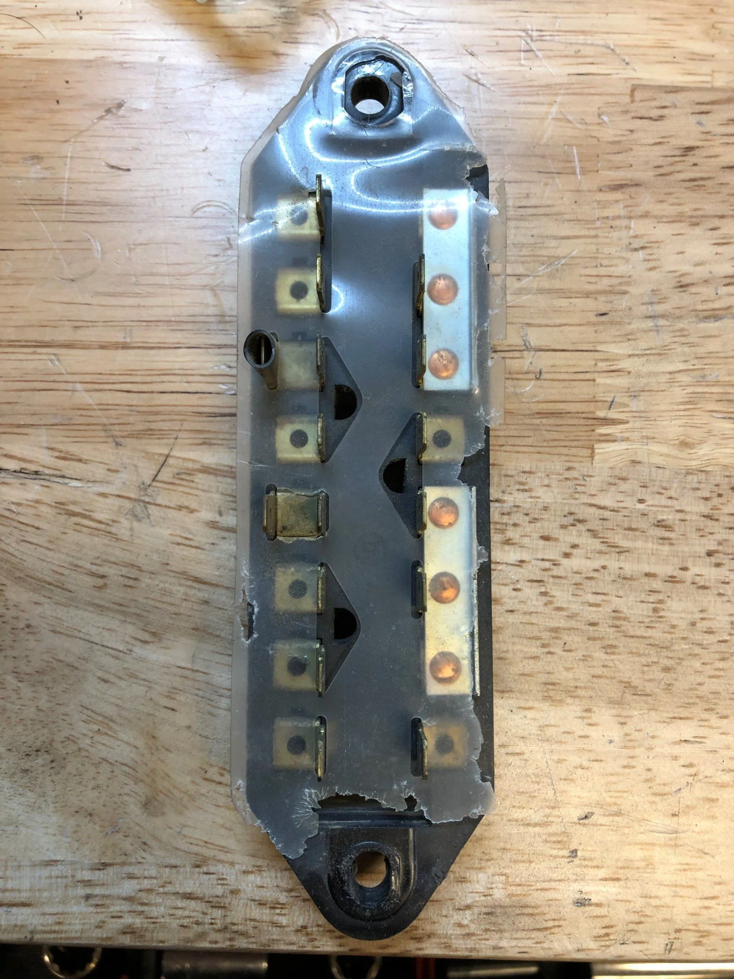

I ordered a new fuse box from City Racer a few weeks ago. Mainly because I didn't have the elusive fuse box cover, but also because I felt like it wouldn't be a bad idea to address it BEFORE it became a problem. I'm pretty glad I did too!
Old fuse box -
It was honestly in pretty okay condition considering it's age... the fuses, not so much....
Many were the wrong amperage, one fell apart completely, a few were pretty badly corroded inside and out and the one on the far right had something floating around inside of it??
I installed the new fuse box in a few minutes with new fuses and double checked that all of the items worked after replacement. All told, it took about 15 minutes and leaves one less item to fail due to old age.

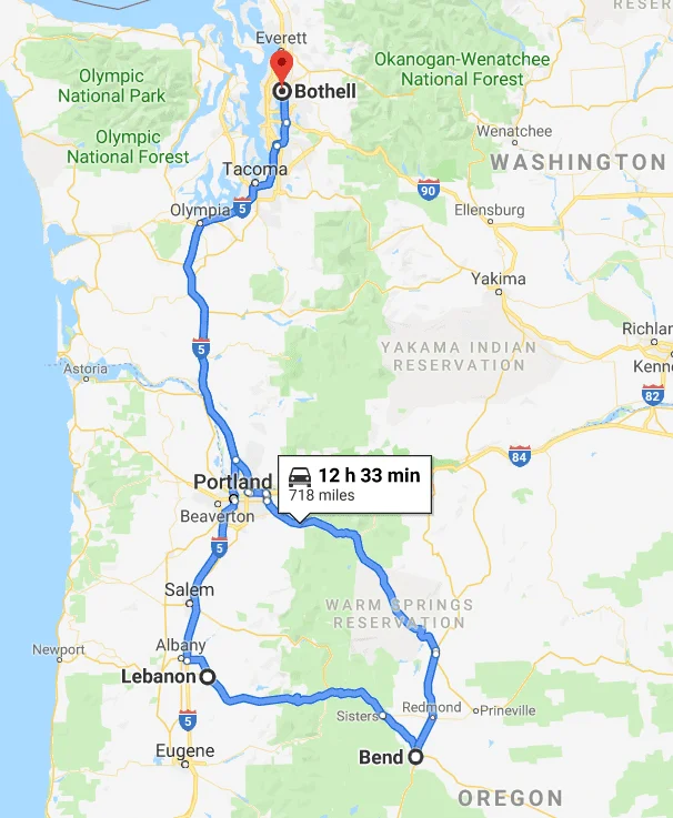

I'll be taking a trip to Bend Oregon here in a few weeks for work and I plan on driving Scout down there. It will be a round about way totaling just over 700 miles. Here is a rough estimate of my route.
I may try and find some alternate roads to avoid some of the freeway. If you have any ideas on great alternates, let me know!
