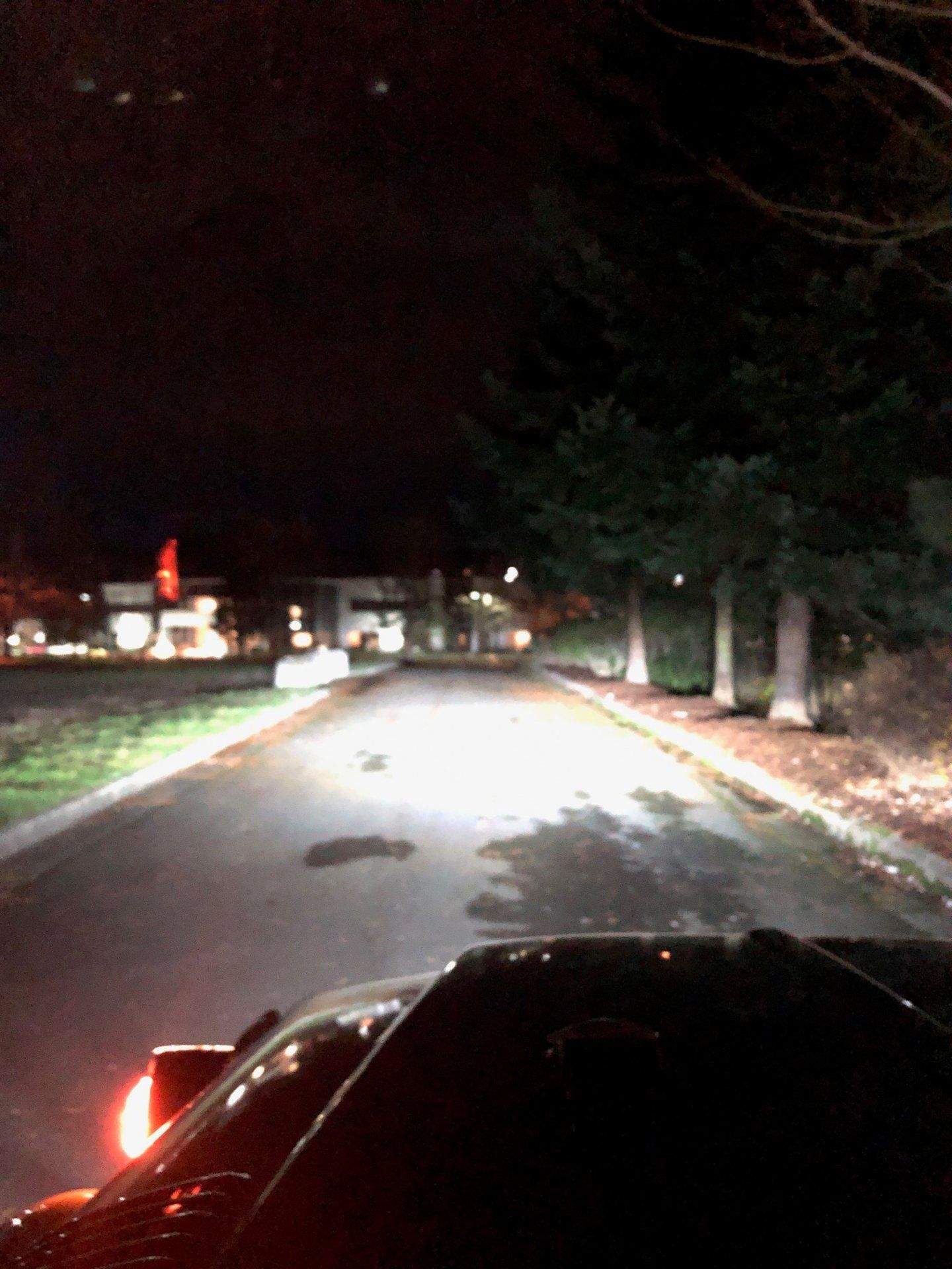

Pictures of the lights, take 1, as I'm loading these pictures up right now and see them on my computer screen vs. my phone I can tell they look like crap, I am going to take some more pictures tonight perhaps.
Headlights only: (E code Hellas with inexpensive LED H4 bulbs from Amazon and dedicated circuit)
Compared to stock halogen sealed beam headlights, these things are like taking a chunk of the sun and strapping it to the front of my rig. I don't know how anyone drives with the old sealed beam headlights in these rigs. With the weather we get here in the PNW and the rain, I just see that as dangerous. Besides being about 3 or 4 times brighter, the pattern is much more usable. See below, the non-E Code headlights on the left just toss out a blob of light but more importantly, it's all concentrated up high. The E Code headlights have a sharp cut off to avoid blinding other drivers and put more light on the road in front of you.

Headlights on high beam with KC Daylighters which automatically turn on when my high beams are selected.
I could probably stand to aim the KC lights a bit higher but have not done so yet. They are so incredibly bright that if I turn them on when I'm driving the power of the lights pushing forward slows my vehicle down and I have to downshift. (not really but they are super bright)

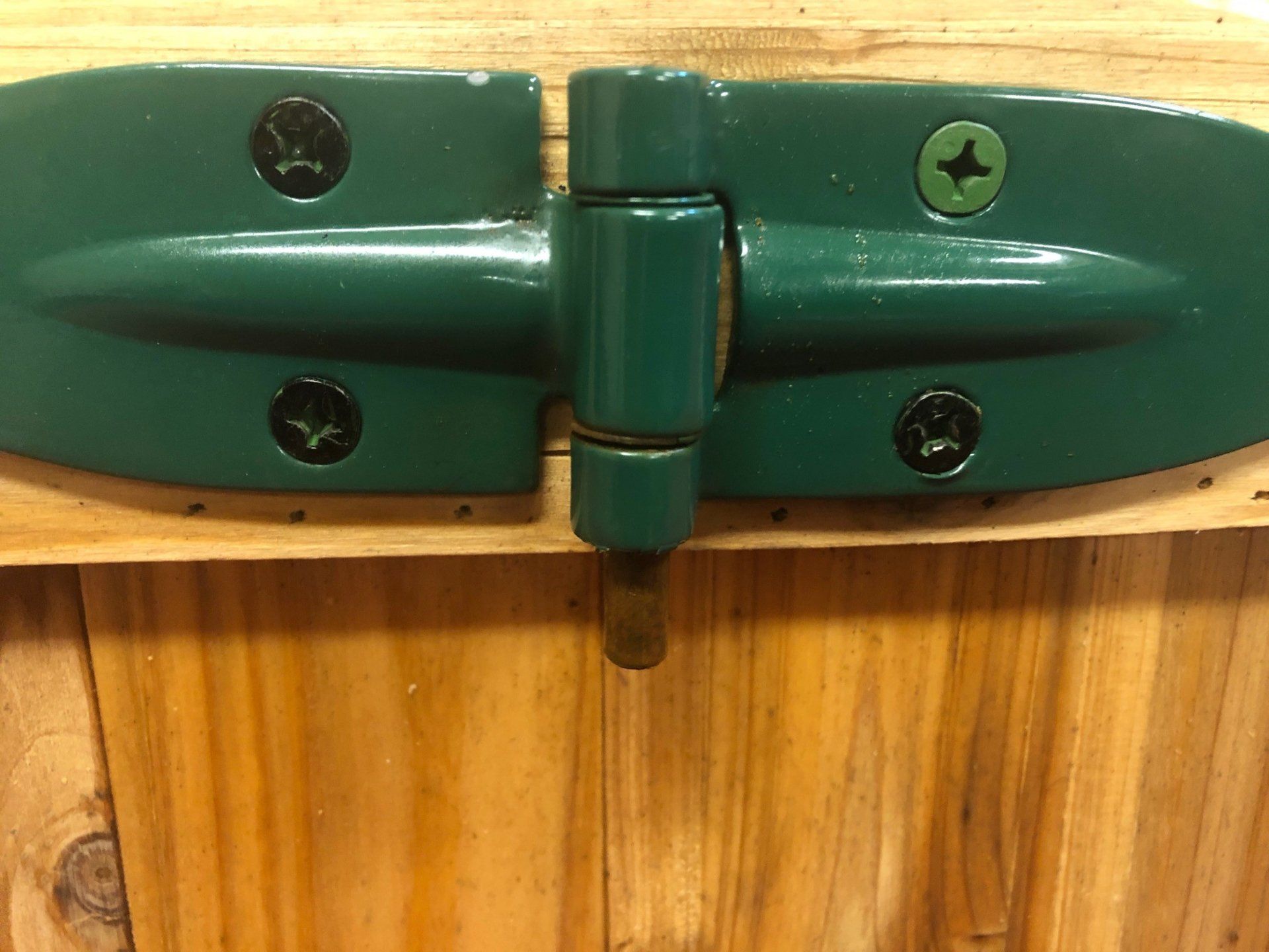

One thing that bothered me from day one is the fact that the hood rattles super loudly when I go over even the slightest bump. I felt the hood and the hinges are very worn out. I just picked up some of the bushing/pins that SMG sells here on Mud, I'm going to install those to see if I can make the ride a bit quieter. Everything else is super tight now so I figure $70 for something that makes the ride more enjoyable is money well spent. Plus it means I get to buy an air hammer to install them! :) More soon.
In anticipation of receiving my new @SMG hood hinge pin/bushing replacements I removed one of the hinges and did my best to remove the pin using a hammer and punch.
Well, the hand held hammer and punch method yielded absolutely zero movement after hitting it well over 50 times, pretty hard with a 3lb sledge! Not a single millimeter. SMG suggested an air hammer which I also saw on @wngrog write up, I own zero air hammers. So when the dude from Amazon rang my door bell I was anxious to try out my new toy.
I'd already mounted the hinge on a piece of wood to secure it which worked pretty well. To my amazement, the pin literally slid out like butter after just a half second of the air hammer. BRAAAP. pin out. The moral of this story is to use the right tool for the job. The air hammer was cheap, it was delivered the next day and it worked like magic.
Had it not been for SMG and wngrog I'd have wasted lots of time, become frustrated and probably damaged my hinge. thanks guys, that's what this site is all about!!
