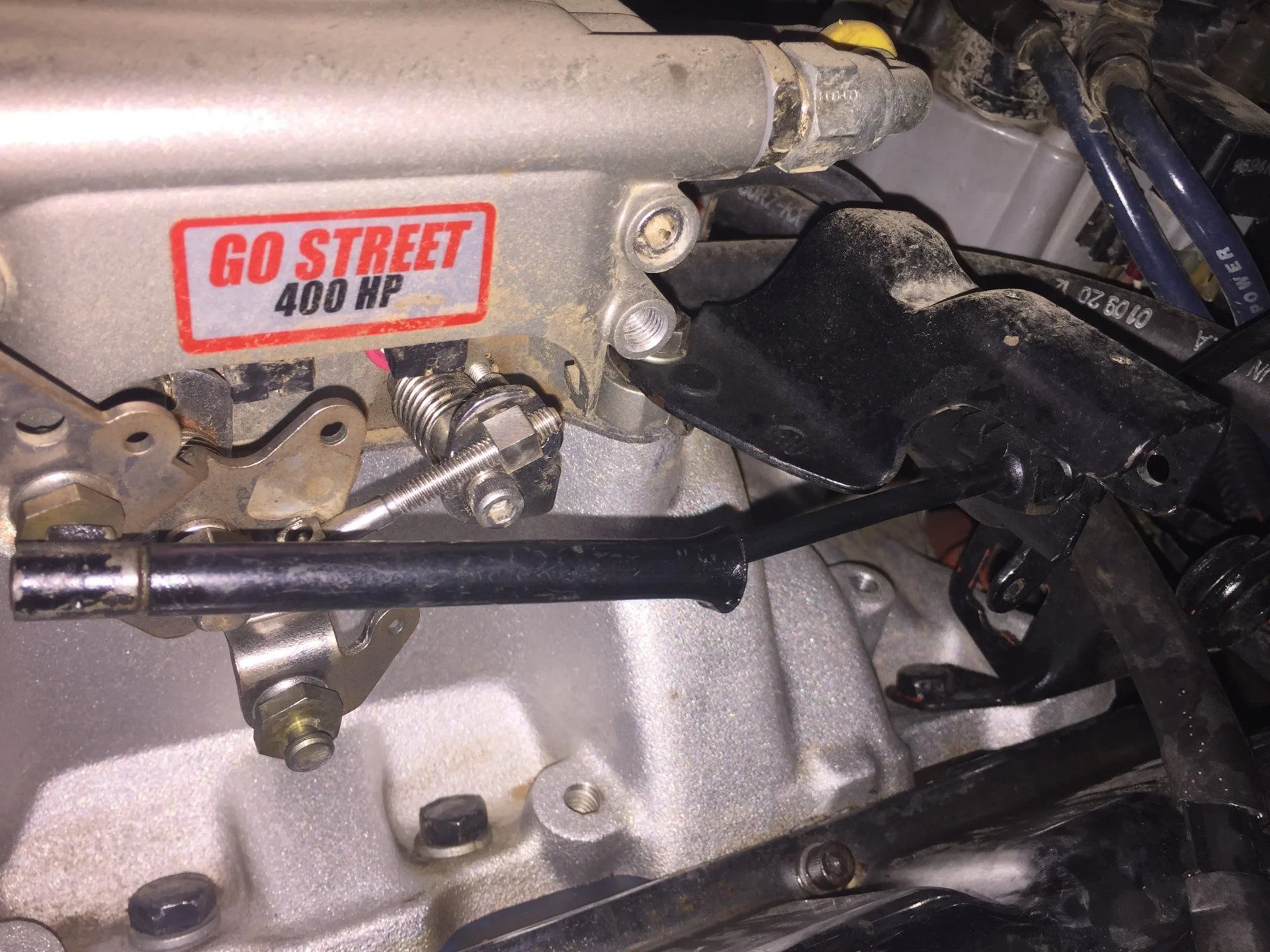

loiking for ideas in throttle cable on my SBC with FITech. Love the set up but the routing for cable is not optimal and she is getting a bit sticky off idle. Really noticed at 'crawl last weekend. I can pull her and soak it, or put a new cable in. What are you others using?

IMHO, if you tweak the angle on the bracket to make it closer to a straight pull it would work better.

Thanks. Did you tweak at the base or closer to where the cable attaches. Thanks for the feedback.
Marc
My bracket was a little different and included a spot for the transmission kick down cable, but I did a cut and weld.
It looks like you might be able to put a spacer (nut?) under the front end of the bracket to change the angle.
Mine does a barrel roll too and adds more friction than it should. I ran it at an angle and used a stiff spring, both adding to the problem. I have a new 21 inch on order and I may try make some kind of pivot arm if its still an issue.

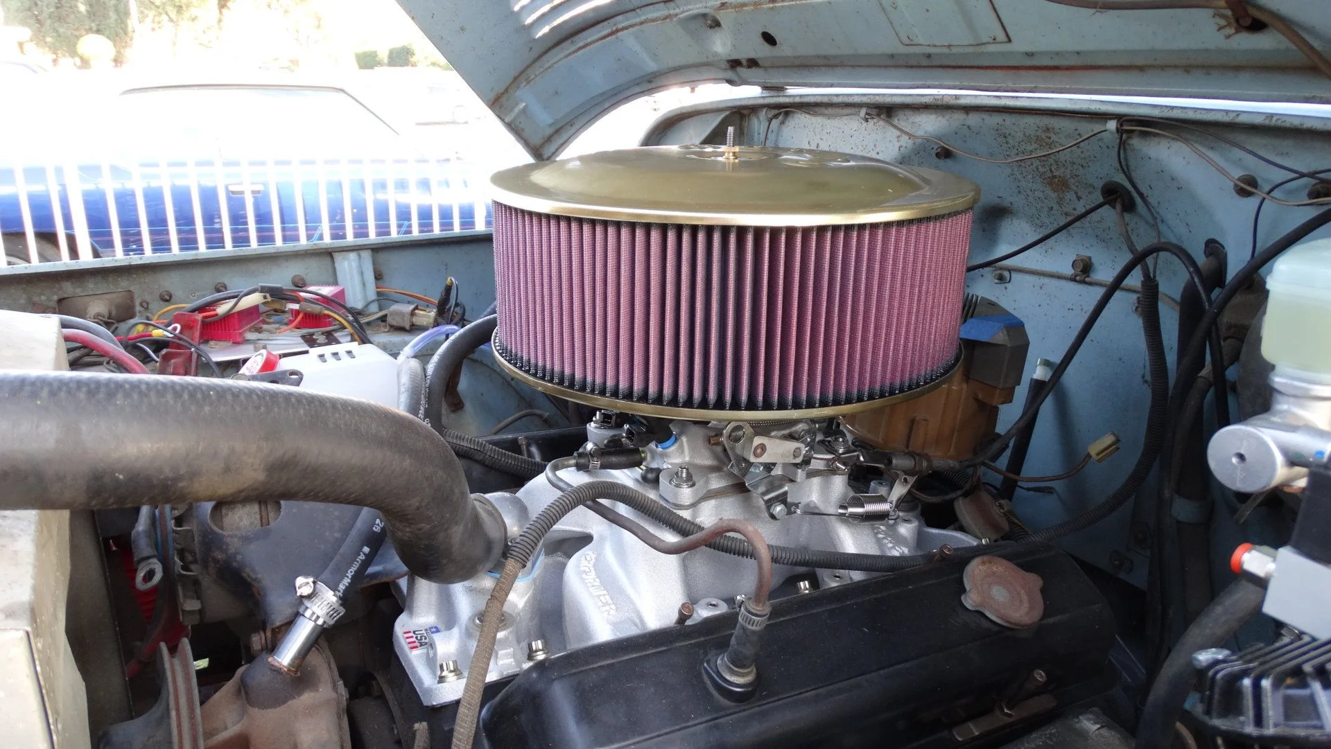

You just have to find the smoothest routing possible and keep the cable lubed. When I mounted my Edelbrock EFI I kept the factory throttle cable and made an adapter to attach it to the carb linkage.

I made a similar adapter and connected it with a Bicycle Brake cable. It may seem Getto now, but it was common place when I did my conversion in '96. It has been working great for the last 21 years. I have found that not all cables are created equal... and it pays to buy a quality one. Smooth bends should be fine... just avoid sharp bends.

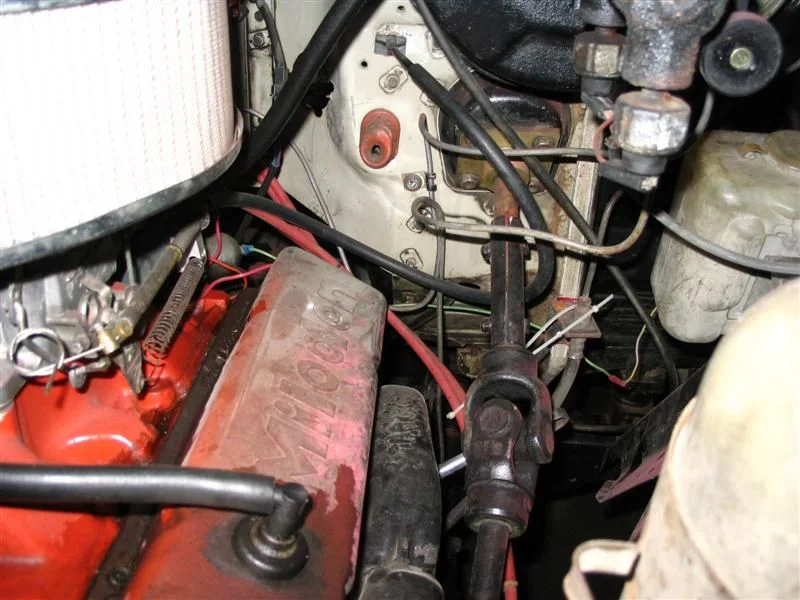

I had the same problem my fix which has worked for the past 10 years was to find a
Longer cable and make a big loop. My old one was short and would rev up when the body flexed. Wasn’t fun on off Camber situations. Old crapy pic I found from years ago.
Not pretty but it works great.
