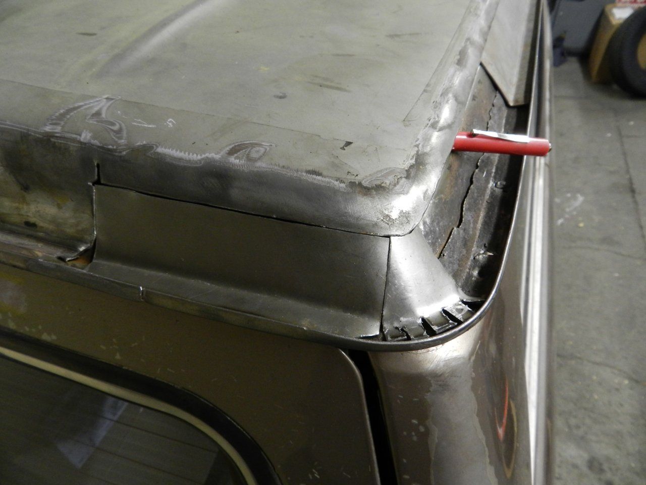

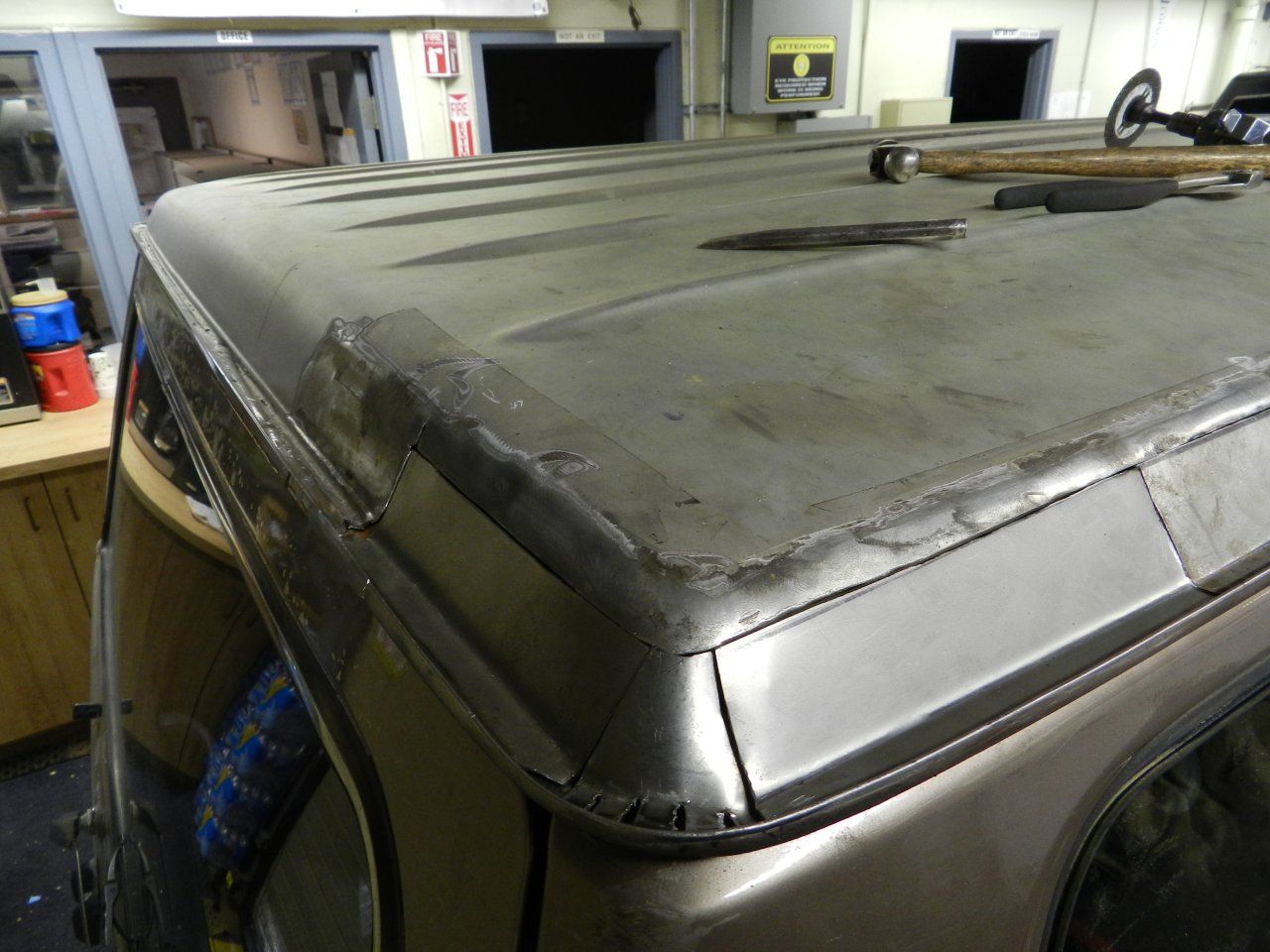

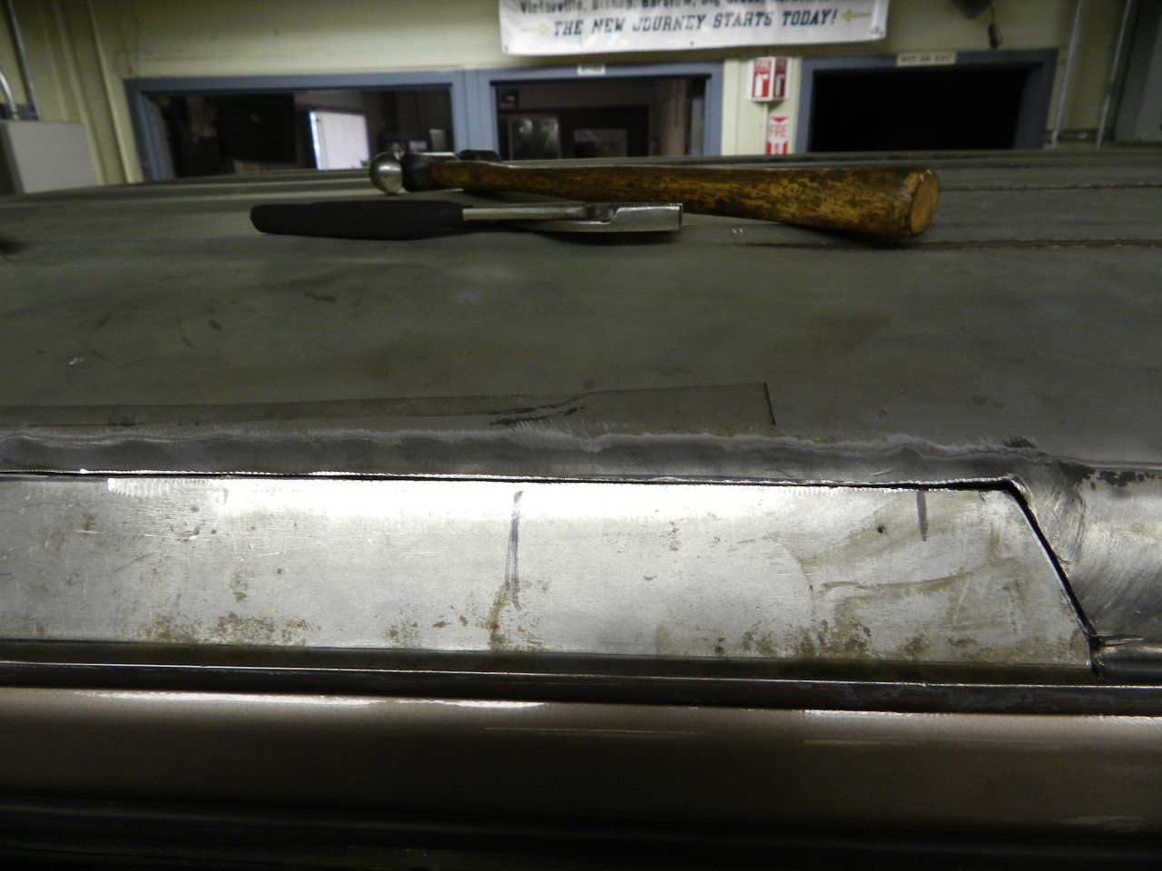

Here are the some of the patch panels I have fabricated. I will paint on Rust Encapsulator to cover the inner shell rust before moving on,and will also use weld through primer on the back side of the panels. The plan is to stitch weld the panels in place. I will post more pics as I move forward.

Thanks for looking at my thread. The piece you are referring to is called the drip rail. Here is another thread that goes into how to fabricate them. Hope this helps.

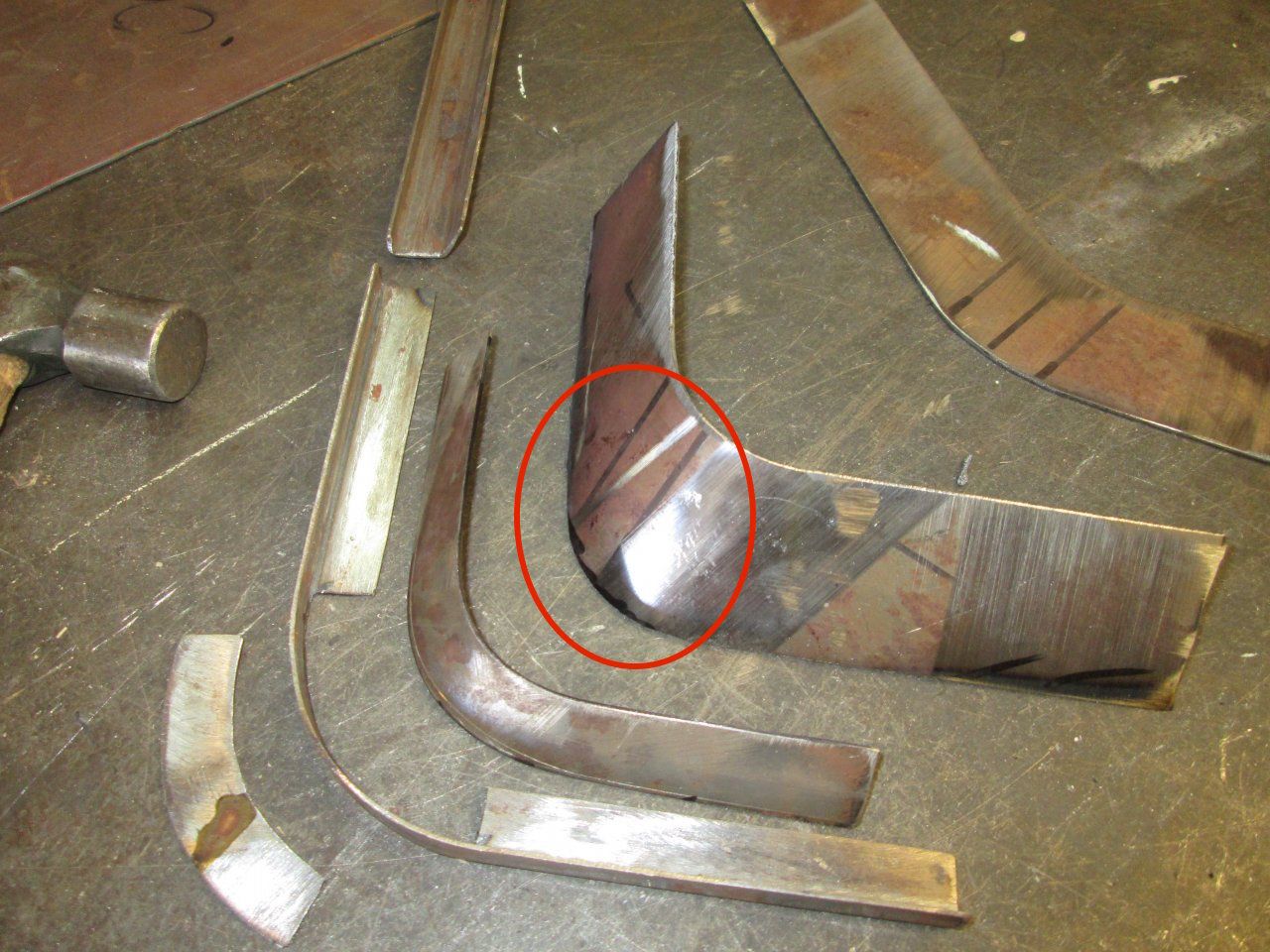

Thank you. Please allow me another attempt with more specificity.
I've circled the piece in question in the attached photo.
Its getting the nice gradual bend while allowing the bottom portion of the bend to flare a bit. Just wondering how it was created. And if there is a name for that bit of fabrication.

Maybe its more pronounced in this picture from the thread you linked.
Sorry for the delayed response. I really don't know what it is called. I just took a piece of 18g sheet metal and made relief cuts so I could form it with a hammer . I used a piece of pipe and a vise to round it out.
No problem. Thanks for the reply. It's a fix that's coming up for me and I'm just trying to figure how I might be making all the different pieces. Glad to hear it sounds like you were able to do it rather simply, like without a special metal bending device.
