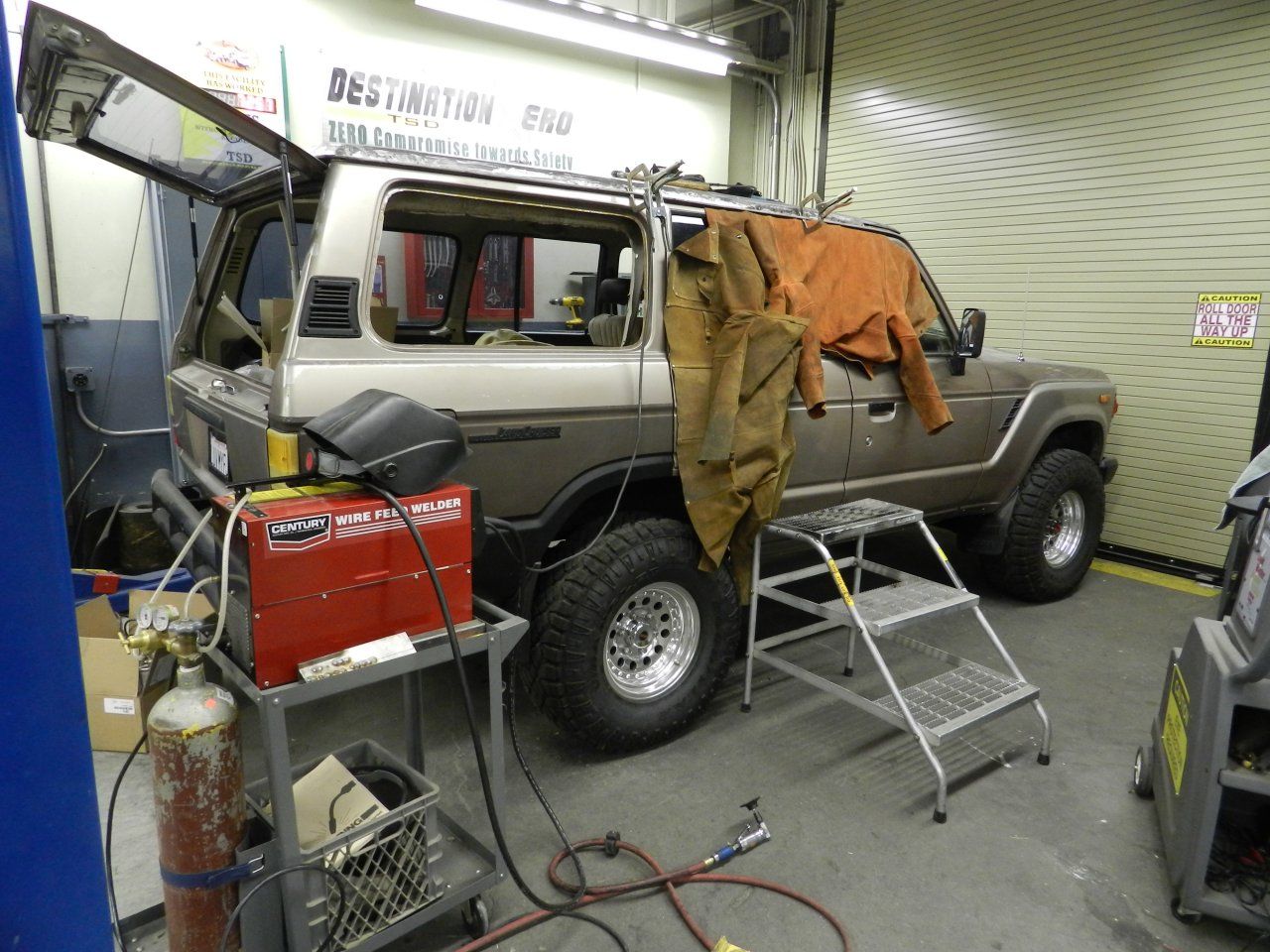

I am using my 110v mig welder for this project. It seems to be a little easier to control the heat, than my big 220v miller.

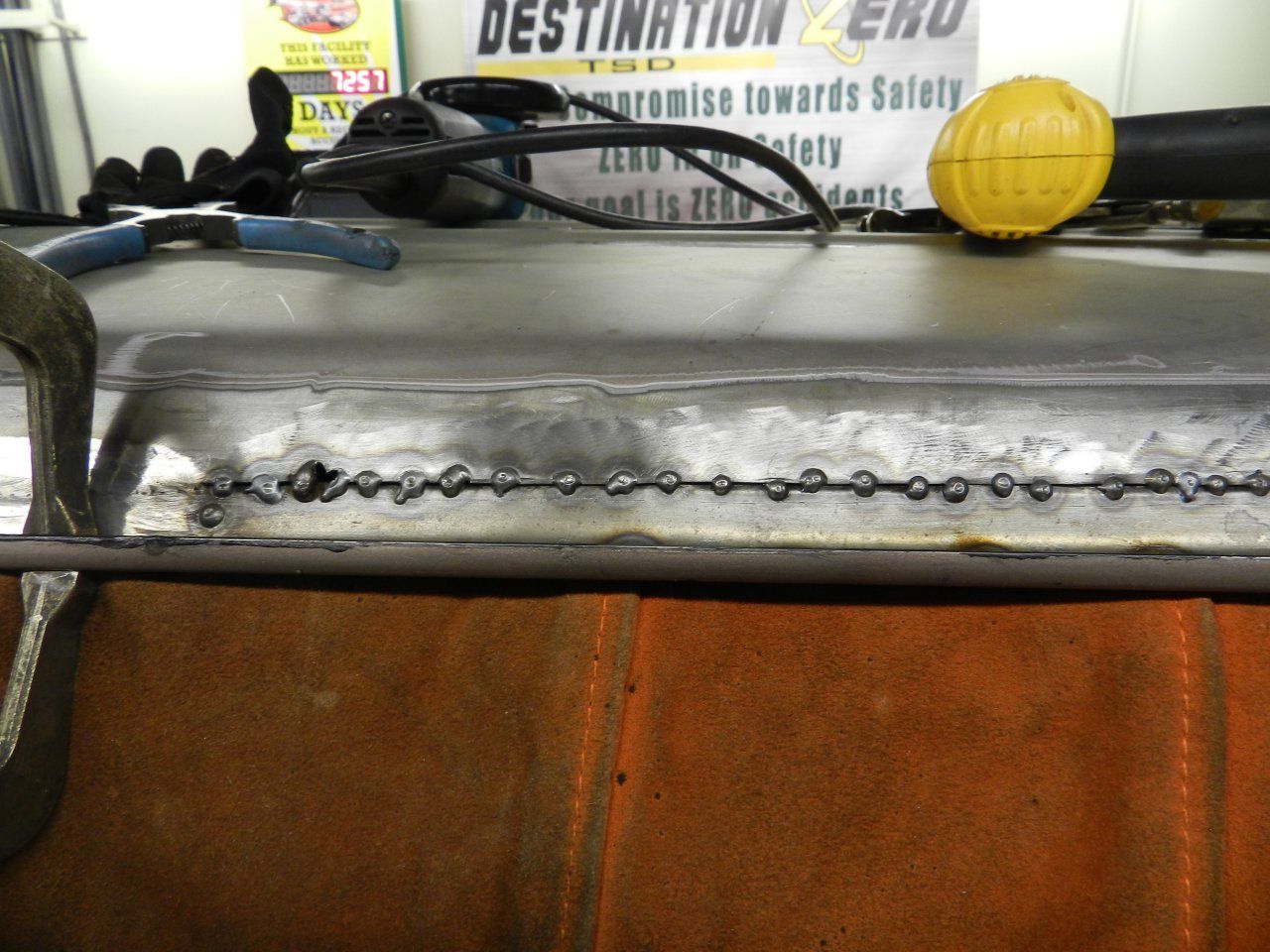

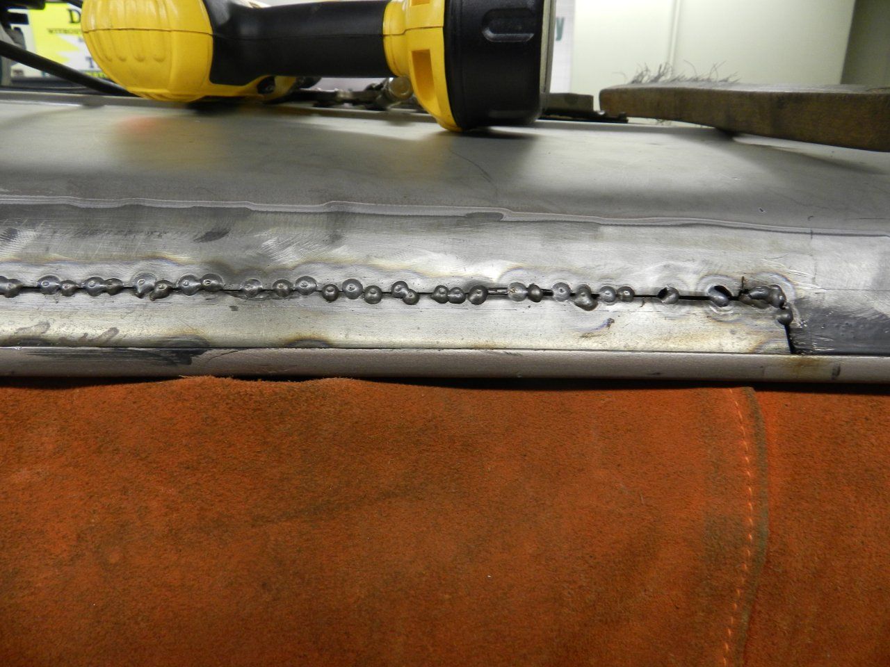

Continuing to move forward. I was concerned about burning holes in or lighting my headliner on fire, so I pulled it out of the way and stuffed a welding blanket in the crack
Now I really understand why, if you can find somebody to even do rust repair, that they charge so much. This has been very labor intensive. It will be even that much more satisfying when I am done:).

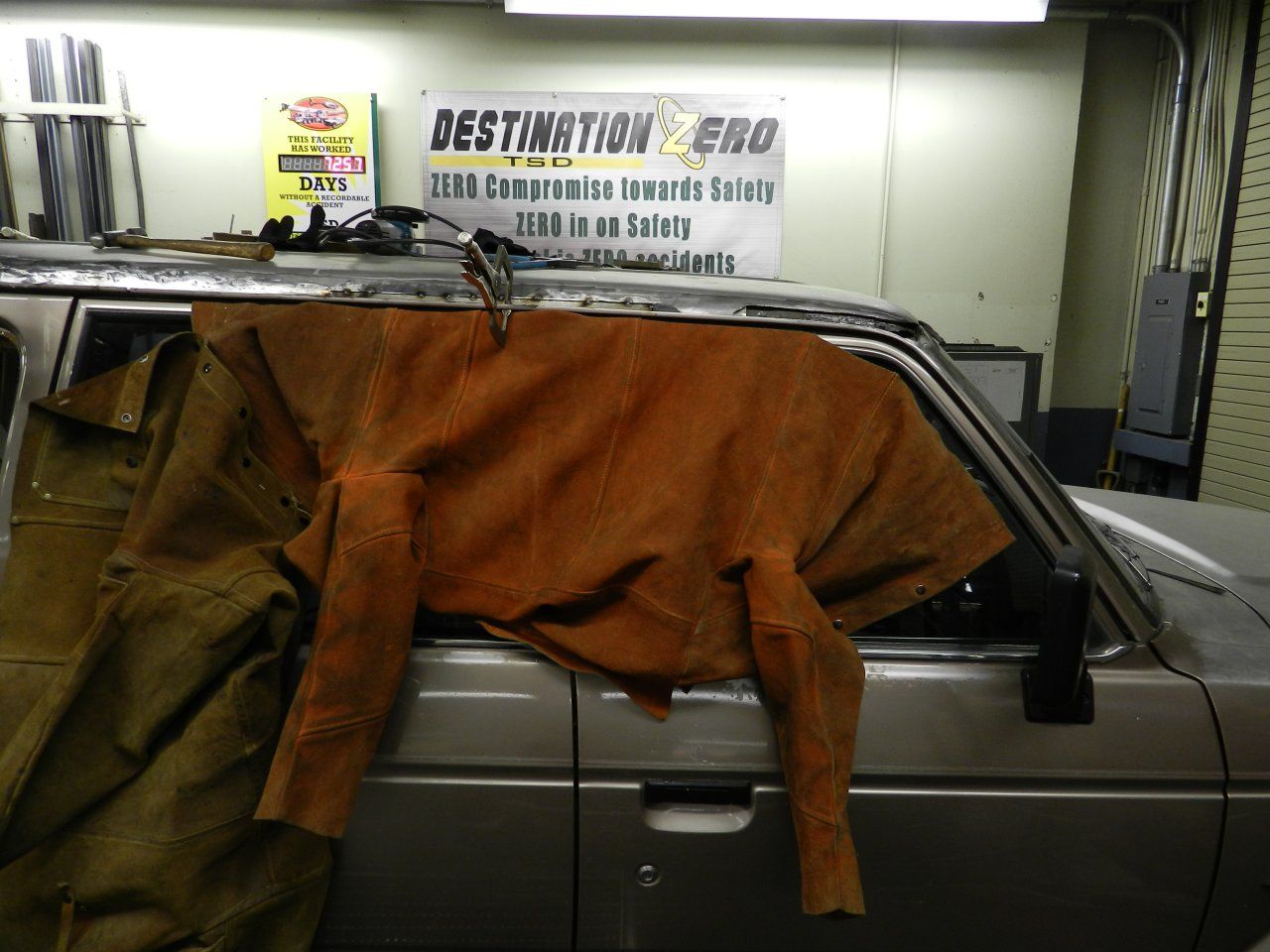

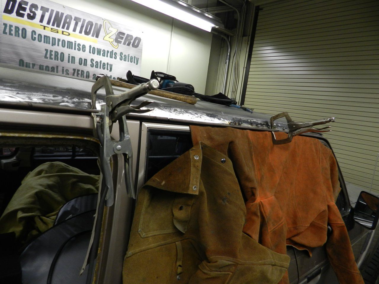

And the beat goes on!!! Trying to protect my glass and interior. Next step will be to pull the windshield and see what fun stuff I will have to fix next.
Friggen awesome use of the old suede jackets! Love it. I used a leather belt my ex's mom bought him that was too small a while back as a strap in some chore. It gave me great pleasure to make a mess out of it. ;)
