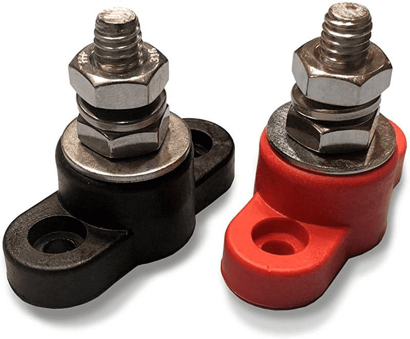

Questions regarding your electrical clean up.
Did you tie all of your positive leads to that red clamp thingy and then go from there with one single power lead to the positive battery terminal? I have a big mess of wires I need to tidy up and what you’ve done here is really nice.
What is that device that the single red cable is coming out of, the one with the little blue thing near it.
Where did you get the little quick release wheel for the battery terminal. I live in Oakland right on the edge of the hood and I disconnect my negative lead regularly as part of my anti theft shut down process. I don’t daily my rig (until I get a V8). Sucks as I have to re-program my radio all the time.

I never saw this question, so I am sorry I didn't reply. Yes I tied all positives to the red lug and ran one cable to the battery. The device with the blue button is a resettable circuit breaker for my winch.

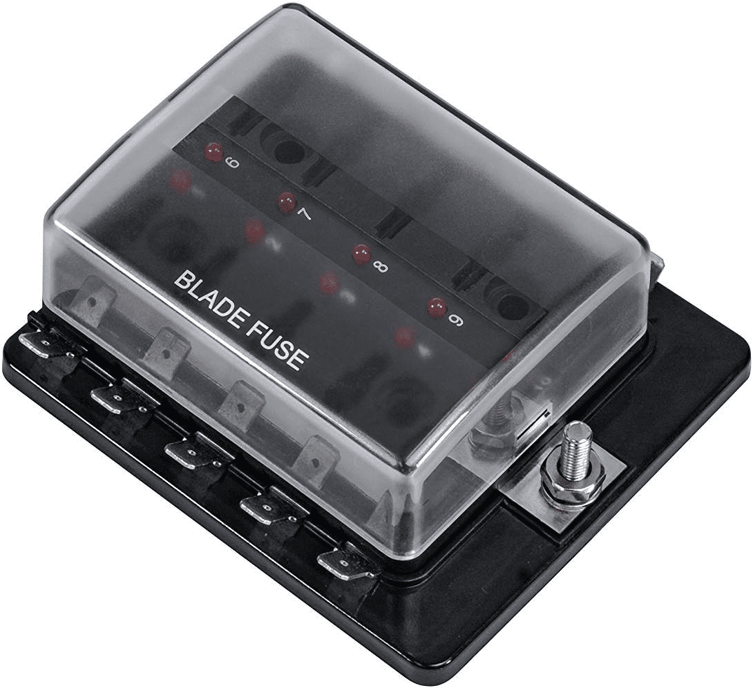

Do you run all of your AUX power needs through that little "Blade Fuse" box? I need to do that too. I've got some clean up to do.
Yes I do. I got the box on Amazon also. Type in, fused power distribution block. I live in a very rural area, so shopping is limited, hence the Amazon purchases.

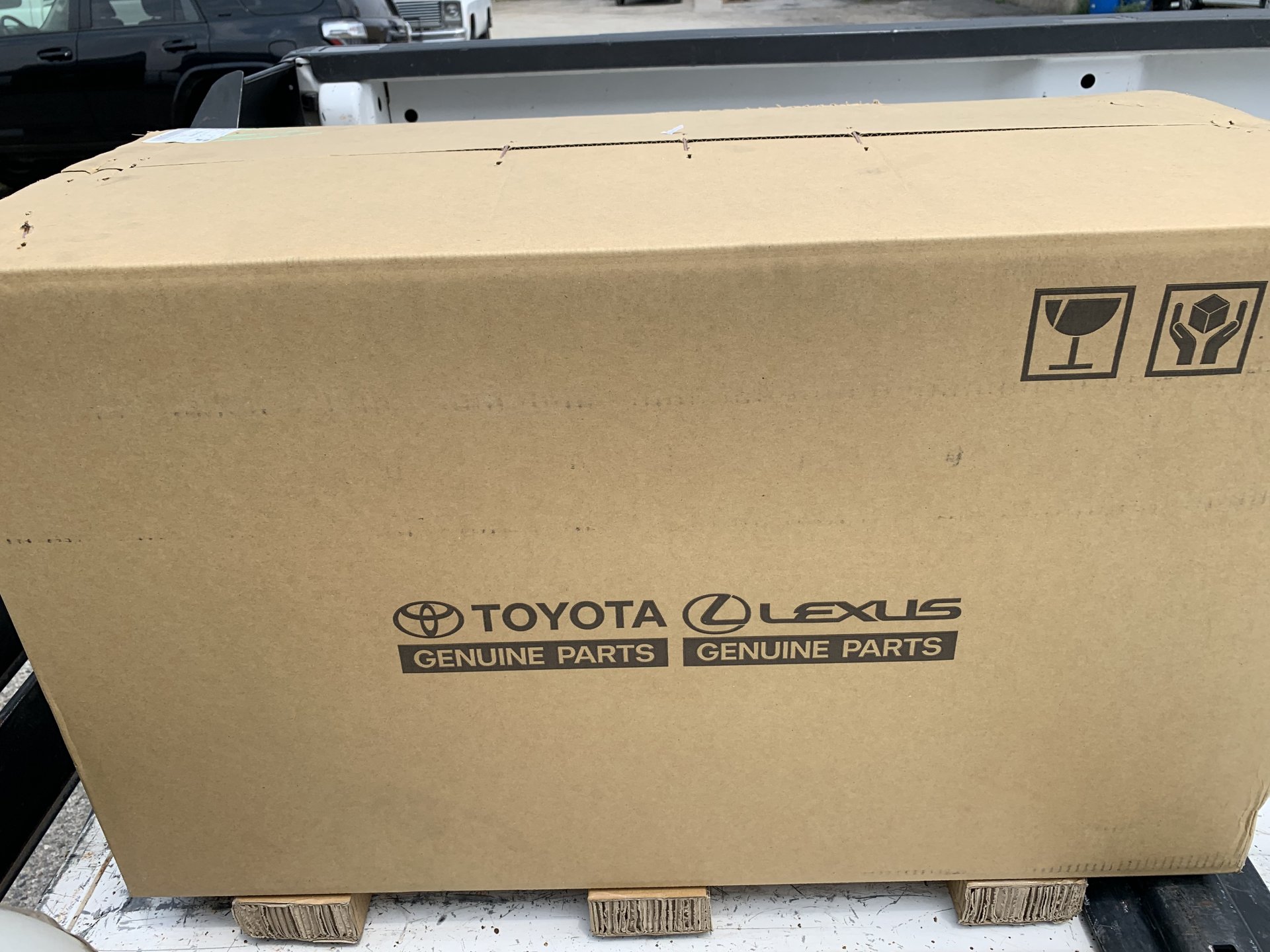

Well it's been two years since I have posted to this thread, so I guess it's time to get busy. I've been driving my cruiser for close to six years now and I think it's time for a major upgrade. Can anyone guess what's in the box?😁😁😁😁.I Will document as much as I can during the process. I know it's been done by a lot of people so I won't bore you with all the tiny details. Just pics And I will try and answer any questions that might come up during the swap.
1FZ short block?
How much did it cost you out the door and where did you get it if you don't mind sharing.
I got it from my local Toyota dealer. With the shifter and Ca. tax, 🤬,$3051. I simply asked what's the best he could do and we had a deal😁.
