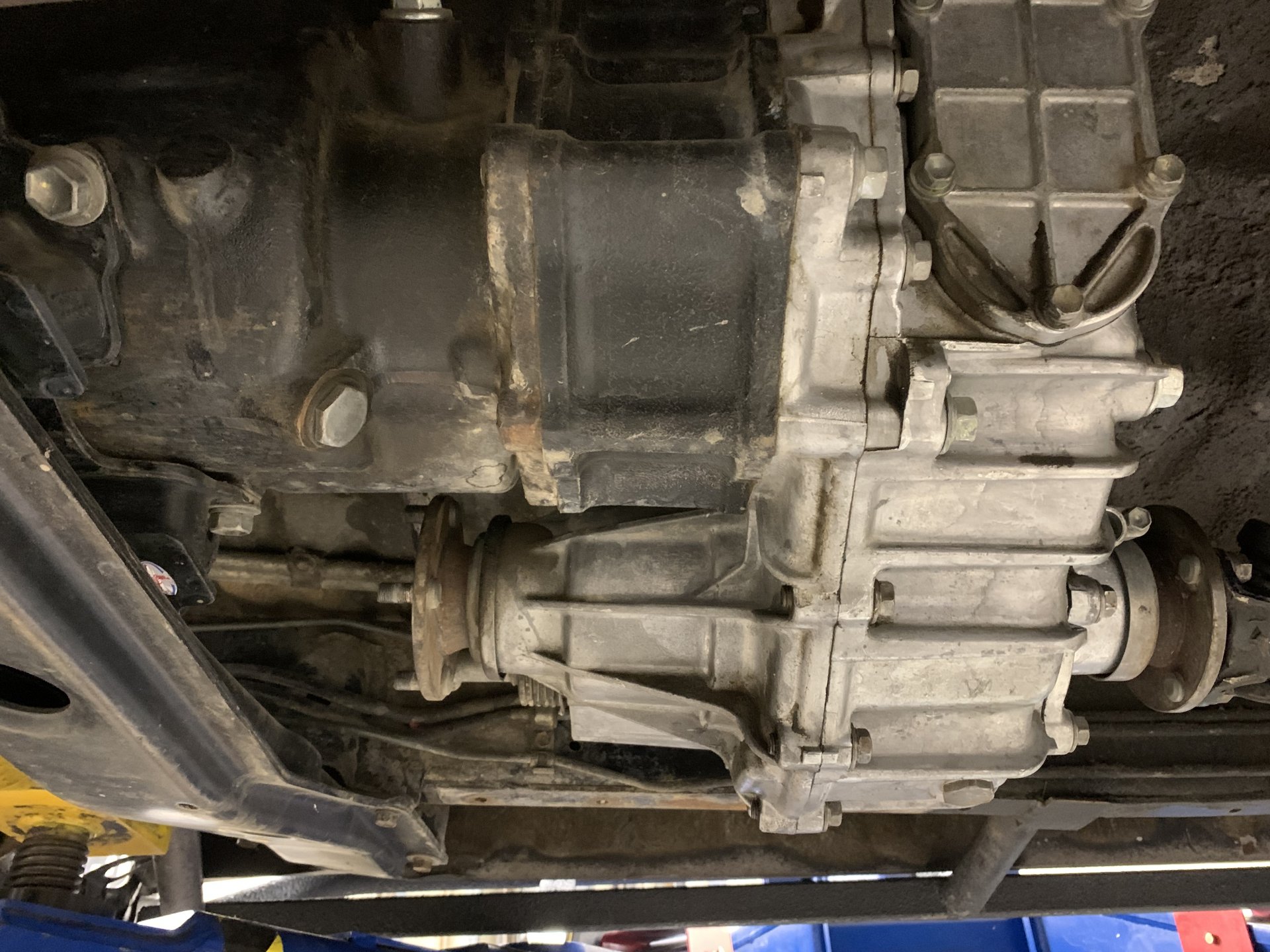

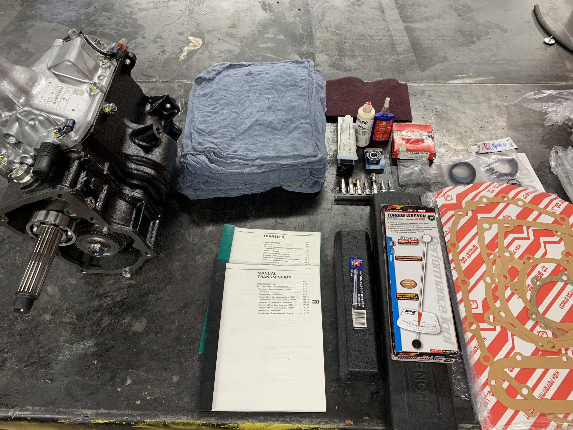

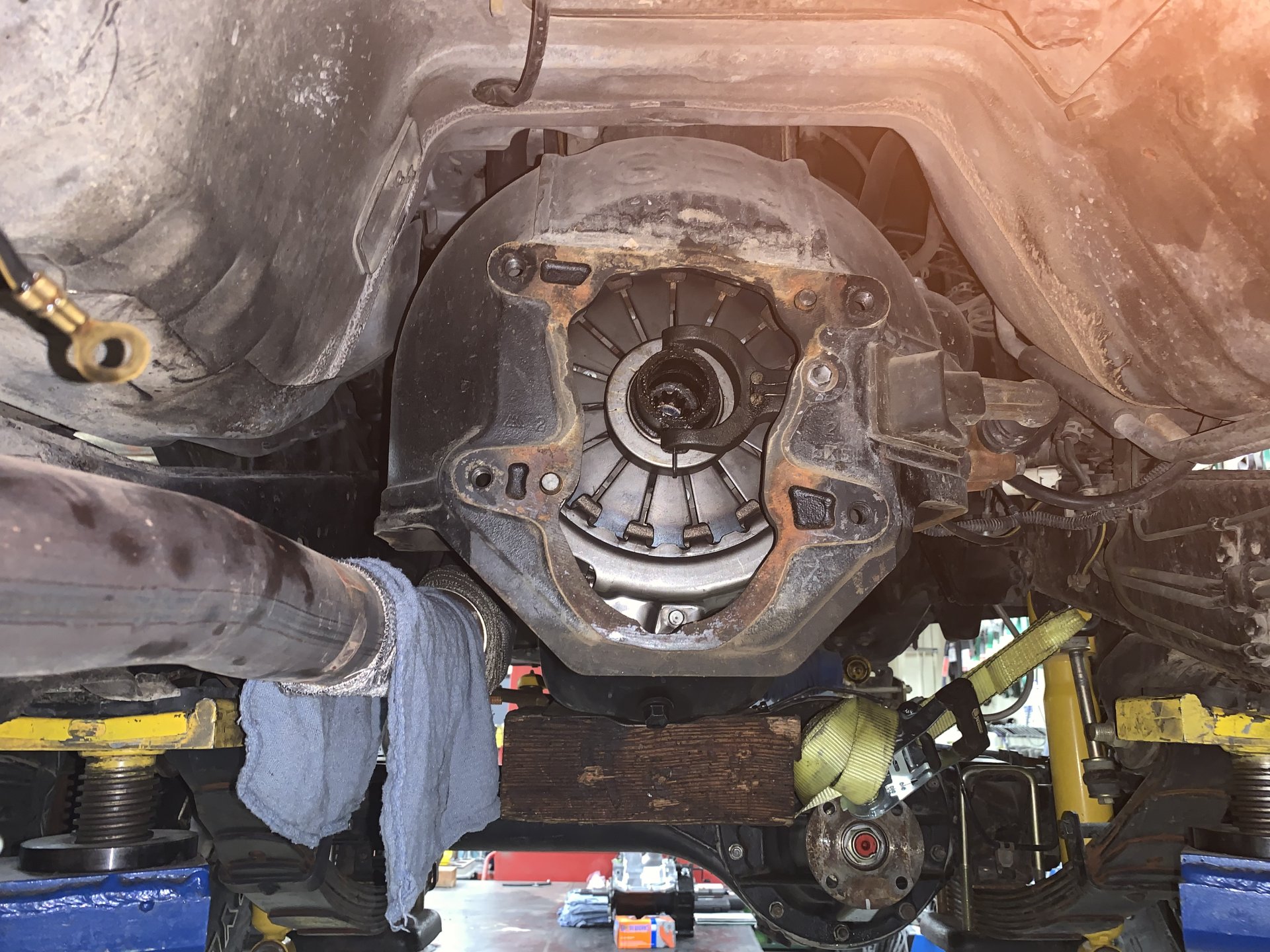

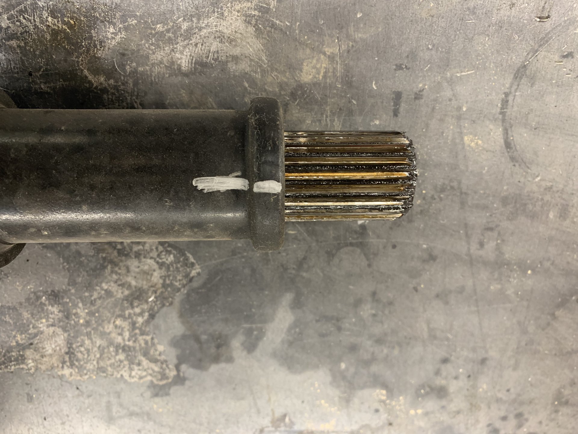

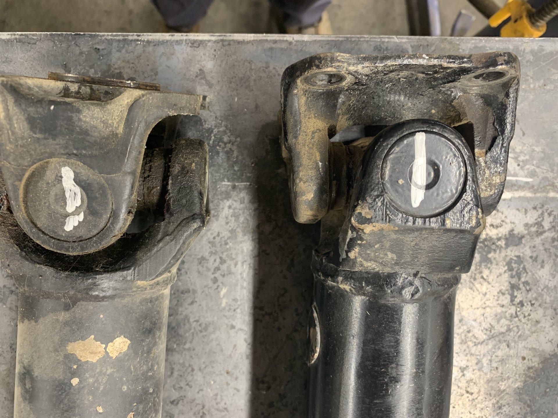

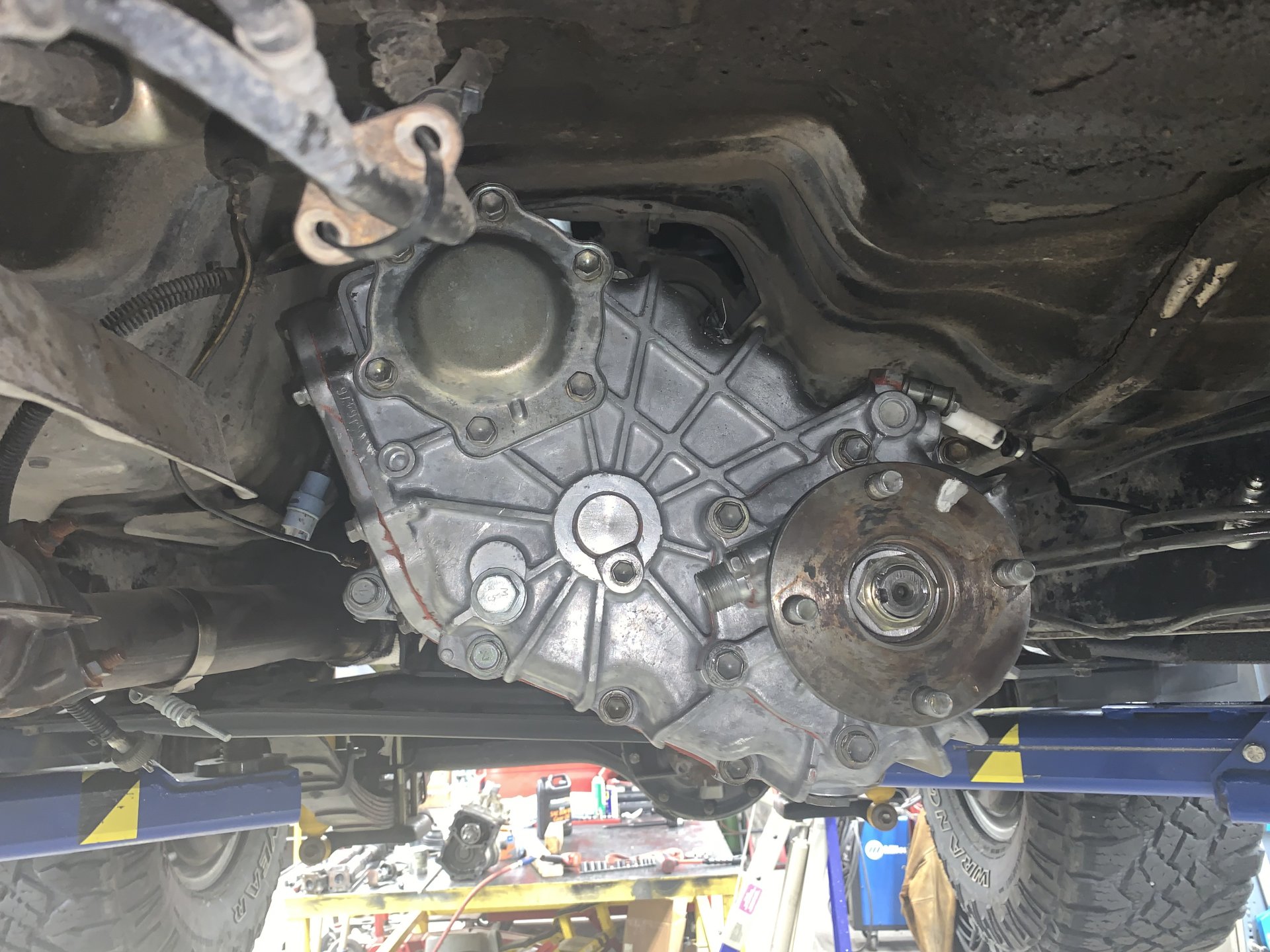

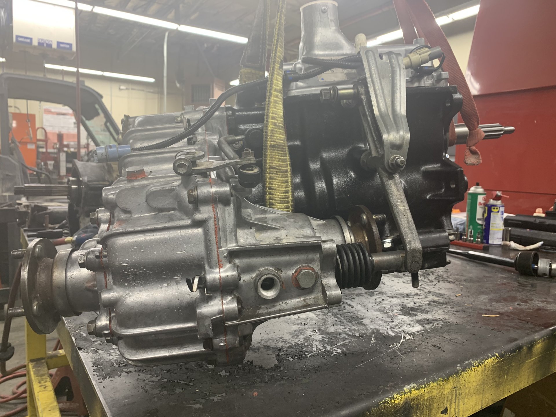

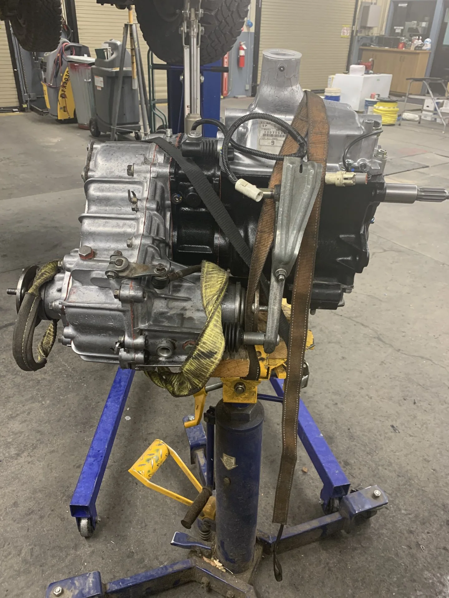

Well today went fairly well. As always double the time you think things are going to take 😁. Make sure and index all of your driveline if your happy with the way it feels and sounds. Hardest part so far was splitting the t-case. Be careful where you pry. Tomorrow is a new day and hopefully I will be almost done by days end.😎

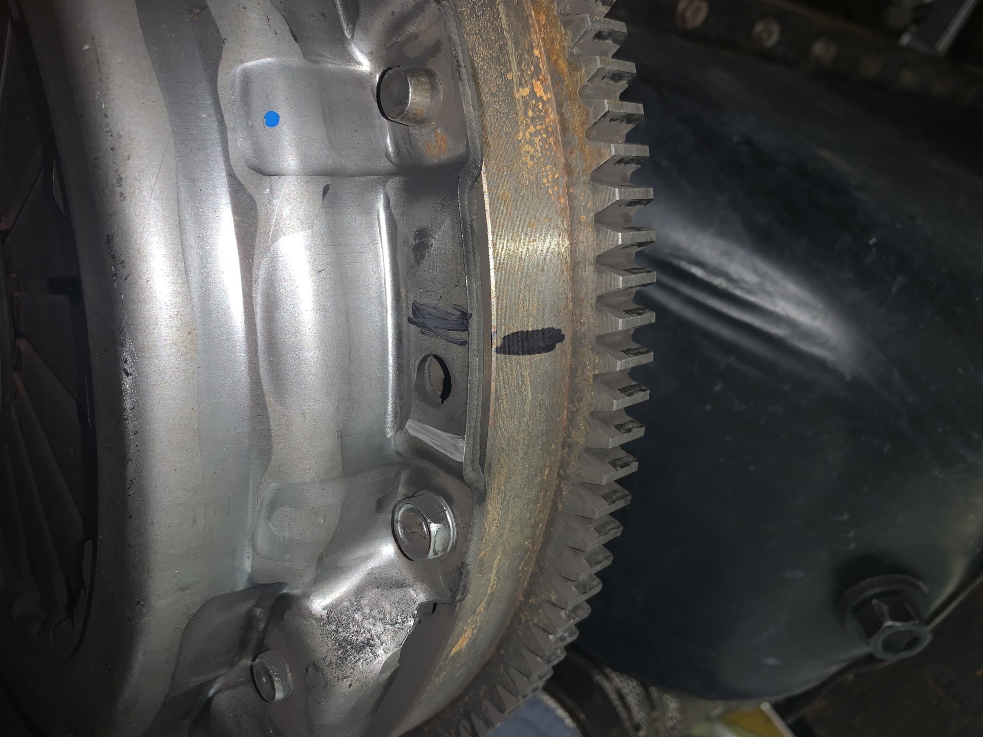

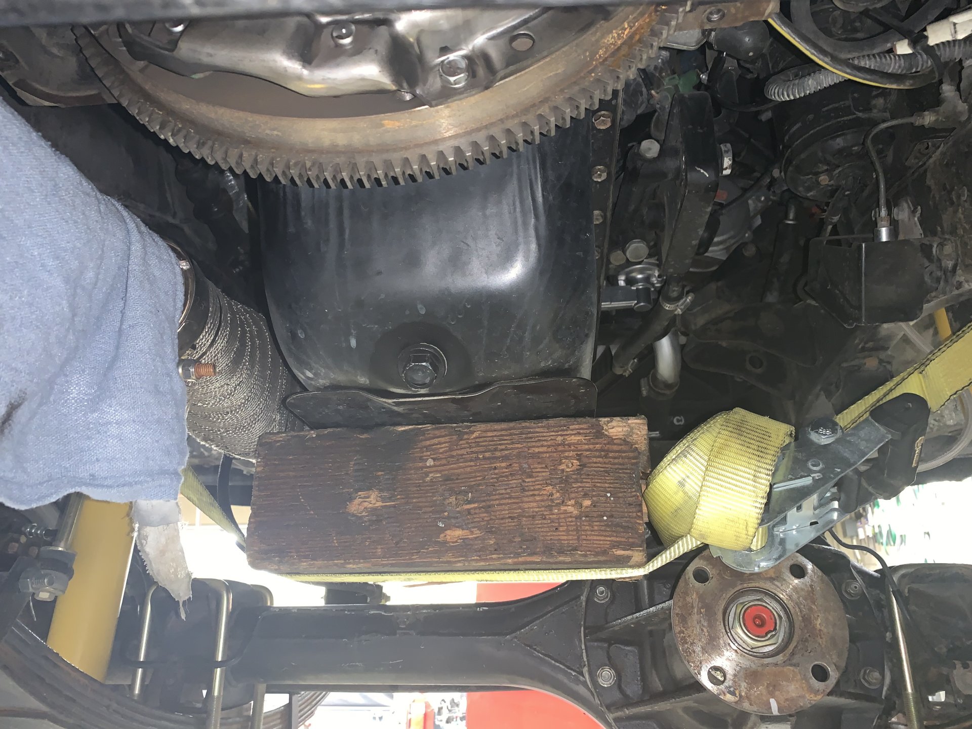

Mark your BB on the flywheel while you have it all out. Another tip I learned from @mattressking was to slide a short 2x4 between the back of the motor and the firewall to support the motor and not have something under the oil-pan. I like your ratchet solution.

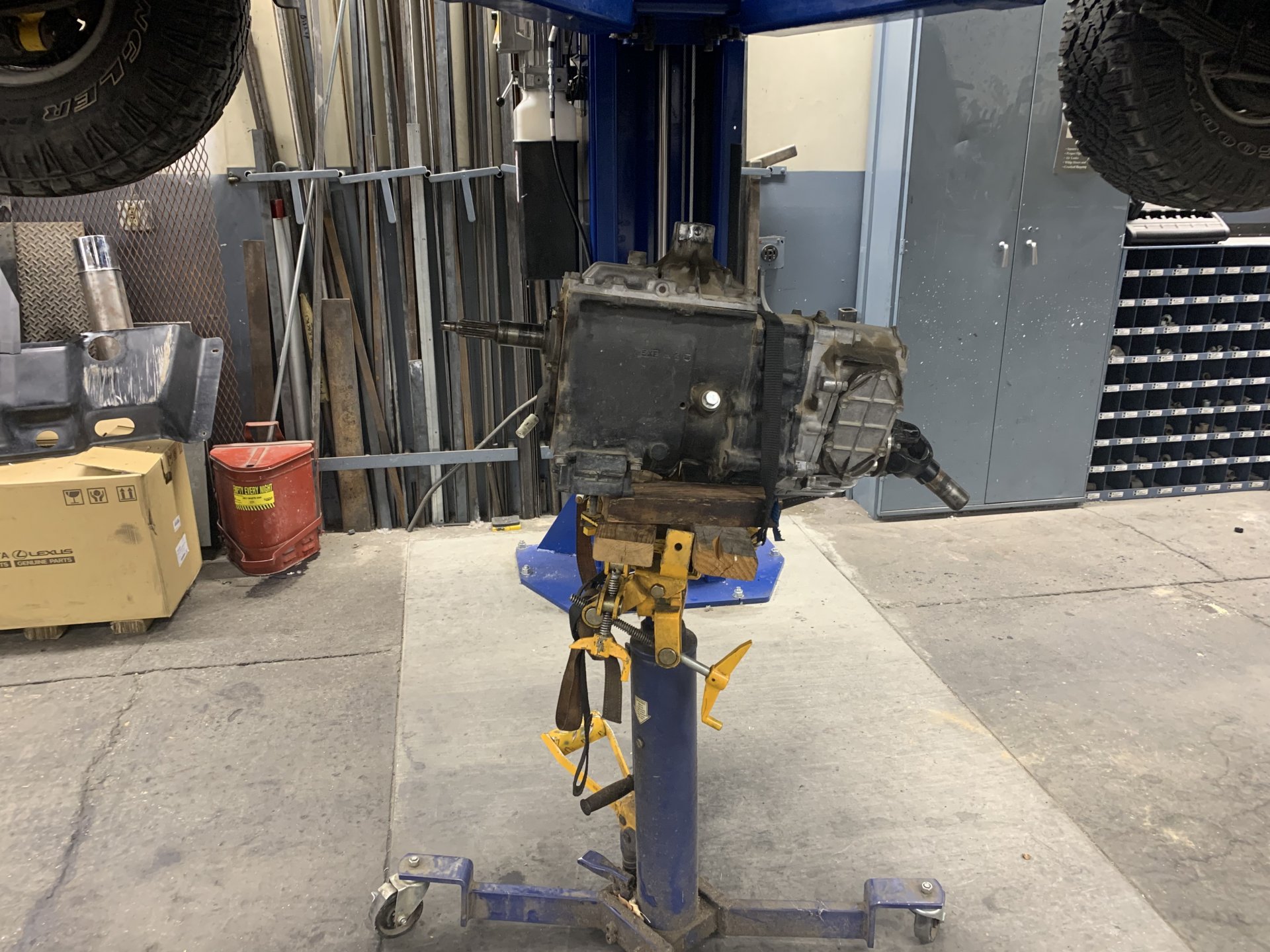

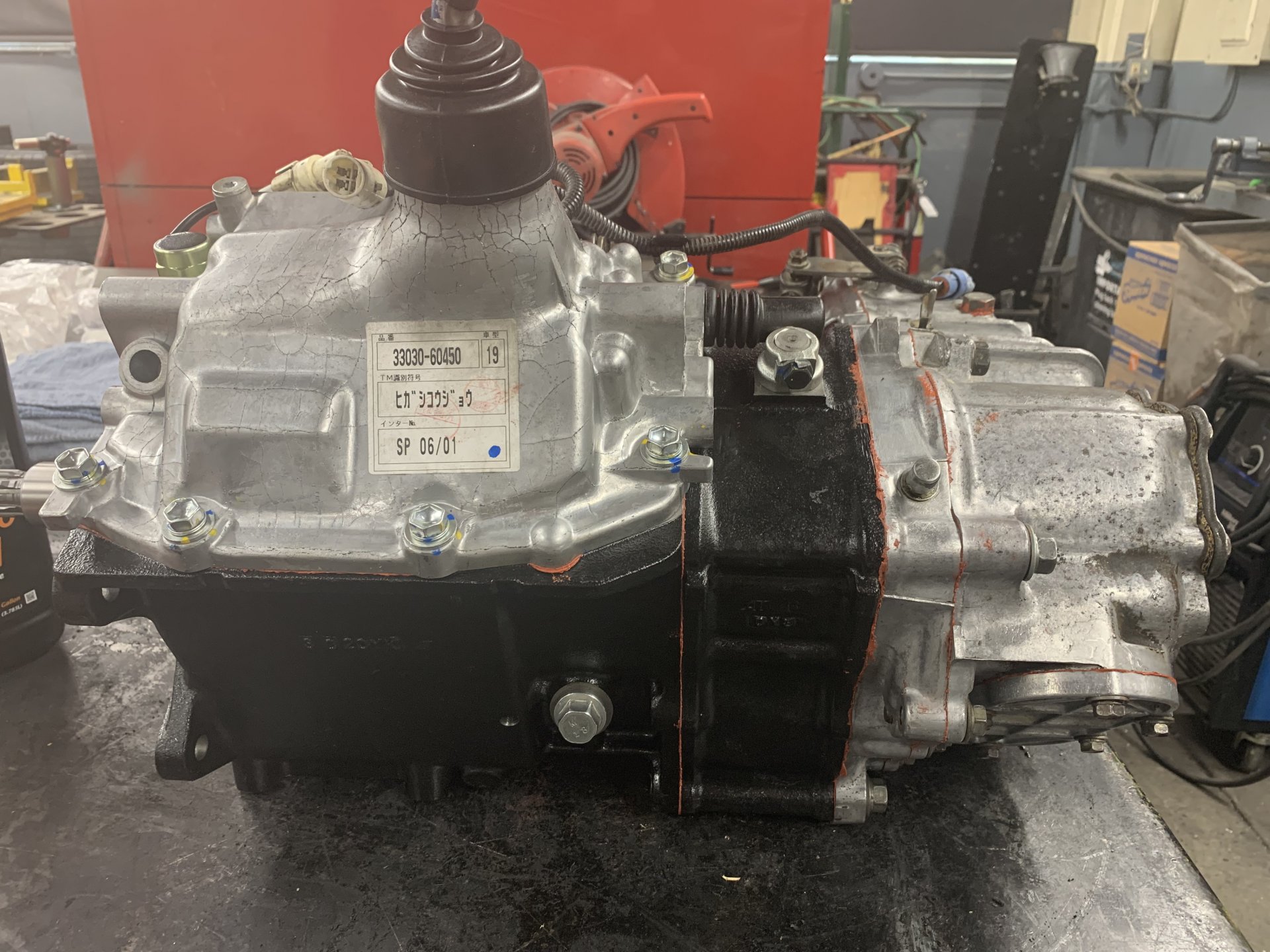

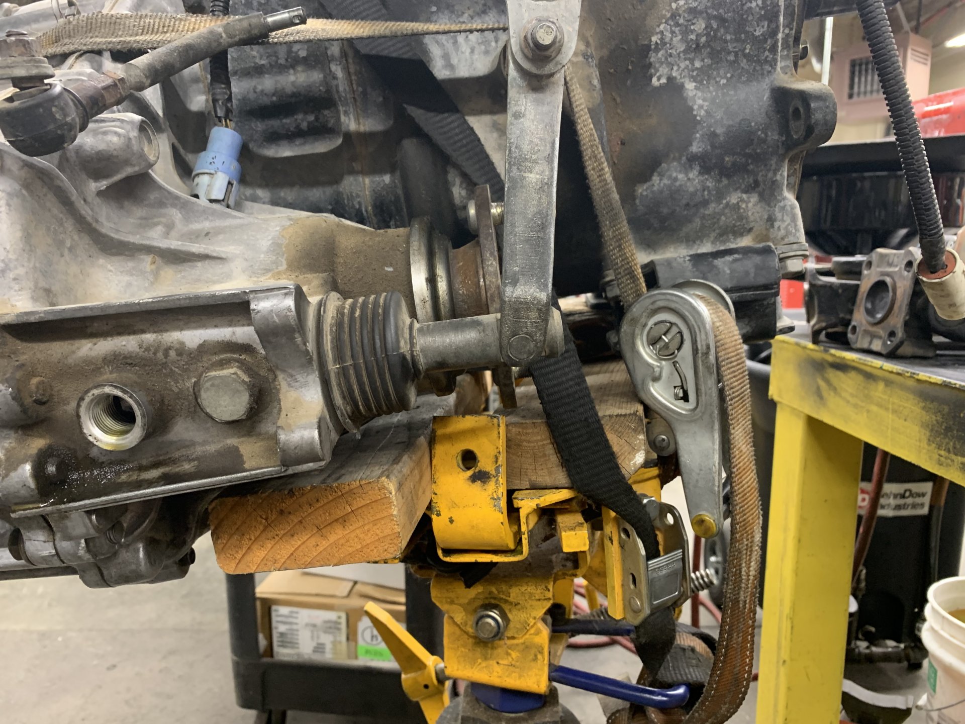

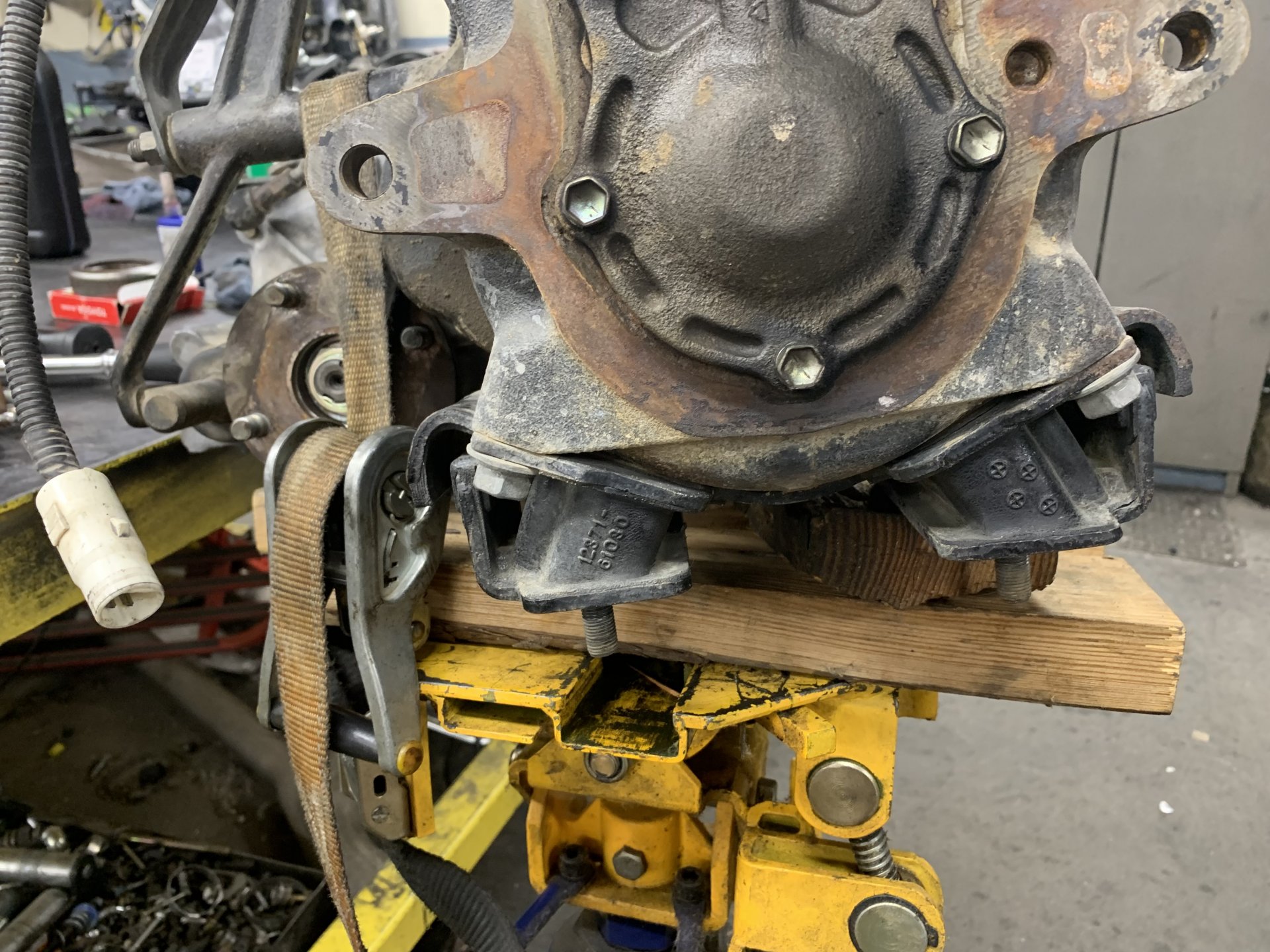

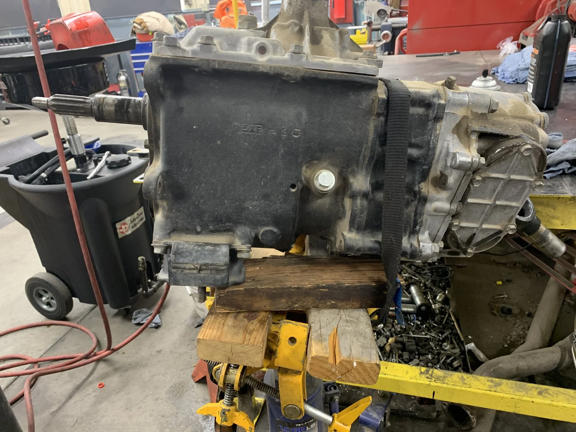

So today went ok. I didn't add pics of the t-case reseal or assembly, enough threads on that. On thing that is hard to deal with is jigging up the trans jack to hold this awkward combo.
I also want to address the saying of (direct bolt in), while it is a bolt in, there is A LOT of work to be done. I had pulled this drivetrain and rebuilt it ALL about 25k ago. So I didn't need to clean years of grunge , do ujoints,clutch,or t-case rebuild. If any of those are on your list of need to do's, this will be the time to do it. Offroad.com actually has a two part thread on a H55 swap that is really good. This swap is not overly challenging but be prepared for a lot of work. Tomorrow I am going to fill fluids and start the engine with new tranny attached but no driveshafts. I want to make sure it shifts and runs without any funky noises. Sorry for the fuzzy pics, I must of gotten grease on the lens, have no clue where it could have come from😂😂😂😂.

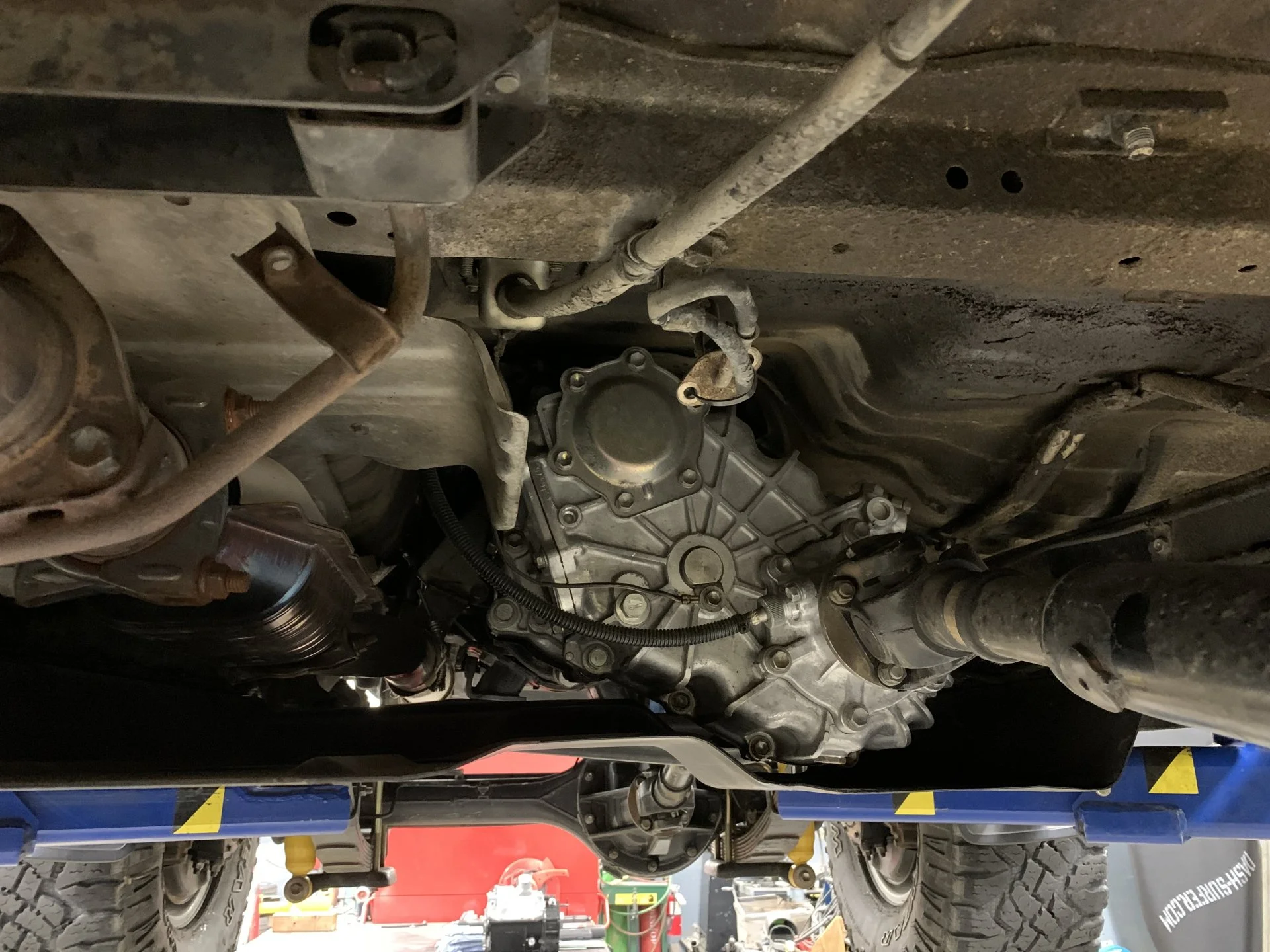

H55 install/swap is now done. Just want to share a couple things that don't seem to be widely discussed. First off, the H55 top plate is almost 2" taller then the H42. If you've ever pulled a H42, you know how tight it is to the tunnel. With that being said, I removed the bolts that hold the tunnel plate to allow it to move up when I stabbed the H55. 2) I found it easier to fill the trans through the shifter hole in the top plate which saved having to pump 5.5 quarts by hand. 3) You will need a 12mm x 1.75 tap to thread the bolt hole that is not used between the t-case and trans. 4) Make sure you have ALL the new seals and gaskets for the t-case Before you start. All in all it was a good project and makes the rig drivability way better. Feel free to ask me any questions you might have😎Happy wheeling. 🍻

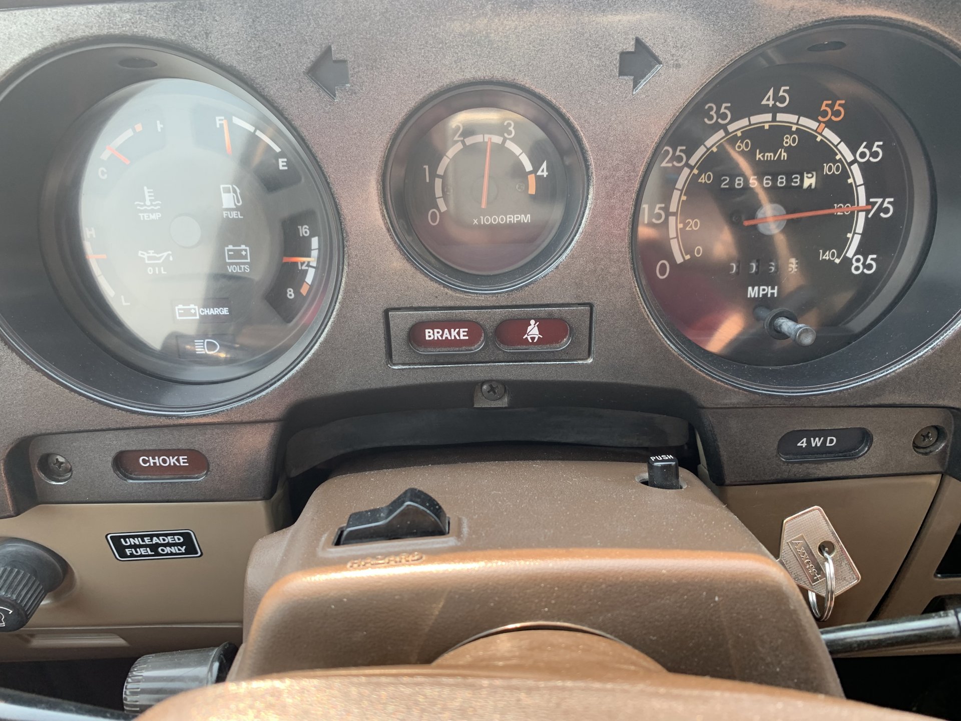

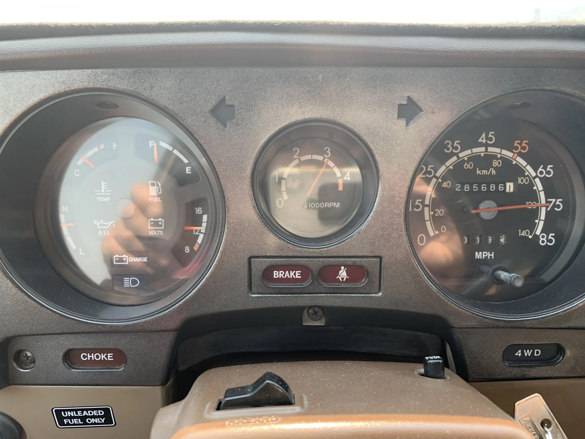

I have about 200 miles on my swap now. Takeaways are, 1)The trans is tight compared to the well used h42 it replaced. You have to take your time shifting. I'm sure it will loosen up with time. 2) I am running 33s with 4:11s and the ratios just seem to be better spaced as your running through the gears. 3) The drop in 5th gear is only 500 rpm but it really makes a big difference in how less stressed everything feels to do 65-70 mph. The noise level is not a lot less which is somewhat disappointing, however, these trucks aren't exactly quiet to begin with, nature of the beast🙃. 4) For me, the most important thing is the much lower 1st gear ratio for off road. I can't wait to try it out. In closing, for the price I think it will be money well spent. My Speedo has read 4mph faster then actual since it put in the 4:11s so these pics are actually 70-71 mph. 4th vs 5th. If you've run out of things to fix on your rig 😂😂😂😂 I recommend this swap. Thanks for watching👍🏻🍻.
