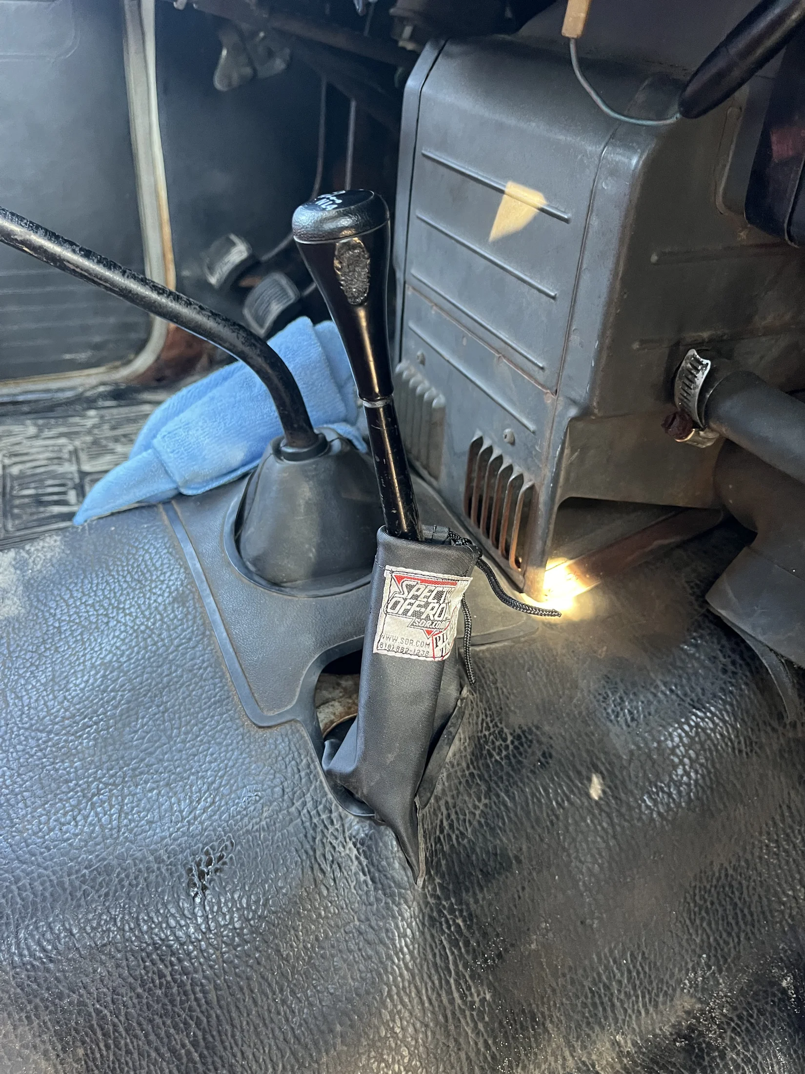

Updates: I installed some shifter boots! I love the vintage SOR logo on the Tcase boot. It was fairly simple to take apart and put back together. a little tricky cutting the extra material. The SOR instructions say to use contact cement to glue the fabric to the metal retainer. I used super glue because I dont have small enough clamps to hold the retainer on. seemed to work fine. Then you just rivit it all together with the supplied rivets. then screw it down to the trans tunnel
I got a transmission shift boot on there but its just loosely in there. I am still waiting on the retaining ring.

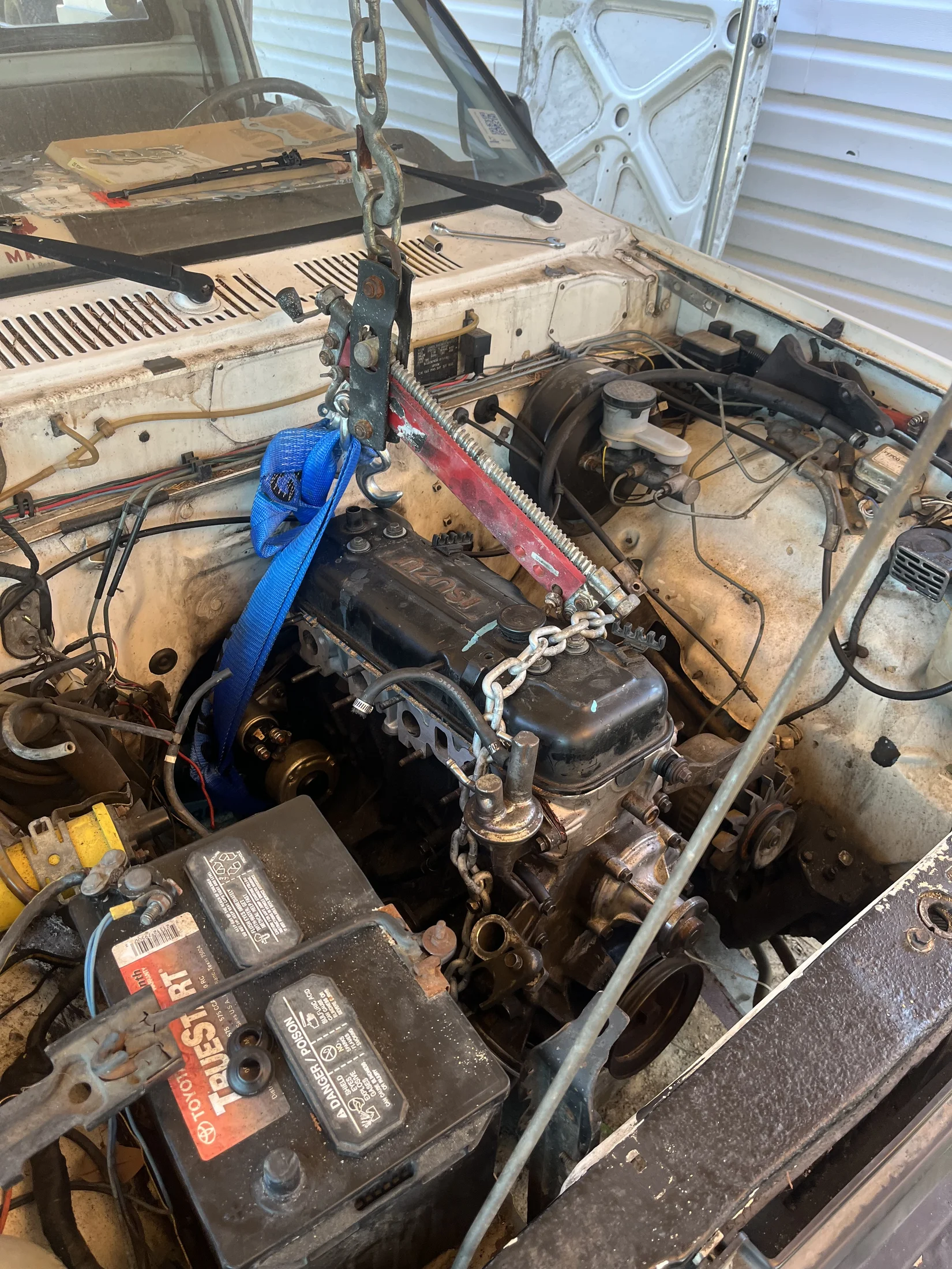

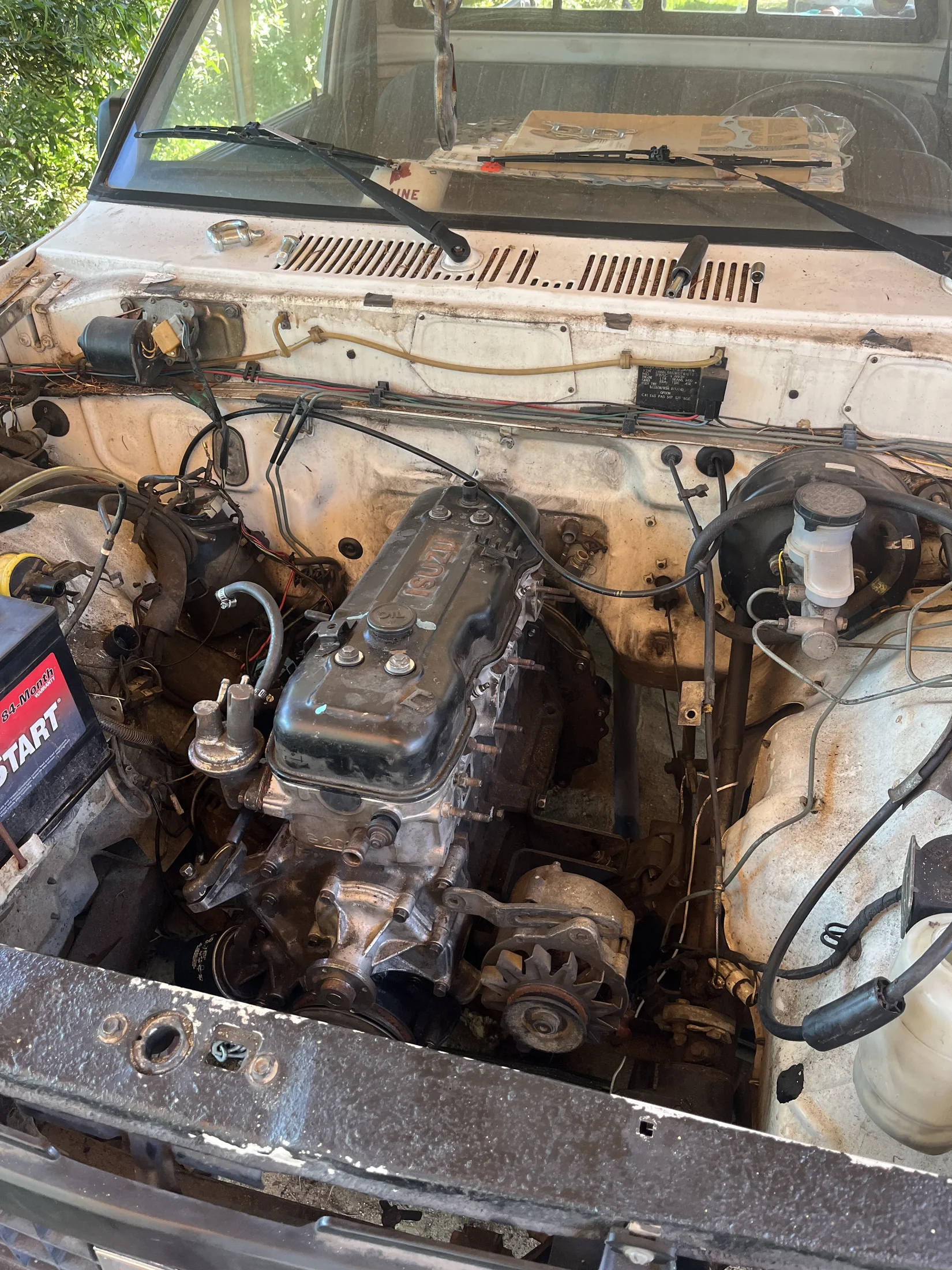

Side quest time! So my isuzu pup has been down since june.... long story short a head gasket turned into pulling the whole drive train! but finally yesterday I started to put things back instead of taking it apart! I finally installed the engine and transmission yesterday with the help from my Dad. Just could not do it myself this time. Now I have to start bolting up intake and exhaust stuff , wiring things back together, adjusting the valve lash and setting timing on the dizzy. Ohh and get a new fuel pump. I destroyed the pump with the hoist. (it was a nightmare trying to attach the hoist. Nothing to hook the chains too!)

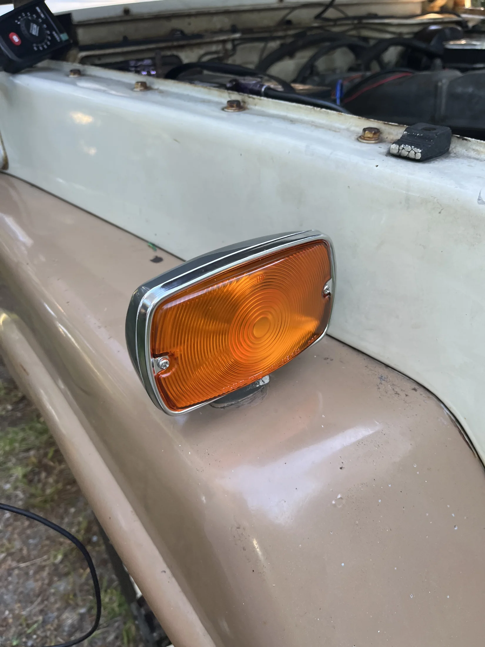

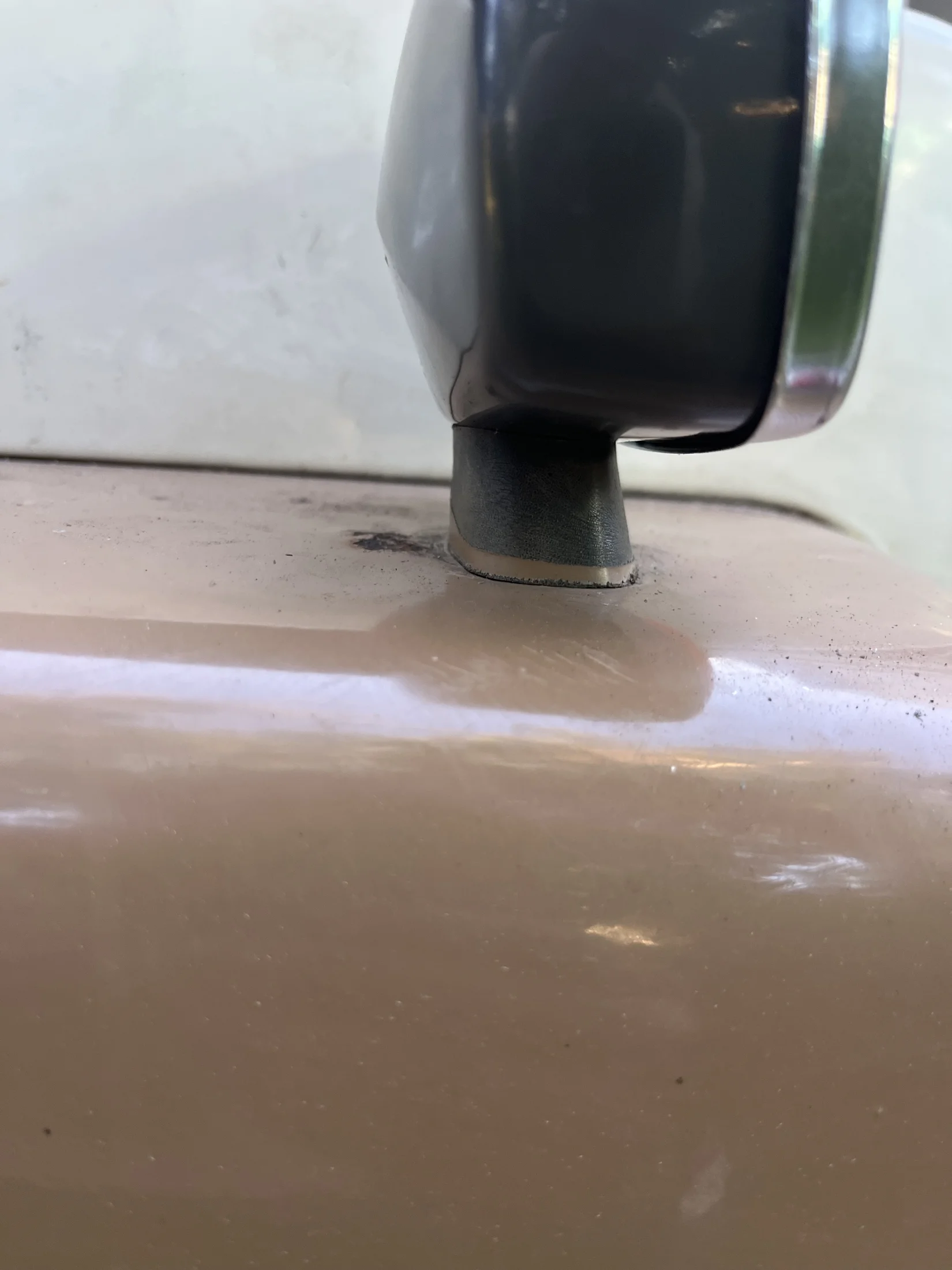

I got my passenger side turn signal installed. I didn't realize the "mount base" was not attached and I could just swap it. I hate the overspray on it but hey now I have a brand new turn signal lamp. I will do the drivers side today after work. It does work!
View attachment 3998571View attachment 3998572

Side Quest: Have you ever had a project that fights you every step of the way? Somthing that you get a step forward then you have to take 3 steps back? A True Money pit? Luckily I dont feel that way about the Fj55. :cool: However.... my isuzu Pup..... YARGGGGGG. Honestly if I had a bazooka today I would have blown it up. I had planned on getting it running this weekend. (I think some of this anger and frustration is coming from storm anxiety. We have another H word in the Atlantic and it has me on my toes. Wednesday is the day it will arrive I keep hearing.)
SO I have the engine in thats great I had planned on getting it running this weekend. But here is the step back... I had to cut the exhaust manifold studs off at the pipe union to replace the little donut gasket there. Fine I will drill and retap them. well I was successful with drilling out the studs. I have one size tapped and the other side I had probably 3 threads left and I hear a crack... Mind you I am working slow, going back and fourth. taking my time. The cracking noise was the hardened steel tap breaking off in the hole. of course its too deep to grab on it. tried a few tricks and now I am at a loss on how to get it. I took a break and posted here and Ill come back to it tomorrow.
