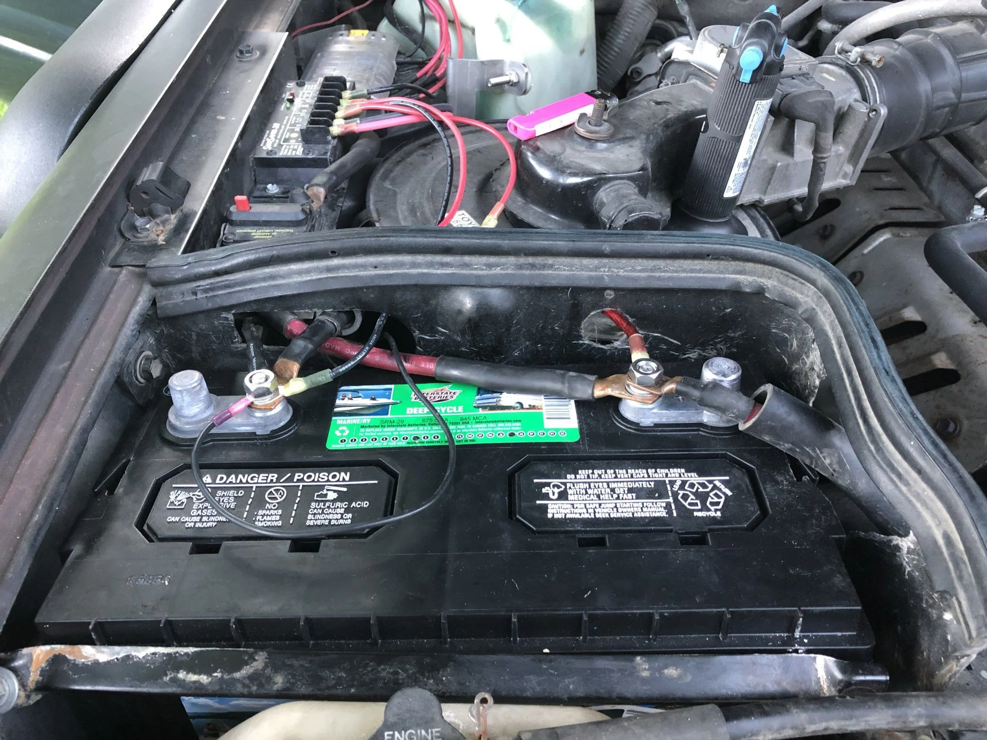

I had a 65W Siemens panel running through a Monightar SunSaver controller to an Interstate Batteries Group 27 Marine Lead Acid battery. It couldn’t keep up with my cheapo Edgestar 80qt fridge.
So I did the logical thing. Bought a new, bigger panel rather than diagnose what was actually wrong. I figured the panel was 10+ years old anyway.
Put the new panel on and some days it would be fine. Other days no. So, I wondered if the battery was bad. Got it checked out. It was fine. So I would throw my charger on the battery and things would be ok for a couple of days.

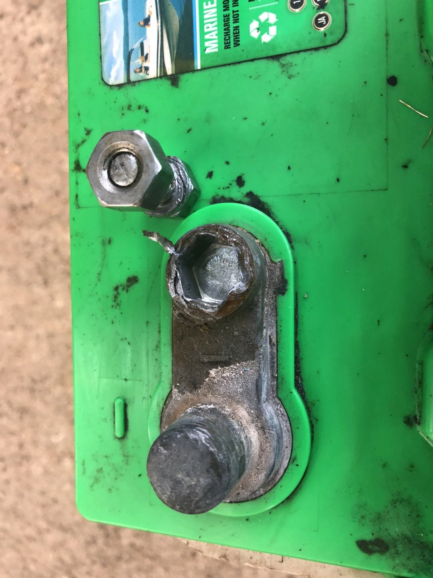

Well, today I had some time so I started trouble shooting it and checking all of the connections. Disconnecting everything and reconnecting everything.
And then I get to the negative post on the battery. Oops. I had torqued it down tight as hell. Later finding out that 12lbs/ft is the proper torque number for screw posts. So the post was loose in there. Thus not giving me a good ground some of the time.
Well, I went to my friendly Interstate Batteries and picked up a new Group 31 and shoe horned it in. Kept the old Group 27 for a dual battery system on my son’s 80 series and solar setup.
Apparently you can just torch the lead around the bolt and push the lead in to fix it.

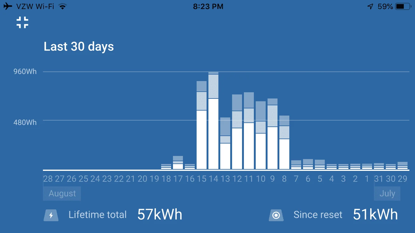

I'm still using the Victron 75/15 controller with blue tooth, but when I updated the firmware and app software last month, it changed the format of the "history" function. So now you get a running month worth of data. You can see the power ramp up the days I was on the Rubicon trail and running my 2 fridges full time in fairly hot weather.
I also used the output function to get a running consumption reading that I thought was pretty cool. You can see the 2 fridges were using 660-720 Wh per day-That's roughly 50 amp hours per day of power to run 2 medium sized 12 volt refrigerators and maybe 3 cell phone recharges.
The 180 watt panel worked great. The max I saw from it was 176 watts so very close to spec. The batteries would be in the "absorb" phase, and thus full by 1030am each day and then basically float the batteries until dark. During the day, the panel powered the fridges directly.
And in the morning, the lowest voltage reading I saw on my "house" battery was 12.3 volts, so very happy with the overall set up. It's really terrific to never worry about power consumption and battery charge. I had a period of 4 days straight where the truck never ran, the batteries stayed fully charged and the beer/white wine was always cold at the end of the day.

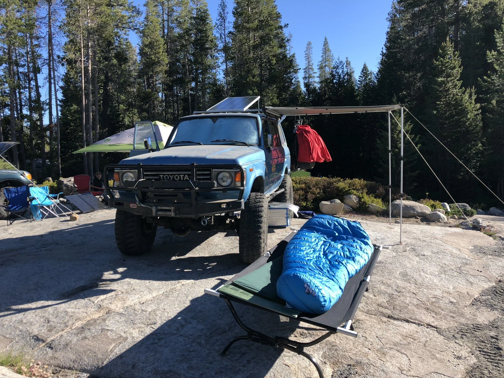

Here is a pic of camp where you can see the solar on the roof, tilted the 10 degrees up for maximum efficiency this set of dates.
