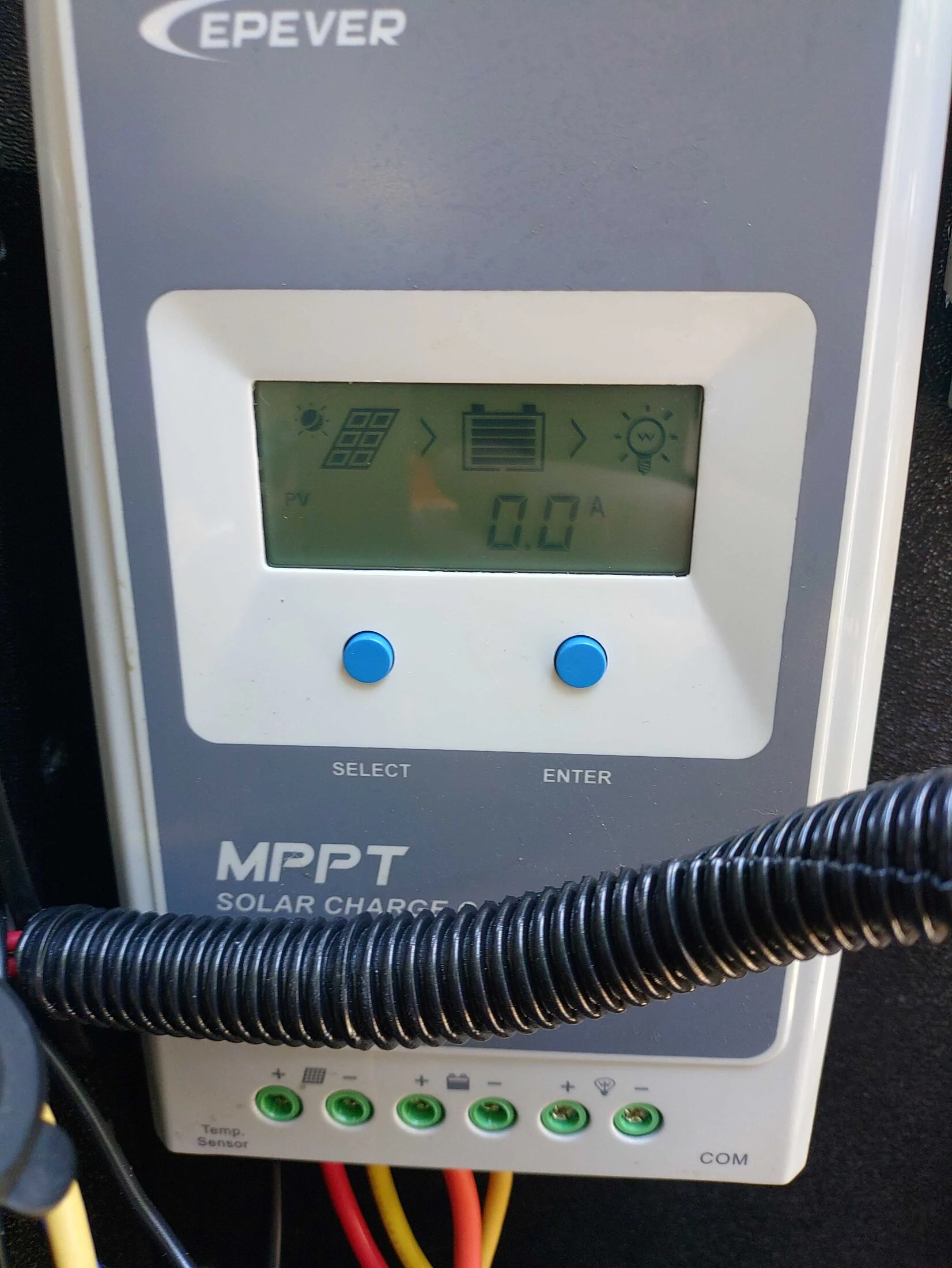

I get 10 amps coming in from the breaker to the charge controller (so the breaker is good). BUT: I get 0 amps coming out of the controller, going to the battery. The charge controller display panel shows 18 watts coming from the panels, then 0 amps. There used to be an amp reading there in the 8 - 10 range depending on sun/clouds.
So do I have a burnt out charge controller? The battery is also good - I charged with my AC charger and it went right up to 100% - 14.7 volts - in about 7 hours. And it was fine today, 12 hours later.

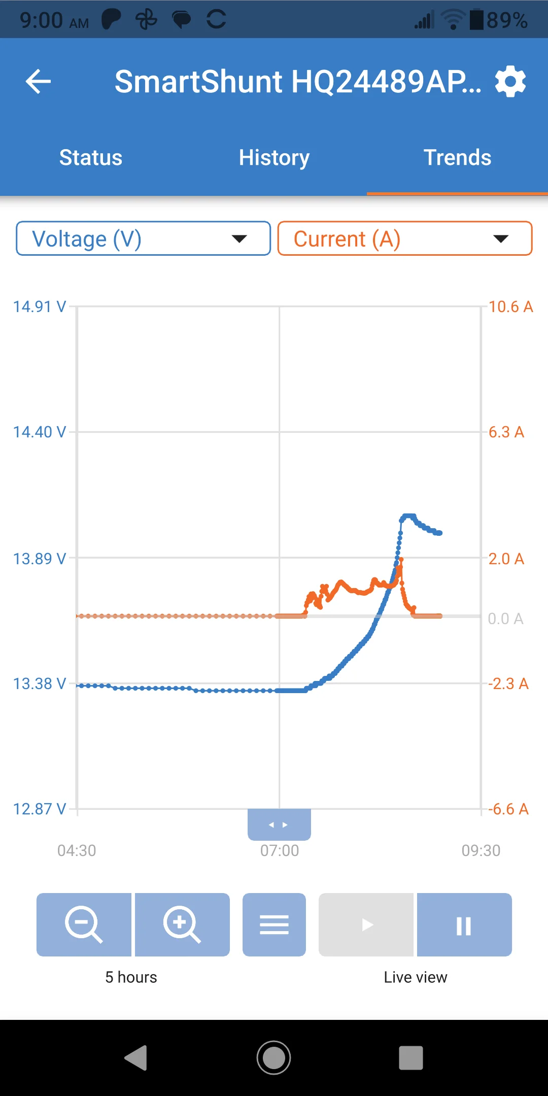

Just a little more info. The smart shunt read out shows daily battery charge up and down with day/night cycles, as well as incoming solar charge likewise alternating. At the thin red arrow you see something happened, not sure what, and the power stops coming in, and the battery voltage starts steadily dropping. The fridge was on this whole time and as it drew all night it pulled the batter down. The next day I hooked it to my AC charger which caused the two flat topped spikes to the right (had to take it off the charger for a few hours to do some stuff.)

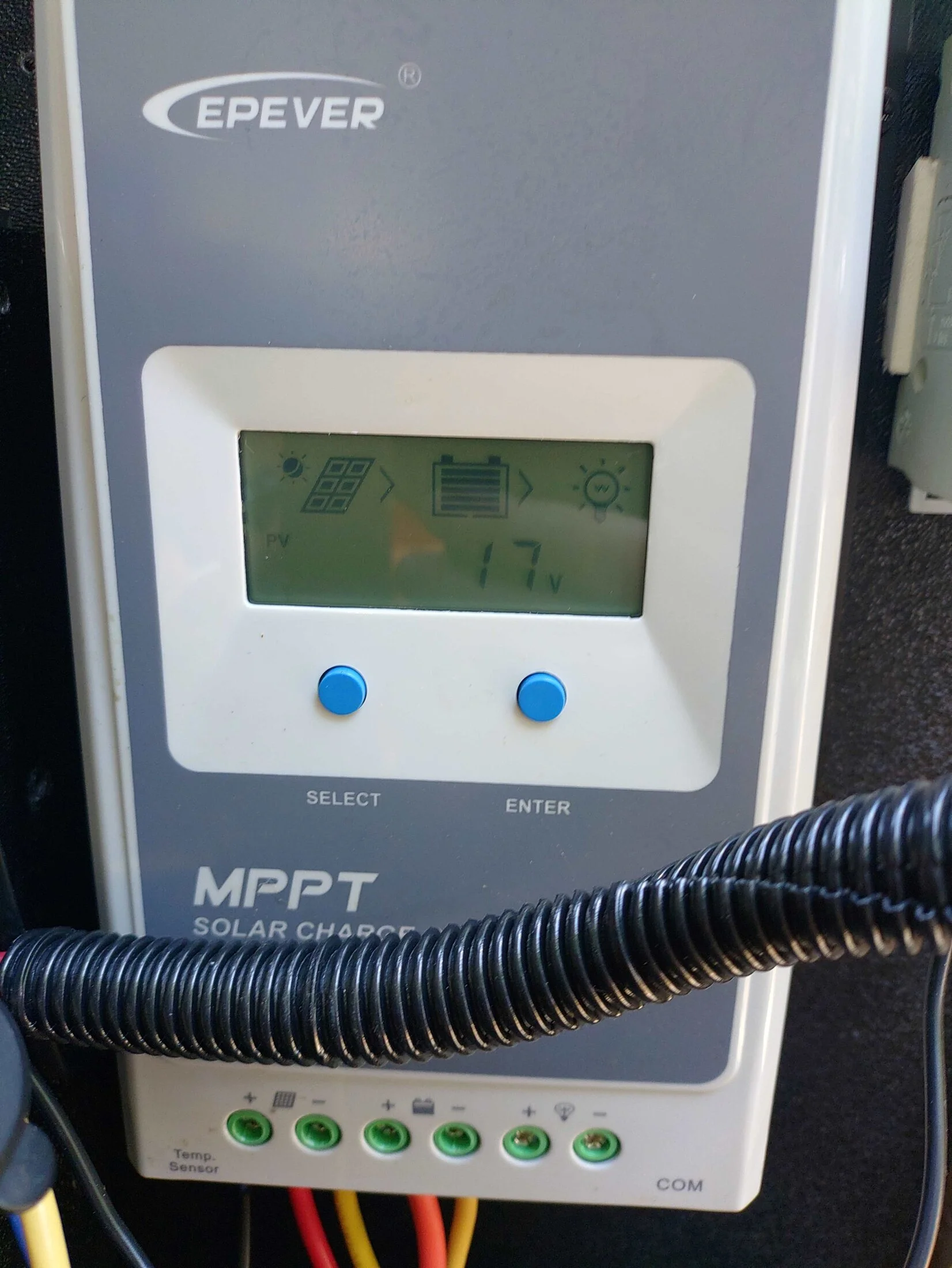

Also the charge controller showing 17 v coming in, and 0.0 amps out.

It's weird - I get a normal volt reading, and a KWH reading, but no amp reading on the controller screen.
The voltage readings mean just that, there is voltage, and kWh is likely history, all that is not inconsistent with there being no current out currently. But you'll want to make sure there is indeed no current coming out, notwithstanding what the controller says, it is conceivable the current reading of the controller is off. But sounds like no power out based on your description.

Rereading your OP, with 18V instead, there is something off. If you were to have 18V 10A coming in and 14V 0A out, that would mean there is 180W dissipated in the controller, that would get noticeably hot pretty fast. So something is not making sense there.
I'm with you, what happened in the first place? - important thing to figure out. If possible. Looking back at the original screen cap of the smart shunt graph, there is that blue spike after which things fail.
