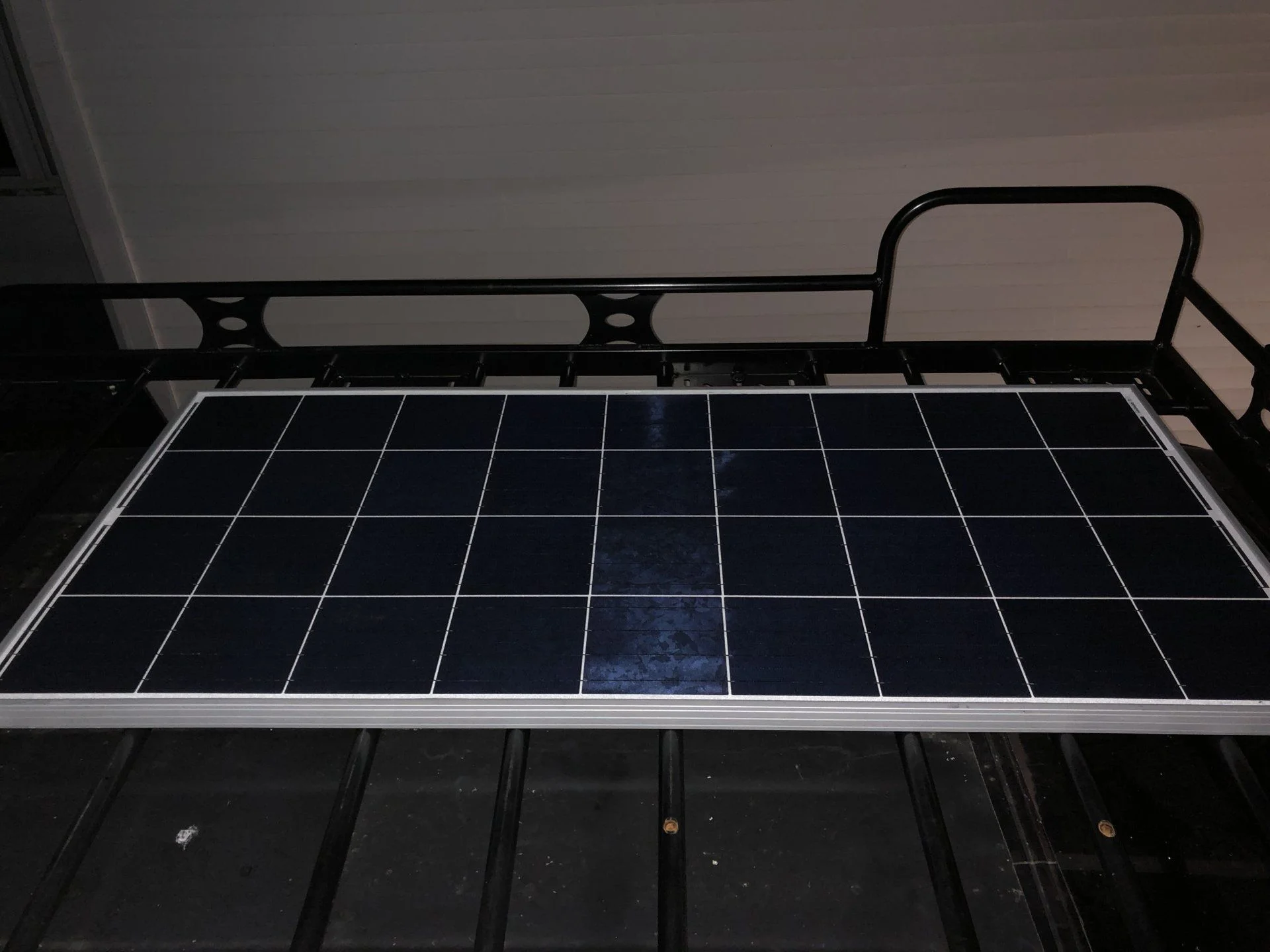

Got the 160w panel mounted yesterday. Also swapped the wiring to MC4 connections and 12 ga instead of 14.
I have it hard mounted, for now. I thought about a mounting system to be able to tilt it but figure I should be ok with it being hard mounted. Size is 59”x27”.
Just make sure those rack side bars don't throw shadows on your panel. Even small bits of shade will kill the output from that string of cells.

This is so true! Put a volt meter on that sucker and shade just a tiny bit and watch the drop! It's astounding

Yep. The rack is getting chopped once I finally figure everything out as far as set up. Work in progress.
