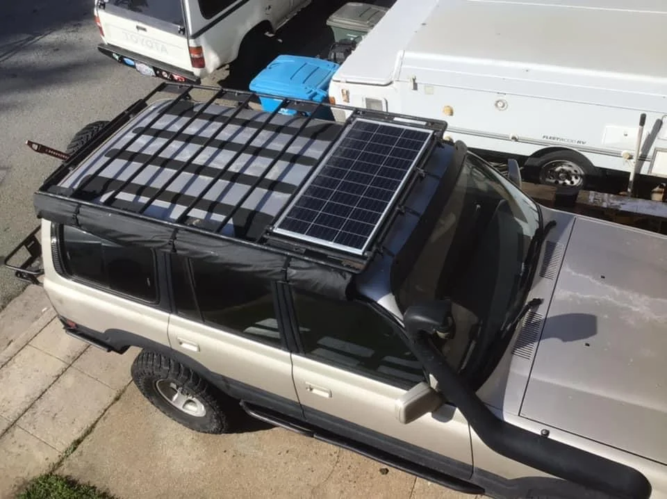

100w Solar panel is finally small enough to fit flush inside sunroof opening of my home brew fake gamviti rack. Wiring through the snorkel.

Sure thing! It's been a fun project overall. There are apps but there's also a gov website that you can get tilt and azimuth for any time of the day without all the app ads. NOAA Solar Position Calculator - https://gml.noaa.gov/grad/solcalc/azel.html
Then with a compass and inclinometer the panels can be positioned. So far I've only gotten a max of about 150-160W but that really keeps things topped off. The only other use for this battery right now is charging phones/headlamps/gps so it's kind of over-spec'd but I wanted to be able to handle many days of little to no sun and/or non-ideal campsite conditions we all sometimes get forced into.
