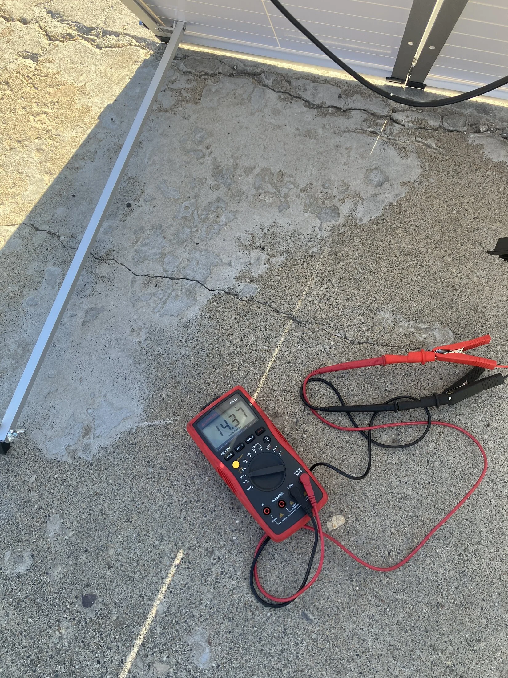

I am going to put the alligator clips across the battery. Ill check the output under load and without a load when they arrive

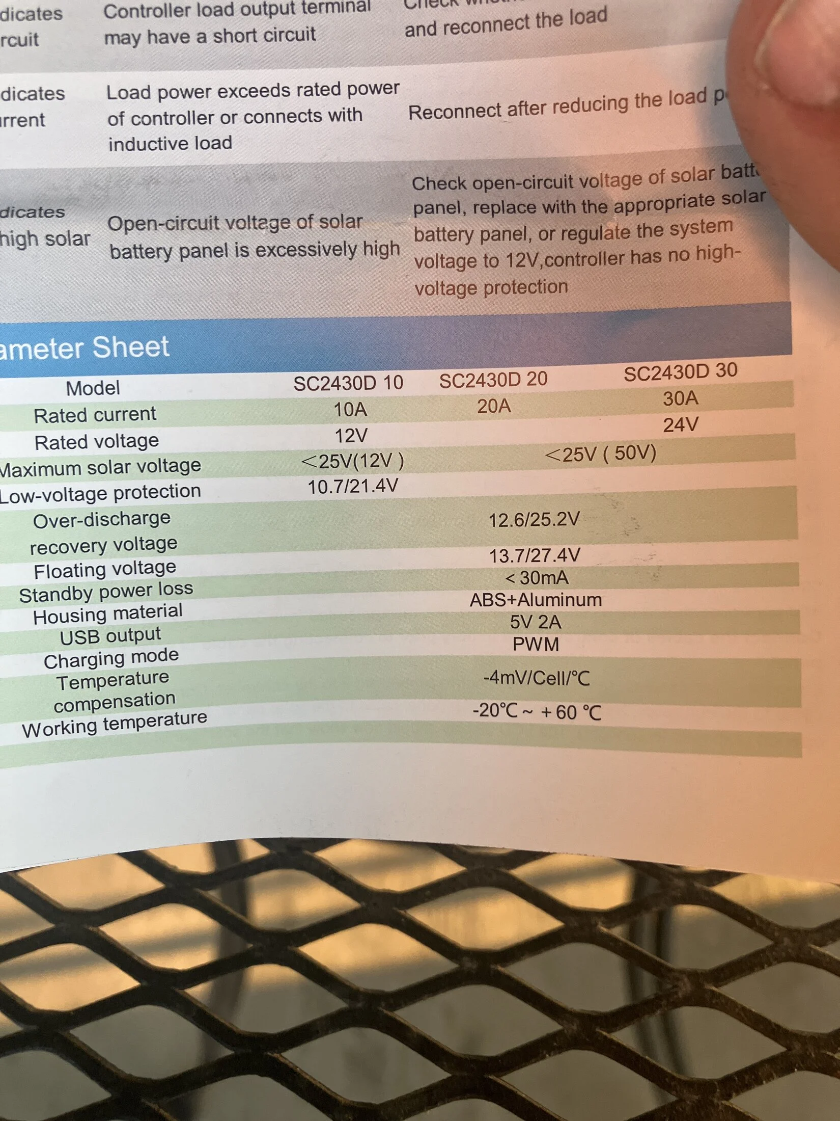

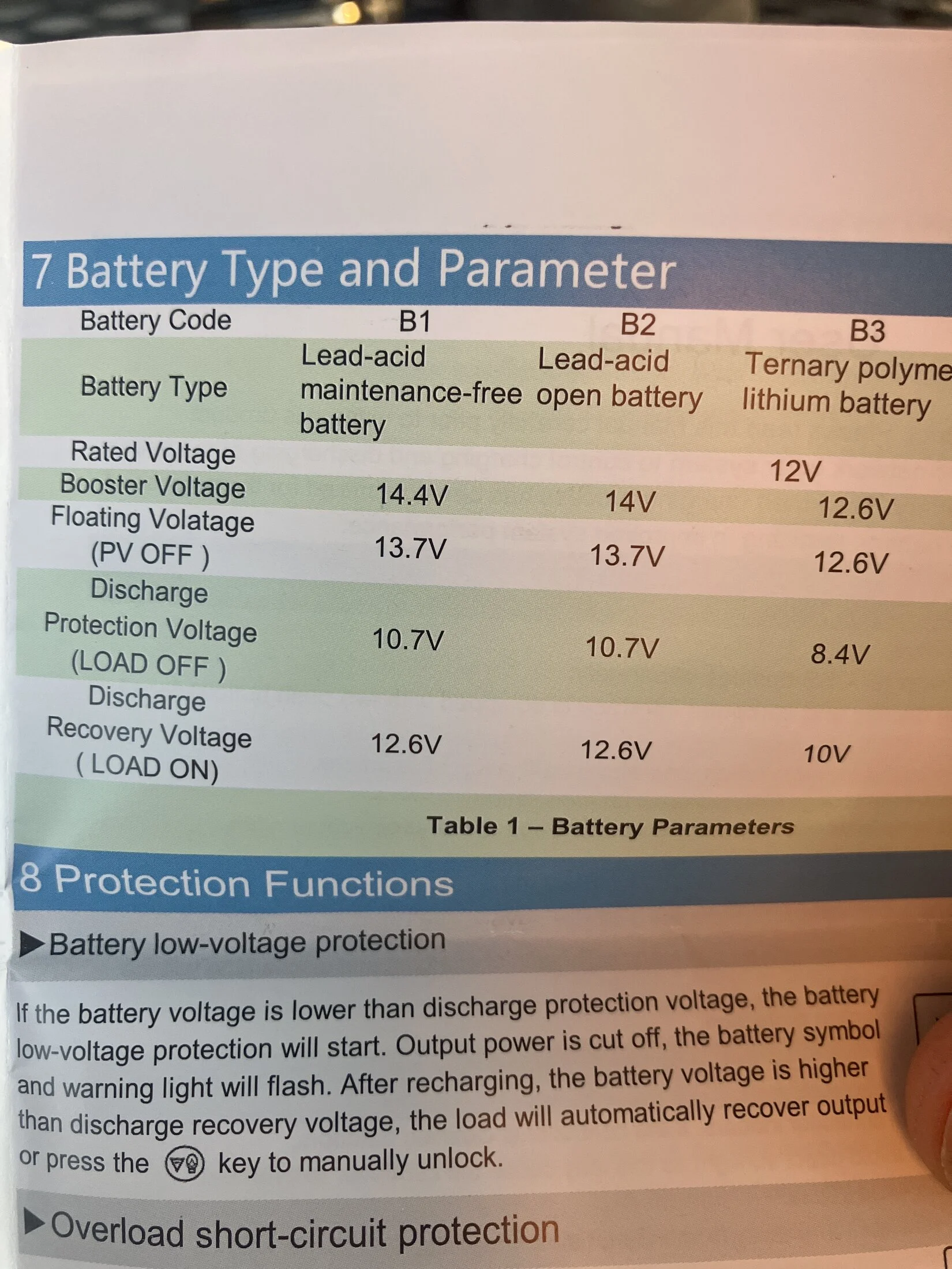

My top of the line high quality kit arrived today :rofl: It was heavier than I anticipated. The 6 year old Chinese boy that wrote the manual did a decent job. The float was set at 14.4V and it was default set for a maintenance free battery. I verified with my multimeter. I am not sure how to install the controller indoors as recommended, but ill do my best. I am heading to Cruisers in the Rockies this weekend so I will probably bring it along. Thing is I will probably be driving enough that I will not need it.
^ what do you mean the float was set to 14.4V? That is not a float voltage for lead acid, float should be around 13.5V. 14.4V is absorption voltage.
But what are you measuring there? Is that the voltage straight off the controller without a battery?
well, that looks like they have the absorption ("booster") voltage set to 14.4V, that is fine for lead acid.
And the float to 13.7V, also fine.

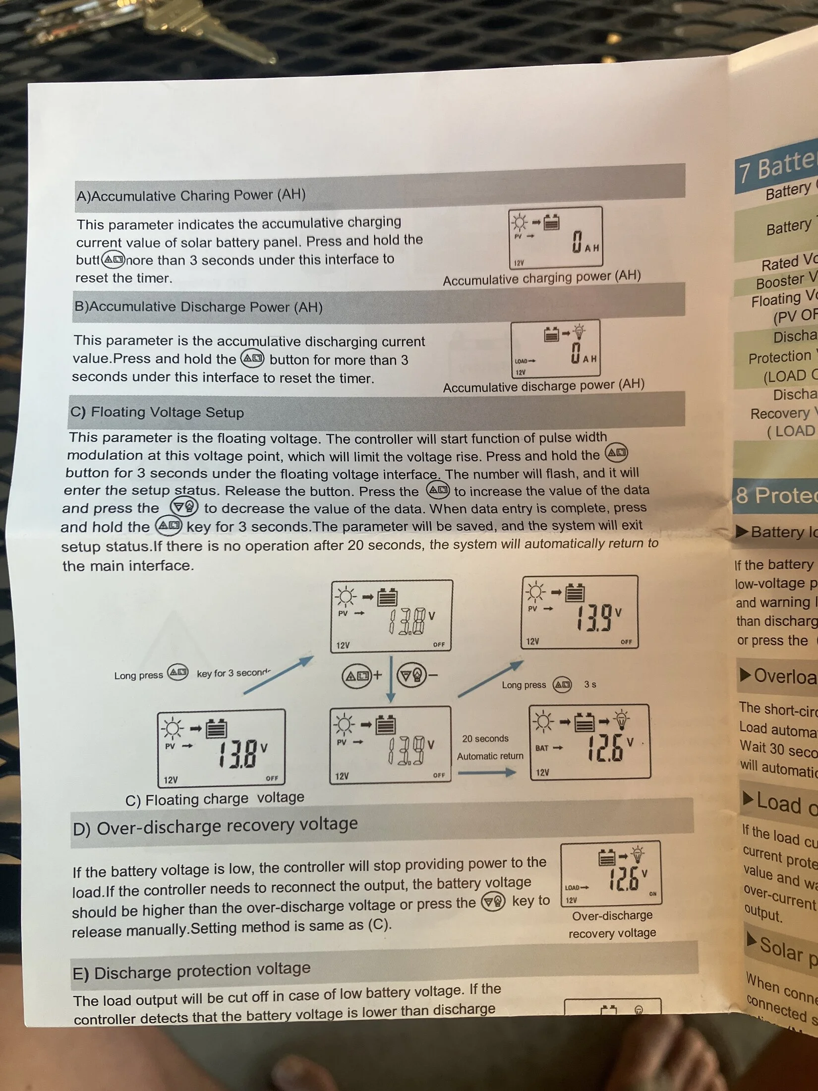

And it looks like it can be changed, good.
