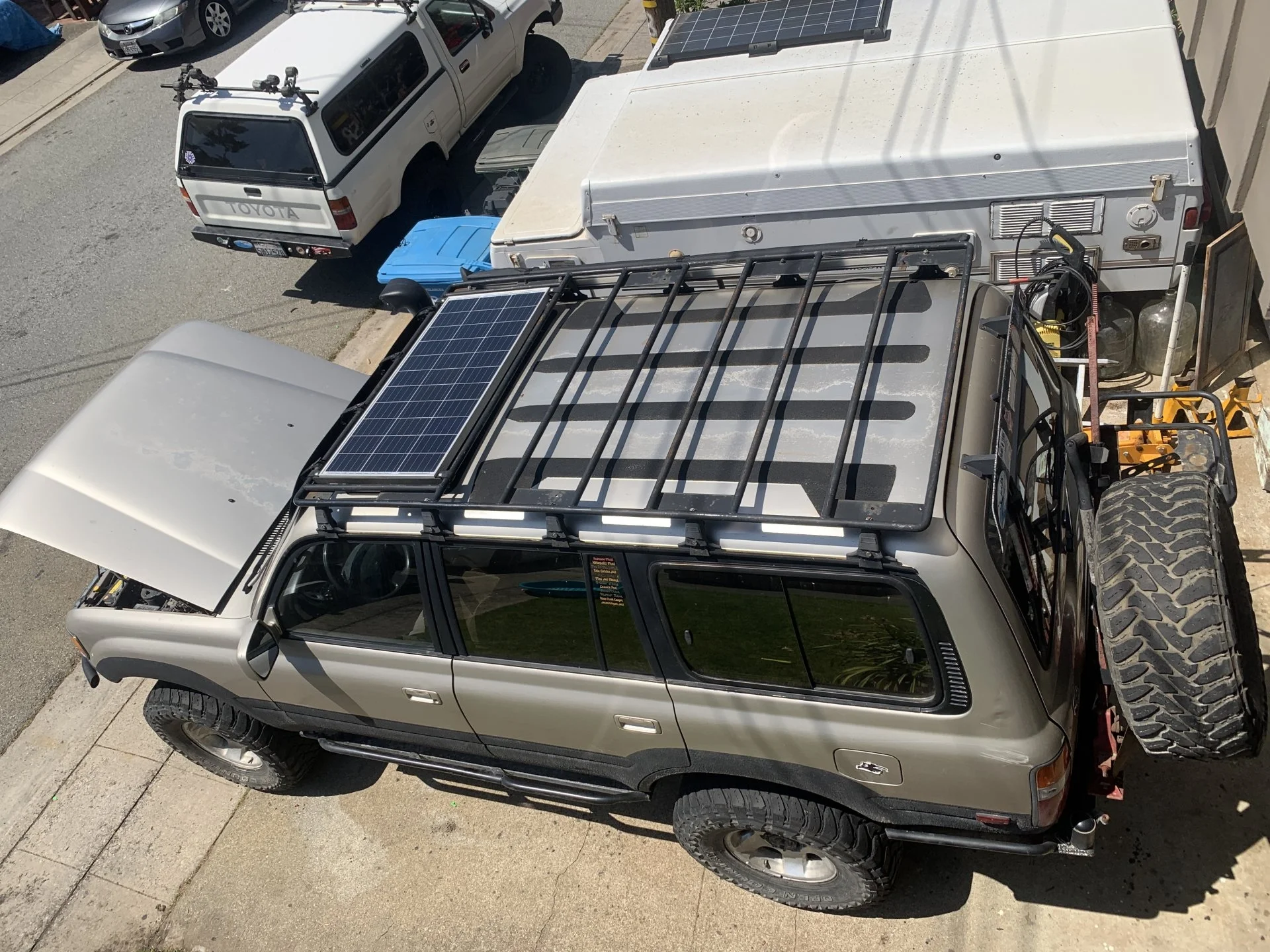

I never bought the folding solar panel because I never wanted to take up space inside my Cruiser. I considered mounting the folder on my roof because it’s too large, the same can be said for the 47”x21” long 100w panel. The newer 42” by 20” 100w panel changed all that. It fits perfectly inside the framework of my roof rack‘s sunroof cut out and is level with front fairing. The only issue is to keep the wiring “portable“ or mount the ip67 controller a couple inches below the panel and run 6‘ of 10g to the battery) or mount the controller literally on top of the lead acid battery in the very tight battery box (where battery off gassing could pose a hazard) or the back side of the battery box which exposes the controller to higher engine temperatures. In cab mounting is not an option since house fuse block/distro is in engine bay. Roof to engine bay would be accomplished by running wire through the cheap China snorkel.

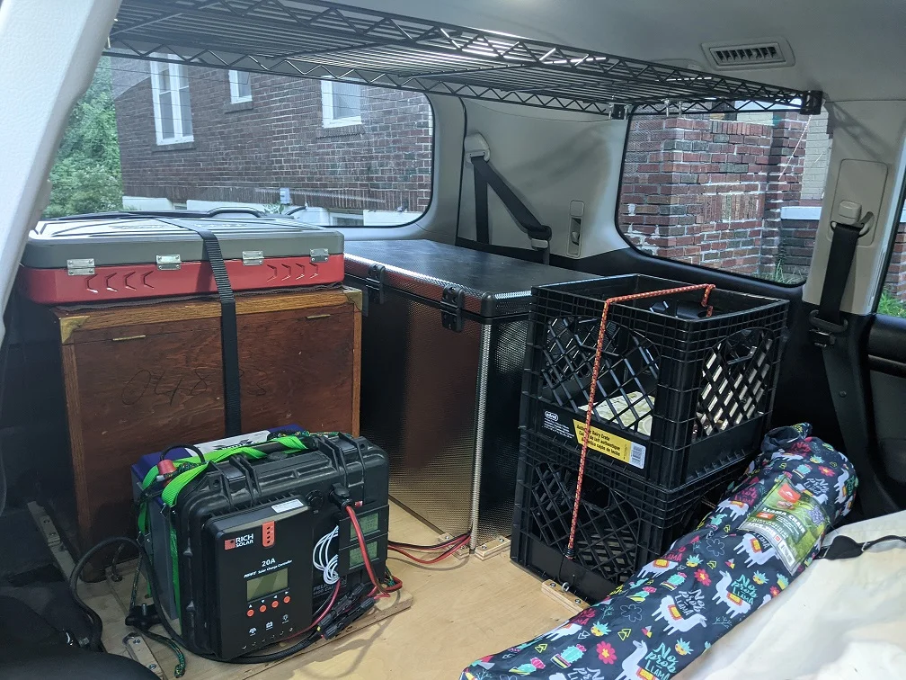

This thread was very helpful for me, and I thought I'd share some photos. It all started when I got tired of regular coolers--yes the ice melts but what's almost more frustrating is having to hunt through it all to find that one stick of butter or last can of beer. So I got a National Luna fridge and then the accompanying solar + battery. Battle Born LiFePO4 100Ah, 200W Renogy, MPPT, etc etc. Got the battery and electrical strapped to a board that screws into my rear cargo plywood. Ran a ~6ft cable with MC4 on either end through one of the grommets in the floor and it is mounted next to the trailer plug.

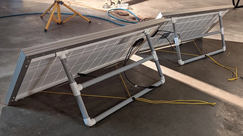

The idea is that I can put the panels wherever I need them on the ground and run a longer cable to the 6ft outside-inside jumper which goes to the Pelican box holding the electronics. Did an adjustable PVC frame for each panel to get the best tilt angle. Trouble is, I like to camp with a big 10x14 canvas hot tent (and I am challenging myself to pack everything inside--hence removing 2nd and 3rd row seats).

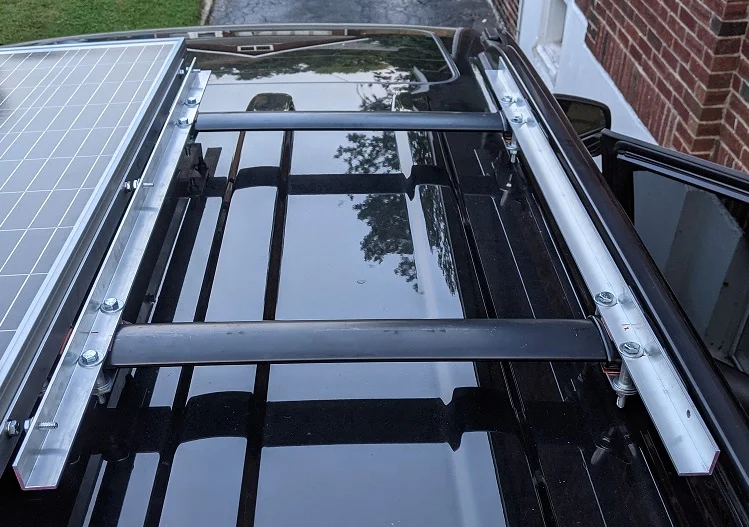

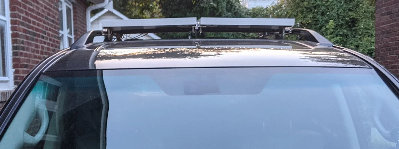

Chuck box, fridge, battery do great in the cargo area. Attic is a shelf from Menards (I'm very cheap/home brew/diy here...). Shelter, cots, chairs, etc get ratchet strapped using the 2nd row seat mounts. All of this works great, except the big glass/metal solar panels don't pack well inside. So I cooked up some bracketry and mounting that uses the existing roof rack rails. It's was my idea to put the panels here for transit and hopefully get some power during. I like keeping the entire fridge circuit separate from the vehicle.

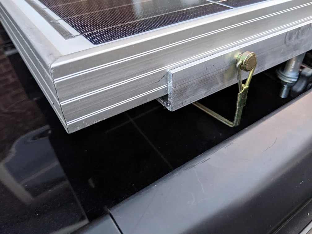

Basically, from each side of the truck you can lay the inside edge of the solar panel frame into the bracket and catch 3 bolted in studs. Then tilt down and rest on the outside bracket which has two through-holes to accept 2 pins with integral wire catches. I still need to make some kind of air dam and resolve the wiring to the interior, but it's going well so far. If I make another cable that uses thinner gauge ( I used 10AWG ), then I could pass through the gap that the upper half of the rear hatch makes with the body. Right now it would just pinch the wires. But if I could do that, then I can run down the rear hatch channel and behind the bumper and catch my existing 6ft jumper. Hope this helps others! This stuff is very home brewed hardware store quality, but it's quite sturdy and I just don't have access to the machine shop equipment I'd otherwise like to apply to this project!

Nice stand for the panels! Is that top pvc pipe attached to the panel somehow or just resting there?
