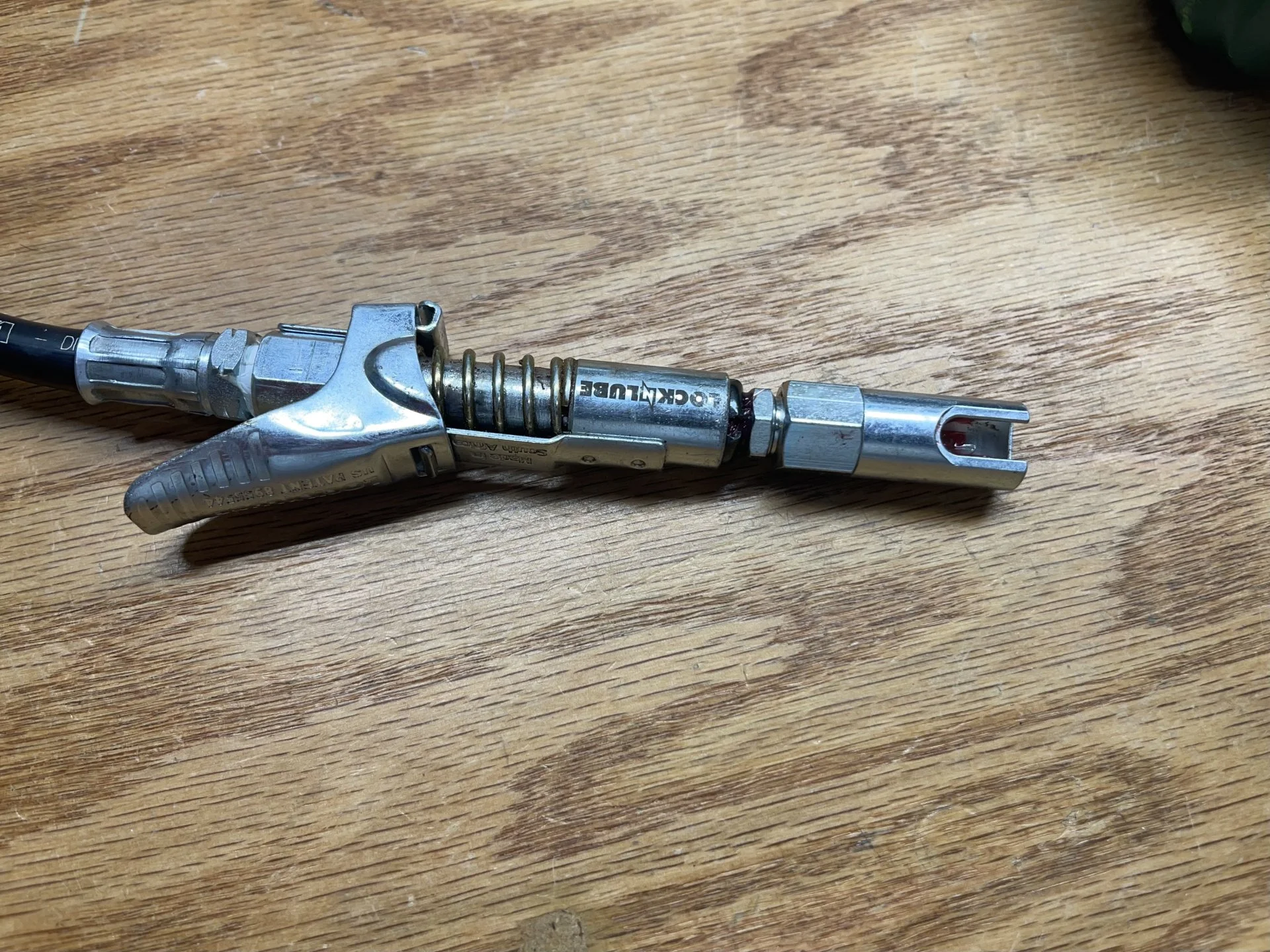

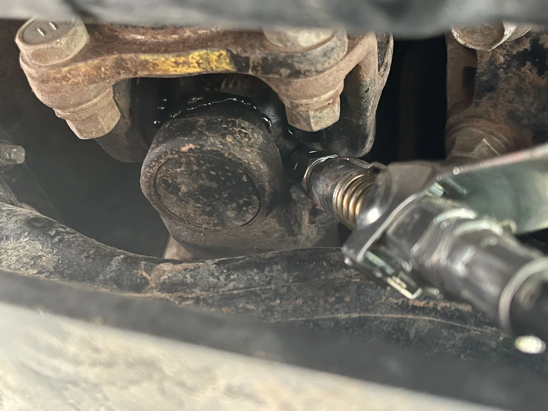

I just had my first introduction to all my zerks today and did find the front shaft rear u joint somewhat challenging. However, it was a breeze with the lock N lube LNL121. No dissent skid plate removal required.
View attachment 3134548View attachment 3134549
That is a great tool. I’ll be looking into it and possibly amending my thread. I still think it is a good method to get the zerks clocked into a position that allows access though.
I still highly recommend the needle attachment. Allows the zerks to be reached on extreme off-angle locations and does not require a direct line of sight so to speak as the Lock-N-Lube does.
Amazon product ASIN B0779FK9CZ
The use of that adapter still requires getting the zerks in an accessible position, especially the front drive shaft with Dissent skids and it’s rear u joint. Your tire off the ground while in neutral trick is the best method by far.
