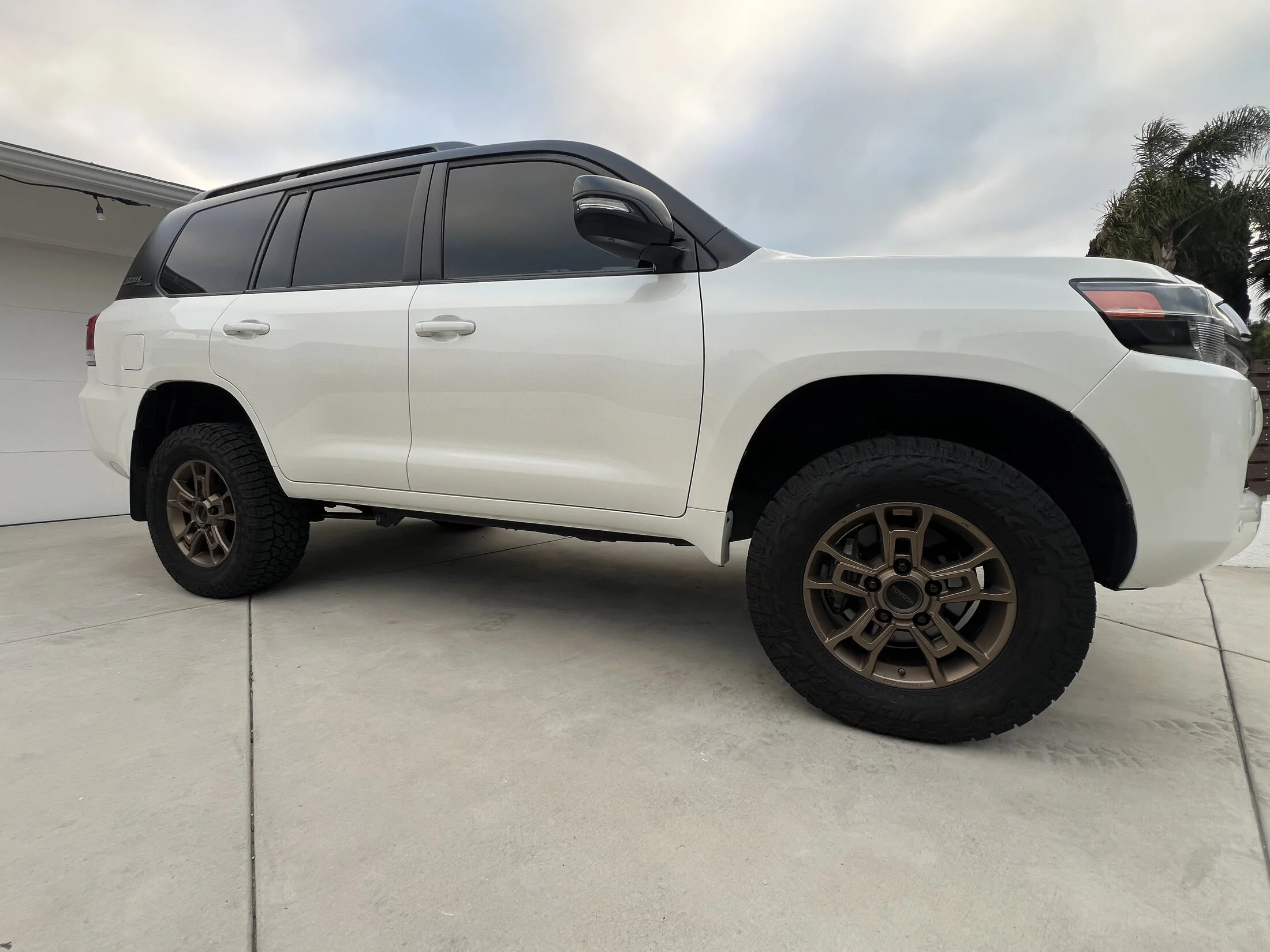

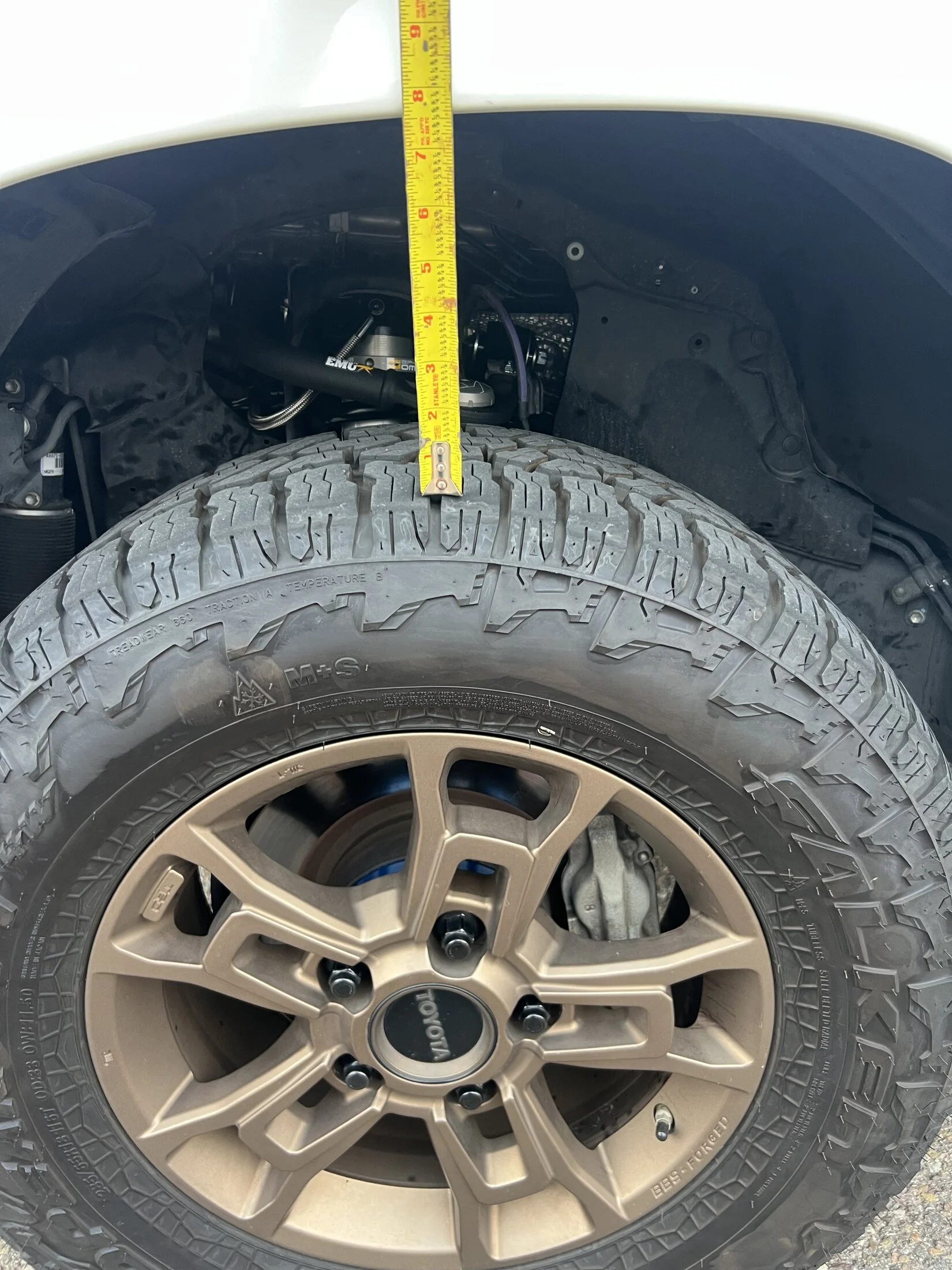

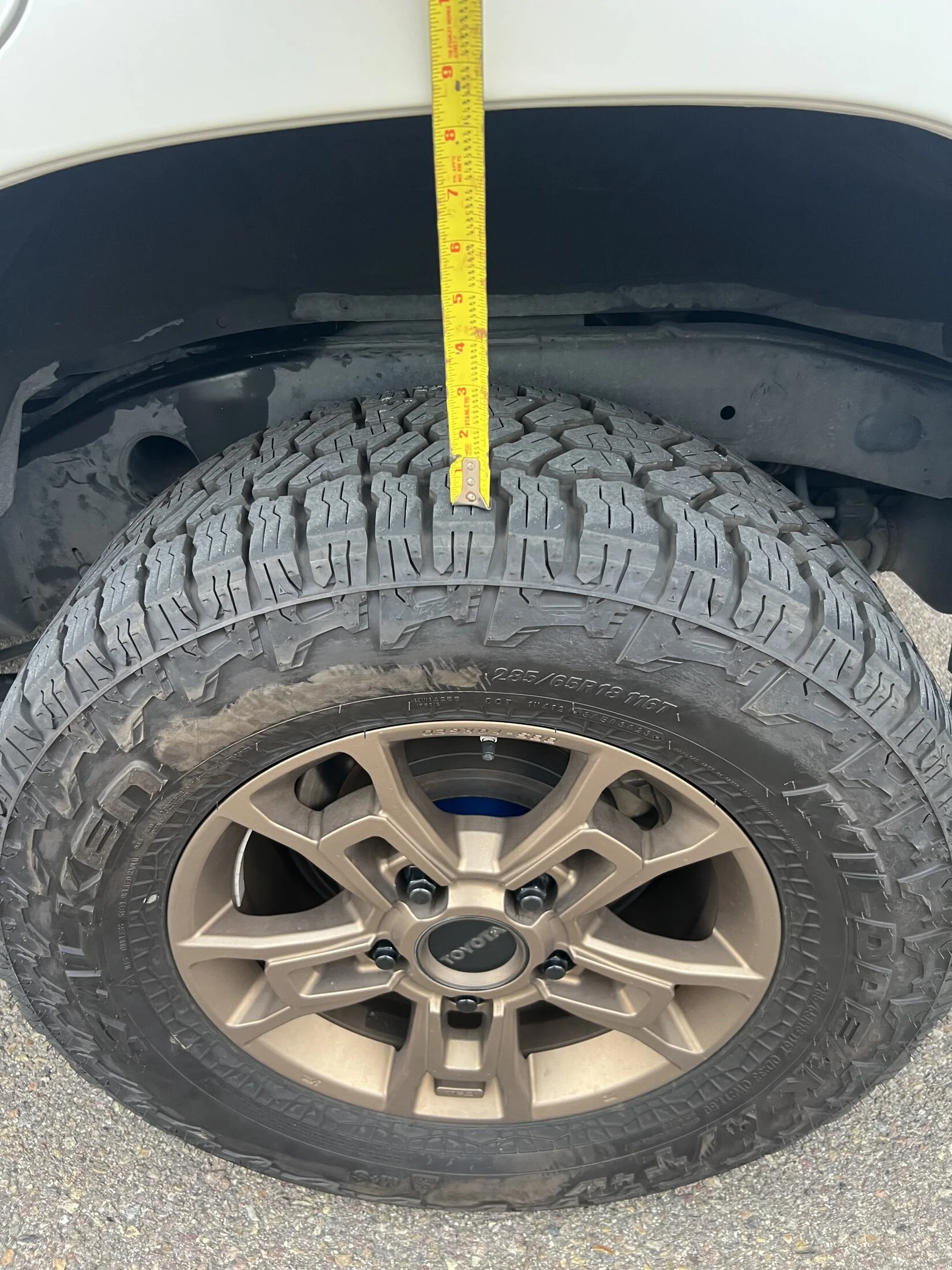

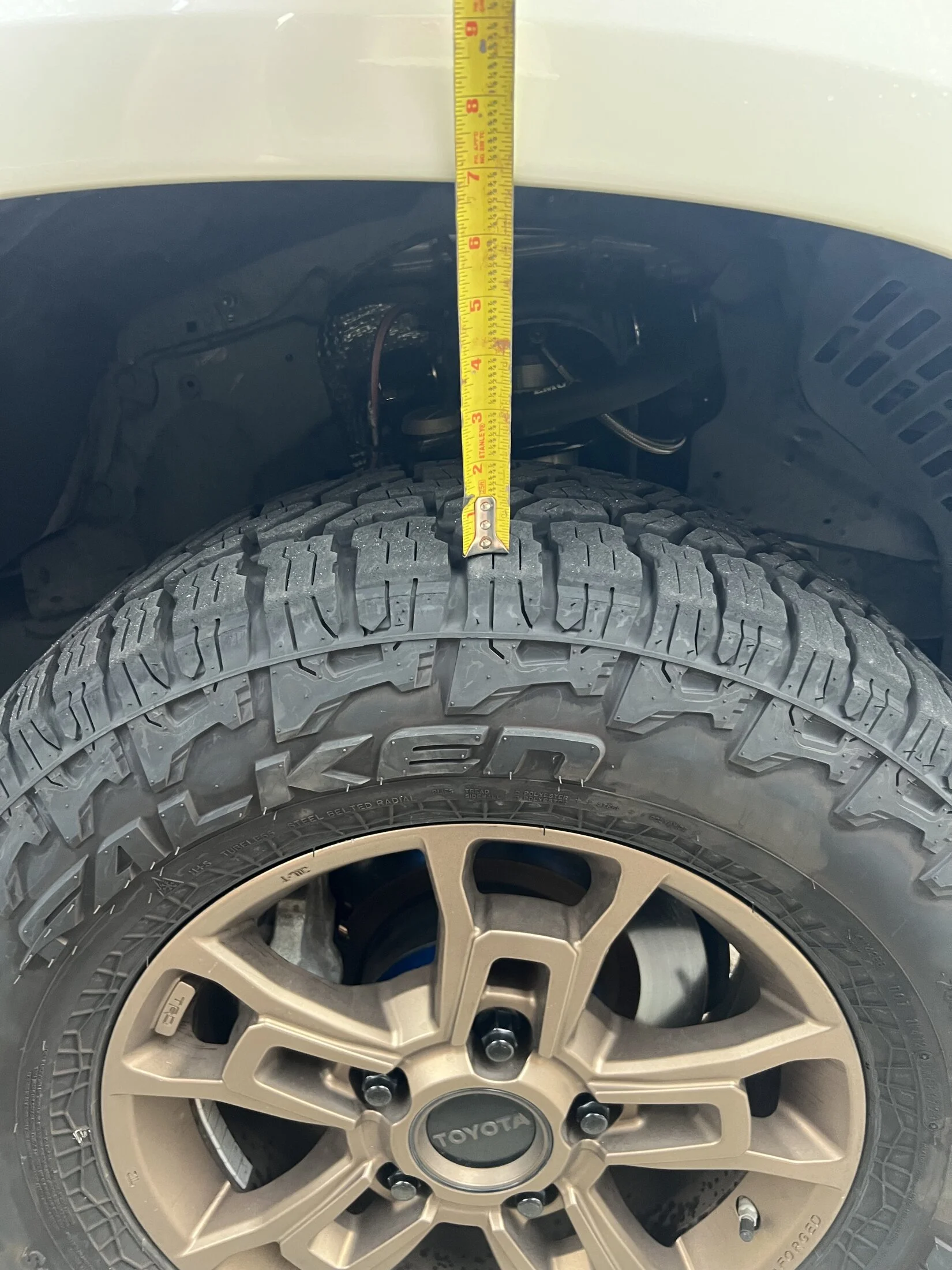

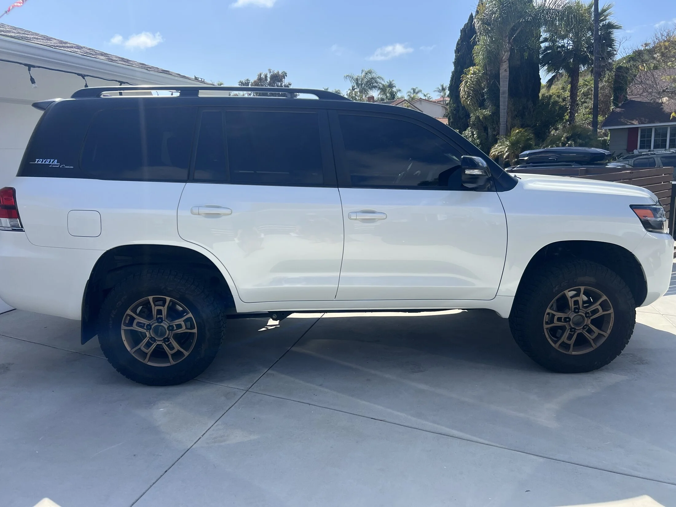

Installed an OME BP51 on my LC today at a very reputable shop. Love the way it rides. I was told the factory setting from OME were kept when installed and they weren’t adjusted at all….but I’m looking at the side to side being almost 3/4” different from passenger to driver in the front and about 3/4 in the rear. Both front and rear the passenger side is lower.
What’s an acceptable difference from side to side?
Pics attached start from passenger front and go counter clockwise.
Curious if this is what’s to be expected or is there something not right that needs to be fixed-and what that could be.

It's best to mesure fender lip to center of wheel. This removes and impact of tire defections and air fill.

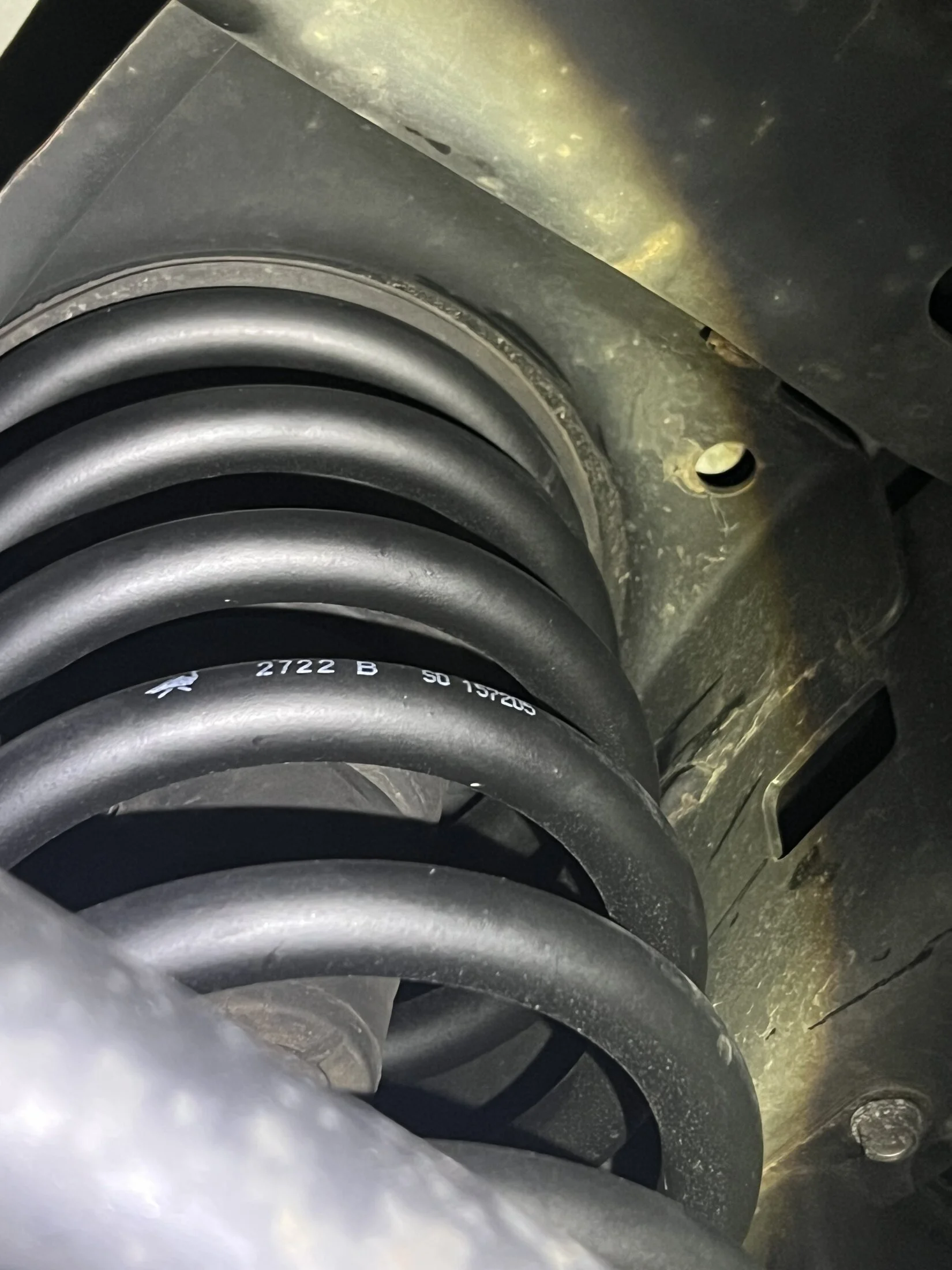

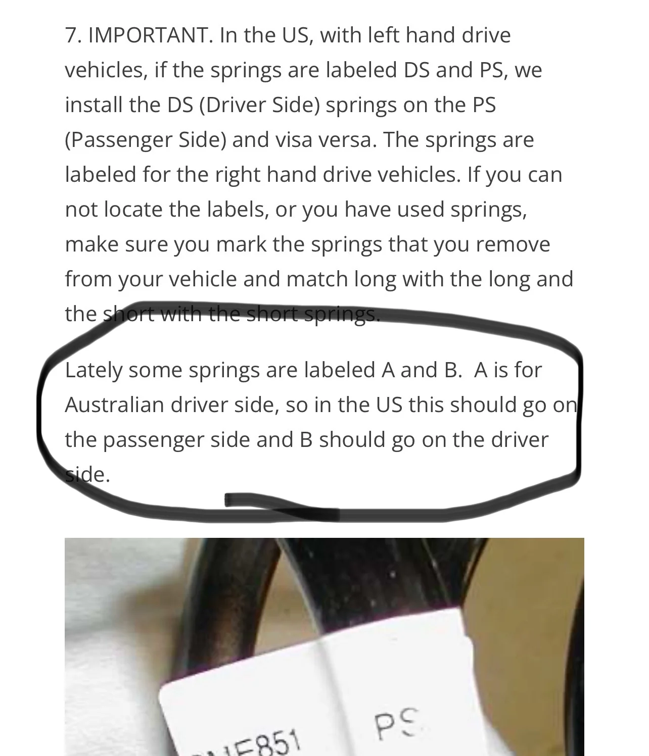

Going with this train of thought I checked the rear coils to see if they were installed on the wrong sides because these are Australian… it specifically states they’re opposite for US cruisers..
they’re on the wrong sides.
Exactly.. got it.
Picture is passenger side
