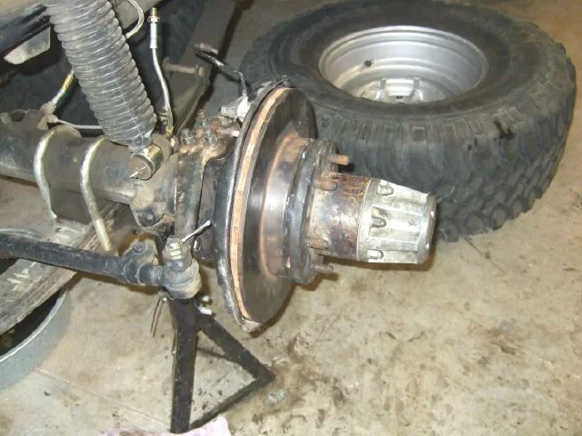

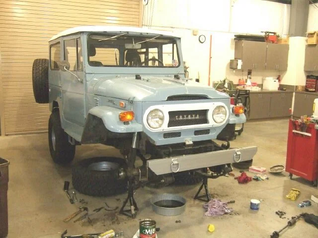

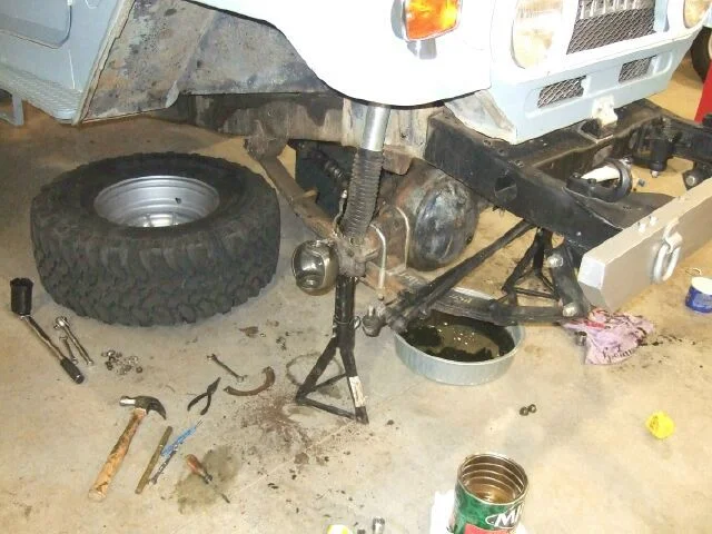

Along that same line, I've spent the last couple of days working on my disk brake conversion. A few minor problems popped up along the way. A few might have seen my post about the calipers not fitting. Poser posted right up what was wrong. I took the calipers back to the parts store the next day and sure enough, they gave me the wrong ones. Got them bolted up without any drama. The big problem popped up when I tried to put the wheel on. No dice. I had hoped I could just grind a little off the caliper, but it is rubbing too much. So, today I picked up a pair of billet 1/2" spacers to see if that would work. But, I'm going to have to get the center drilled out since the hub opening is too small. Arrgghh. And, I may have to get longer wheel studs, too. I could get different wheels, but I like having the stock hub caps. Oh well. If everything was easy to replace on this rig, I'd call it a Jeep!
I don't have any pictures with both sides done since my rig is not at home. I'll get some tomorrow and add them. Right now, I have both sides done with calipers on. I still have a couple days left of my ROTW, so I might as well make the most of it!
