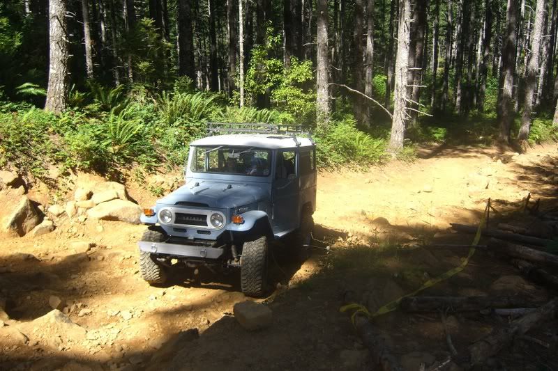

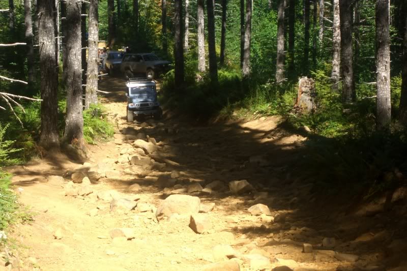

well geez... I dont usually come over to the 40 section but I saw this and thought I would pimp his rig a little more. Here's some of freak on a wheelin trip in Tillamook State Forest not too long ago.
Vid of Freak attacking Fire Break 5....
Pic:

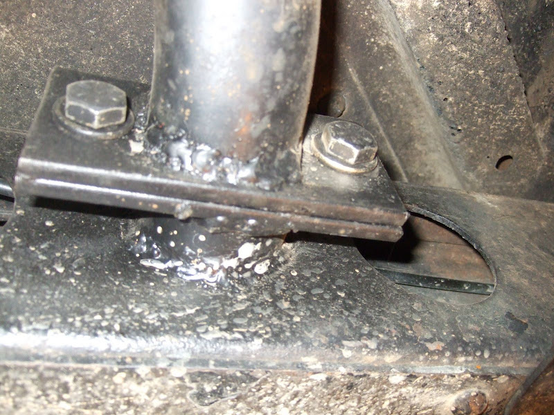

On to the upgrades. Years ago, I replaced the 3 speed with a 4 speed while retaining the 3 speed case. No pictures, because that was several years ago. Besides, it just looks like a transmission. However, I made the cross member behind the parking brake drum removable at that time. That mod has saved me countless hours! Ignore the booger welds. I'm a much bettwer redneck welder now! :hillbilly:
