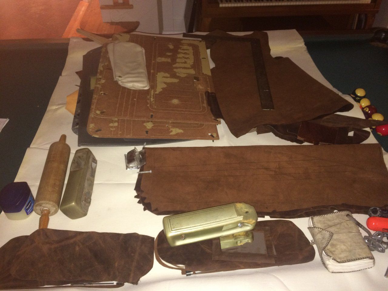

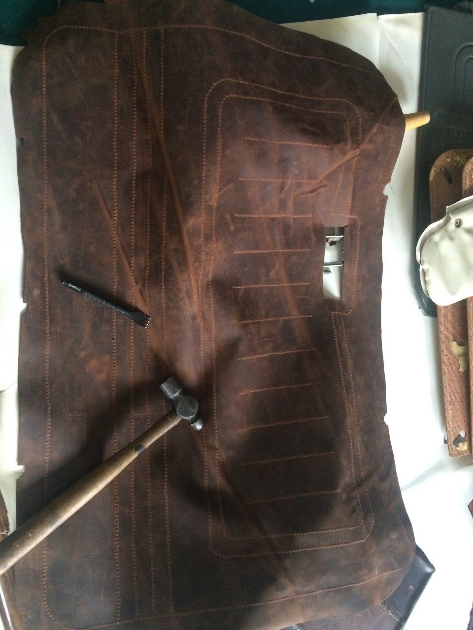

Also we made some new leather shifter boots, to replace the seriously dead oem ones.

Working on reupholstering the inside of the doors, the rear view mirrors and eventually making covers for the seats to match everything.
here is what we have so far.
Every hole is hand punched and it is giving me a headache! :bang:

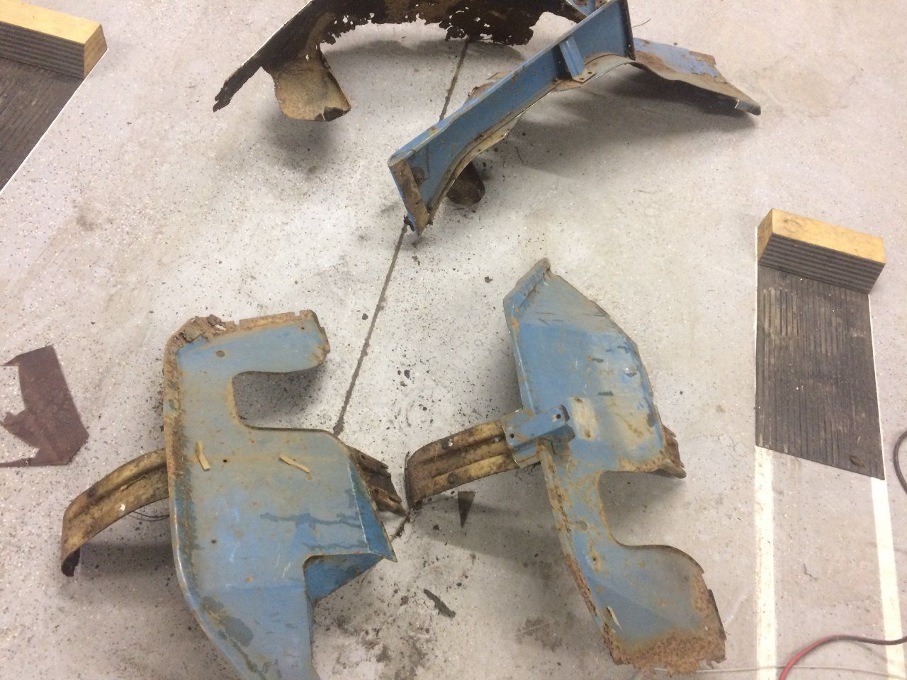

Lots of work on those fenders, I think Steve has a few new sets for a good price at Extreme Bends in Vancouver.

Wiring not for sale. I saw a huge pile of front fenders in Steves shop last week. He has piles of every part, by the looks of it

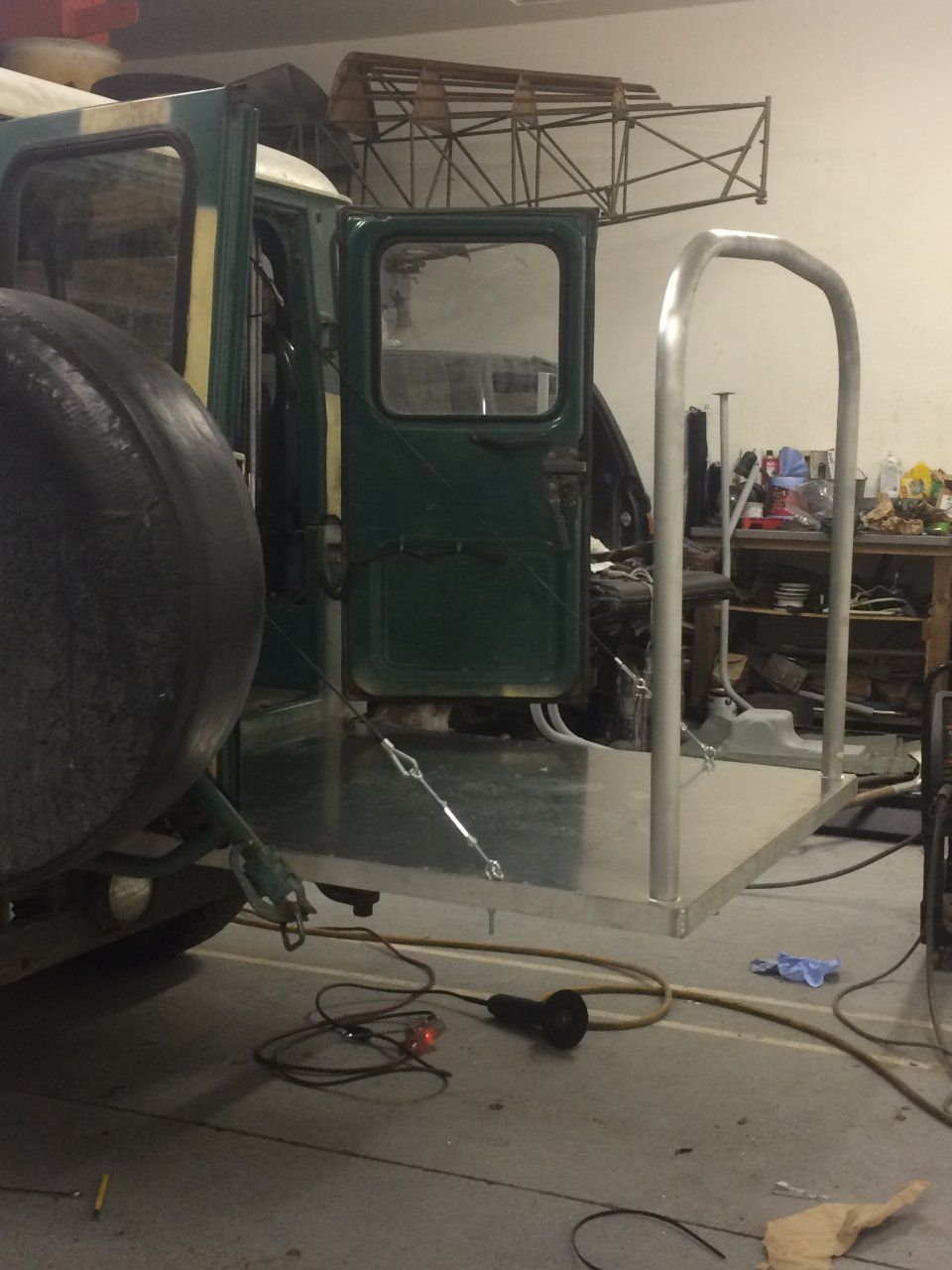

We got some more work done. The bed extension (floor to the pop tent) is made out aluminium and riveted every 3 inches. It is going to be cabled to the internal roll cage and cantilevered out the back, ignore the level "prop". Tomorrow I'm going to bend up the upright for the tent support on the back. We sandblasted the oil pan and I welded up the holes and polished up the welds. Can't even tell they were there. Now we're waiting for primer to dry. Also finally got the engine gaskets so that is going together nicely.

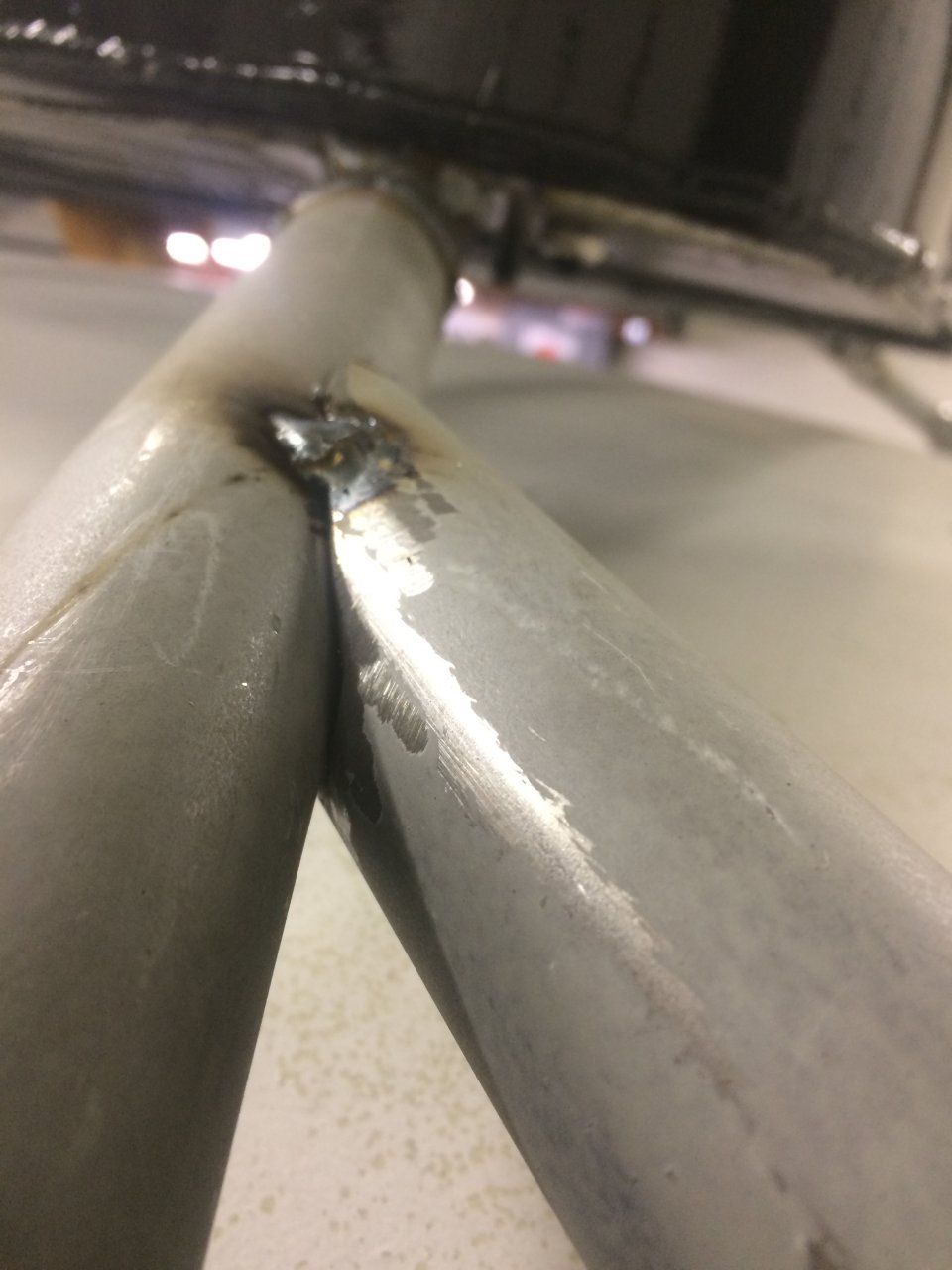

Finally got the supports for the roll cage mocked up and tack welded together. The whole thing comes apart so it doesn't look like some giant electroshock spider monkey when we take it off. Going to finish welding it up today and then spend 4 days waiting for paint/primer to dry.

This is the bracing on the back for stabilizing/rigidity. It wanted to wiggle a LOT before we put these and the diagonal bracing to the front fenders.

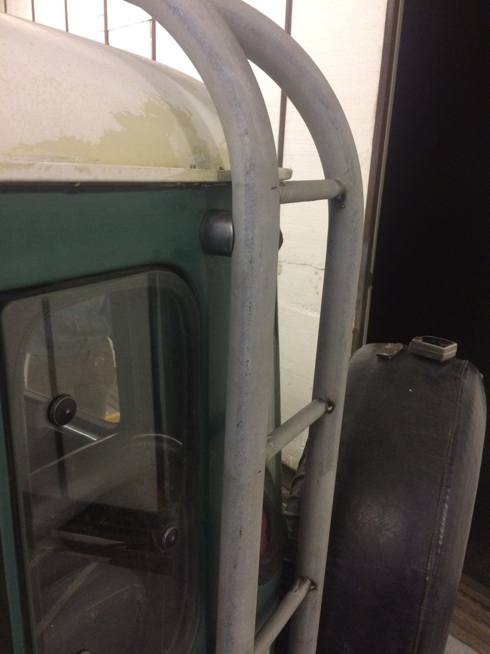

Making sure the back window still opens

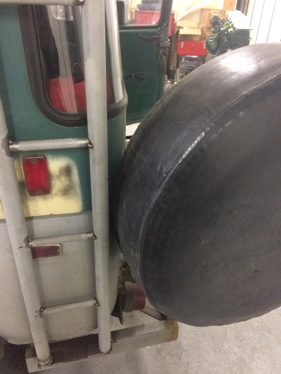

An the tire carrier still swings out all the way.

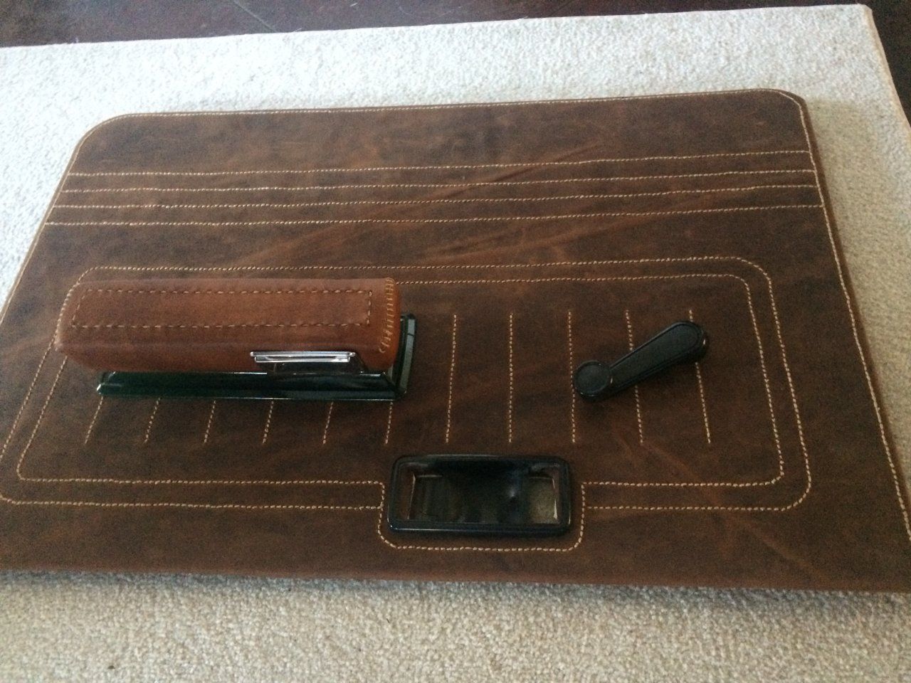

We finally got all of the stitching done on one of the door panels.
hand punched eek
Worth it in the end but omg what a pain
It was worth it!
It was worth it!
Is that going to be enough space between the kick out window and the support? Hard to tell from the pic, but I'd hate to see the window get broken if the frame flexes.
ithe frame is only close when the window is p
opening or closing.
Once it is past the choke point there is plenty of room
