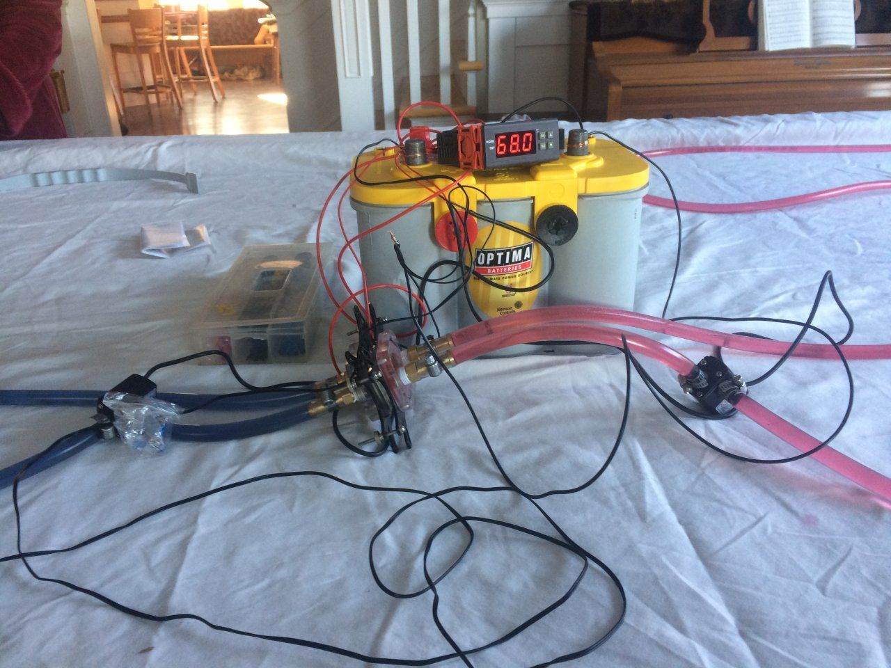

This is the setup for the fridge. i'm testing it in the living room rather than installing it and then cursing and screaming and pulling out my hair. With a couple of modifications I think I can get it to be either a fridge or freezer.

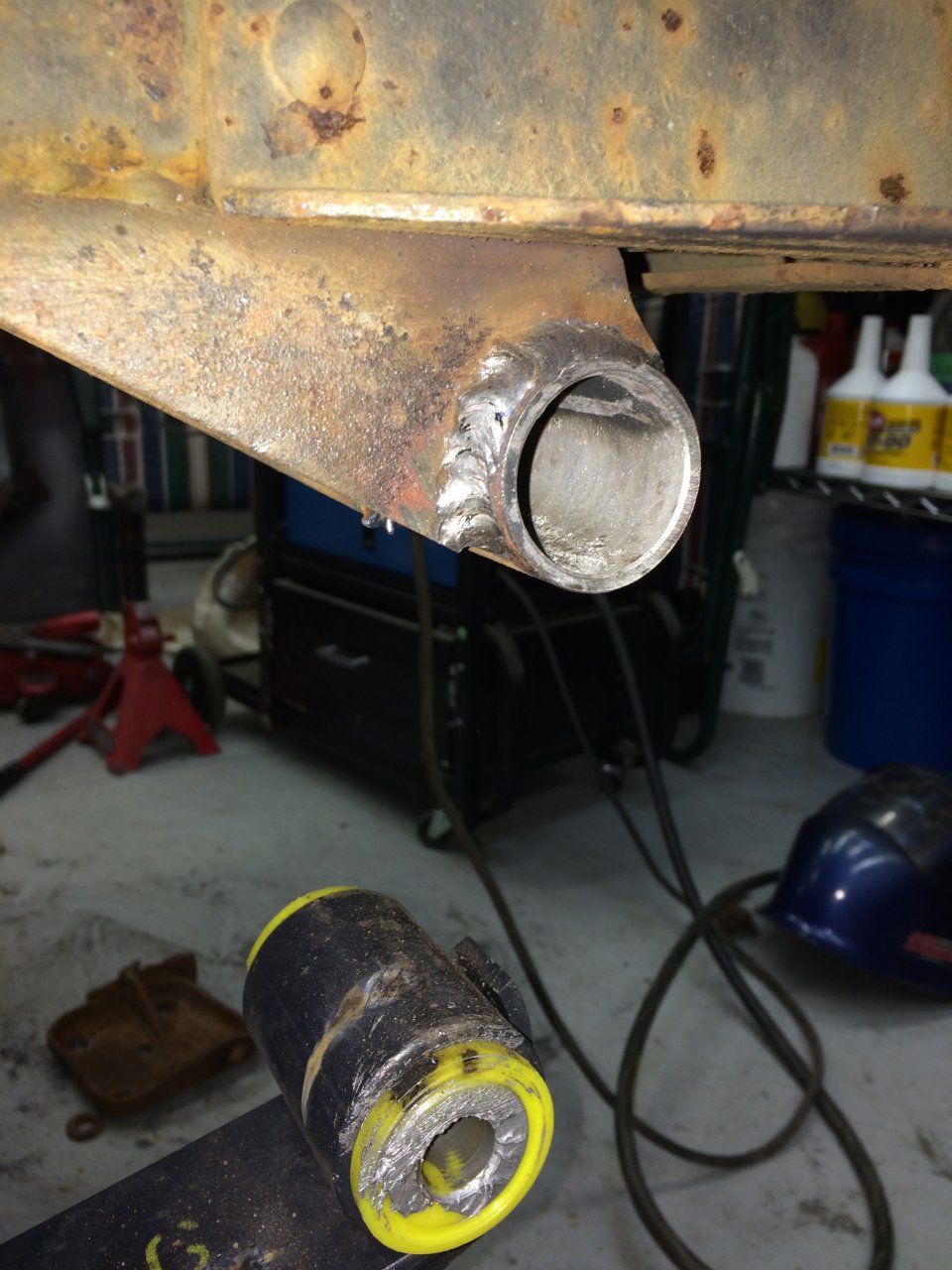

We upgraded the suspension with a full OME "heavy" kit. Full greasable pins all around, heavier leafs and larger 35mm bushings. That meant that we needed to fab new spring and shackle mounts to accommodate the larger, OD and length, bushings but Keith his lathe and lift made that a much easier job. Also mounted the tires on the rims with a boltless beadlock system inside and got them all balanced. The front drive shaft slip joint was seized so we pulled that out, hammered on it in a vice with a hammer and brass drift till it came apart then cleaned it up, covered it in neverseize and put it back in then greased the heck out of it. The rear driver side spring hanger wasn't welded on any more. That was a fun surprise. It was being held on by a very warn old 10mm bolt. Again, no wonder it rattled driving down the road. got that all cleaned up and welded back on.

Making the front and rear spring shackle mounts.
Old shackle hanger and the new tube beside. The new bushings are much beefier. oohrah
