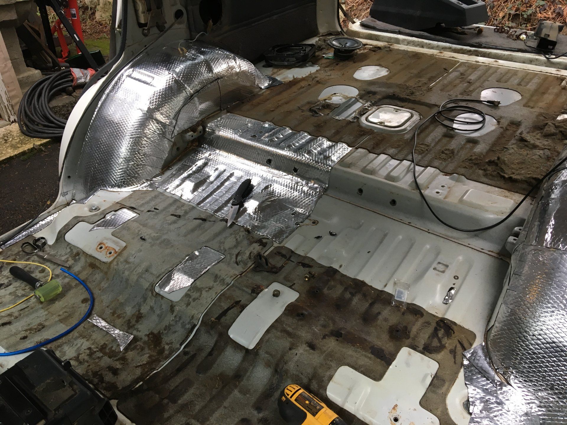

There’s a bunch out there, Dynomat, etc. I used 80 mil thick Noico brand from amazon. It’s peel and stick and comes in about 3’x3’ sheets, you cut it to fit and press it down with a roller (green one in left side of pic)
Here’s a picture mid-project, I guess I didn’t take any when it was done.
For bolt holes you can see the indentation and cut out for them with a knife after installation. It’s well worth the effort.

Much appreciated! Gonna do this. I also spy a BM Griptilian.
