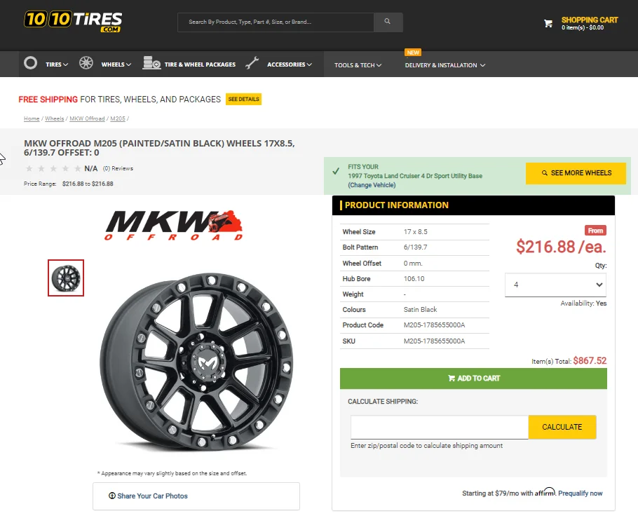

First time posting and in need of assistance. I recently purchased a 97 LC and added a 2" suspension lift from Iron Man 4x4 (which is awesome). I am having trouble finding rims that fit the hub and now debating if I should put on spacers but wanted feedback from people that have more experience than me. I bought the tires already, BFG 285/75/17 and tried getting the rims I bought online installed and the wheels wouldn't slide over the hub even though it showed 106.1mm diameter. Here is the link to the 8.5" x 17" rims I bought, MKW Offroad M205 M205-1785655000A 17x8.5 6/139.7 0 Offset 106.10 Satin Black Wheel | 1010Tires.com Online Wheel and Tire Store - https://www.1010tires.com/Wheels/MKW+Offroad/M205/M205-1785655000A?vehicleid=75369 (image below), in case it's helpful to look at the specs. Is this a common problem? I'm dying to get new shoes put on this and see how it rides. Any recommendations on who I can buy rims from that will fit (assuming I can send these back) or am I okay putting on spacers? If spacers are a viable solution would I need to consider a different offset than these rims I've bought and what size spacer would you recommend, 2" or ? Any help is appreciated. I look forward to adding pictures as soon as I get these rims put on. Thanks again!

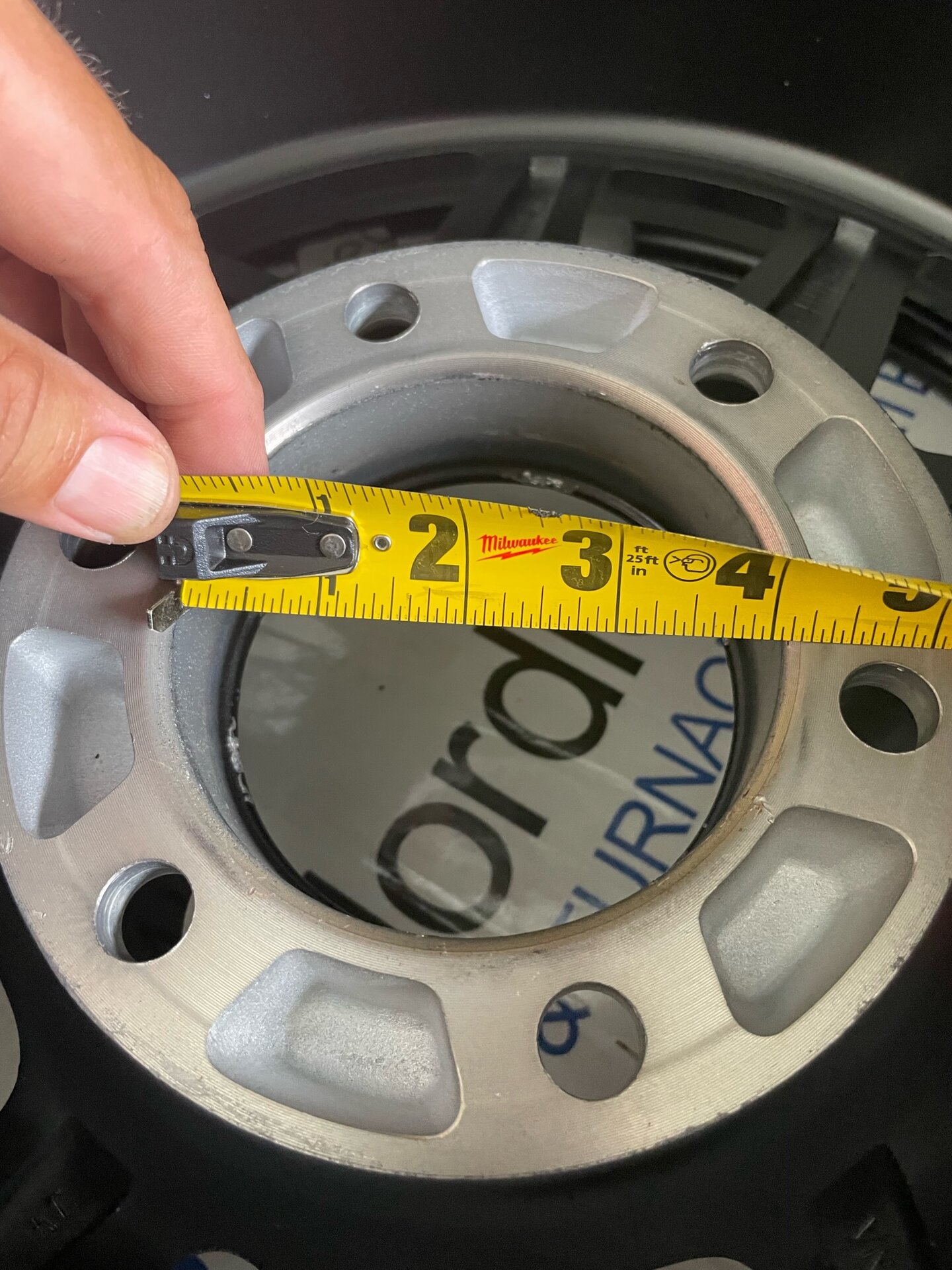

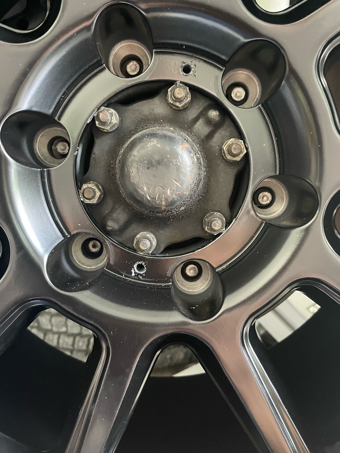

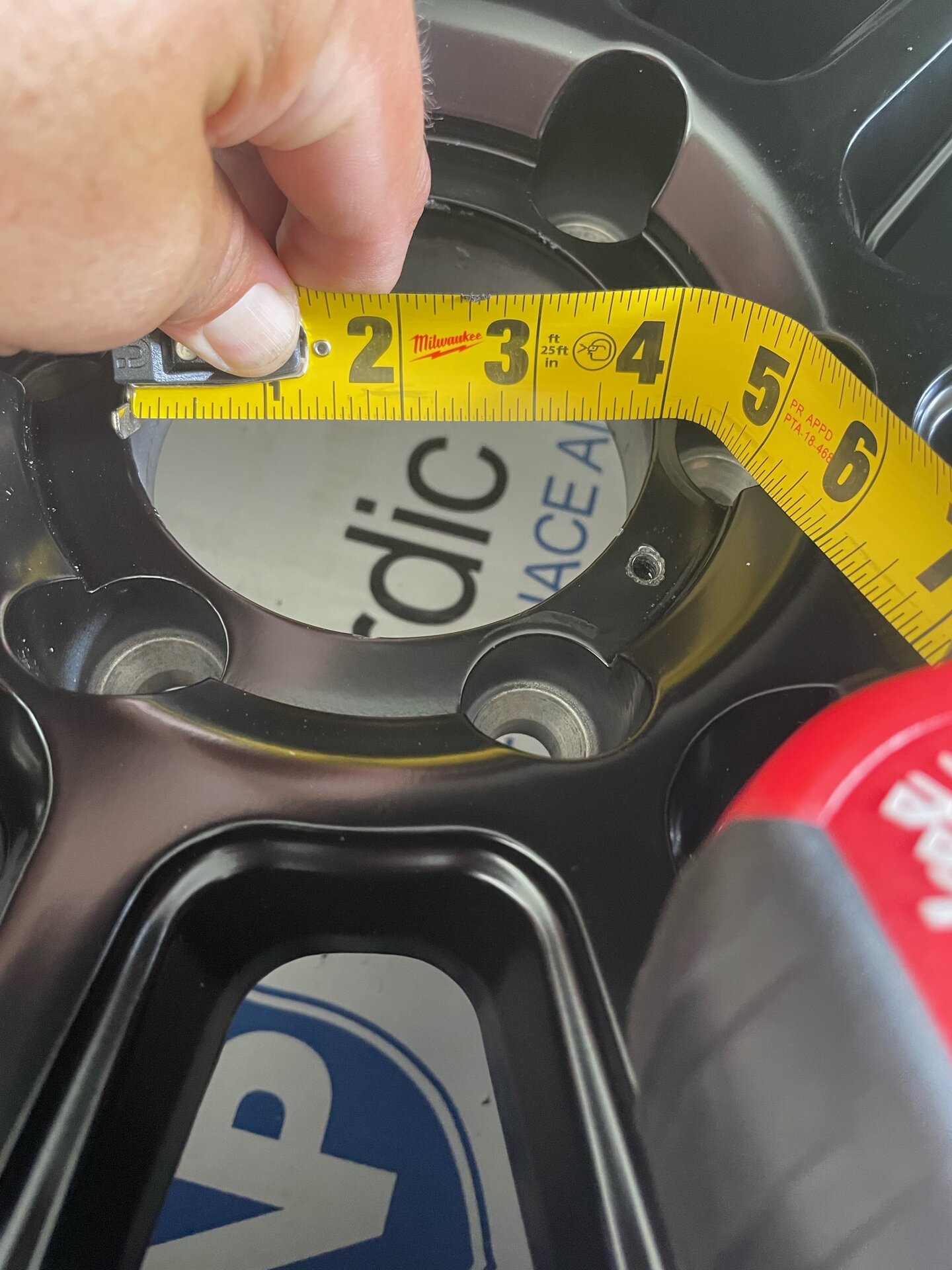

Thank you for all the help. The rims I bought were defective, the inside of the center bore on the rim is correct diameter at 106.1mm but as you slide it over it hits the front part of the rim preventing it from sliding on all the way.
Your rims are not defective.
They have a small lip on the outer edge of the bore. (Look at your picture where there are scratches from hitting the center hub.) This is common on many rims even though the over all center bore is correct at 106.1 mm. I think this lip is often used to help mount a center cap.
Many vendors or manufacturers don't specifically mention this aside from not listing the wheel as approved for the Land Cruiser. It is this lip that needs to be machined off that @BILT4ME mentioned above. If you do not want to machine that lip, then your only options are return the wheels or install spacers.
The word defective may have been the wrong choice of words but bottom line is if they build it to the correct spec it would slide over the center hub without the purchaser having to take it to a machine shop and grind it down. This website says "Guaranteed Fit" for 97 FJ80 so hopefully they will honor that. I appreciate the quick response and feedback.
