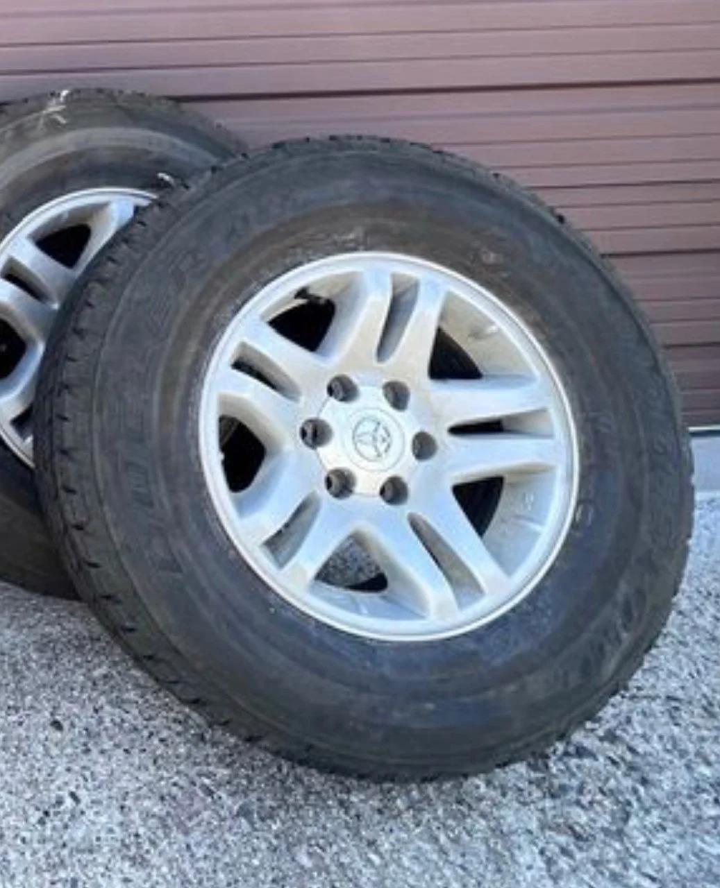

I recently purchased a '97 LC and it came with, what I assume are, 17" Sequoia rims (pictured). My buddy was worried that the offset was not correct and made the platform too narrow....potentially causing a rollover during off camber trail situations. Does anyone know the measurements on these as they compare to the stock 80 wheels?
Man your buddy must worry a lot!!! You will be just fine with that offset. We are talking inches of difference not feet.
Curious what the offset is on the Tacoma rims. The 80-series rim is zero offset AFAIK. With wider taller tires - 35" eg you can get some frame rub at full turn. A narrower offset could potentially exacerbate that.
I am running the 17” Sequoia wheels on my LX450.
You will need 1.5” Spydertrax spacers I got from Slee.
I found a 35x11.5” tire which would bring it exactly back to stock width.

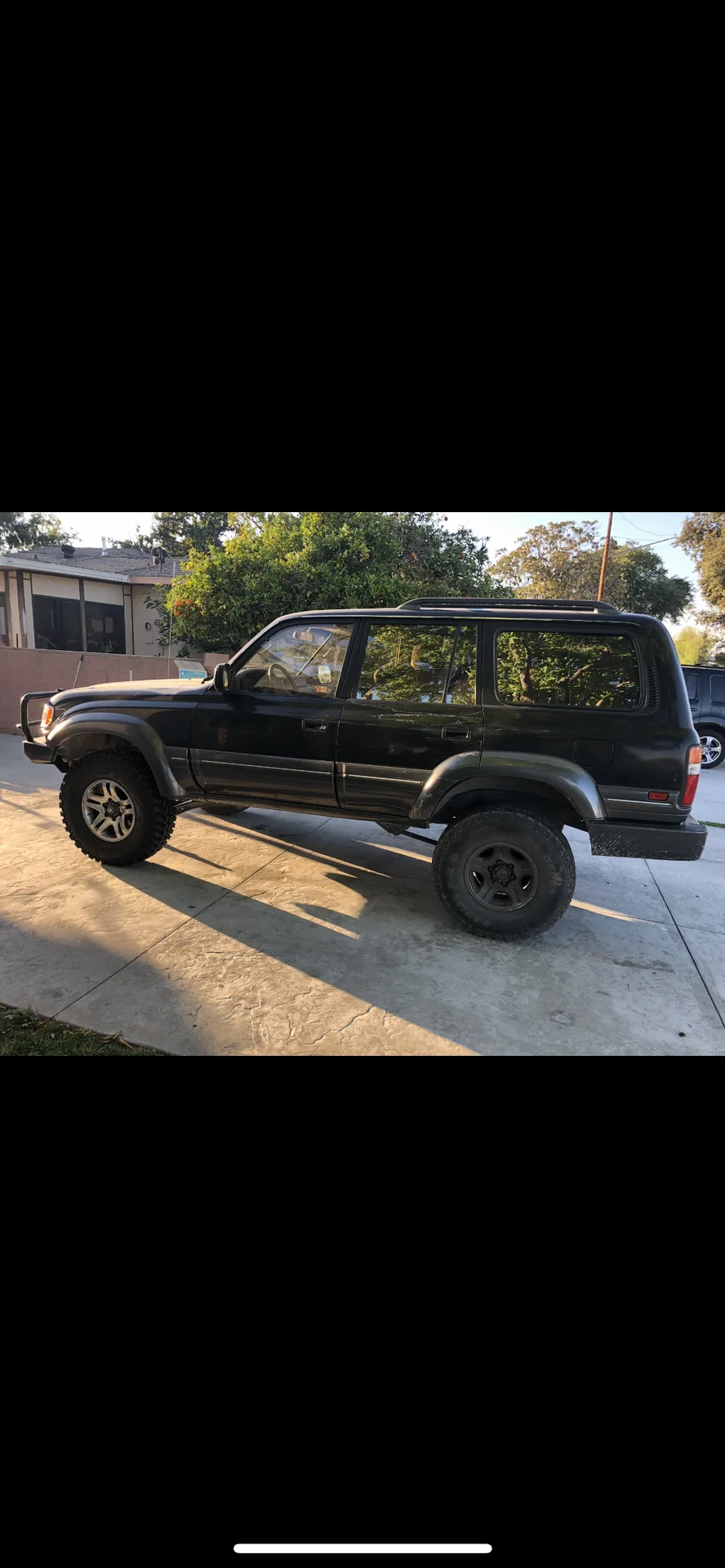

See attached photo for comparison. Stock 16” LX450 wheels (painted black) compared to the Sequioa wheels.
