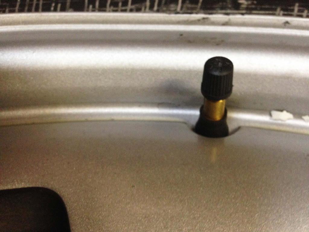

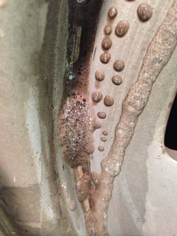

Another data point, or 3, now that I'm recovered from my gall bladder being evicted. I soaped the known problem child, hoping it was just the valve steem. Turns out the biggest leak is next to it, but definitely not the valve steam, so no easy fix.
Then there were two more smaller leaks, all again on the weld that holds the wheel disc to the rim.
Not pulling the wheels off today, but there may be more of the same thing on the inner side. This is bad enough, because it look just a year to go from one leak to 3 more.
AFAIK, the other identical rims we have show no sign of this. This one just seems not have been properly prepped before painting and has now started showing the issue. I can see why they would be reluctant to weld up so many issues. It'll be a losing battle, at least on this one wheel.

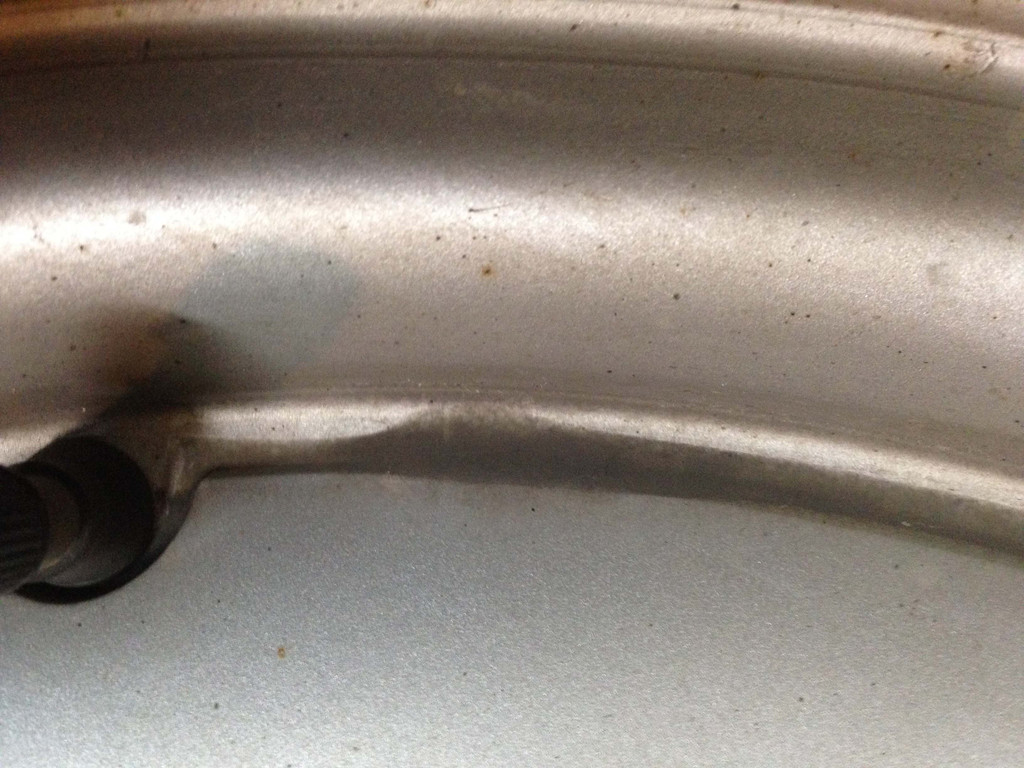

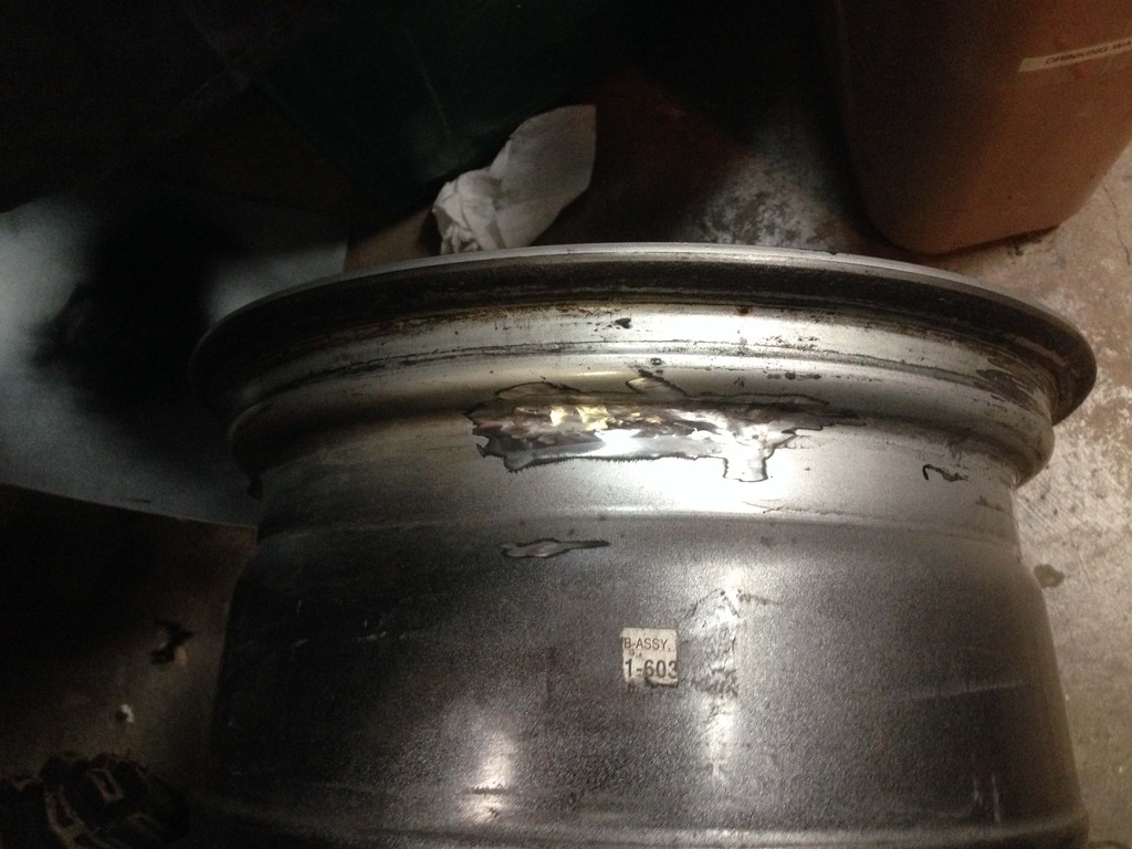

Some updates and perhaps some clues to what's going on with the flaky wheel.
First, inside the wheel with a pic of the weld that was done last year and lasted about a year.
Pics of the bubbles at the weld are above in a previous post. What's interesting is that I can see no obvious holes that could be the source of the leak, although I haven't gone over it with a microscope. The leaks were widely distributed around the rim.

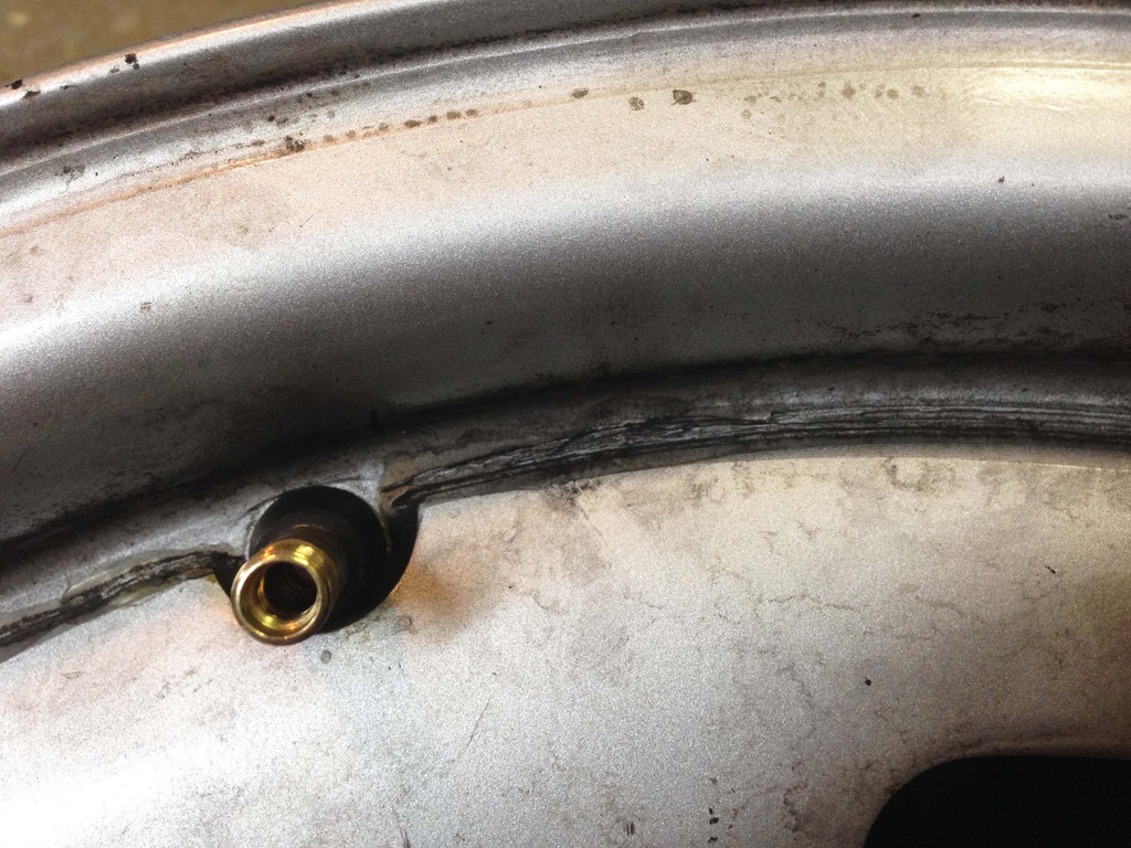

Now here's the best pic of the area on the gailed rim that was a big leaker, next to the valve stem.
Looks somewhat crunchy in that weld to the right of the valve stem and I suspect a somewhat incomplete weld. This was covered by the finishing and was OK until the issue arose, nearly a decade of service.
Here's another from this group of rims, all purchased from a reputable MUD vendor. I wouldn't call it a "batch" of wheels, as IIRC he had three in stock and need to pull the others from around the country. This wheel has had the same life cycle of environmental exposures as it's sister rim, but look at that same weld.
Even to the naked eye, that looks much bette. And this seems to be the case with the other 3 original rims.
Here's a pic of the new rim.
So this, along with a lack of similar issues on the other 3 rims, seems to back up my conclusion this is a bad wheel, not a bad wheel design. I thought it important to note the issue here, just in case you've got these rims on your truck. There could be others, although the general lack of response to this thread suggest it's very much not the rule, but the exception with these fine wheels. Now we've giot some evidence to share and this should help tell what if anything needs done about any of your heavy metal.
