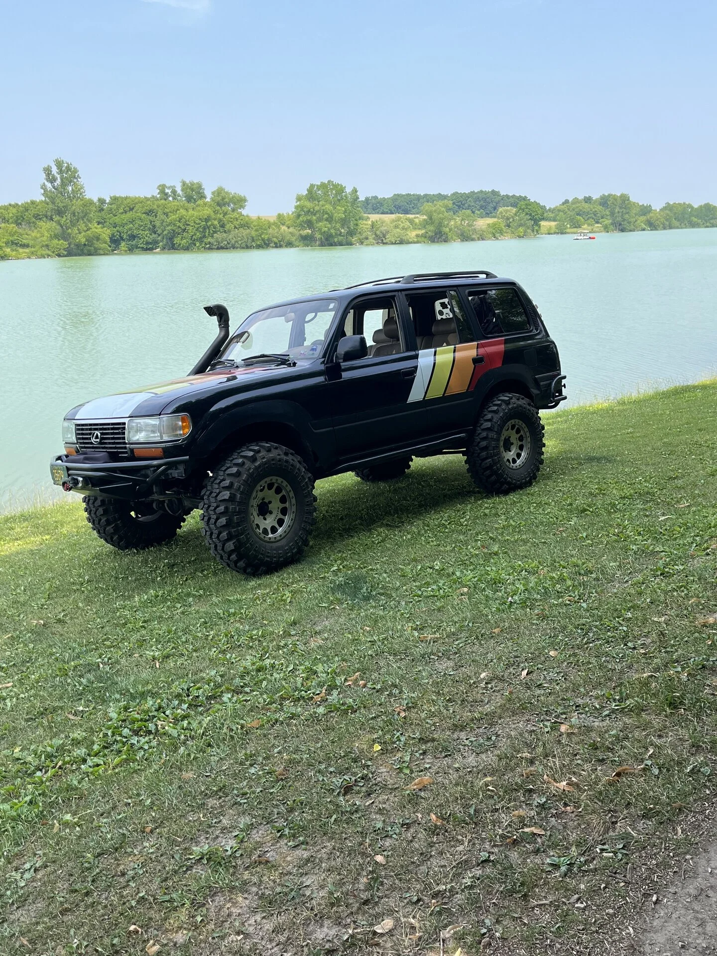

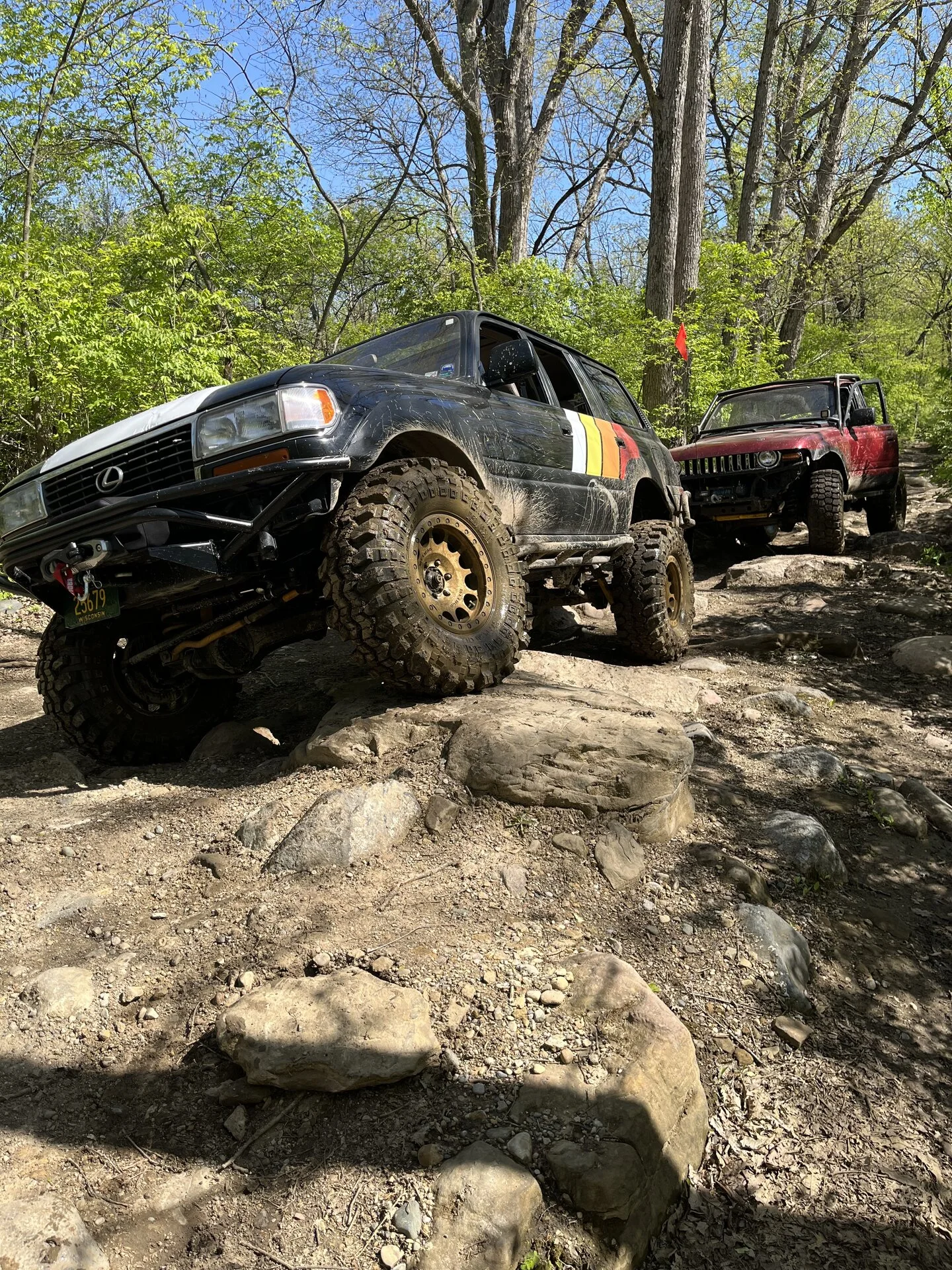

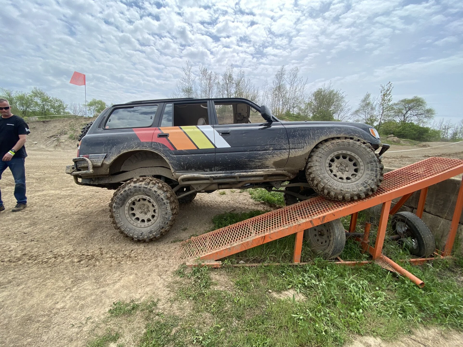

Im running a 37x14.5 SXIIs on my Methods and 2" springs. Havent done any bumpstop changes, I am running the @eimkeith RAMs and they tuck without rubbing. Ive posted a few pics of it on here.
Post some pics here.
