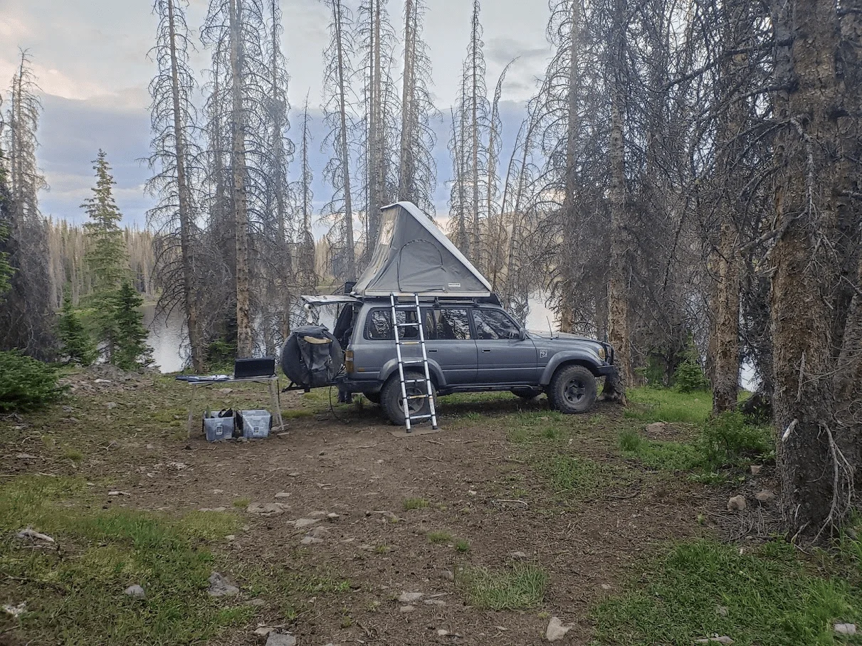

I didn't read all the comments but I've been having a blast with my 80, doing remote work and such w/o a single bit of worry. It gets me there and back reliably and comfortably. I installed seats from a 2006 LR3 which really helped with the ergonomics over these long trips. The rig has been sound deadened, and a wind fairing in front of the Autohome Columbus RTT helps with the noise, which is great over a long trip. I'm not sure if the running costs are that high, for me at least, but the smiles/gallon is definitely up there :hillbilly:. More info on my sig line.
