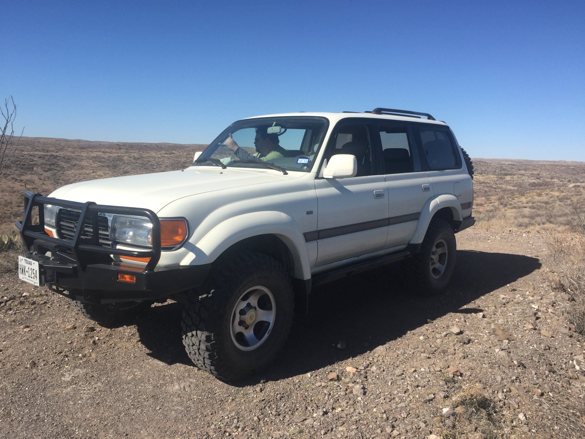

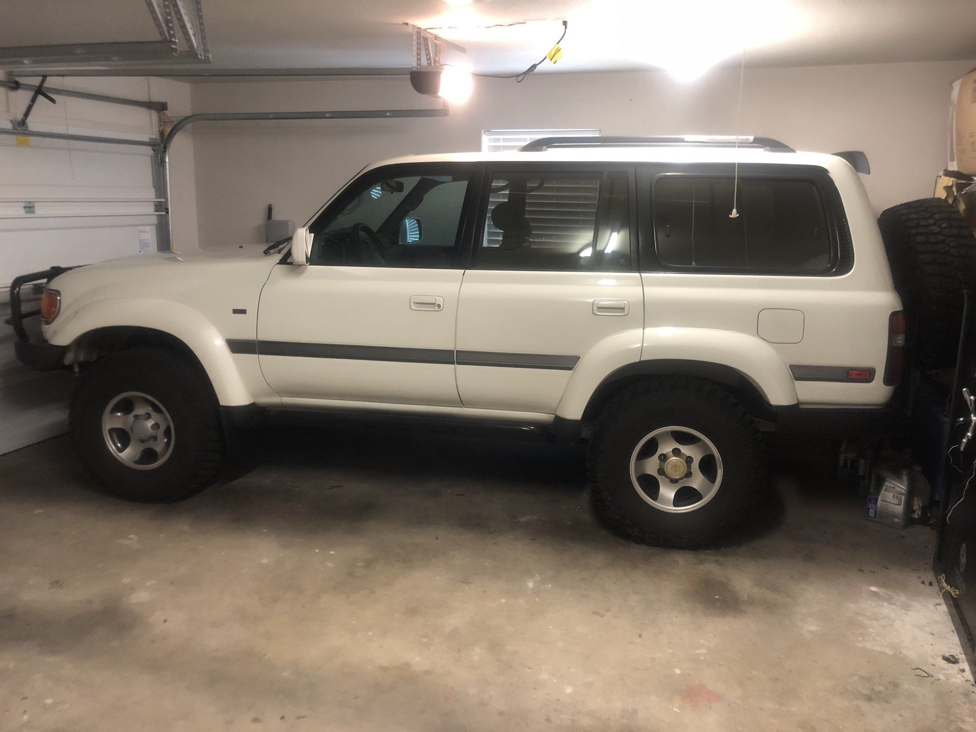

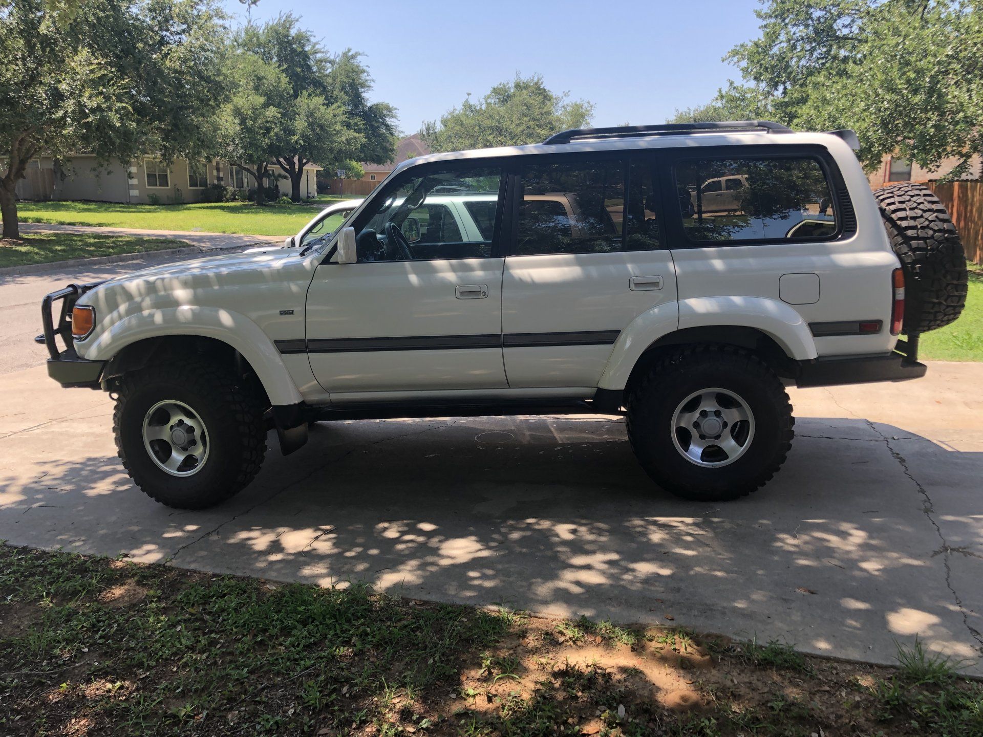

1997 CE, Mangnuson Supercharger, ARB front bumper, Warn 12k with wire line, IPOR rear bumper, 24 gallon LRA aux, standard main tank, Slee sliders (now step sliders), Icon Stage 1, 3” lift, 30mm spring spacers on driver front and rear.

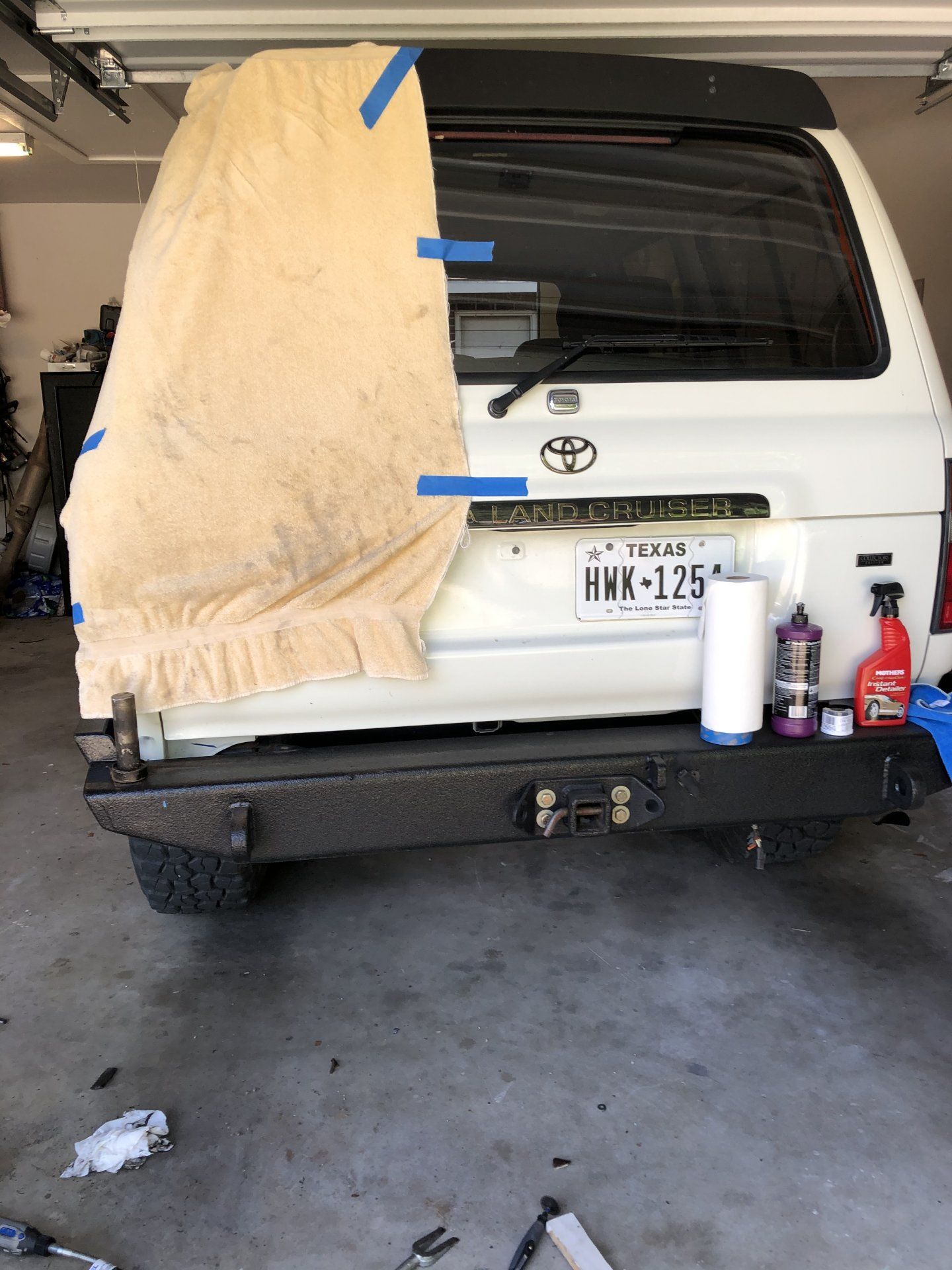

Recently removed the rear tire carrier for the sake of convenience (the grocery store curbside pickup kids couldn’t operate it...yep! I said it!!) and to look less “overlandery”. Threw the spare in the back. No height change in rear. Interior is all stock, no storage, no stockpile of tools.

As always, pictures are welcome haha! And nice! It sounds like we are in the same ball park. I have front and rear bumpers, sliders, winch, etc. The reason I asked is I wasn't sure if you had a similar amount of weight. Obviously an aux tank would add a higher percentage of gross weight to the vehicle if you were bone stock (minus the tank itself) vs our 80's which are armored and lifted.
