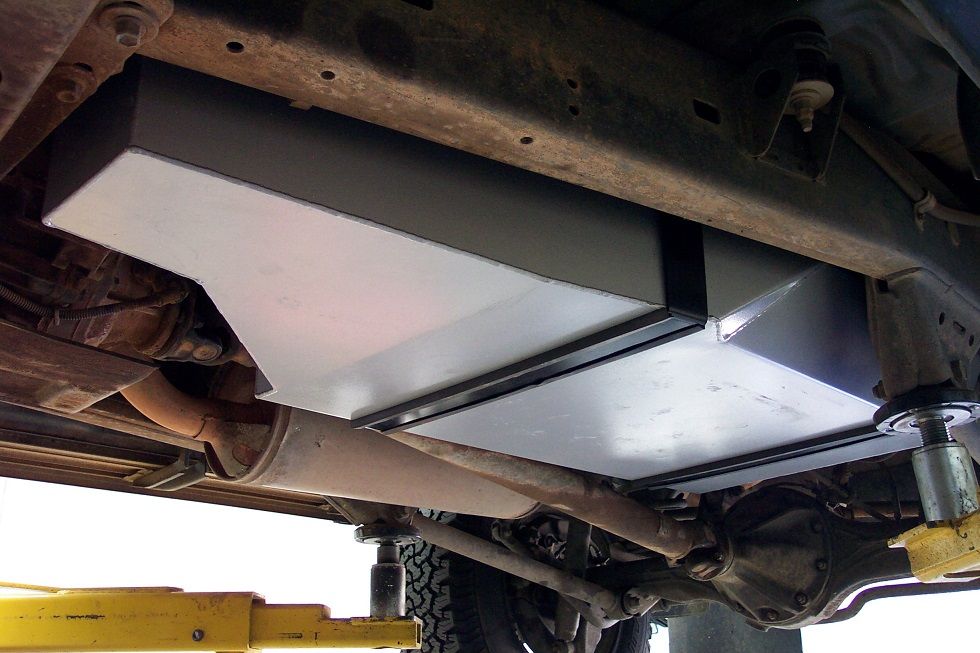

Doesn't LRA offer a replacement main that's above the frame rail? Maybe I'm dreaming.

Here is a pic of how the LRA replacement sits.
Yes, you'd be adding weight behind the rear axle but you'd be doing the same thing if you mount jerry cans to the rear bumper.
Most definitely not the same. All that weight, that low, quite literally directly behind the rear axle will have a different effect on overall driving dynamics than having jerry cans mounted higher up off your rear bumper.
Not trying to start an argument, trying to learn. Why, exactly, would that be any different? The rear axle is the nearest load bearing point in terms of the vehicle as a whole. So weight mounted on the bumper vs under the frame still loads the rear suspension. Only difference I see is an off-camber situation where the height above the rear axle would drastically affect stability.
Lol. No argument here, these types of discussions can be good. Worth pointing out I'm no mechanical genius either, but there is a lot more to it than just what is the "nearest load bearing point". Proximity to that point, proximity/placement to the vehicle as a whole + many other things I would imagine all play a part in how its going to feel on the road and how it effects stability. I'm not saying that a full LRA tank is going to make your 80 feel like a haphazard jalopy, but it will definitely change how it feels in comparison to a couple of jerry cans off the rear bumper.
Ah, I think I read your first post wrong. I definitely agree that 20 or more gallons of fuel in an aux tank is different than 10ish gallons on the back bumper - more weight = a larger effect on vehicle dynamics. I was talking more about placement. I understand that weight on the rear of the vehicle can cause the front to walk if it's excessive. But, weight being equal, I don't see a difference between bumper mount and the spare location.

You have any trouble dragging that 24 gal tank on rocks? Just curious. It looks huge.

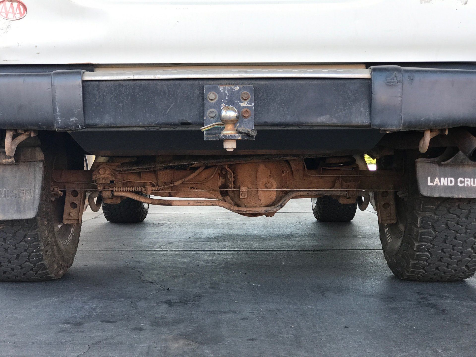

I remember seeing a few pictures of these and for some reason they looked like they hung down lower than that. I'm on a mild lift with 35's and have a Slee rear bumper so I wonder how it would jive with the LRA tank.
There are two LRA aux tanks for the 80: One is 24 gallons, the other is 42. In my opinion the 42 compromises ground clearance too much. I don't know their compatibility with the Slee bumper (fastenings for either).
Agreed, the 42 hangs down very low. The 24 tucks very well. The only downside I’ve found to the LRA aux tank is loosing the spare tire location. But after going to 315’s you mostly lose the ability to mount a spare there anyway.
I don’t notice a handling difference between 48 gallons of fuel or an empty fuel load. I do notice 1/2” of rear suspension squat when fully fueled up. After I burn 10 gallons the squat is unnoticeable.
