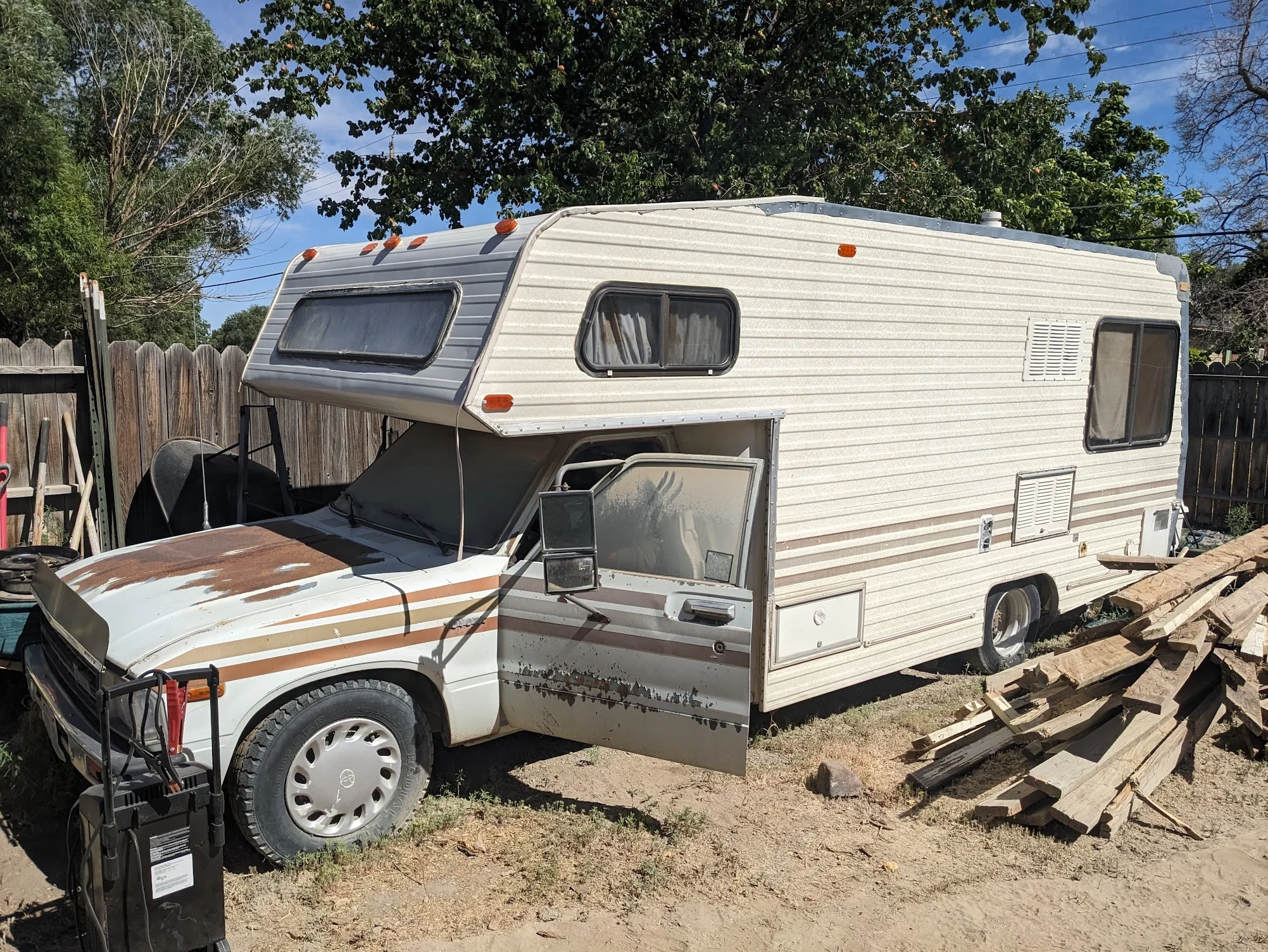

Pic as promised:

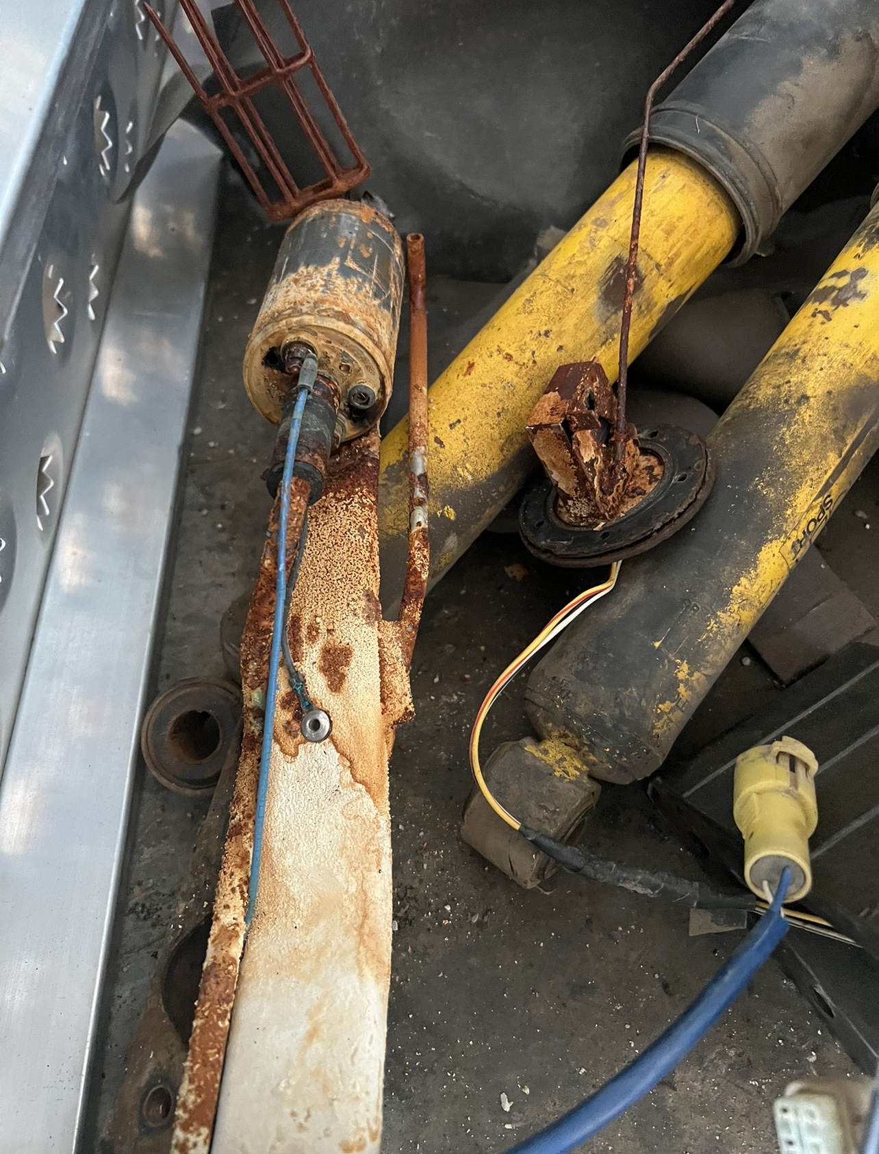

Great looking camper!!! FYI-I just pulled a tank from an 86 PU, the fuel/varnish was easily removed but there was a lot of rust in the bottom. I ended up replacing the tank to make sure none of the solids caused problems later. You might be able to inspect it with a camera from the fill tube, in lieu of dropping the entire tank??
I would inspect the tank. My 84 sat from 17-23 and the fuel tank was awful. Full of rust and it ruined my intake pump, holder and sending unit. It has also ate my fuel pump sock. Last thing you’d want is for the fuel tank to plug filters again and again on a long road trip imo.
