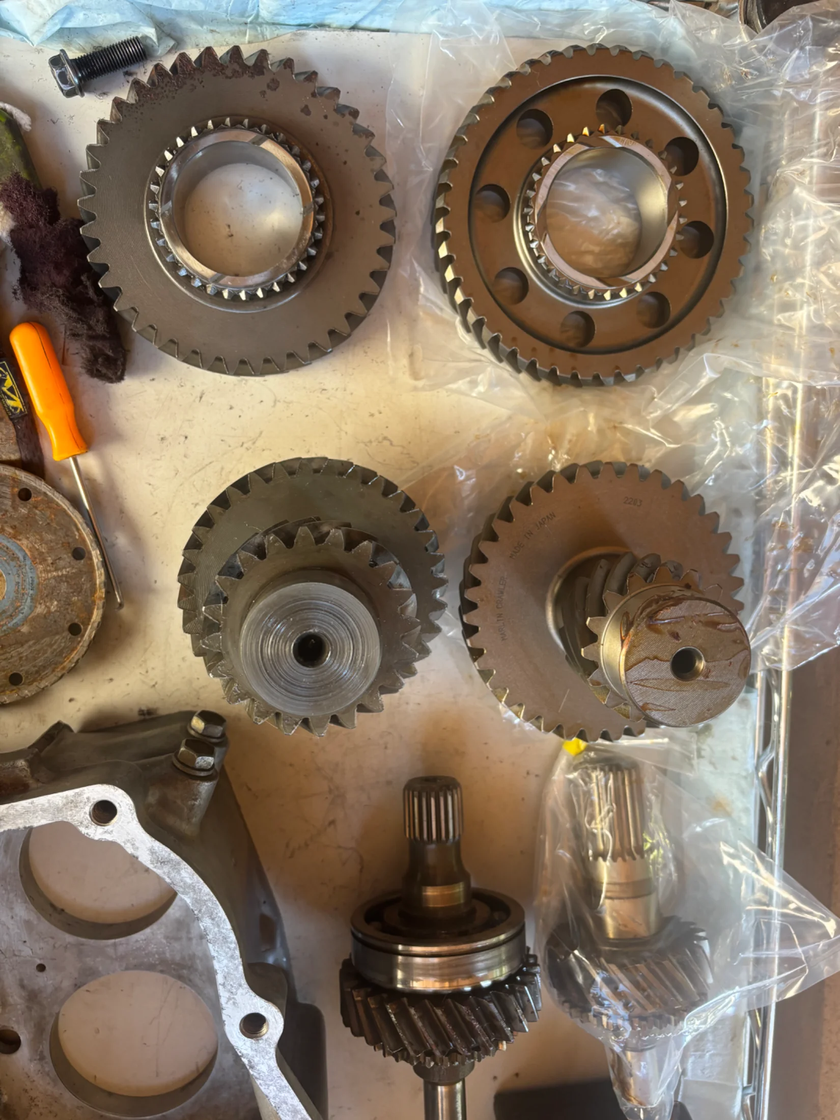

So I ordered MC Japanese made 23 spline competition 4.70:1 crawler gears and t/c gaskets during a 10% off sale so I finally pulled the trigger on the “starting gun”.
Off I go! Herd o turtles race, or er eh crawl.

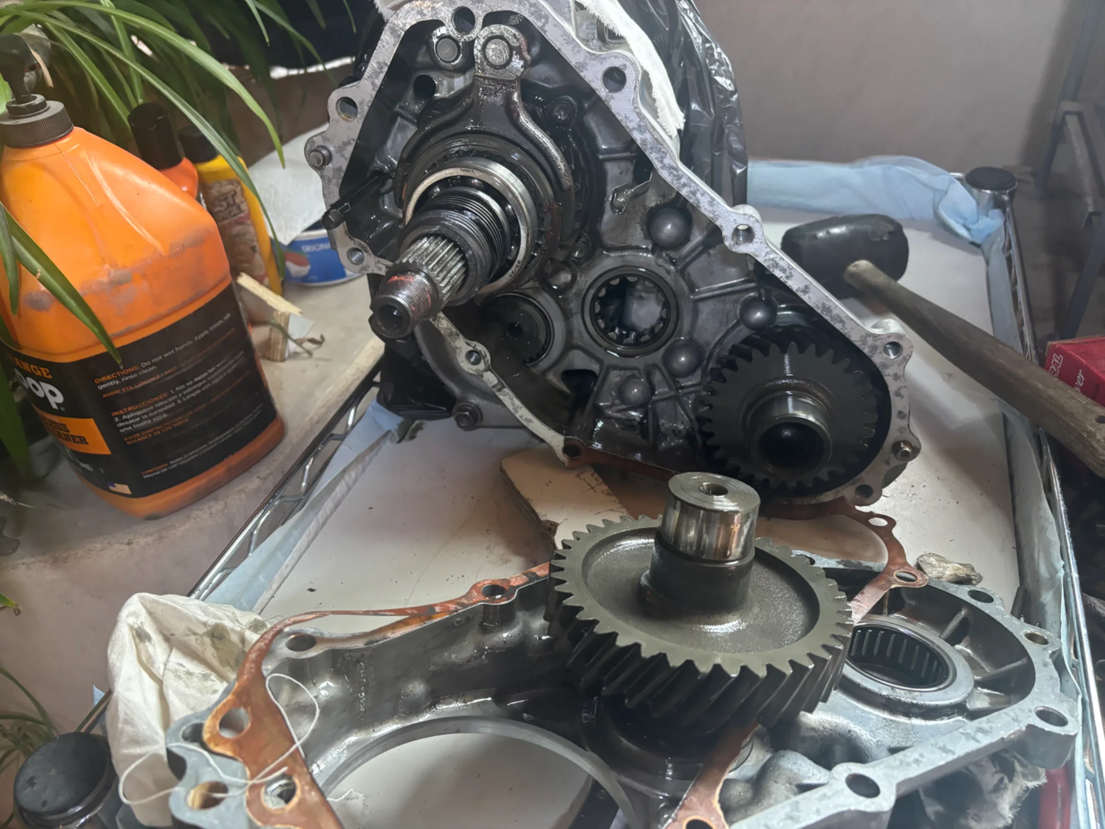

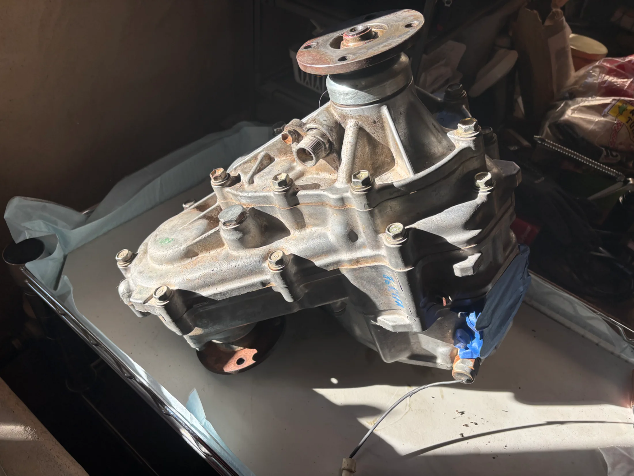

I cleaned up my donor t case that I had bought from my neighbor for 100$. I drained the stinky gear oil awhile back and @Mesa Woman 💋was cool enough for me to bring it inside the house to rebuild it where it’s warm over the winter.
The MC 4.7 gears are tough and full of improvements over the stock gears ! I plan on having plenty of time to do this build right while still keeping the integrity of the 1st gen 4x4 charm intact. Out with the old, in with the new!

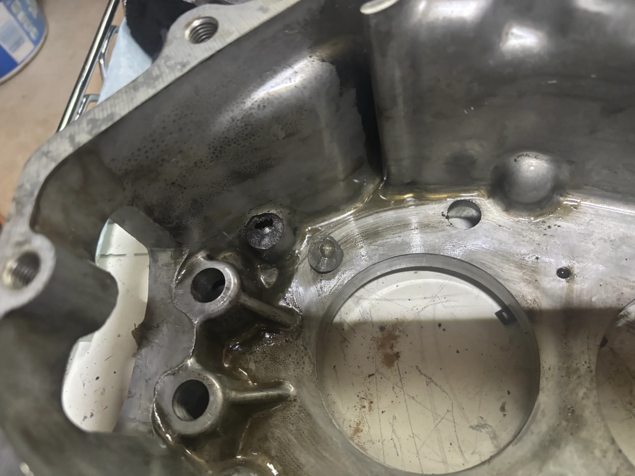

I discovered this broken off inside the case🤬

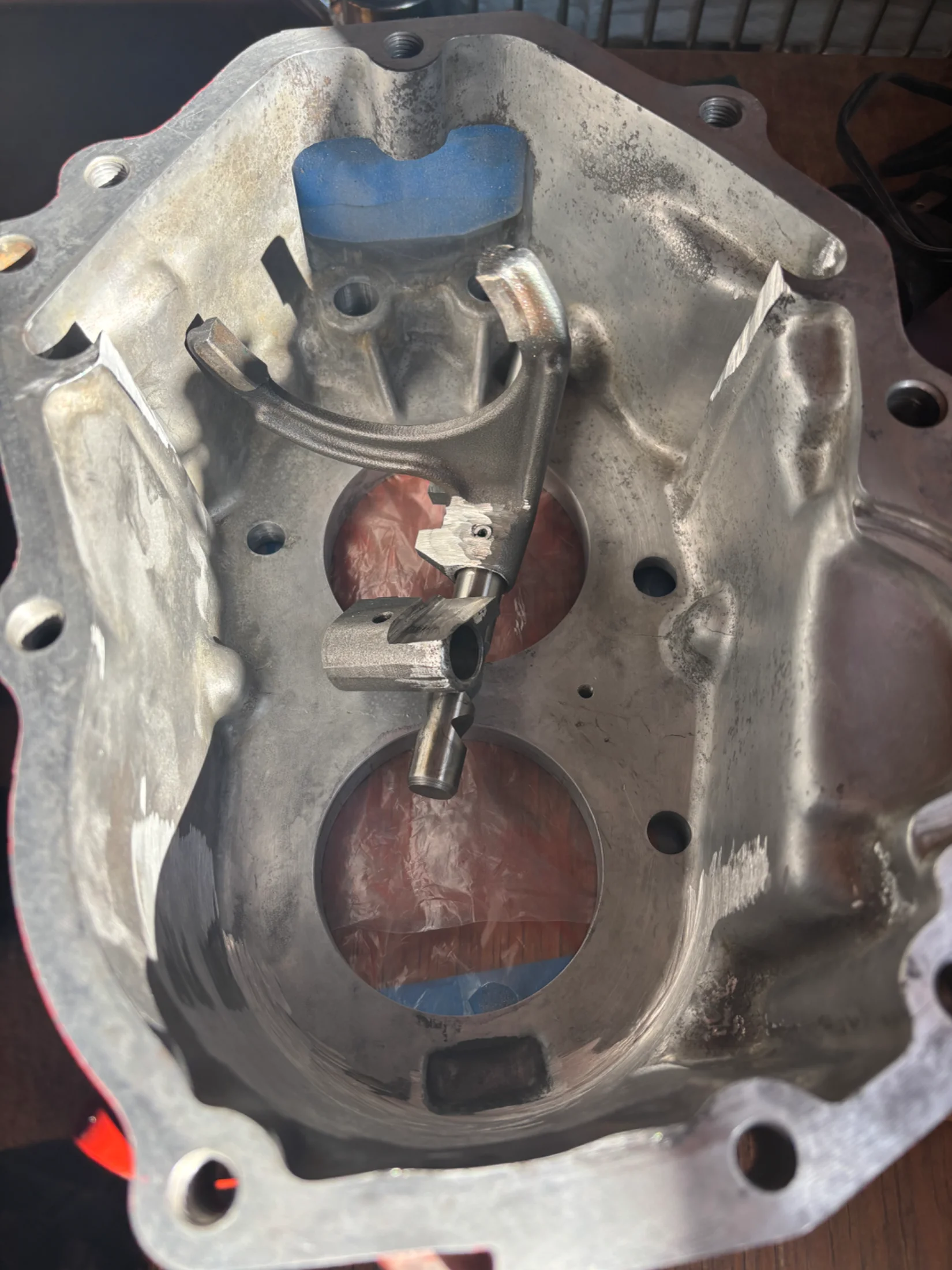

So I used another I had salvaged. 😊 I clearanced the inside of the case and shift fork with an Angle grinder for the larger 4.7 gears and put some lipstick on for show!

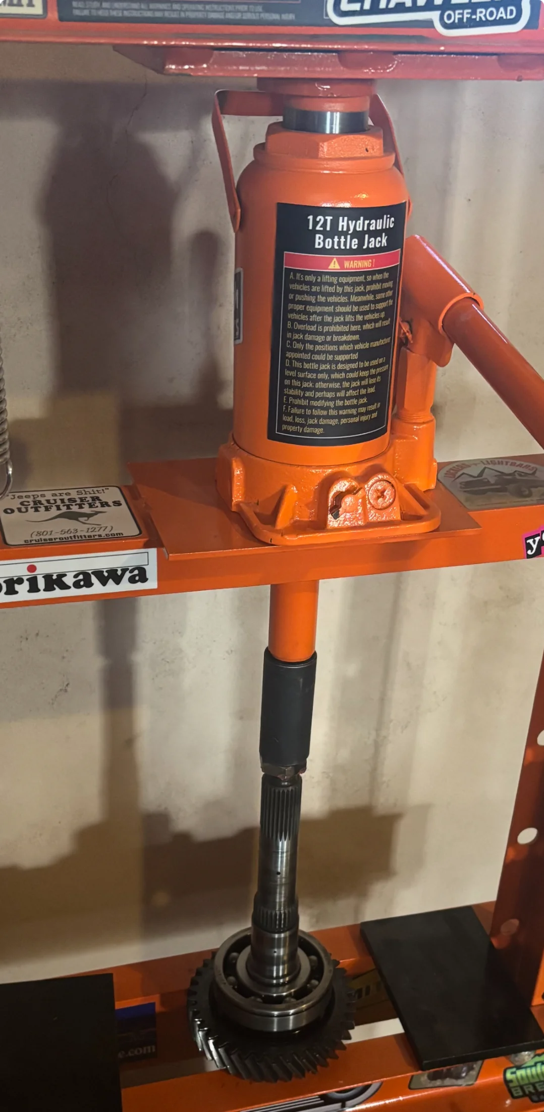

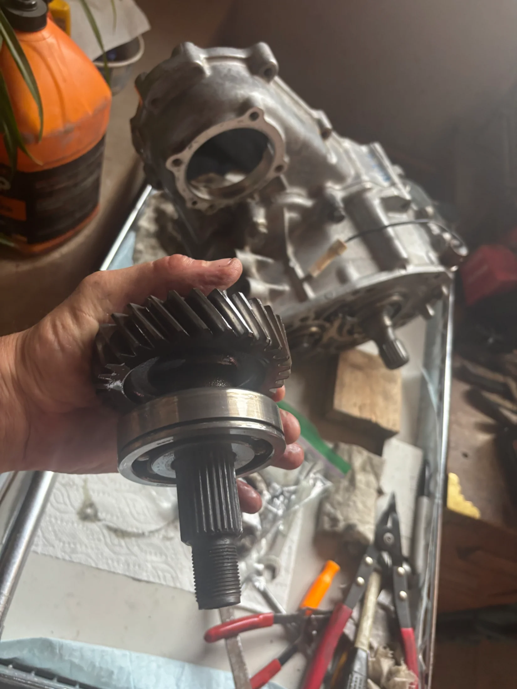

I Pressed the old 2.28 off and pressed the crawler gear onto the shaft with my new mini-press.

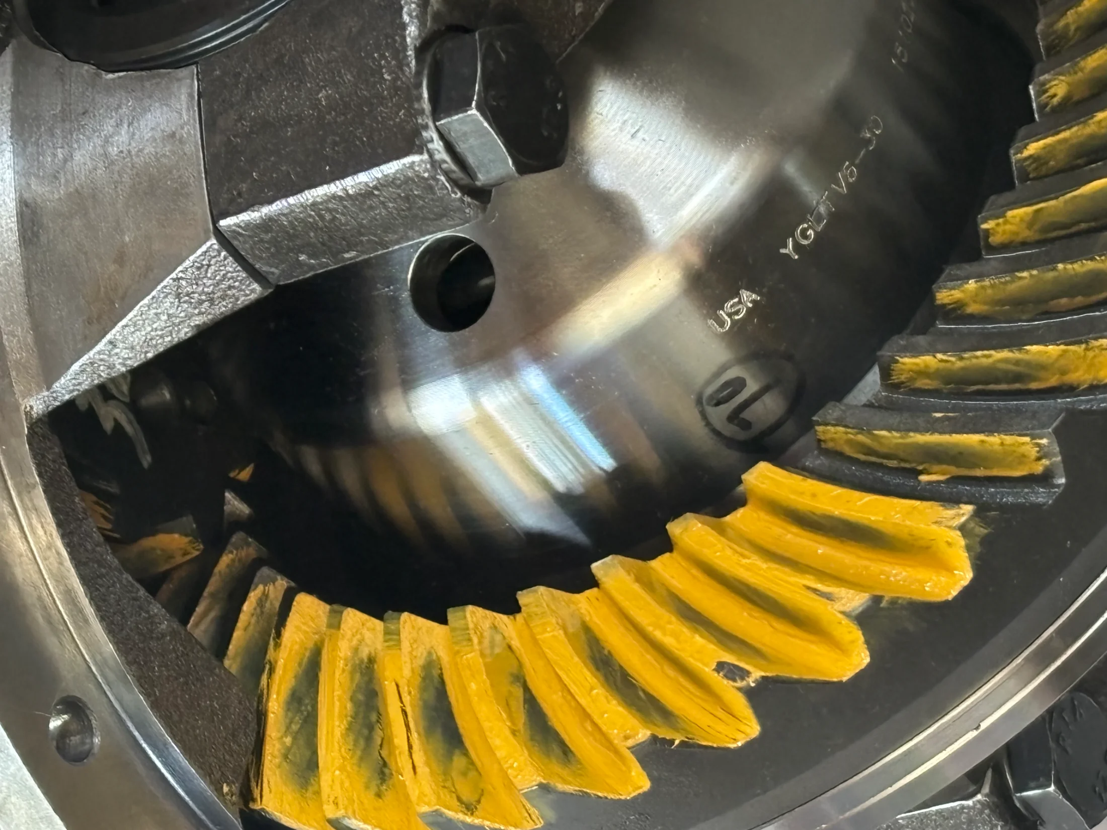

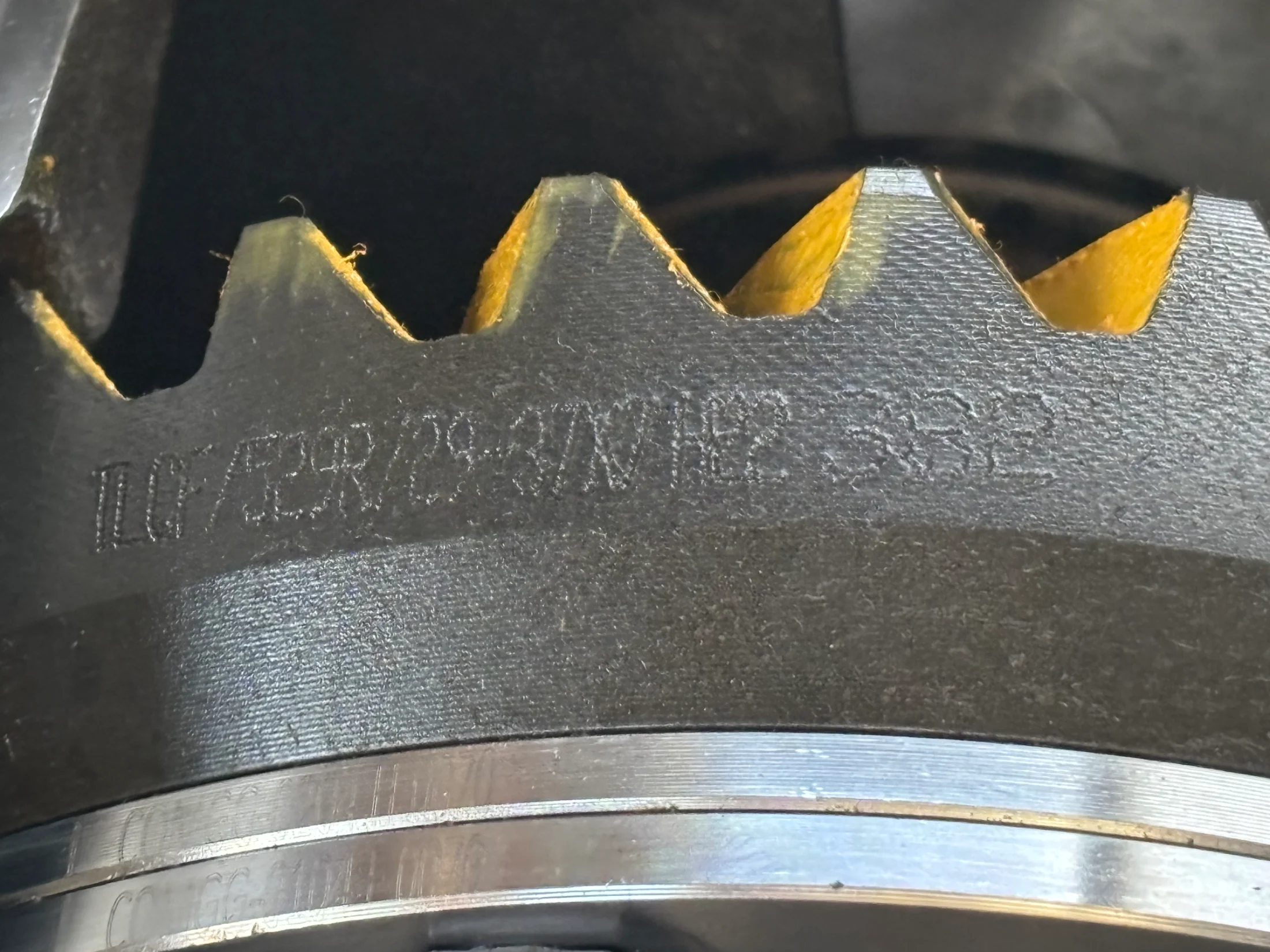

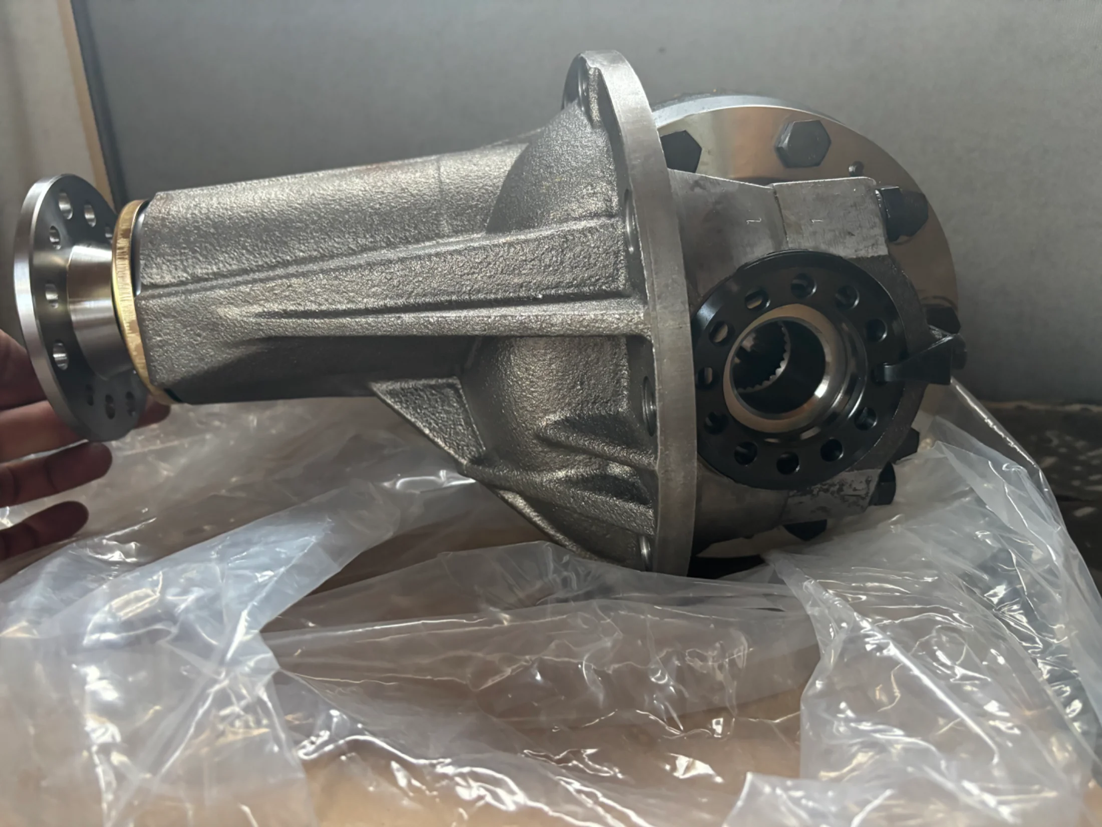

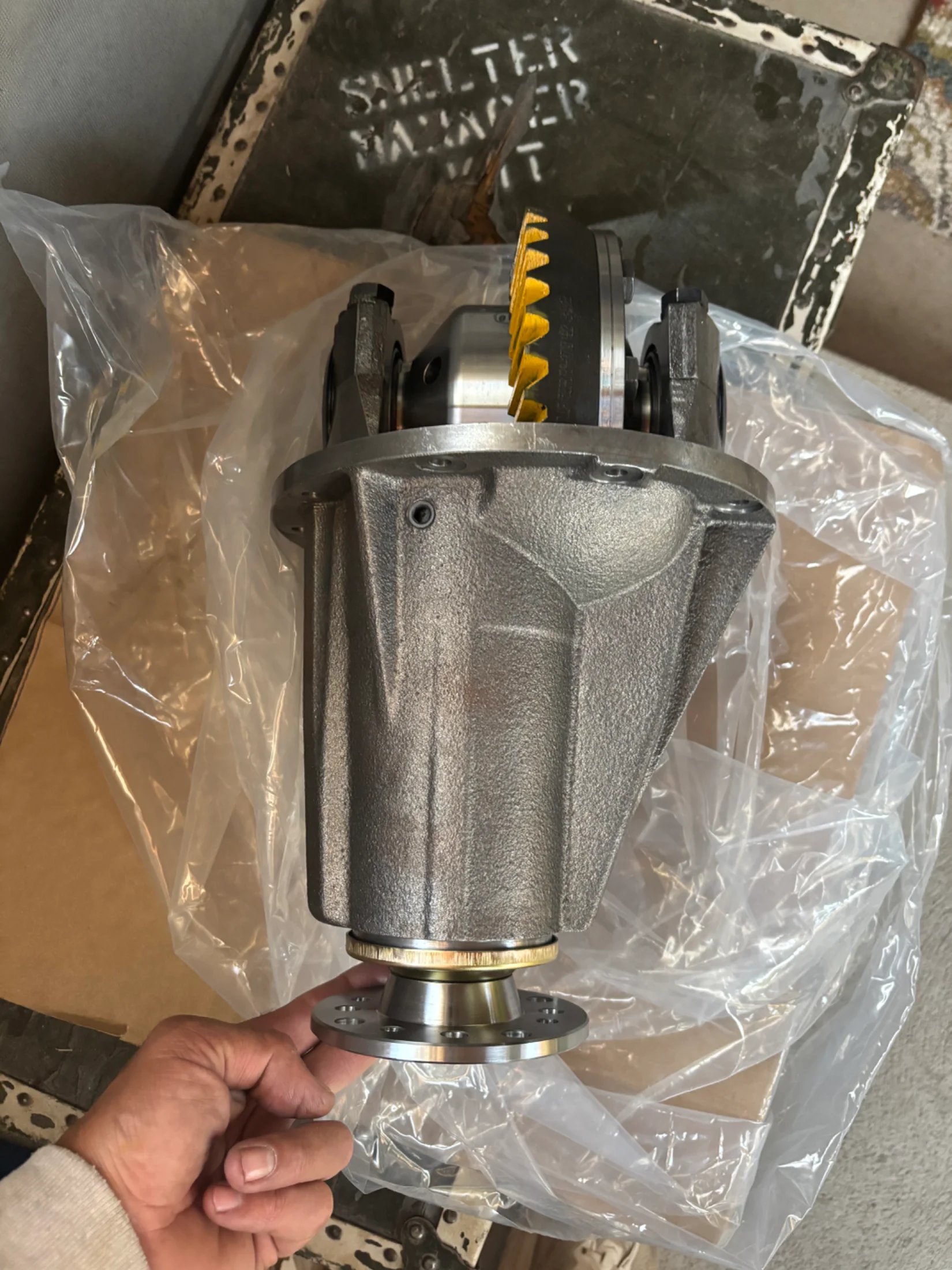

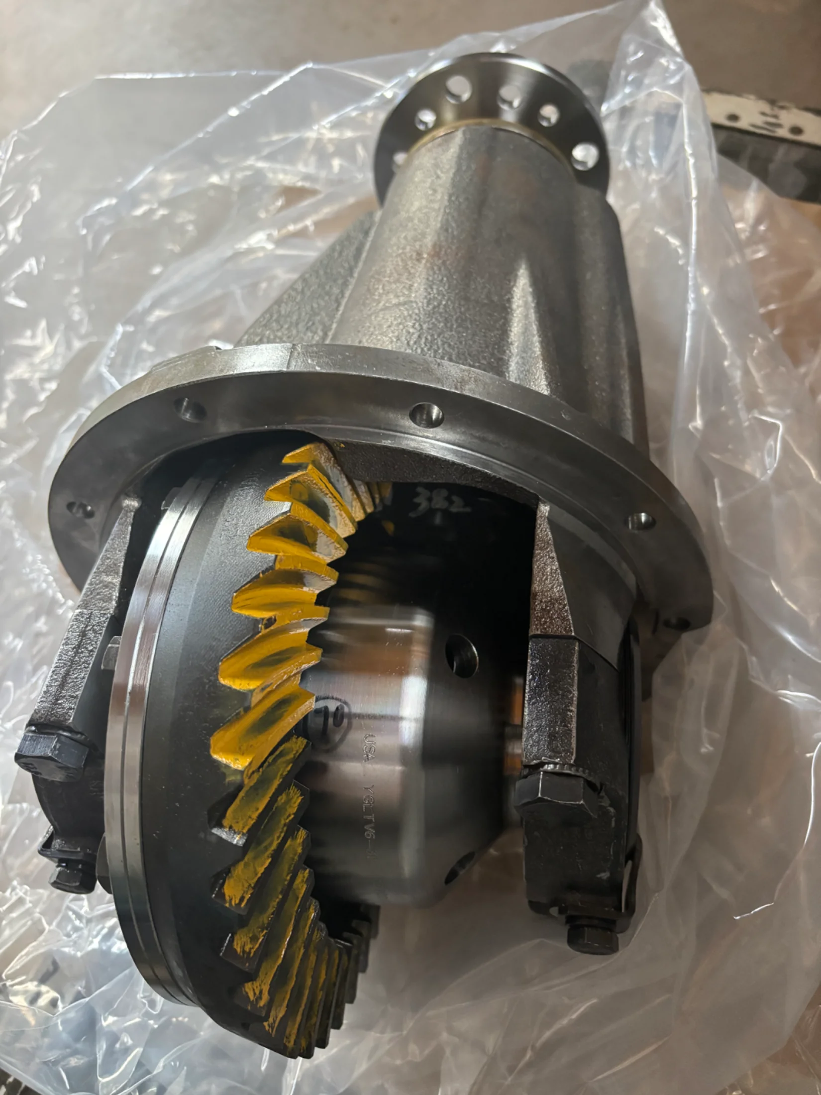

I’m super stoked to FINALLY after nearly 6 months to receive fully built and warrantied USA built Yukon 5.29 hi- pinion front, and rear 4 cyl. third members with Grizzly lockers for little Clementine!
NICE! Grizzly's were my plan when my cheapie Aussie Lockers break. Had no idea they would still be working when I put them in 14 or 15 years ago.
I'm looking forward to hear what you think of them. Your truck should be pretty unstoppable.
Yes, I added up the total costs of building my own 3rd members and my time , not to mention IF I built it right also, and it was only about 300 more for fully built with Yukon life time warranty so it was a no brainer for me.
Good piece of mind on the trail.
And this way I get to keep the 4.10 diffs as spares also.

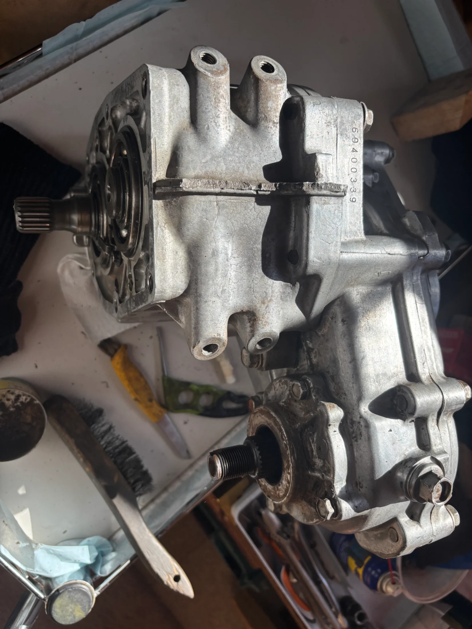

This 2-4 shifter rail from a w56 has the hook stop, do I need to cut this off like the hi -low rail On the right? To look like this picture, I studied up on the subject last winter but my memory is foggy, and I’ve been working construction full time so have not had a lot of time to work on this. Thanks for info guys!
no you don't need to cut the 2/4 rail. it does make tearing the case down a little easier if you do so.
also. the 2/4 rail only has two positions, the high/n/low has three.
hope that helps
hope that helps
Ha! Thanks man, I see now that it does go into 2 and 4! Nothing wrong, I just was confused.:bang:
Thank you for clarifying only 2 positions on the 2/4 rail. It’s been on the bench awhile now so I’m anxious to get this moving.
