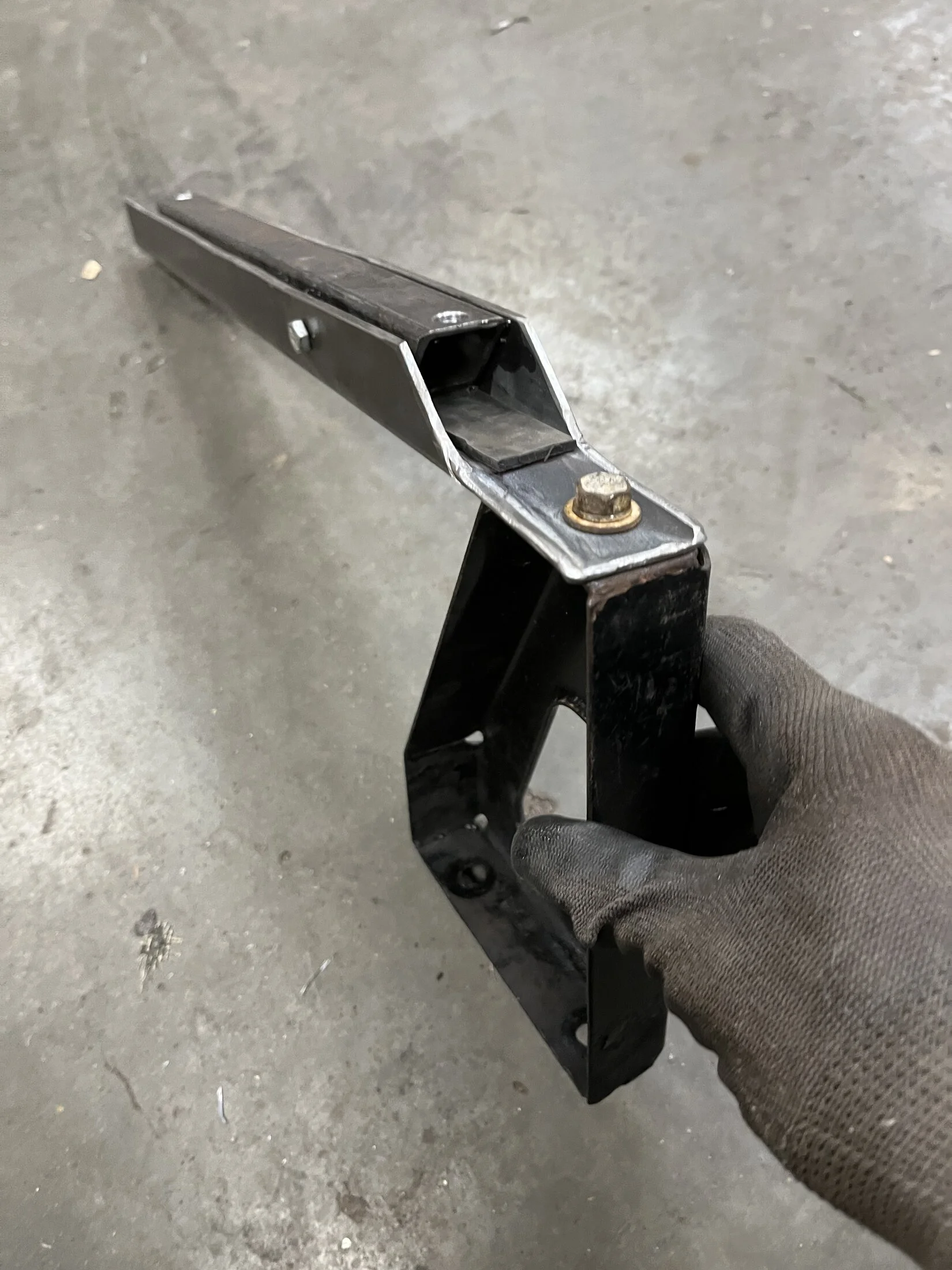

The design consists of 1” square tubing that is bolted to the bottom of the seat using the stock mounting holes. That tube will slide in a “U” channel that mounts to the truck using a combination of stock and fabricated brackets. The square tubing is held in the U channel by bolts (or possibly some clevis pins). With some strategic drilling of the 1” tube, I should be able to remove the pins, slide the seat ahead or back, and re-insert the pins at the desired location.
The seat is not fully installed, but we’re getting there! Here’s the 1” square tubing bolted to the seat. I tapped the mounting holes M8 x 1.25 so that I could use Toyota hardware.
The ends are angled so that I can get a socket on the bolt.

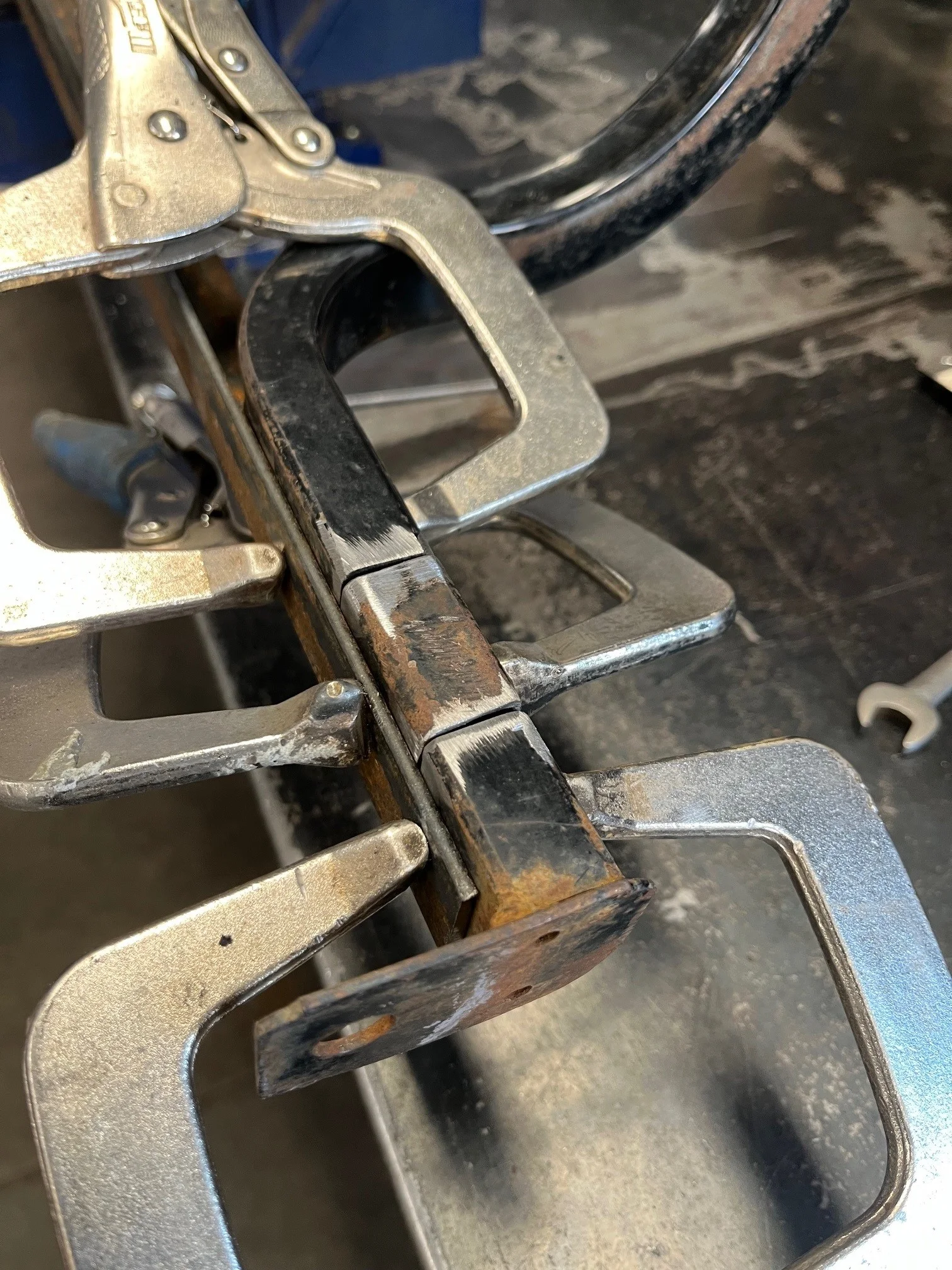

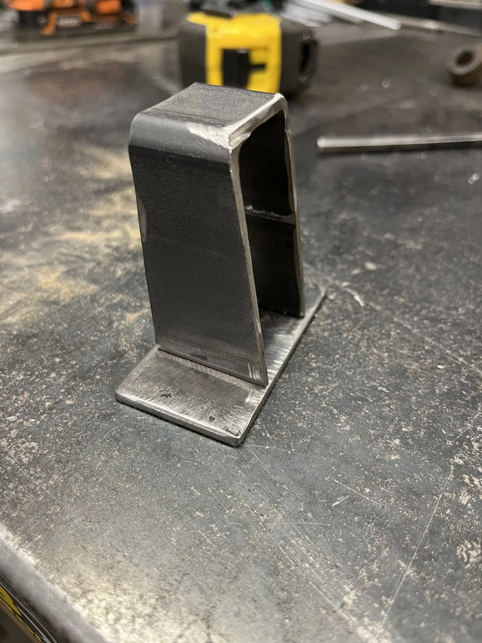

To make the “U” channel, I cut some 1 1/2 x 3 x 1/8 wall tubing lengthwise, making a channel about 1” deep. I cut one end back so that there was a “tongue” the same size as the mounting surface of the stock seat bracket. In this pic you can see the square tubing nesting inside the channel, and the mounting bracket attached. I also drilled through both pieces, then put a bolt through. Each “slider” will have two bolts or pins, and these are what attaches the seat to the supports.
At this point I was able to start mocking up the seat position. This allowed me to determine the height of the rear seat support.

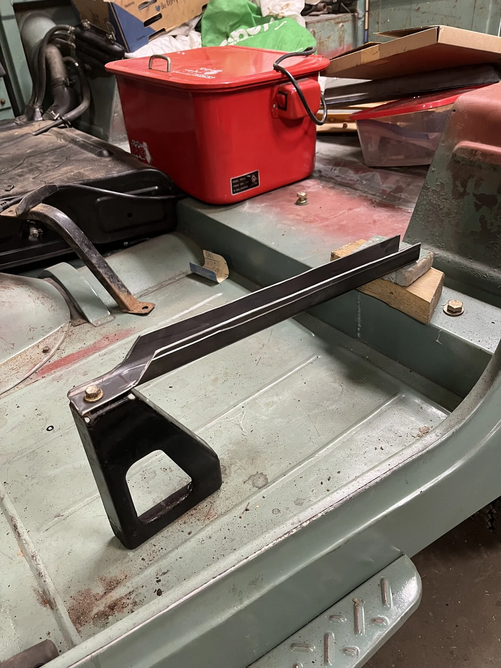

I made this support from the same 1 1/2 x 3” tubing and some 1/8” flat bar.
And here it is welded up for test fitting. Pretty pleased with the clean look and I think it’ll be plenty strong.
And here’s the seat in its more or less final position:

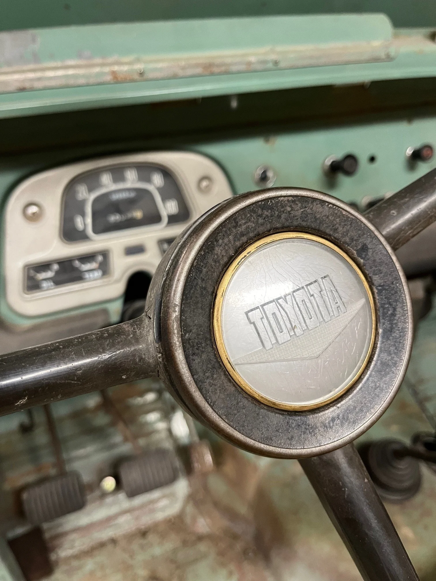

First thing: got my horn button installed. It looks dope, and it works.

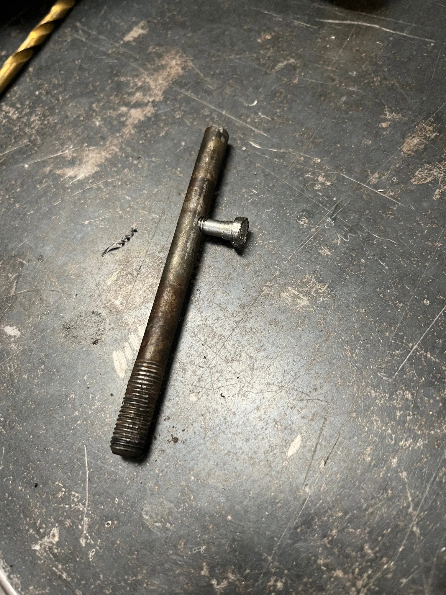

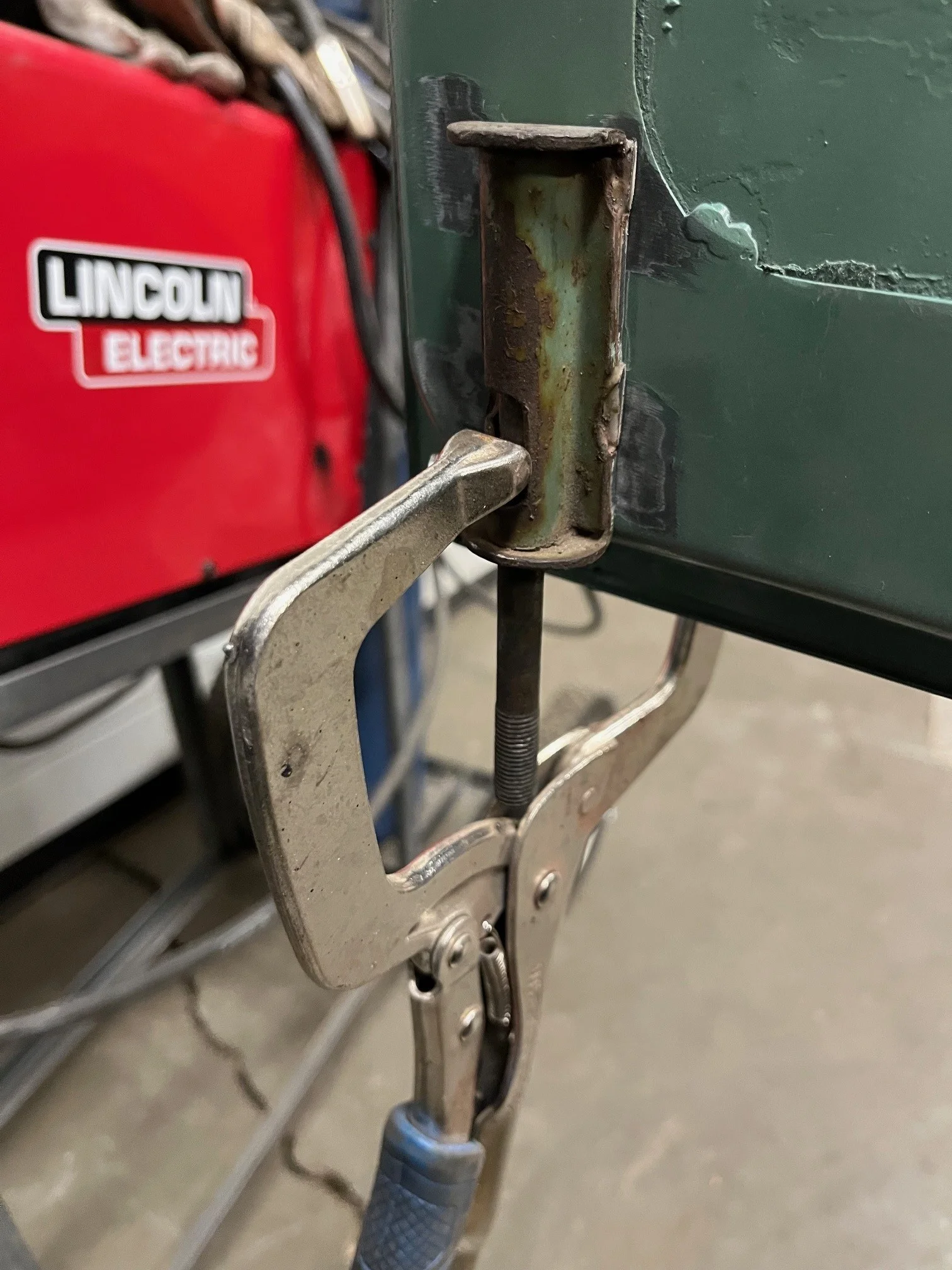

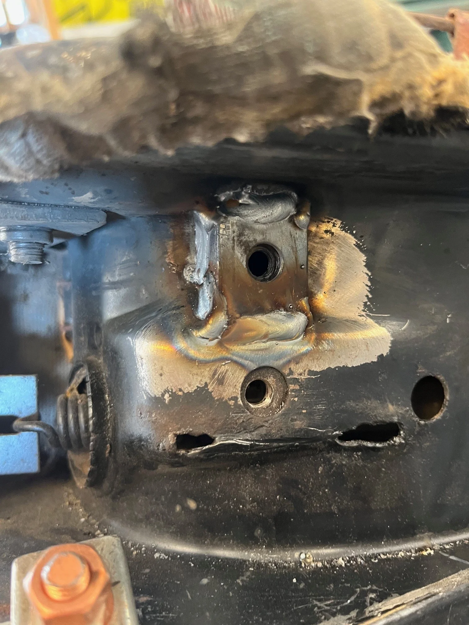

I then moved to the back of the truck, where I set about installing the lower door latch. When I bought the truck, the slide bolt was missing, but the rest of the latch was there, so I cut it off so that I could repair the doors. Finally getting around to reinstalling.
The first step was to make a new slide bolt. I started with an old 60-series body mount bolt, which happens to be the exact right diameter, and has a nice long shank. I drilled the side of the bolt, and tapped it M6x1.0. Then I found a suitable M6 bolt and rounded the top so that it looks more like a knob and less like a bolt.
The next step was to fit the bolt in the latch and measure for length:
And then situate it on the truck:
Finally, I tack welded it in place. Looking at this photo, I don't think my tacks are likely to hold, so I will have to go back and re-weld, I think. Don't really want this breaking off. But you get the idea...

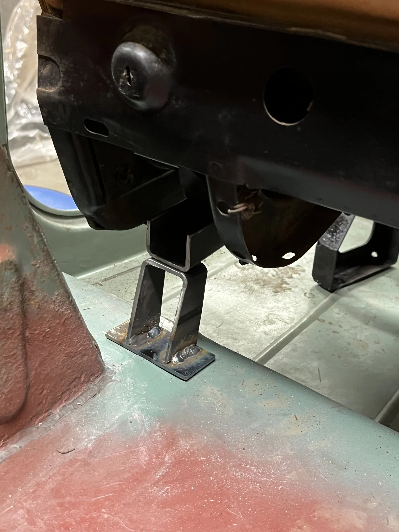

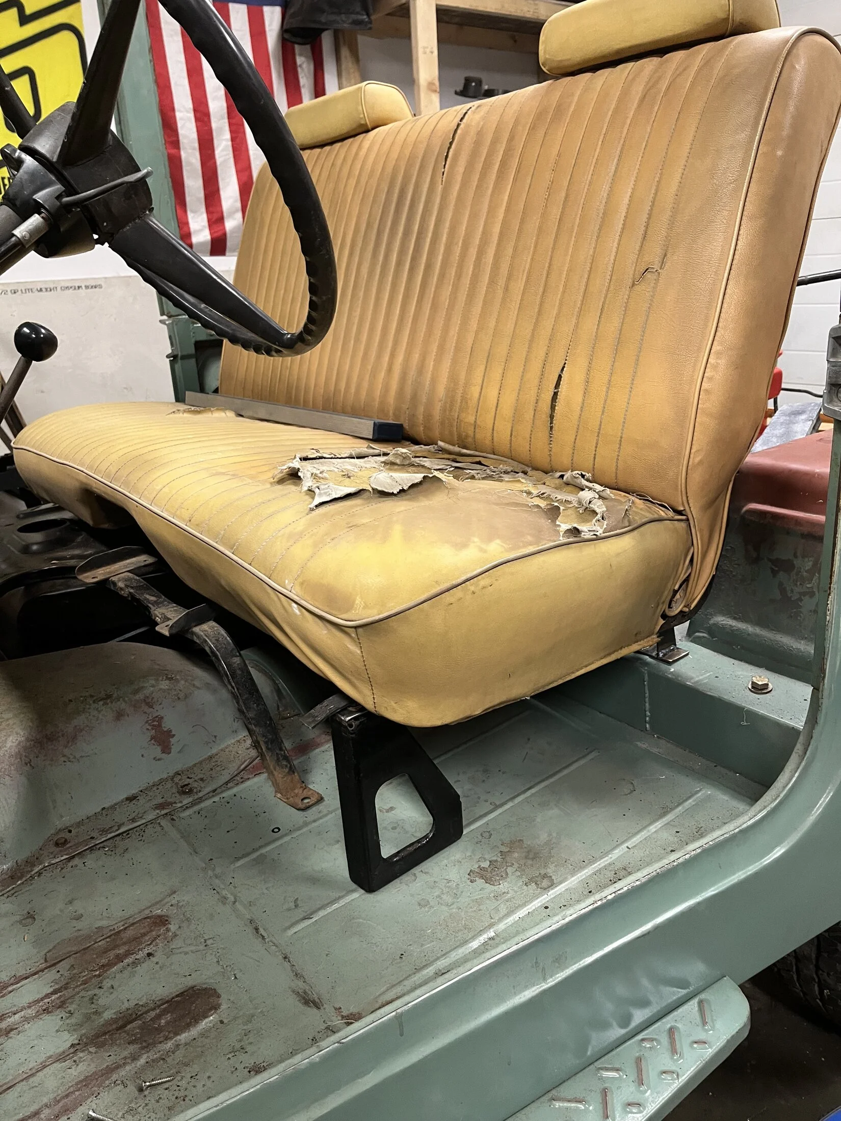

As mentioned, I've also been working on mounting the seat, which has been a real challenge. The driver's side is taken care of, but the passenger side is proving more of a challenge. The first issue is that the passenger side mounting bolts are perfectly in line with the fuel tank overflow hose or whatever it's called - so the first thing I had to do was move the mounting rail outboard a little bit. This entailed making up a new bracket and welding it in. The mounting nut is welded in place on the back side of the bracket:
That still left the challenge of attaching the seat to the floor. In the end I decided to hack up a seat mounting bracket from a later FJ40, as it has the necessary curve to get around the fuel tank. This entailed lots of cutting and welding to get it to fit.
After several hours of work and lots of puzzling, this is where I'm at: I basically have one more piece to weld in to connect the seat mounting rail to the bracket. I'll then need to fab up the bracket that will support the rear of the seat -- and that should be it! Getting the seat mounted is one of the last major hurdles to getting this thing roadworthy!

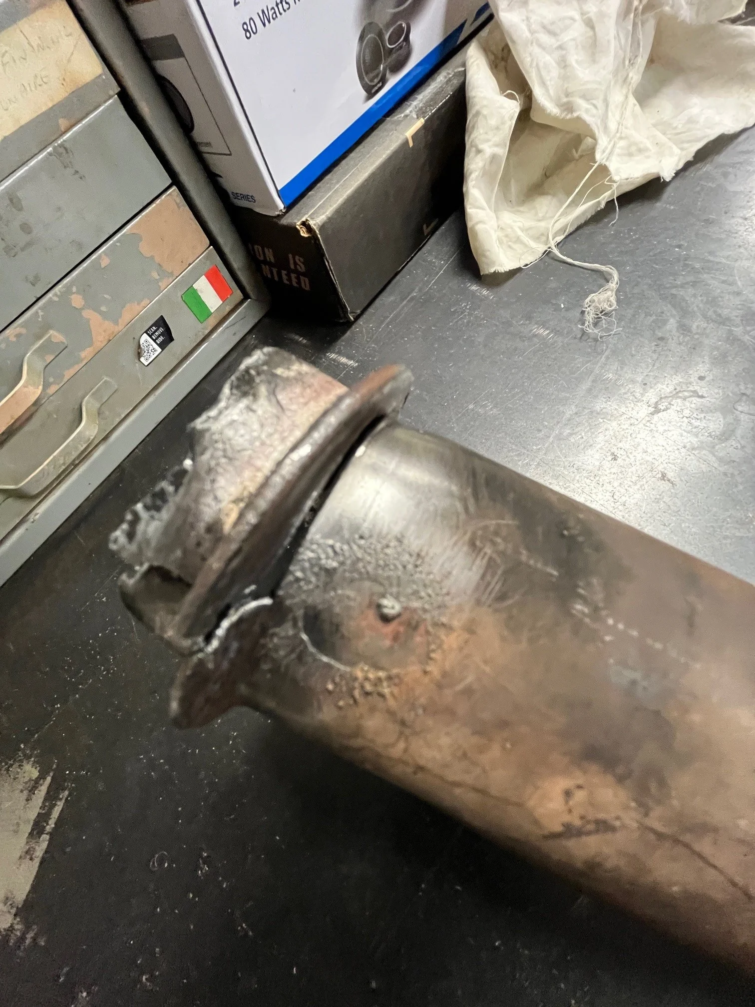

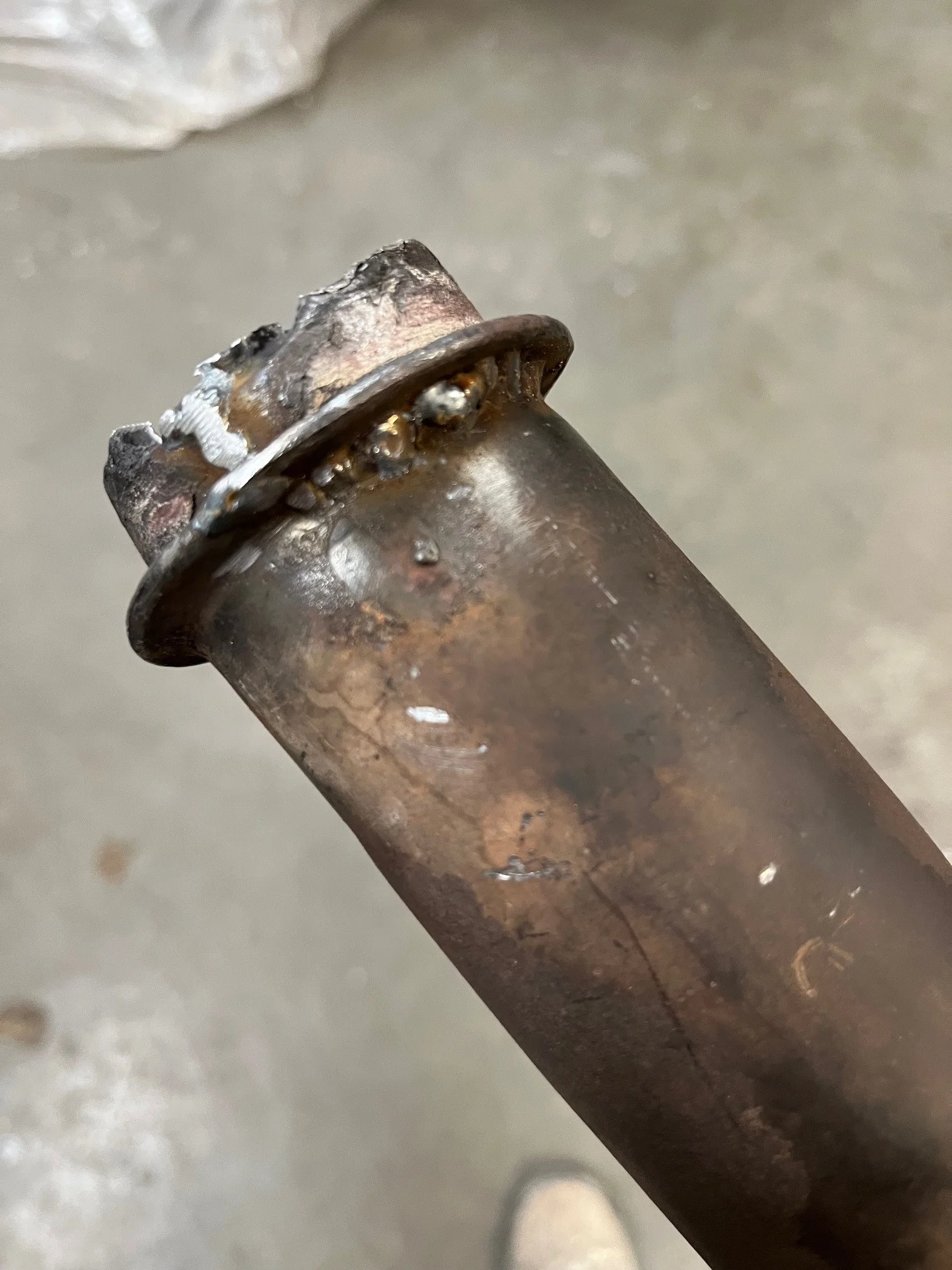

I also made a repair to the exhaust down pipe. It took about a week of soaking with PB Blaster, but I was finally able to remove the exhaust flange nuts. There was a significant crack in the down pipe right at the flange (sorry for blurry photo. stupid phone):
I was able to clean it up and get it welded back together. Should last a little while, anyway...

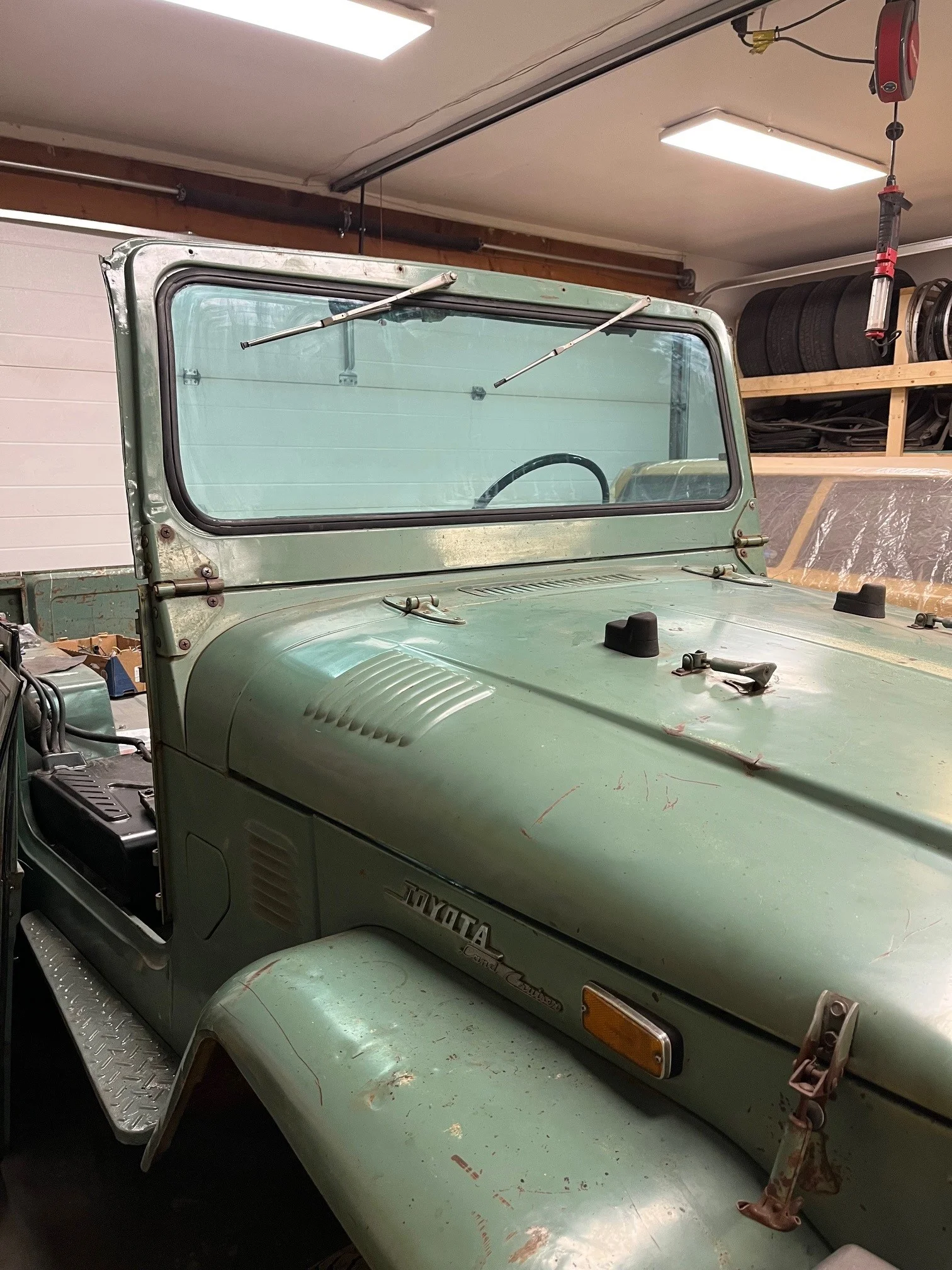

I also spent an evening installing the new windshield I had cut. The glass place only had green tint available, which I had misgivings about, but they *assured* me it's legal. I guess we'll see what the insurance inspector says. Getting the glass installed solo wasn't the most fun. I started by installing the gasket on the window, but that didn't work very well as it kept falling off. Tape helped, but even so it was very frustrating.
Finally I ended up installing the gasket on the frame, and then dropping the glass into the bottom groove, and then working it into place all the way around, using Windex as a lubricant. I still need to add the lock strip, but we're almost there.

My windshield looked milky in areas so I had to replace it too. I ran into the same thing, every place I called said that the new flat glass would have a slight green look to it but that out in the sun and driving it I would probably not notice it. I haven't installed it yet. All my glass is bubble wrapped in the garage until the paint and body is done. While all the glass is out I was going to tint the side & rear glass, but my wife thinks it will look terrible tinted. I thought it would look good. But, I have the final word. :cool:

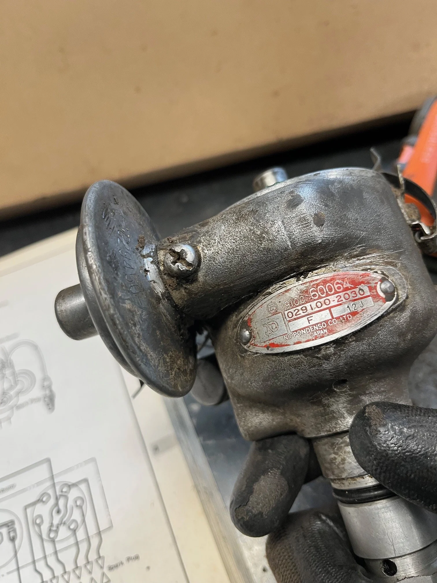

  • Pulled the distributor and gave it a good cleaning. Re-set the point gap. Tested the vacuum retard function - it seems to work ok. Replaced the oil seal, reinstalled. I also cleaned the contacts in the distributor cap, as there was some corrosion forming that could have impaired the spark. I'm still running what I believe to be the stock dizzy for this truck:

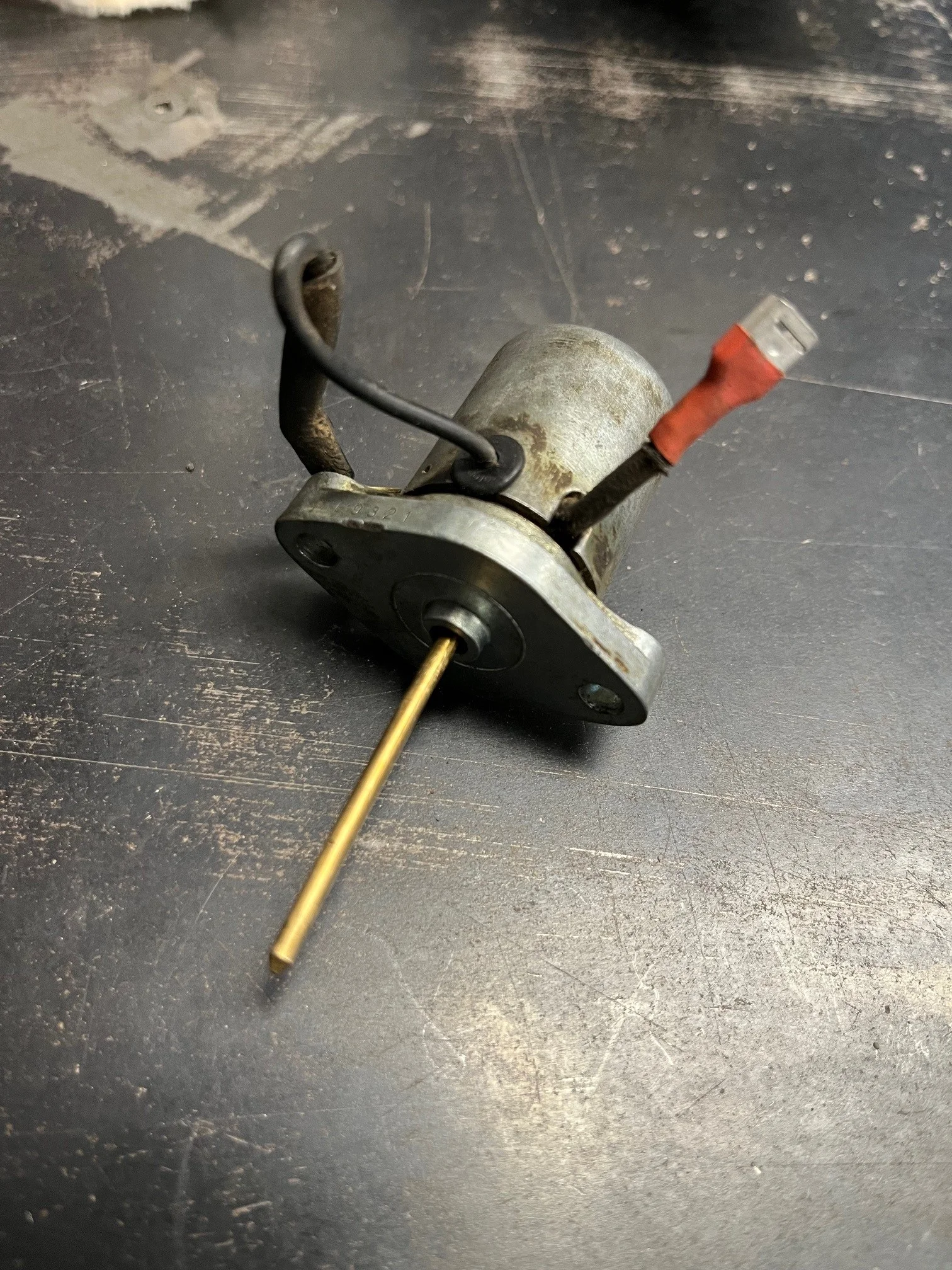

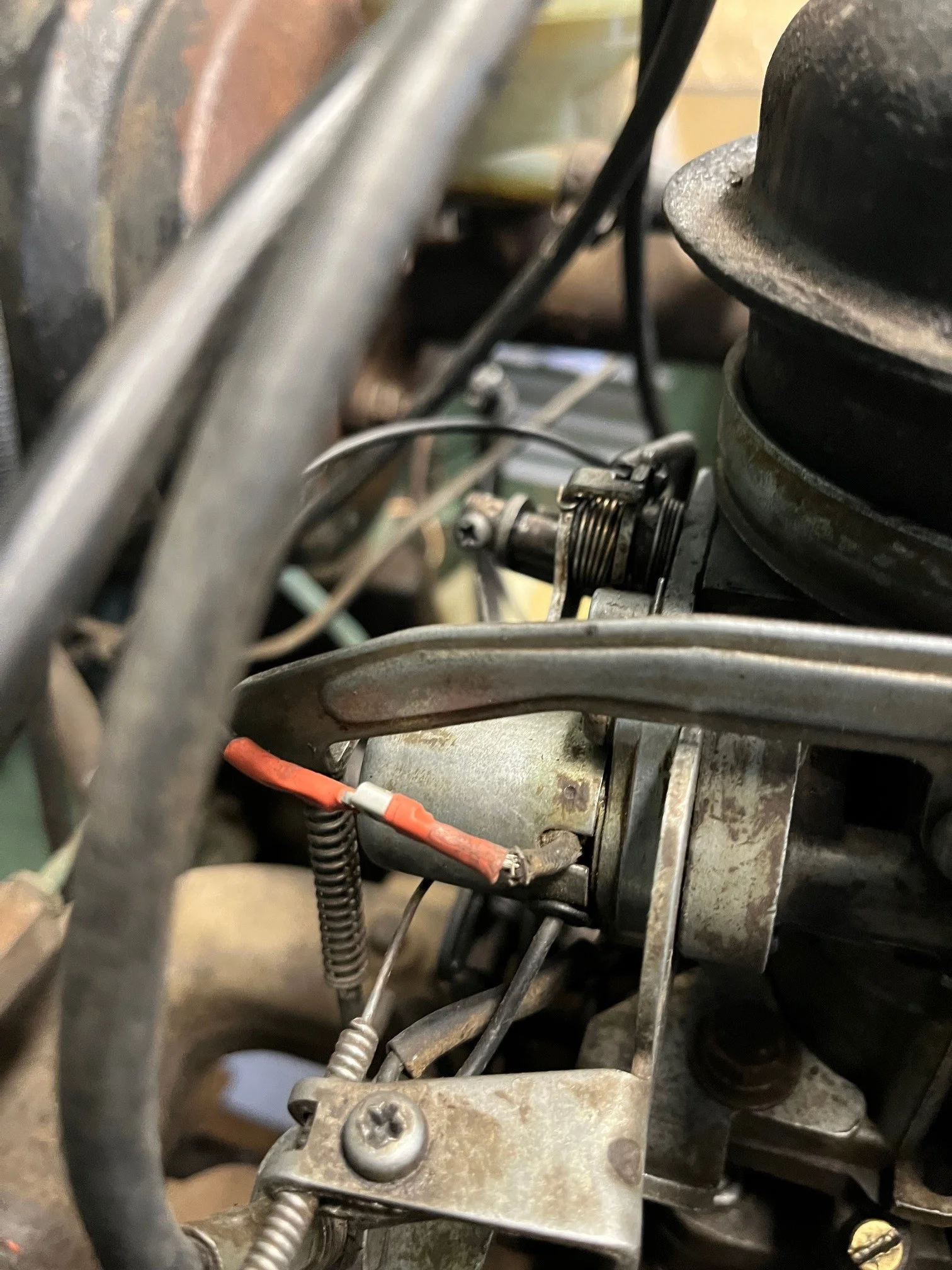

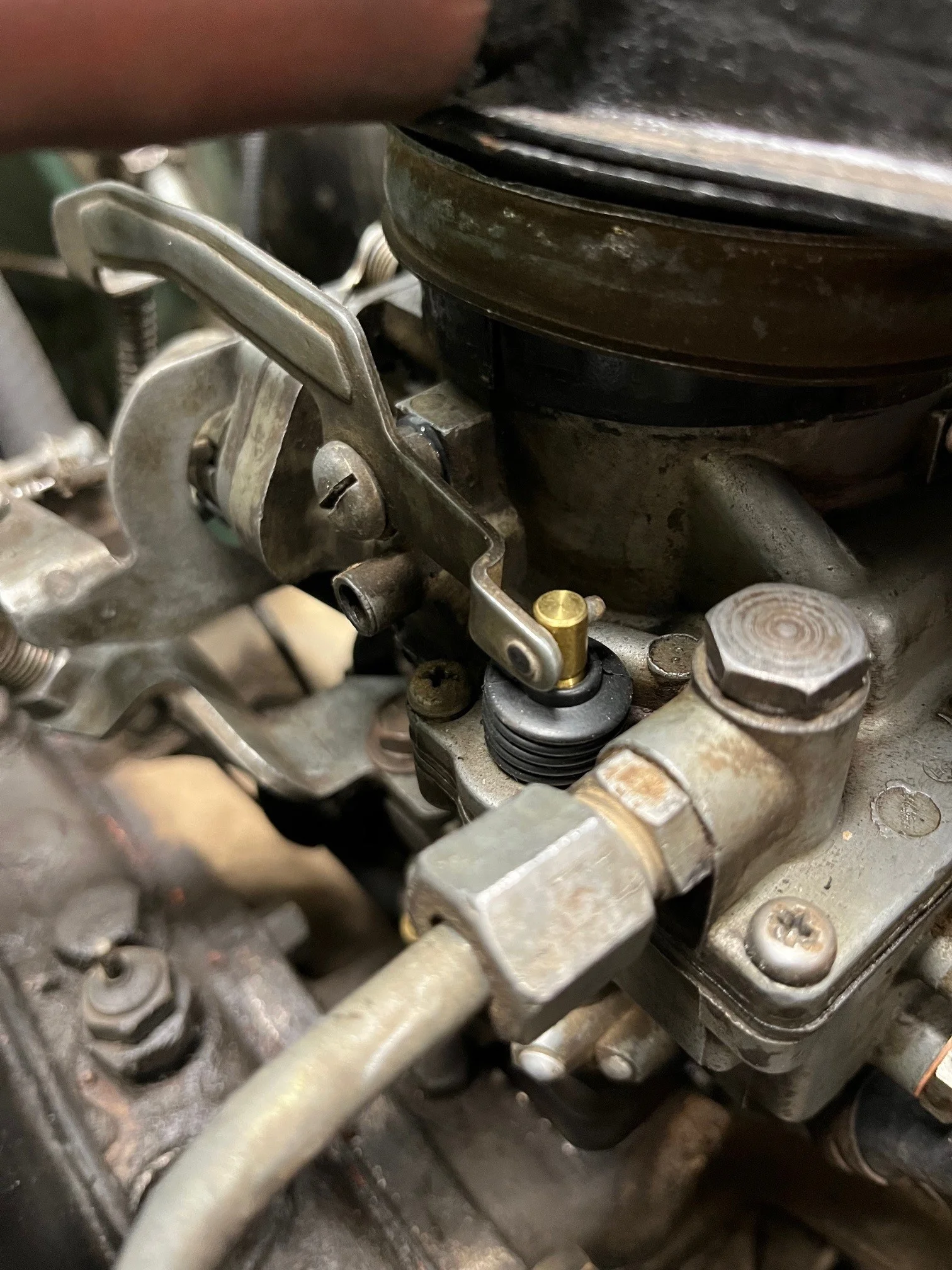

Confident in the knowledge that the ignition system was fully dialed, I turned my attention to the carb once again. I had noticed that what I thought was the fuel cutoff solenoid was not wired in at all - there was just a stub of wire sticking out from it. Upon further research, I learned that on the 2-barrel F carb, it's not a fuel cutoff solenoid, but an idle cutoff solenoid. It's supposed to get power whenever the key is on. When it gets 12v, a pin retracts into the body of the solenoid, opening the carb's idle circuit. This is the little bugger right here:
In the above photo, I've added a spade connector to the stub of wire. I tested the solenoid off the carb, and confirmed that it works. I then reinstalled it in the truck. I'm pulling keyed power from the voltage regulator.
Wiring in the idle cutoff solenoid made a dramatic improvement: it would finally idle, even with the choke off. Based on what I've read on this site, it's possible to get the engine to idle without an operational idle cutoff solenoid, but you have to adjust the various idle screws way out of spec. Anyway, getting the solenoid wired in seems to have been time well spent.

On my '75 the wire for the idle solenoid was wrapped along with the temperature sender wire in the middle of the firewall. It had been cut, but I found it when I unwrapped the wires a bit.
