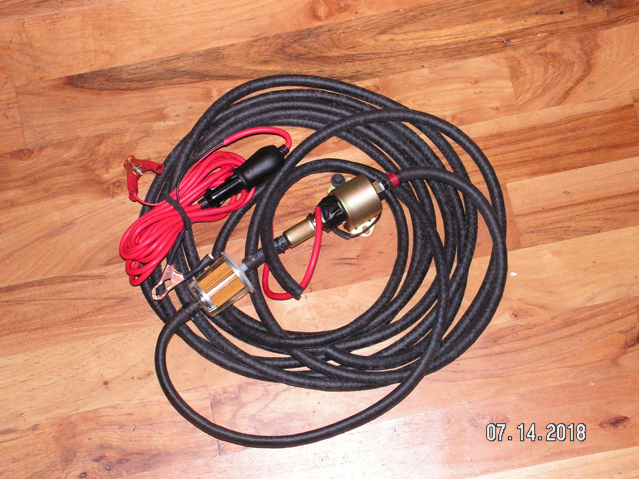

So this is my switched, fused, filtered fuel transfer pump. Has 5' draw and 20' delivery hose plus a 10' power cord that will plug into cig lighter or clamp to the battery. Will do diesel too. All the stuff was from Amoron or ebay was about $50 back then. I have made up about 10 units over the years. Way better than holding up the crappy 5 gallon gas cans if you are old. You can swap the hoses to drain fuel tanks. Got a carb engine, you can hook in this system with a 5 gallon can of gas and by pass gas tank issues with old gas, weak fuel pump, clogged lines or filters...

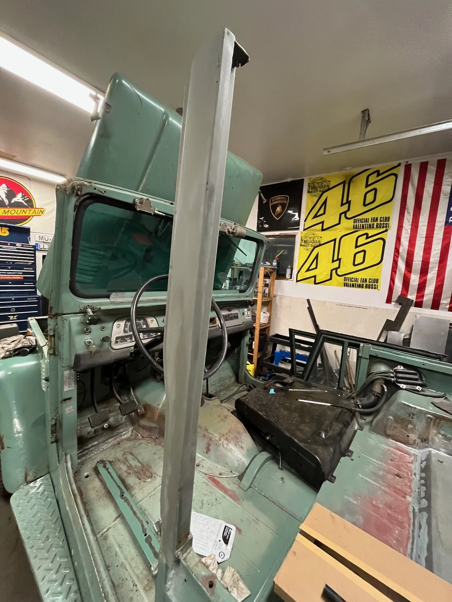

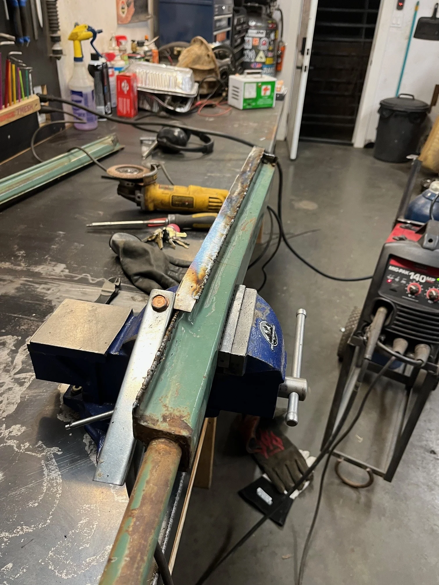

Kinda tired of messing around with the engine on this thing, so I've changed tack and pulled the welder out of retirement for a bit. One project I've been putting off is repairing the B-pillars where the previous owner hacked up the hard top to build the shortened cab, leaving ragged, rusty edges and the inside of the pillar open to the elements.

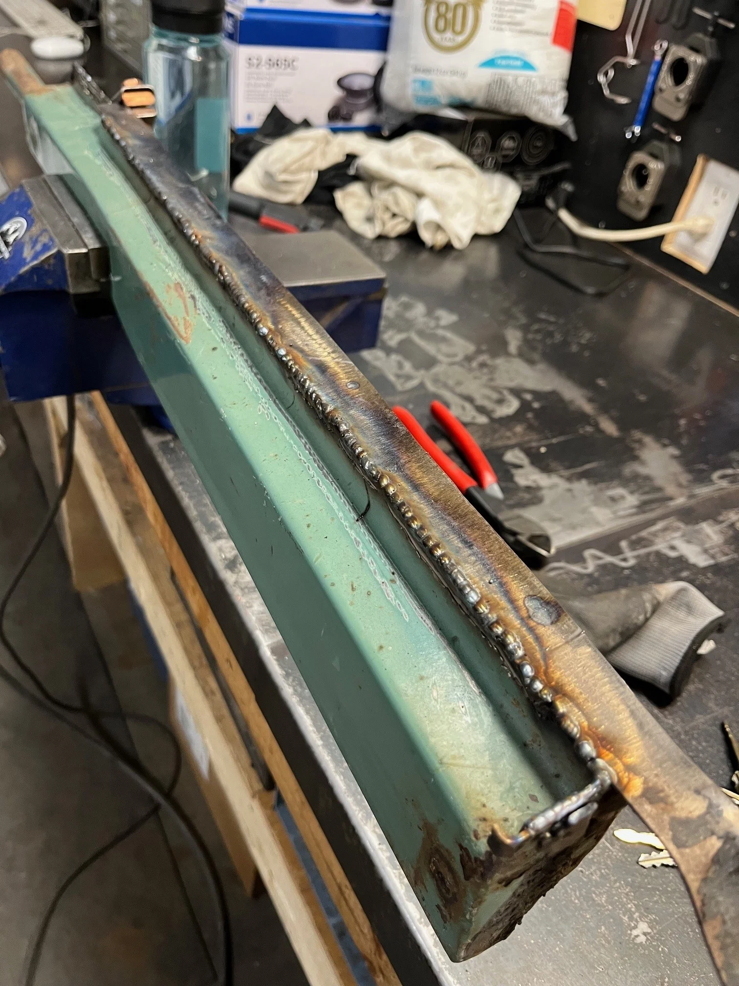

To fix this, I put a fresh cut-off wheel on my grinder and made a new, much cleaner cut. Then i scrounged a scrap piece of sheet metal that was just a little too long and a little too wide, and tacked it into place. Then I fully welded one side, before cutting off the excess metal and fully welding the second side. I find this method a lot easier than measuring and cutting the piece before installing - especially when it's a long, narrow piece that is tricky to handle. So much better to tack it on, then cut/grind it down to size before fully welding it up.

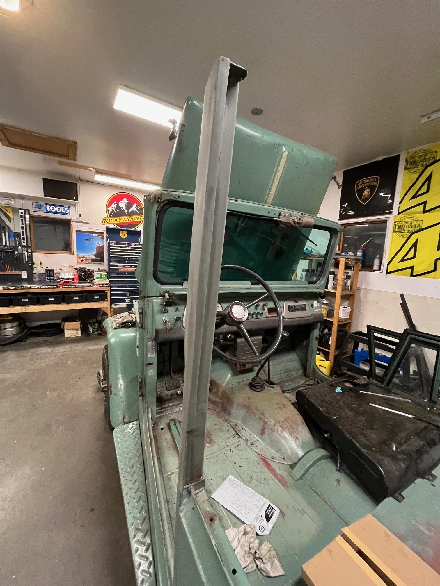

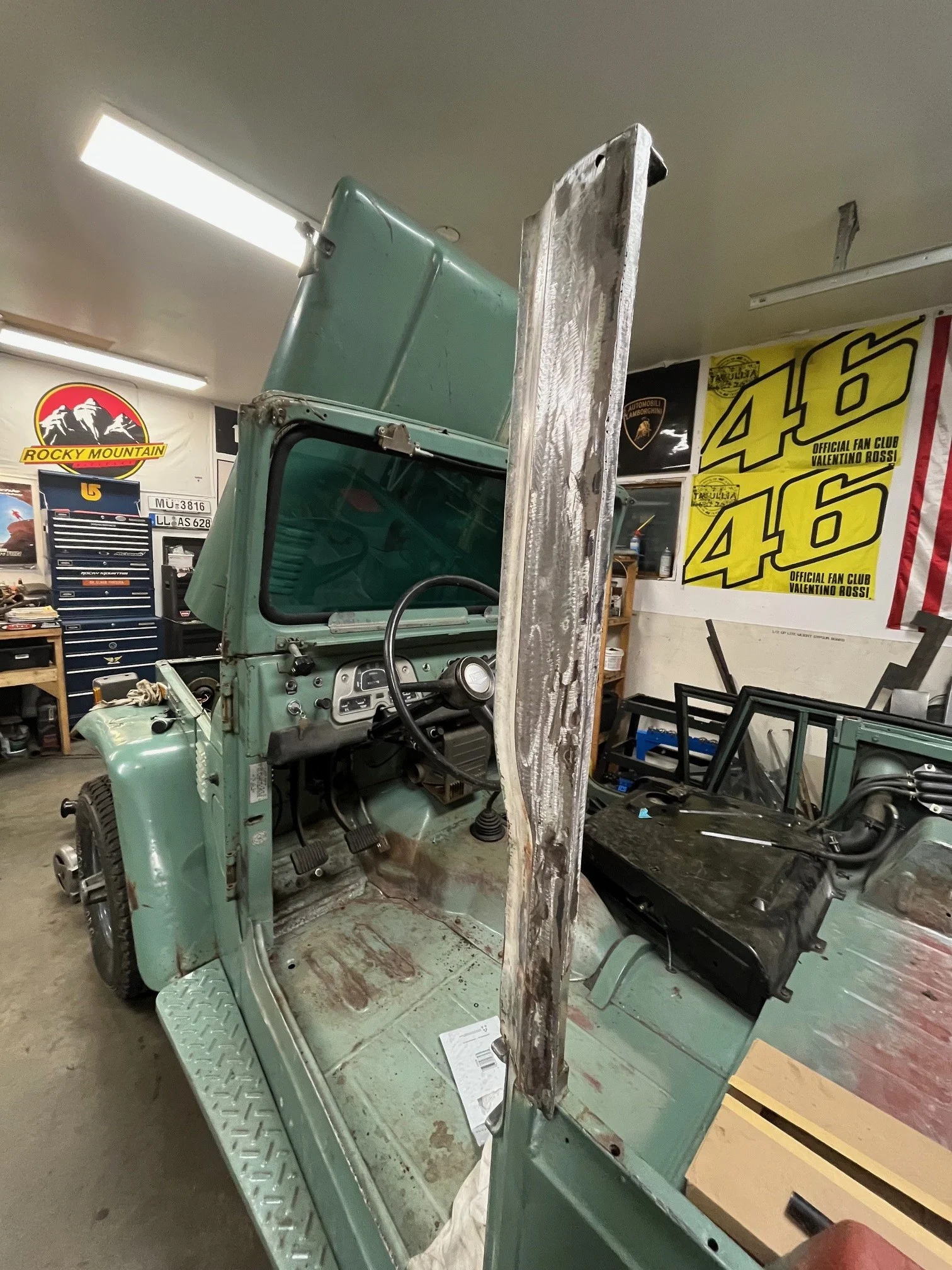

After welding, ground everything flat and smooth, and test fit it on the 40. This pillar will serve as the support for my home-grown soft top bows, which I have also been working on (no pics yet). The piece I welded on is the one facing the rear of the vehicle.
Then I gooped on some filler, sanded it down, and put a couple coats of primer on it.
Will repeat this process on the passenger side, and then I can finalize the soft top situation on this rig.
