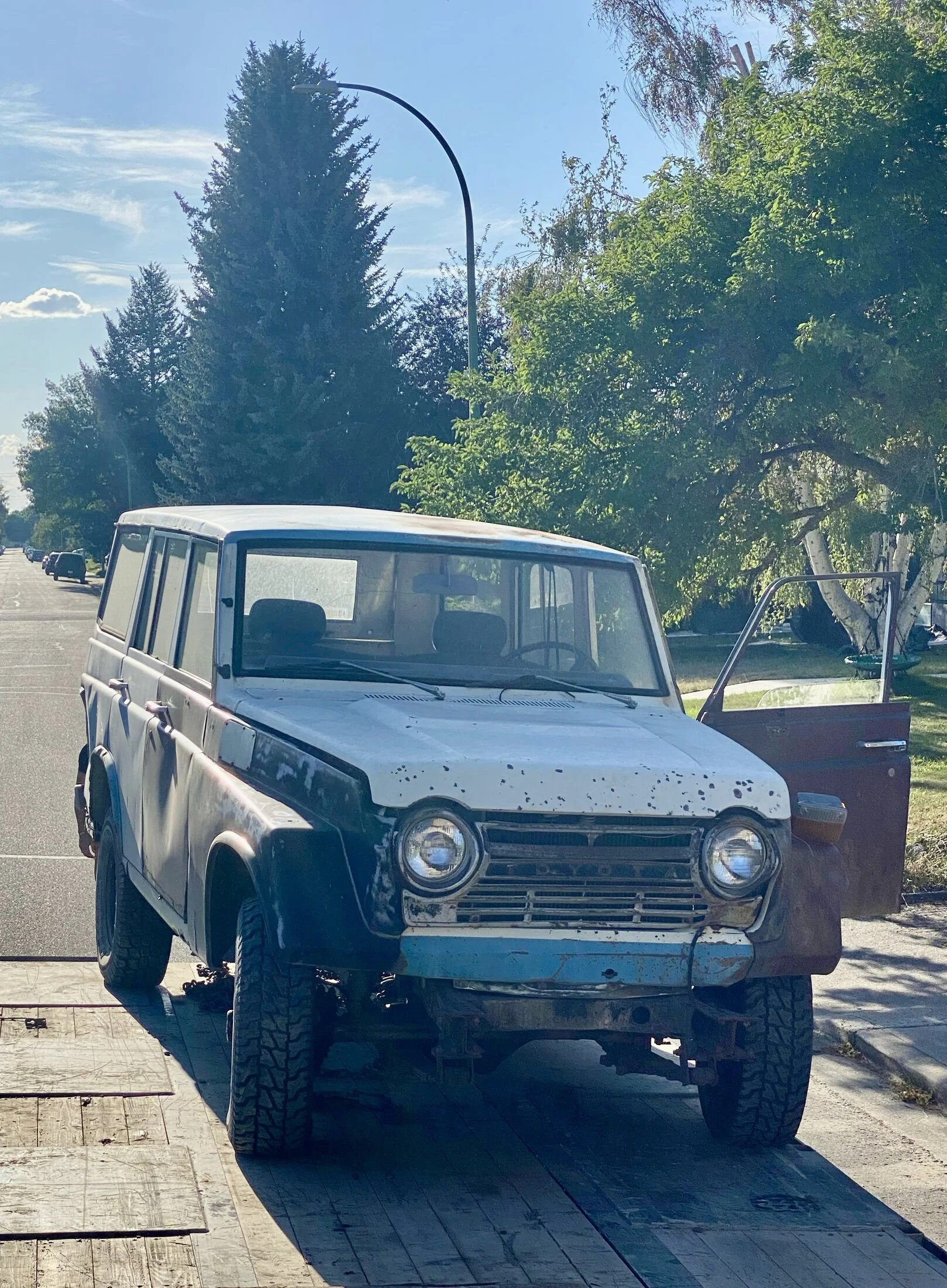

Yup, a ‘77. It’s rusty and dented, but not as far gone as my 40 or even my FJ62. I’m looking forward to expanding my metalworking skills to rebuild things like the rear fender arches etc. I bought it sight unseen for $CDN 2,000, and spent another grand to have it shipped 2000 miles from the Yukon to southern Alberta. Can’t wait to dig into it!

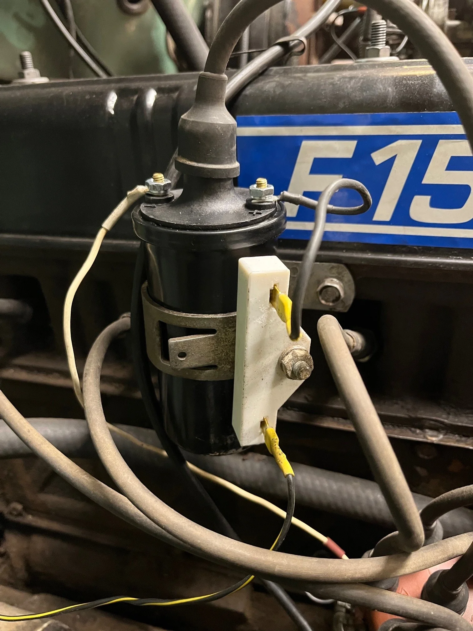

In other 40 series news, last night I took apart the carb for the millionth time. Every time it gets a little quicker, but it's still a bit of a pain. I needed to adjust the float, since the bowl has been emptying during idle. In the process, I discovered that I'd installed the needle upside down. Flipped that around and re-adjusted the float *again*. In the process of reassembling the carb, I dropped a screw that fell under the truck. While I was down on the floor looking for it, I spotted a small gasket that I did not recognize. I soon realized that it was the gasket for the idle cut off solenoid. It must have fallen when I removed the solenoid, and I just didn't notice it. Anyway, I put it back in place, hopefully sealing up another potential vacuum leak. Fingers crossed that I don't have to do anything further with this carb beyond adjusting a screw here and there.
I also installed a new coil and ballast resistor. The coil bracket is from a later Cruiser, so I adapted the igniter mount to support the external resistor.
Did a quick test start and it fired right up and settled into a decent idle. Maybe I can finally tick ignition and fuel delivery off my list?? Here's hoping.

Agreed. For the Pig I'm thinking of building a 2FE. I think I have everything I need to put a 3FE top end on the 2F block. The EFI in my FJ62 has been dead reliable.
That would be awesome.
Have the 3FE wrapped in a 62 as well.
