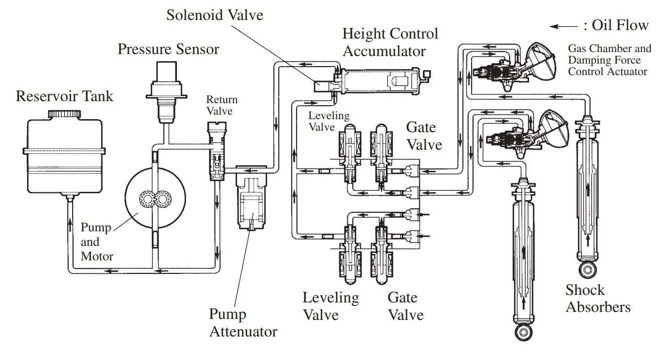

Consider the diagrams below, for example, when air trapped in the fluid in the 'Height Control Accumulator', or, trapped far away in the 'Shock Absorbers', or, sitting in one of the longer fluid lines.
This can take a lot of effort to remove -- won't happen just by cautiously opening the bleeder valves -- it will need repeating the "PADDO Method"** multiple times, and/or adapting the method such as by the suggestion above by @halbeezy .
Persistent bubbles is one indication of such circumstances. To resolve the problem, each cycle needs to include causing the Height Control Accumulator to empty and refill multiple times, and, raising and lowering the vehicle to causing the 'Shock Absorbers' to fill then displace their contents multiple times, then bleeding each time at each of the five points, with vehicle in the "LO" position and allowing it to descend completely as each bleed point is opened.
AHC System Lowering -- fluid is released from 'Shock Absorbers': ECU opens the Levelling Valves in the Control Valve Assembly, fluid exits each 'Shock Absorber by passing up the internal central tube in the direction of the arrow, allowing the vehicle to lower. Pump is OFF, so the Return Valve is CLOSED and fluid passes TO the AHC Tank

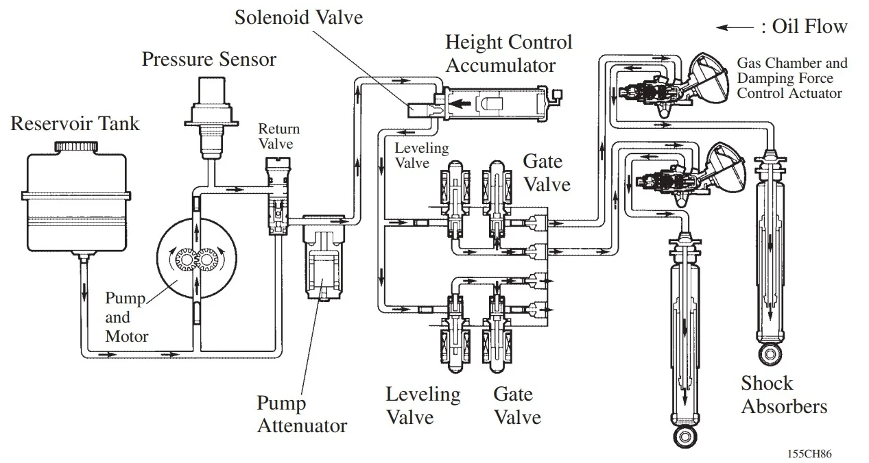

AHC System Raising -- fluid is sent to 'Shock Absorbers': ECU opens Levelling Valves in the Control Valve Assembly and causes AHC Pump to operate, thereby sending fluid to the 'Shock Absorbers'. Fluid passes down the central internal tubes in the direction of the arrow, filling the 'Shock Absorber' and causing vehicle to rise. The Pump is ON, so the Return Valve is OPEN and fluid is drawn FROM the AHC Tank
