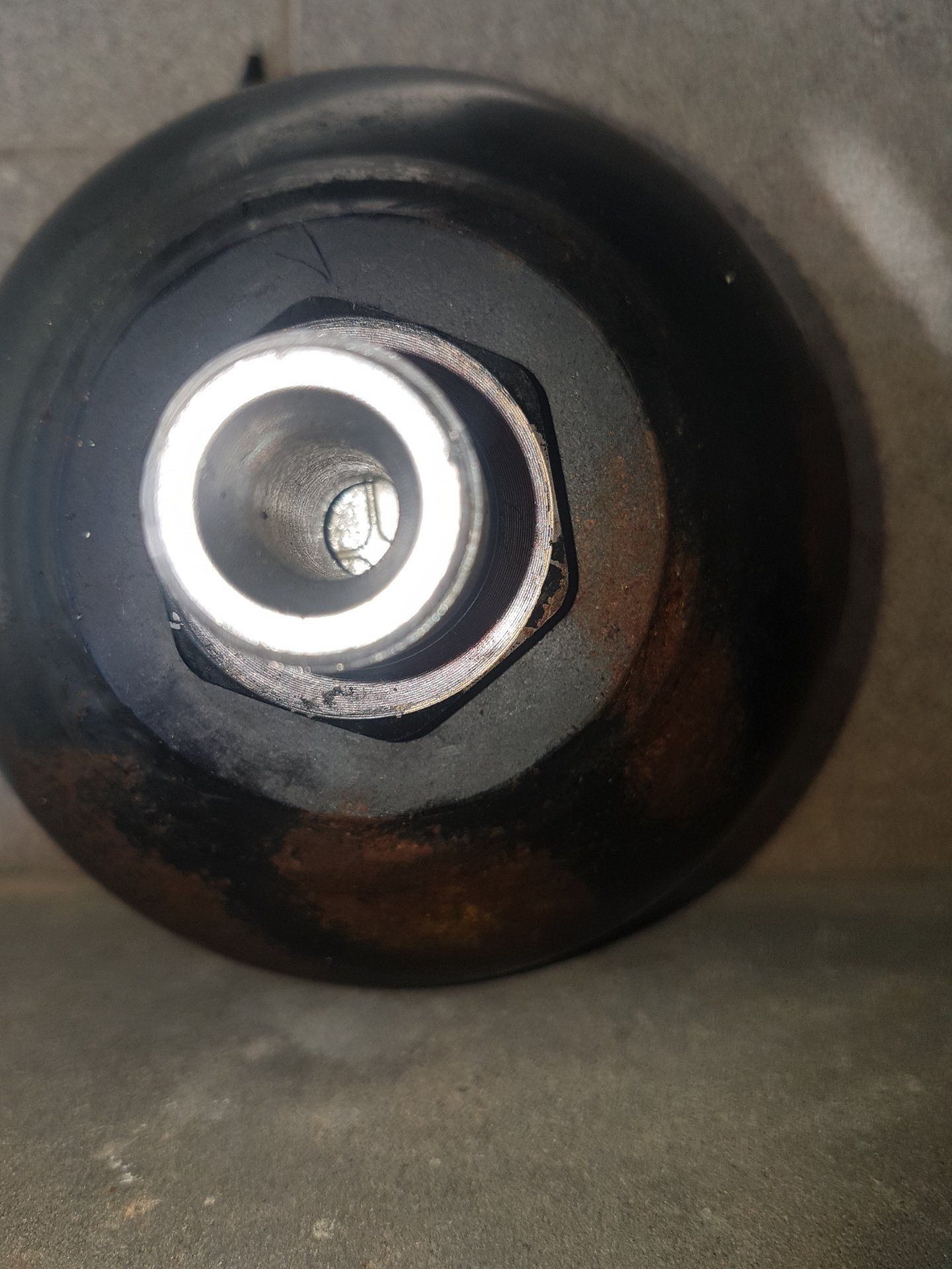

Trying to replace ahc globes and successfully changed one but none of the others are budging.
I have no pb blaster on me and no way to move the car (at friends house right now too). Given the other globes haven’t budged, it would suck to have to start it up with only one globe changed but is that possible? So screwed IMO
I have a 36mm wrench recommended on MUD and a strap wrench which I can’t seem to figure out
Only thing I'd consider trying is get a chisel and hammer. Some have been able to hit on the surface where the wrench goes and most have just carefully hit on the globe. The globes are close to 1/4" thick steel so you're not going to go through it. If you can get them started and finish with the wrench or just turn it out by hand
This was the ticket. How this isn’t the standard recommended removal procedure is beyond me
