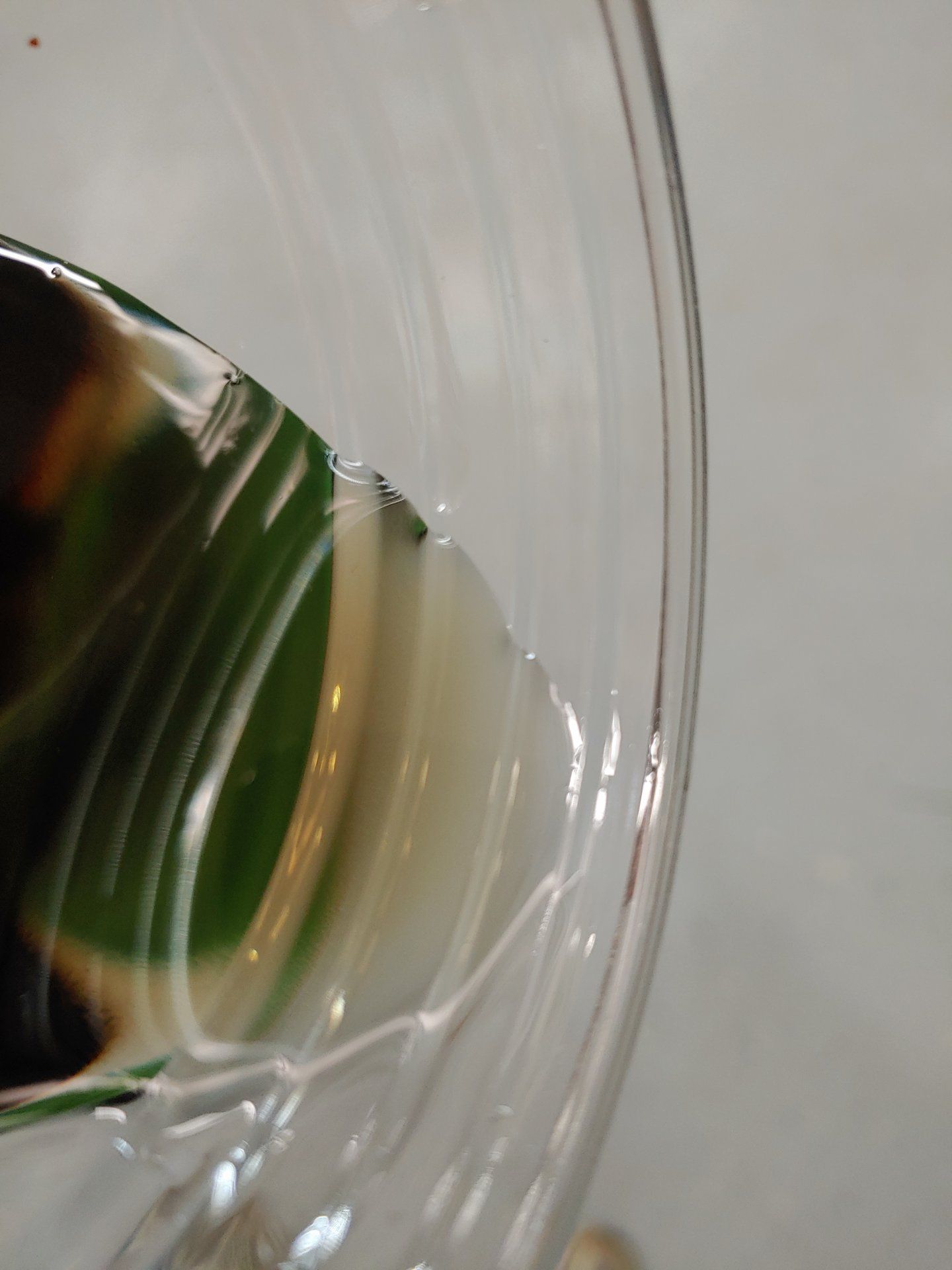

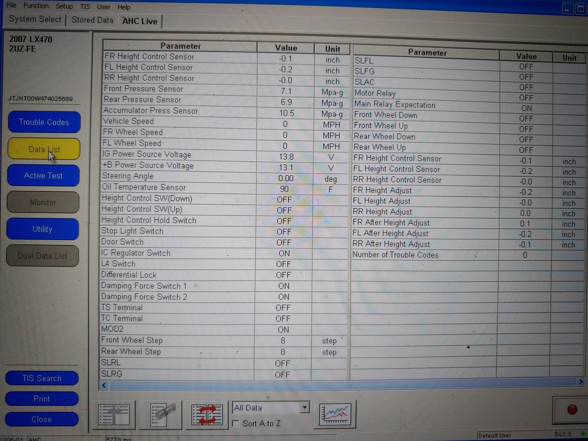

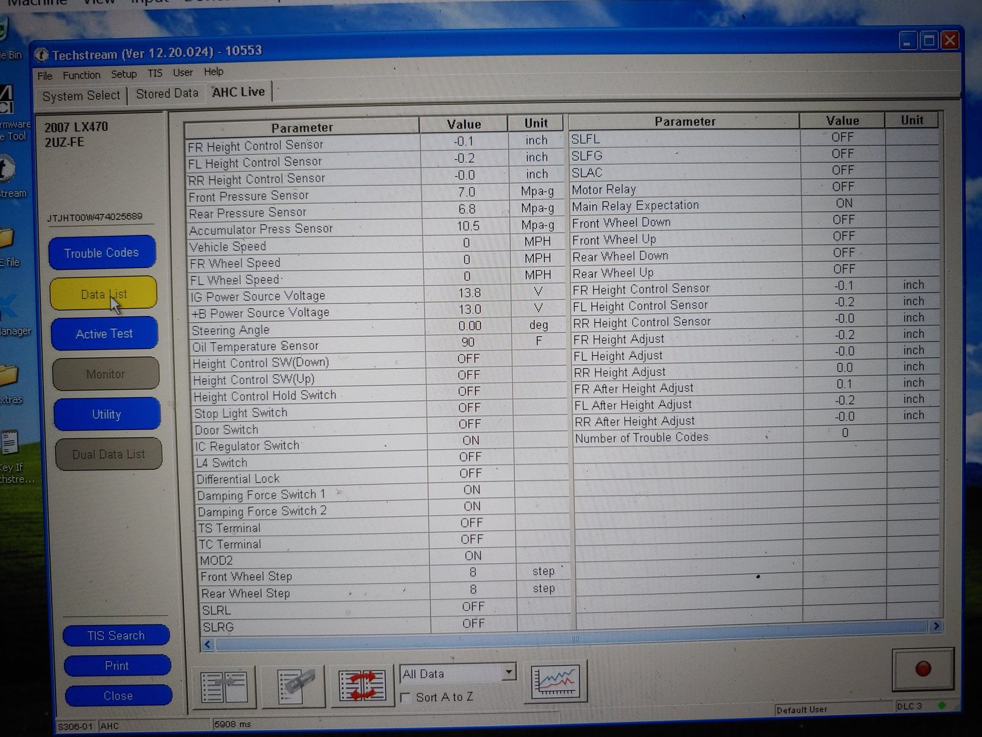

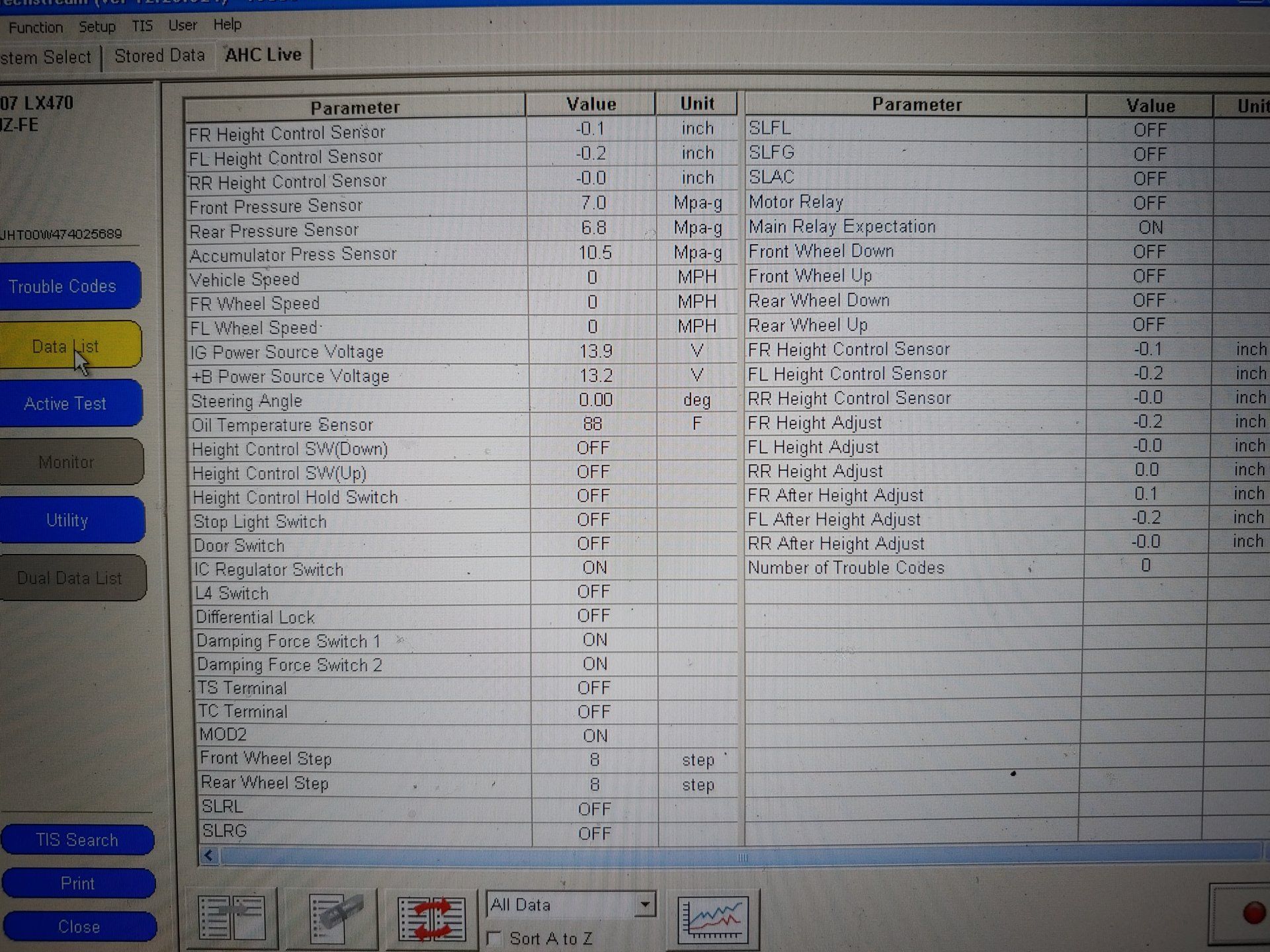

FIXED! Blead 8 oz from accumulator and at the corners to the bump stops from n with truck off. I'm getting changes under 20 seconds and spec accumulator pressures. Tomorrow I'll carefully flush the system with fresh fluid. Last pic is the fluid I started with before this adventure began. Grads now at 9.

Fluid looks like some sort of concoction of brake fluid/ hydraulic fluid glad u got that out before it did fatal damage. You may consider some 30 mil. Spacers for the rear which will drop the there pressure some.
