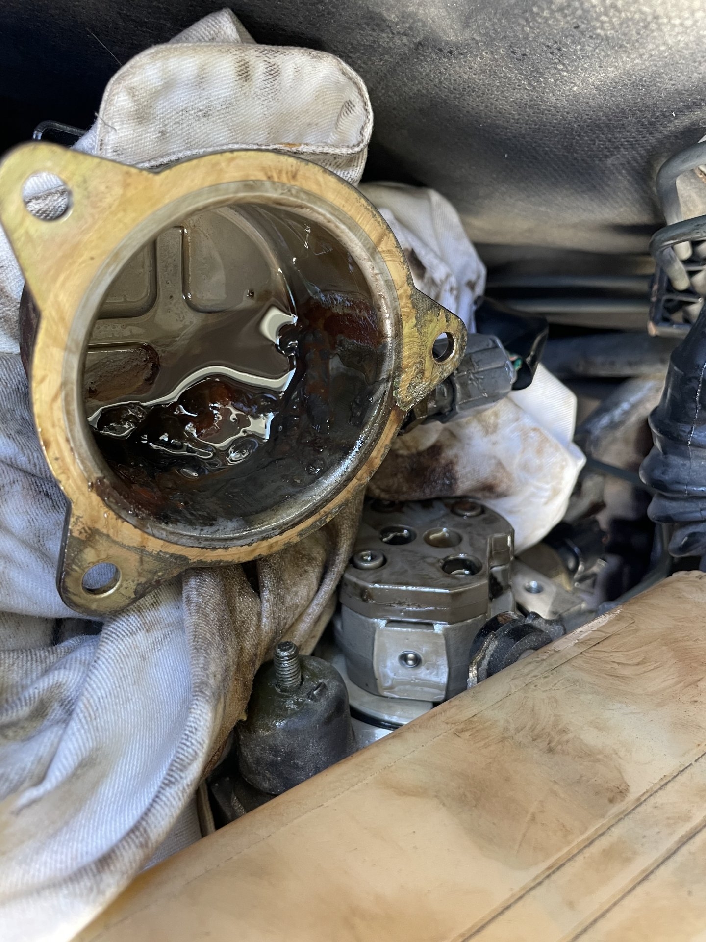

3 flushes must have loosened all this gunk up and it accumulated in this pump area. I used a used pump sub-assembly from someone ditching their ahc. Maybe cleaning will work too.
I have a feeling this is your issue. I was surprised at how much gunk there was.

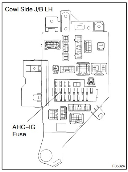

  • check AHC- B Fuse and AHC IG Fuse in Left Hand Side kickpanel in the driver’s footwell, and,

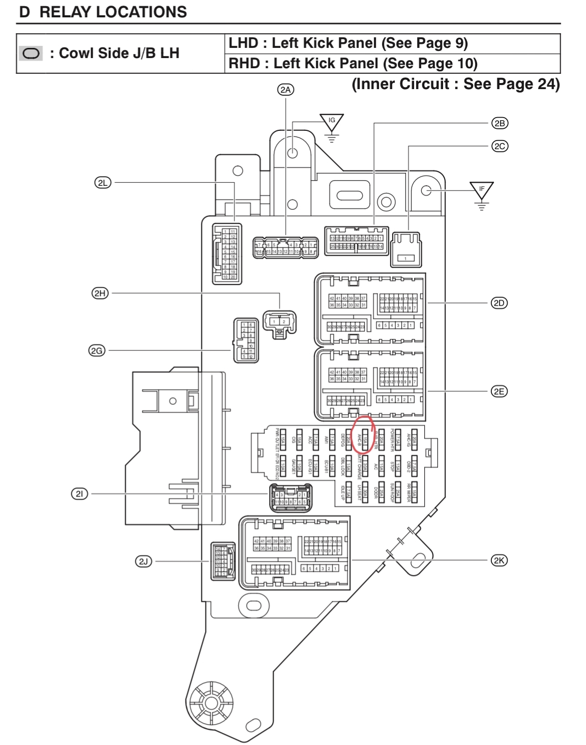

including Posts #71 and #76 in that thread for pictures of possible different fuse panel layouts.

Two variants of LHS Footwell Electrical Panels:

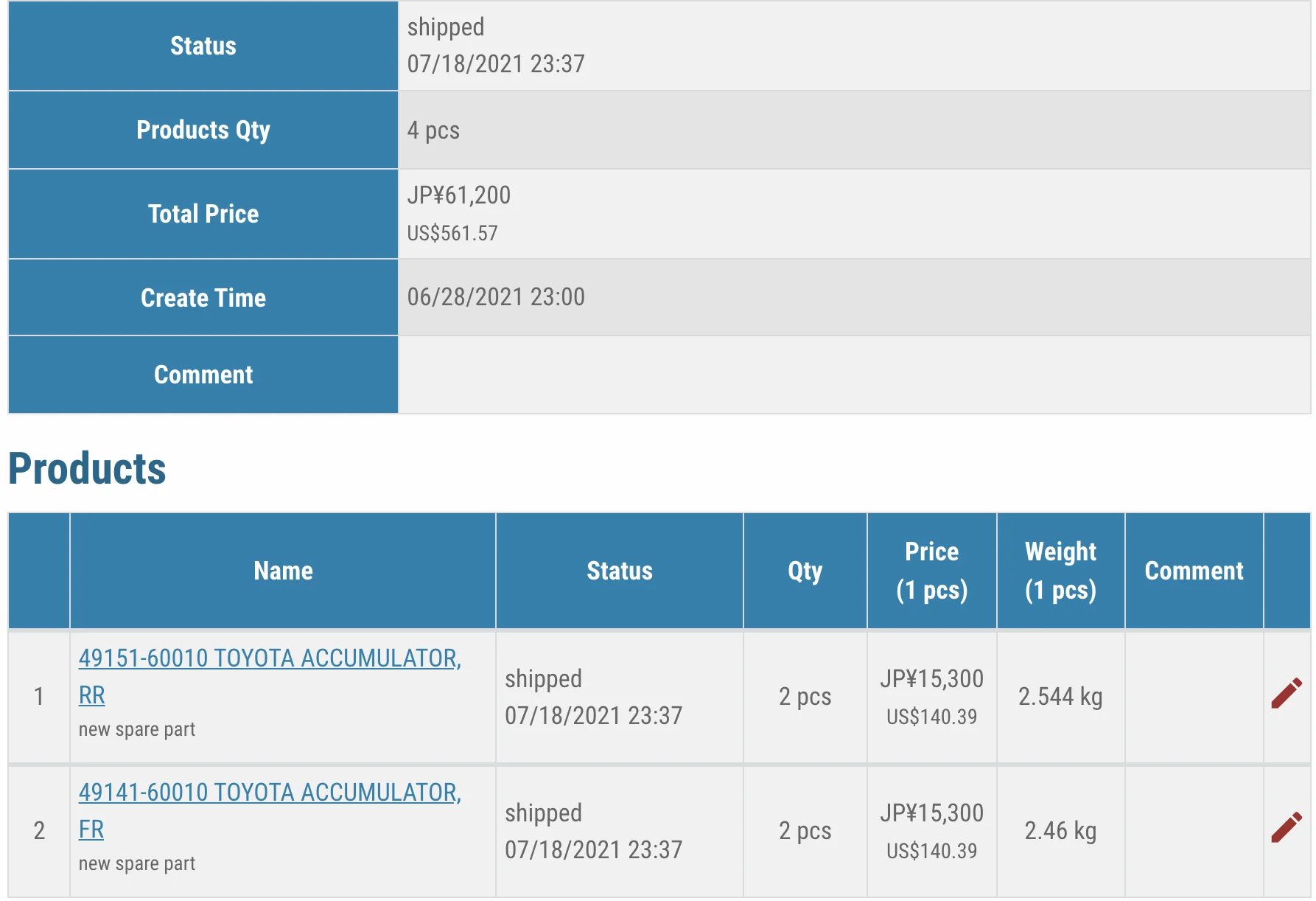

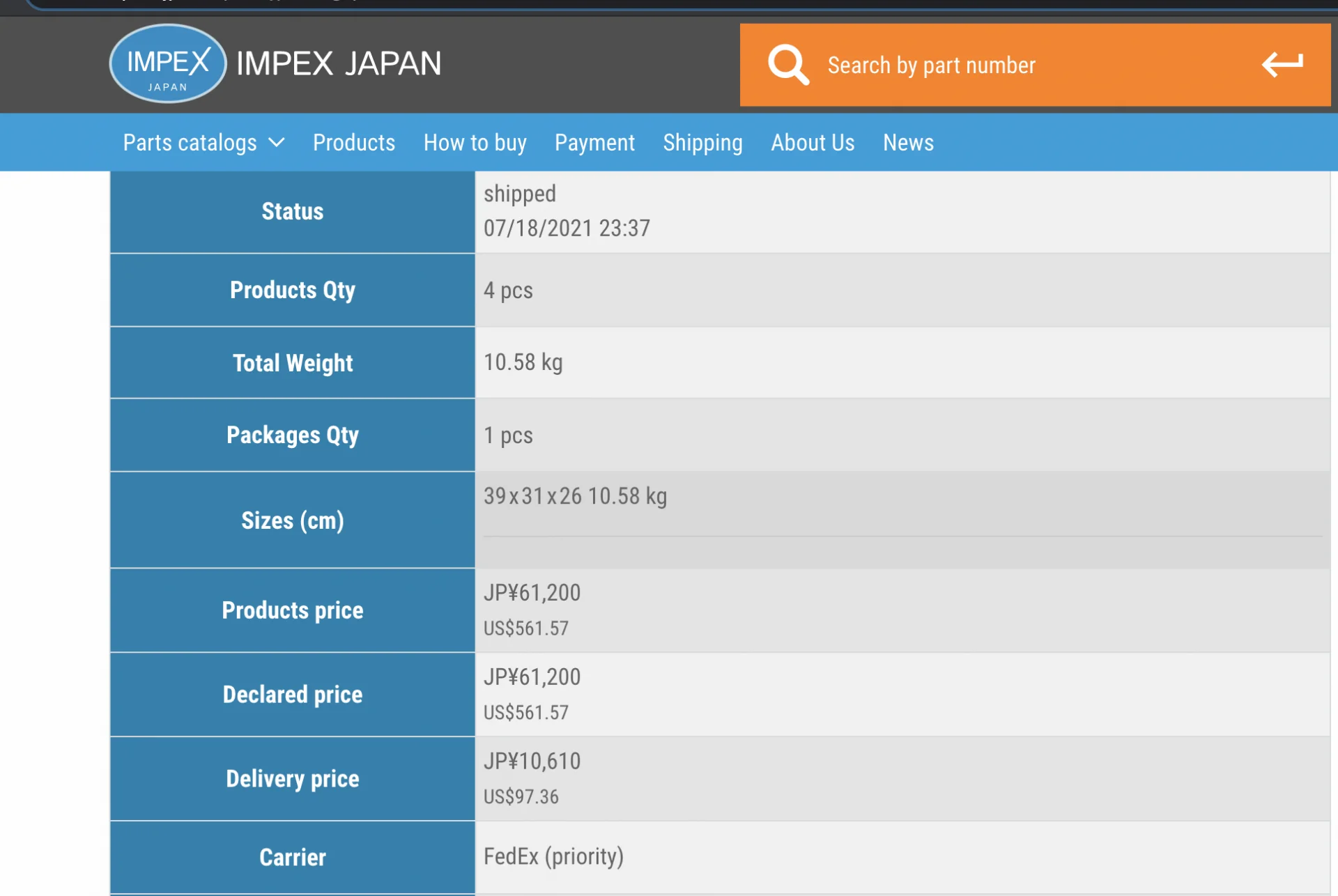

Another successful purchase from Impex; they arrived last week at 561.57 for the globes and 97.36 for shipping, 658.93 all in. I also ran across this 36mm wrench that is of outstanding quality. It was a perfect fit and zero flex. Amazon product ASIN B001ILECSQ

That is such a good price! I’m about to order them even though they were definitely not in the budget lol
how long did the whole process take you?
For me from date of order to completing the project about 19 days
My order was 13 days start to delivered. Just under 700 including shipping. It wasn't in my budget either but I felt like I was taking a risk considering my originals had 347k on em.
