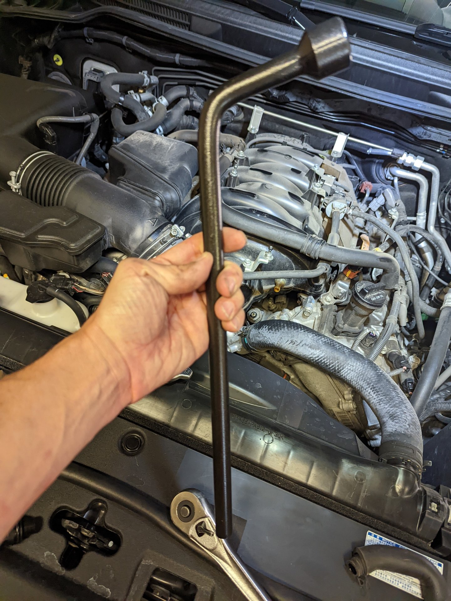

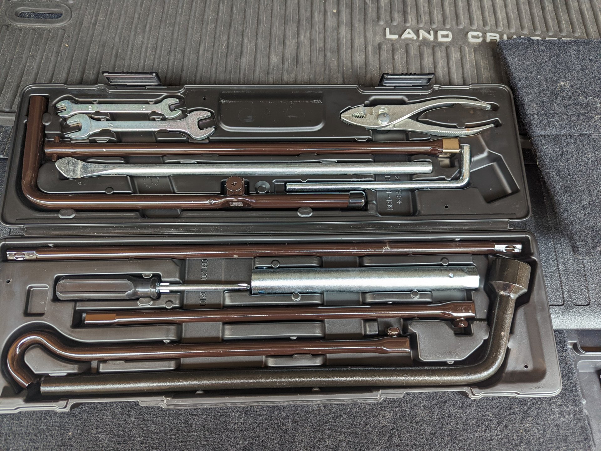

The factory tire iron will double a PCV remover.
When removing the PCV, take note of how much force is used. The PCV is made of plastic, and I can only assume it wouldn't take much force to strip it.
View attachment 3105096View attachment 3105097
This (tire iron) worked like a charm.

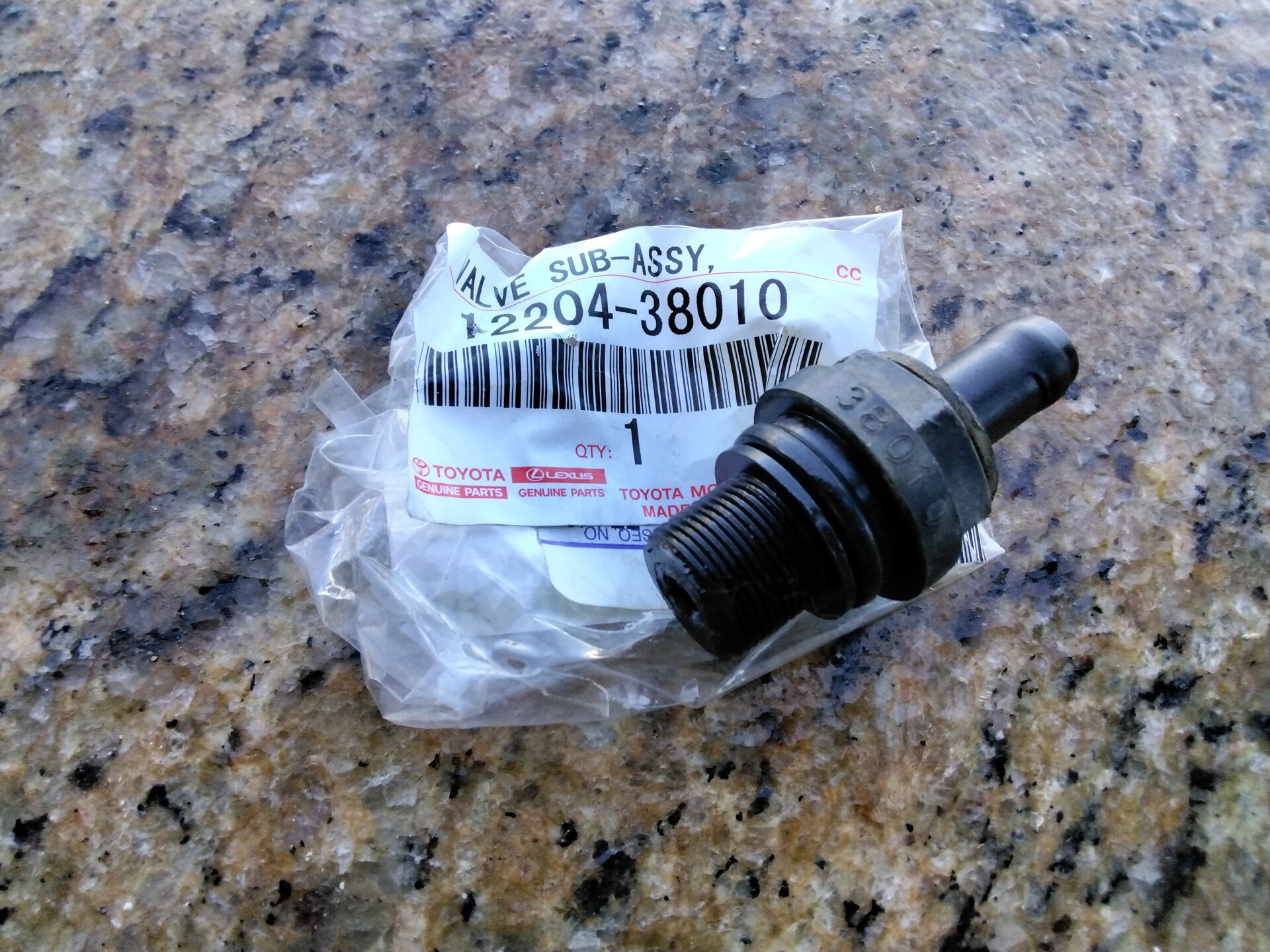

Circling back to green tip vs black tip. When I bought my replacement valve the other day, Toyota parts guy mentioned there could be a minor weight difference in the small rattle ball inside the actual valve designed for flex fuel Pcv valve and Toyota denotes that by having two specific part numbers for what appears to be the same part with different color tips?? He said either would work but I stuck to the black one.
Black
For what it is worth I still have the green one in mine and everything is running perfect (Probably around 10-11k miles later)
