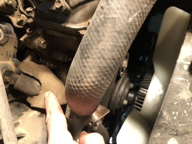

It took me a bit to find it too. Almost posted the same question. Lol. It’s on the drives side near the front. You can see the fan clutch and radiator hose in my pic. Look for the hose coming up out of the foam insulation.

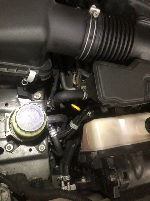

Can't believe it. Can't find it. Here's a pic of mine under hood pass. side. Looks like the PS pump hose is where you are referring too. Plz correct me.
OK. Here's where it really is - at least this is where it is on my 2013 LC200.

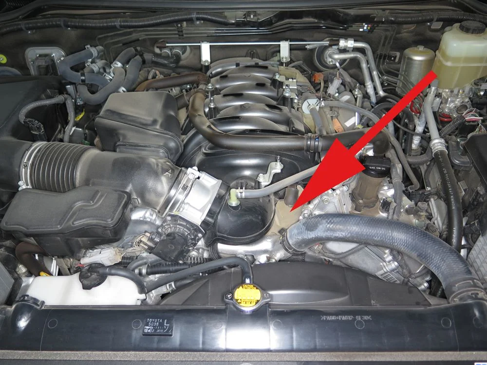

Overall view from the front of the truck pointing to the location of the PCV valve on the Driver's side:

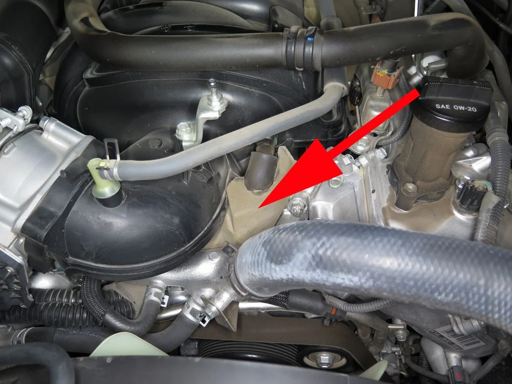

Here's a closer view:
Just peel the foam insulation back and the PCV valve is where the rubber hose ends at its bottom. Remove the hose, then remove the PCV valve.
HTH

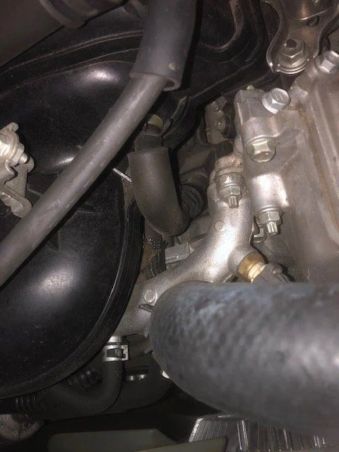

Thanks you guys. Pic attached.
