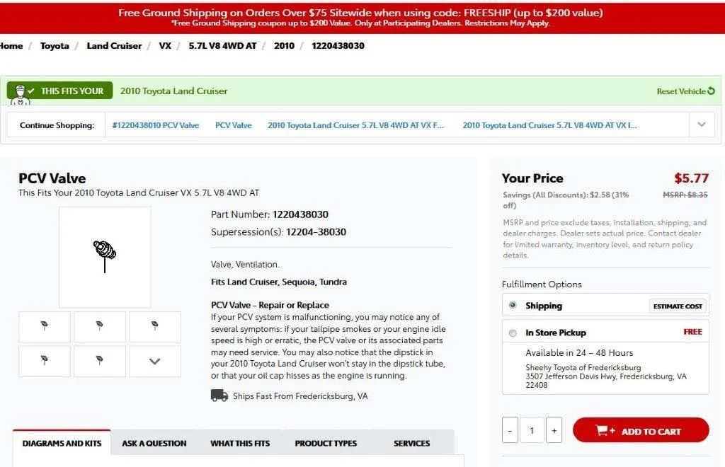

When I purchased parts for the LX from the Toyota dealer I selected 2010 Toyota Land Cruiser VX 5.7L V8 4WD AT
Attached image shows the part I got.
Fits Land Cruiser so I guess Im covered. I would take extra 1-2 mpg plus car truly runs like a champ.

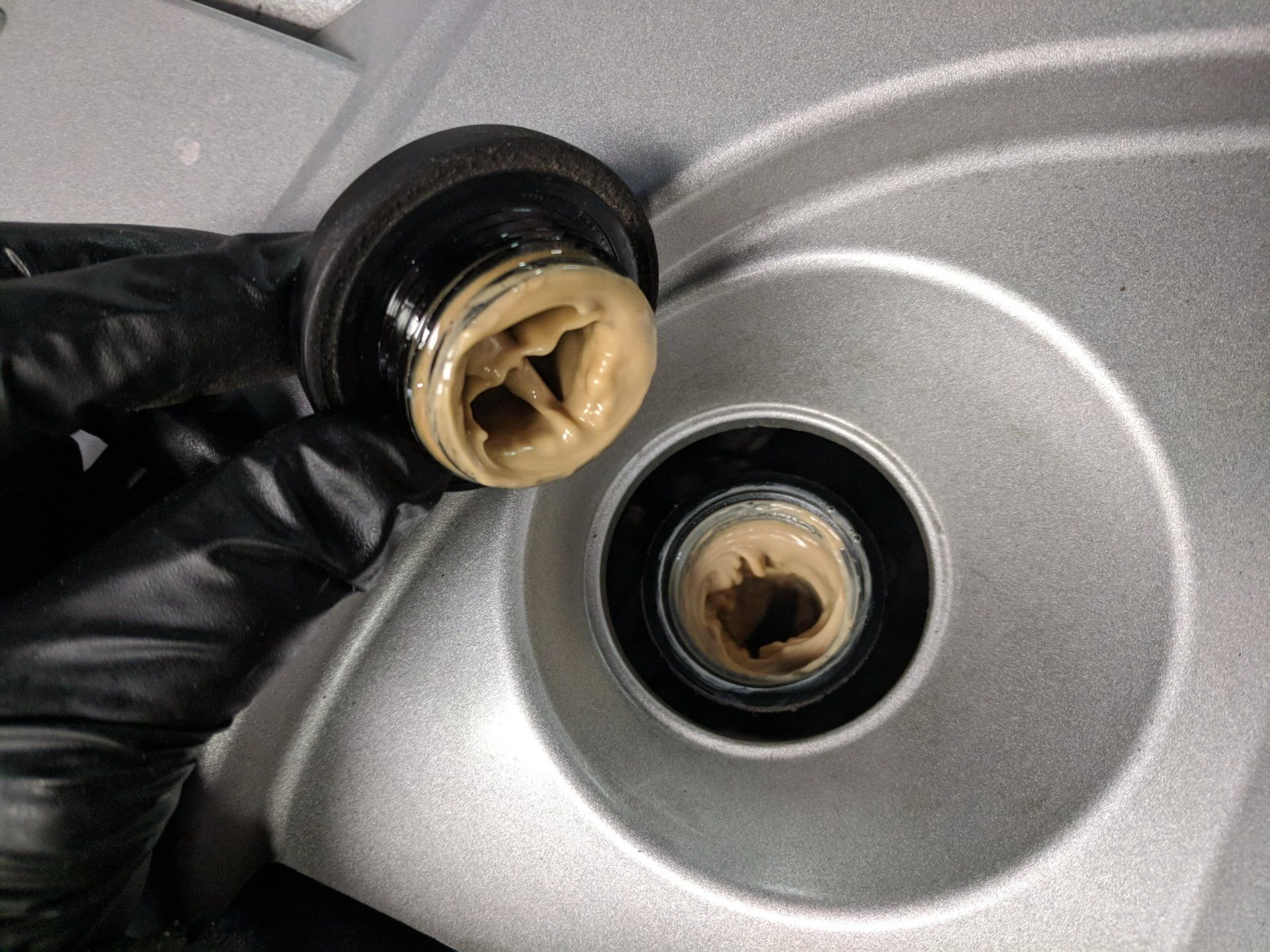

Wow what a lively and lengthy conversation about a part that in many ways is often neglected and ignored. I'm definitely in the "change it often" group. This is what can happen if yours gets clogged:
That was on my '11, it really gave me a good scare. I had all sorts of awful scenarios keeping me awake at night. I would clean that schmoo out, and in a few days it was back. Long trips made no difference. Oh boy.
Then on a whim I figured I'd try the PCV valve. Takes only a few minutes, I found a O2 sensor socket works really well. Took a few days to get all that crap out of the engine, but it totally went away. Phew!
